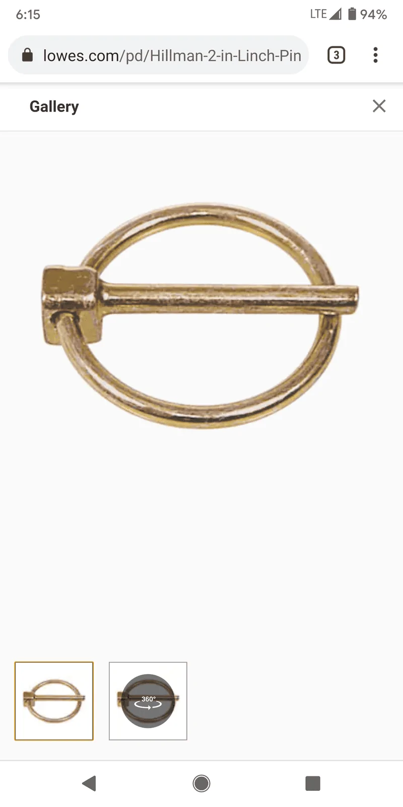

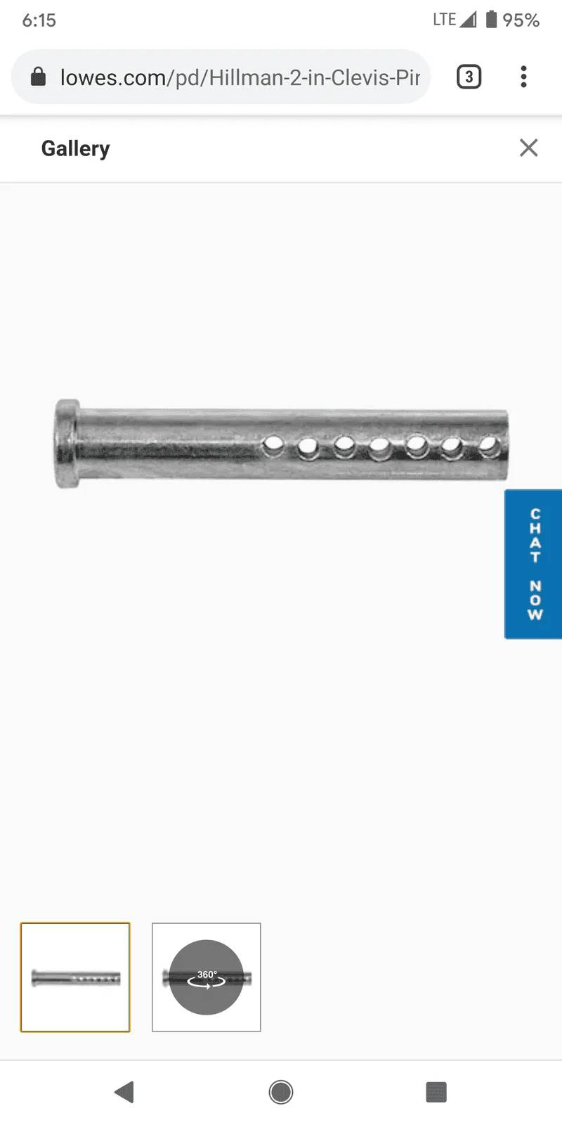

I'll have to look up what all I used on the JKU I had but I bought everything from lowes to do it. Main thing you got to do is get the right size clevis pin bolt and make sure you get it tight. Use a clevis pin to secure it, it's pretty much as easy as removing the bolt and putting the pin in. I may do mine today or this weekend if I get time.
