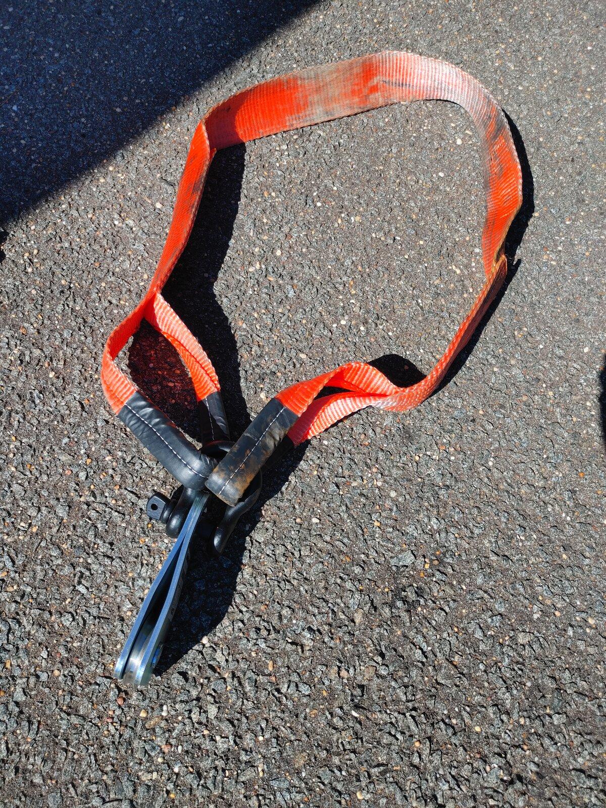

Just make sure the rope is specifically designed for recovery and stretching, not any old rope will do. Something like: Renegade 20-foot • Bubba Recovery Gear (bubbarope.com) Again, just an example - there are plenty brands to choose from.
The part where I mentioned using a shackle would be like this:
Jeep Gladiator Recover Straps Vs. Rope 0623211615_HDR
Imagine the orange tree saver is going around a tree. The loops are too big to both fit in your winch hook, and one-way winching takes just as long to setup but only gets half the pulling power you could have. So it's better to run a d-ring through the loops and into a snatch block. Then the winch line goes out from the bumper, around the snatch block, and back to the bumper for double the power. It's magic to me but it's true.
The reason I use a metal d-ring here is because the snatch block will cut into a soft shackle with those edges. They make this for that instead if you want to go that way and then a soft shackle will work: Rope Retention Pulley | Factor 55.
There are endless ways to recover vehicles, and endless products to support it.
