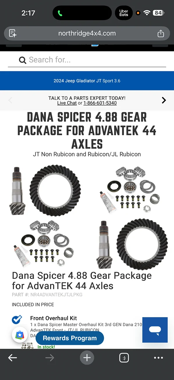

I’m planning to regear my 2024 Jeep Gladiator Sport (3.6L V6 / 8-speed Automatic) to 4.88s using the Dana Spicer AdvanTEK 44 Gear Package (Part # NR4ADVANTEKJTJLPKG).

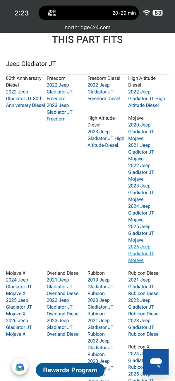

1. Fitment: The "This Part Fits" list on the website doesn't explicitly list the "Sport" trim for 2024 (it lists Mojave, Rubicon, etc.), though the main title says "JT Non-Rubicon". Can anyone confirm this kit fits the M210/M220 axles on a 2024 Sport?

Thats the kit. All gladiators have the M210/M220 axles.
The wranglers have the M186/M220 axles in all trims but the Rubicon. The Rubicon Wranglers have the M210/M220 axles like the gladiators do. That's one of the reasons I opted to not get a Gladiator Rubicon.
The kit above will fit all gladiators, and the Wrangler Rubicon.

If you haven't done it yet, yes it will fit. I just did it today but with 4.56 gears. I bought them from northridge 4x4 also.
