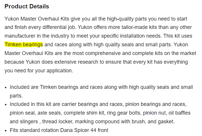

I looked it up.
Yukon uses Timken bearings.
Well it more than likely is the pinions themselves that are the culprit but nice to know they use Timken
