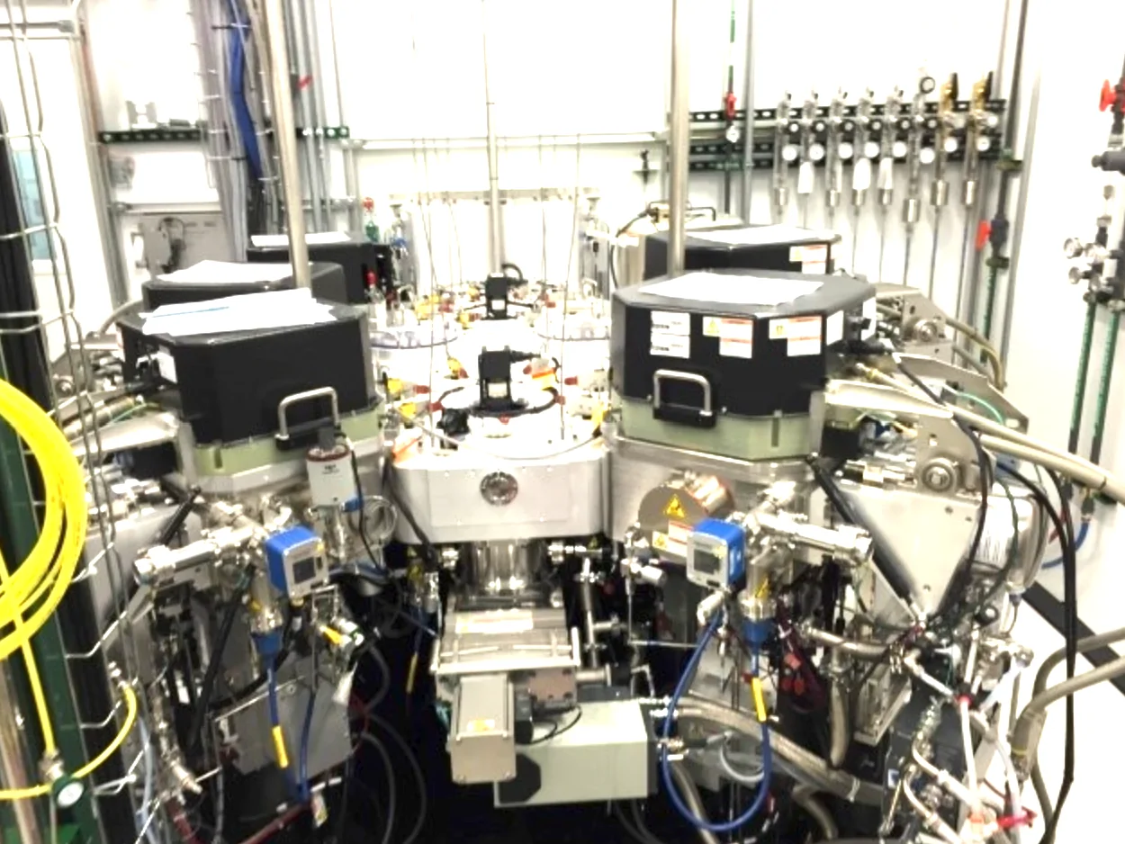

But you can have it on shocks, where the bushing and machine bushing are press fit.. Beyond that I'm not sure I follow the press fit "bolt" concept you imply, unless you mean a shouldered bolt, a compression or carriage style bolt. Even with shouldered bolts being 2mm smaller in diameter you'd have the same issues.
As far as force, the suspension components, after the axle hub have some of the largest and highest fastening torque of all the parts of the vehicle due to the force they are subject to.
I routinely install fasteners that are required to have essentially nearest to no tolerance and seal to prevent atmospheric leaks while also being subject to constant 24/7 movement. Improper tolerance between bolts and fittings is a common failure I see junior techs make, so I'm not unfamiliar with this specific question. The greatest concern though again remains, the frequent cycling combined with any slack or hysteresis in the mechanical system. There is more wear generated when there is room for deviation to occur, that's the short of it. I'd say it occupies a good 10-20% of the failures in my daily work. Lots of moving parts, like shocks that simply make constant strokes, any slack beyond intentional design is a guarantee for premature failure.
Jeep Gladiator Regular Suspension on Mojave 1769474918106-u8
The bolt diameter delta between m12 and m14 isn't just about the visible size. The sheer strength between the 2 is easily more than 20% greater for the m14. Grade dependent, some other exceptions, but like bolts compared, yeah easily more than 20%.
The reason Jeep opted for the M14 bolt was done along side the changes in the reinforced shock mounts, both upper and lower, to withstand higher sheer and impact forces from driving offroad at higher speeds.
Of course YMMV based off your use, but at the very least, improperly matched bolts and bushings will accelerate wear.
