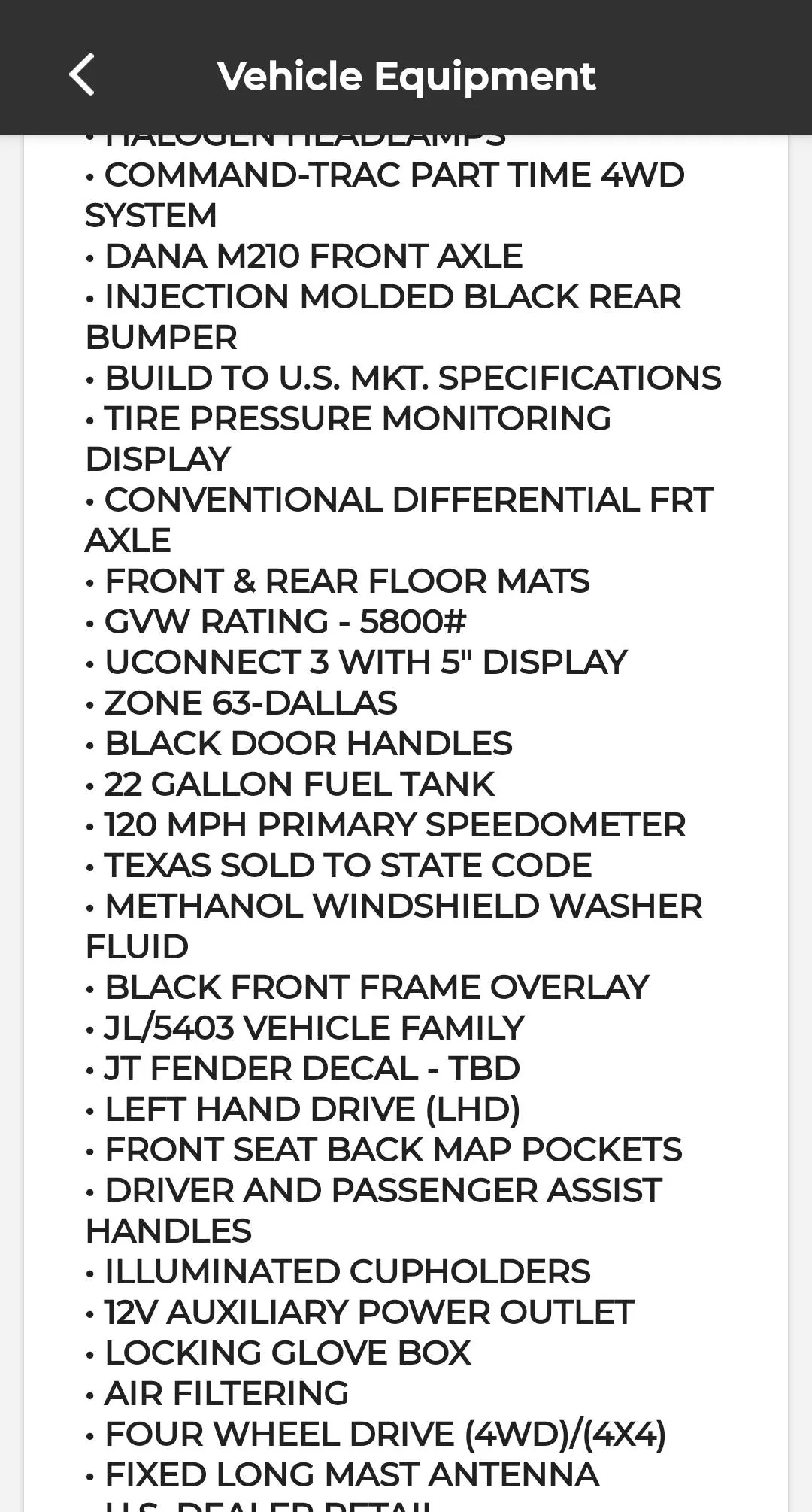

So I want under my Jeep app, it says under standard options uconnect 3 with 5" display
Jeep Gladiator Remote Auto Start Screenshot_20230320-144350_J

How do I know if my head unit has that?
SiriusXM Radio is the receive only satellite radio option that is available on all the head units. Sirius Guardian is the subscription service that enables the remote functions to work on head units that are cellular capable. These units normally have the service activation process completed by the dealer at the time of delivery. Jeep only offers support for cellular capable head units that are factory installed.

Thank you. I don't have any SOS button on my mirror, so I probably don't have it...
Correct. The vehicle equipment list shows the five inch screen. That unit is not cellular equipped.
