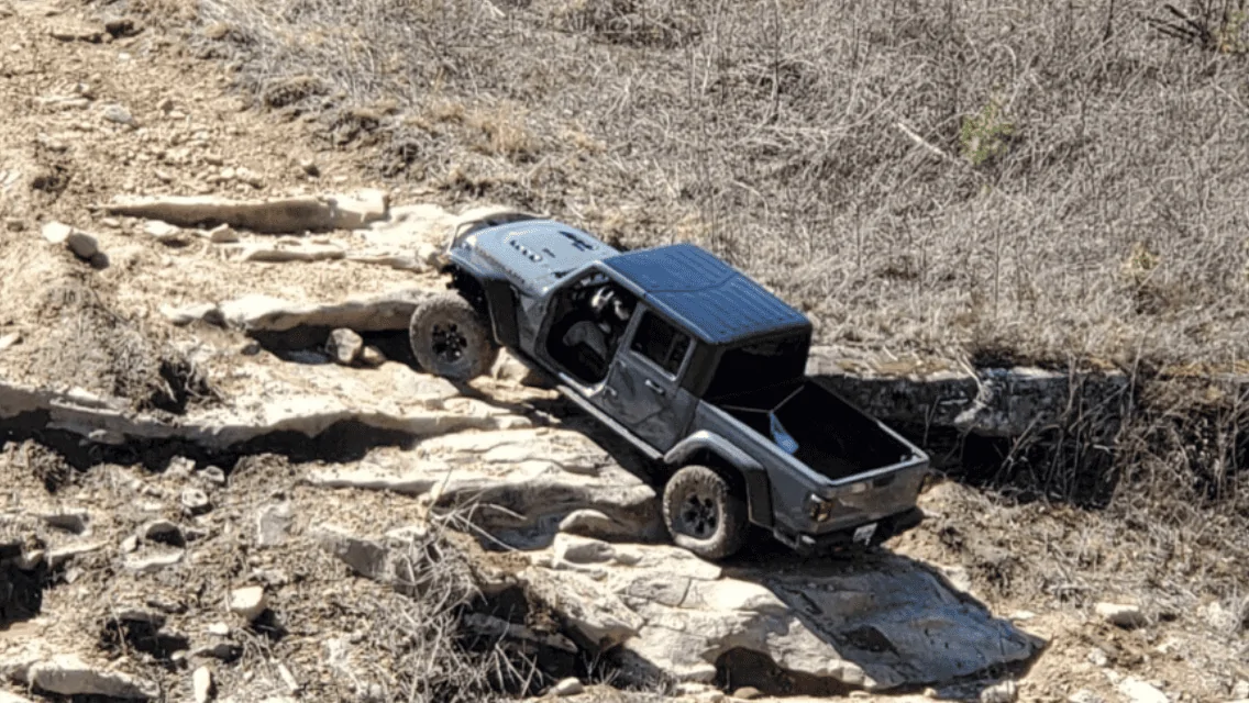

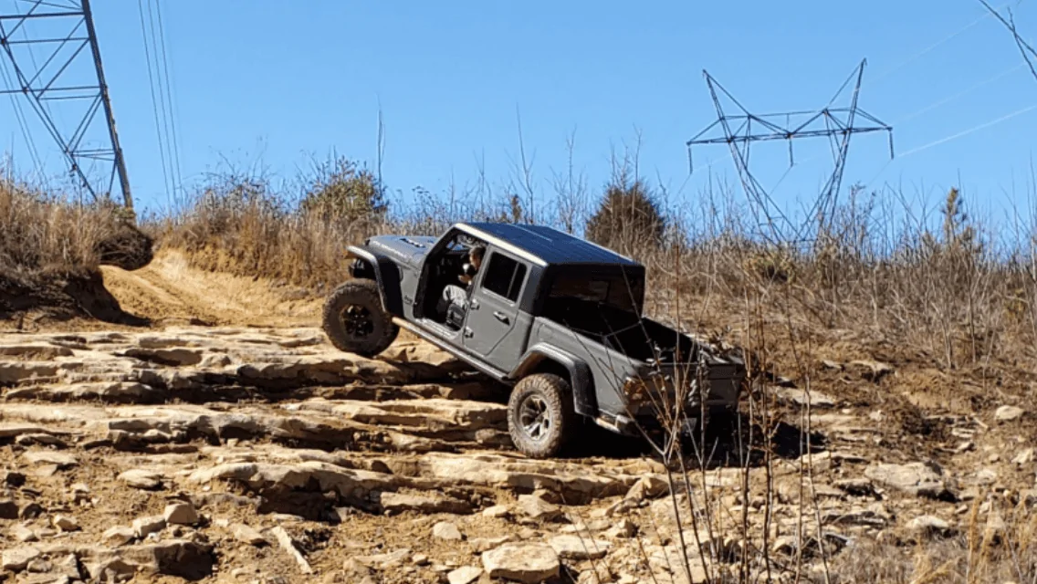

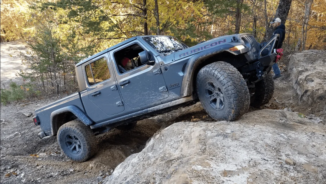

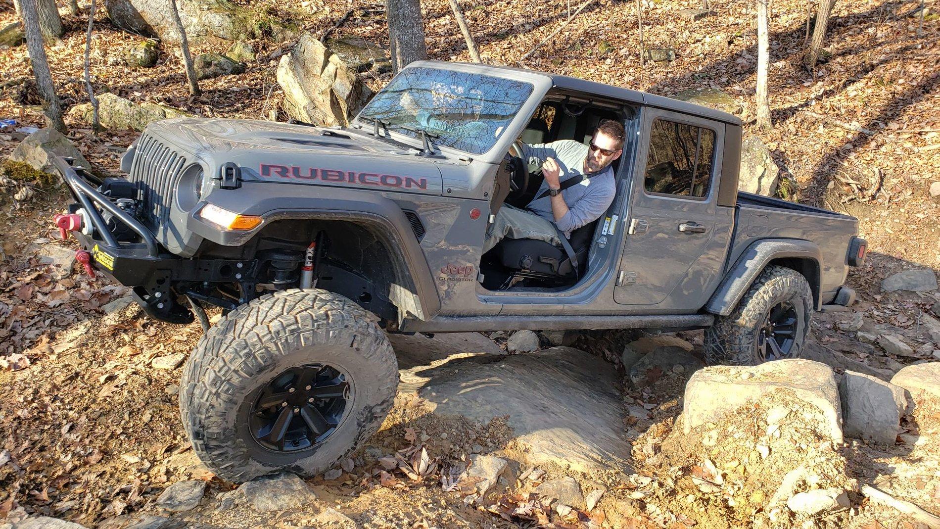

I got invited to Adventure Off Road Park today for their charity toy ride, and had a great time. I’m hanging up frequently on my rear frame control arm brackets. I’ve got some skids in mind there, as well as hopefully getting my rock sliders built in a few weeks!

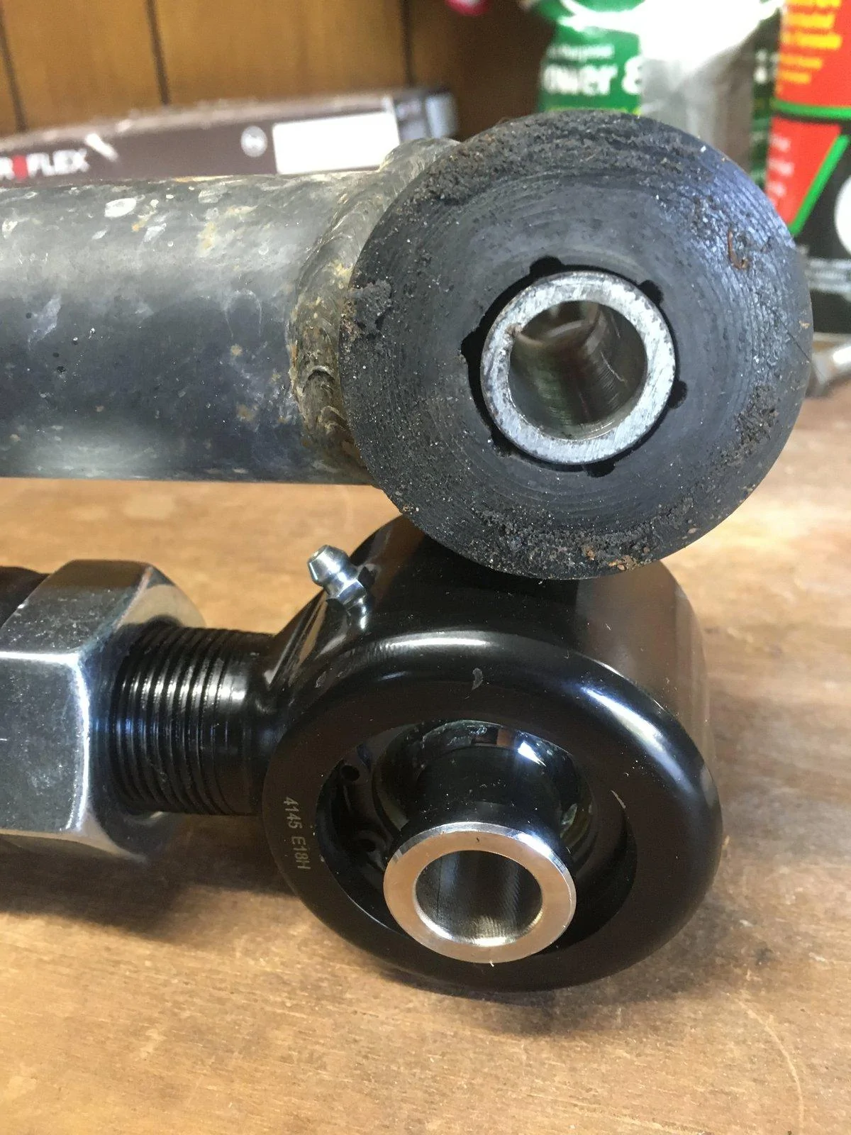

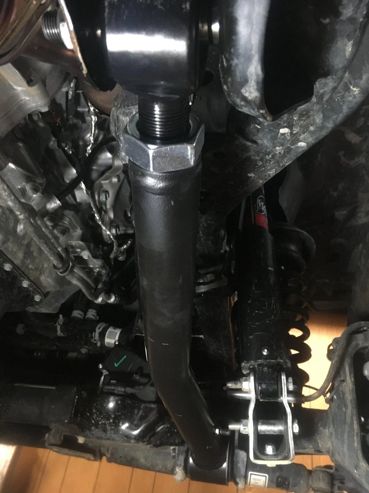

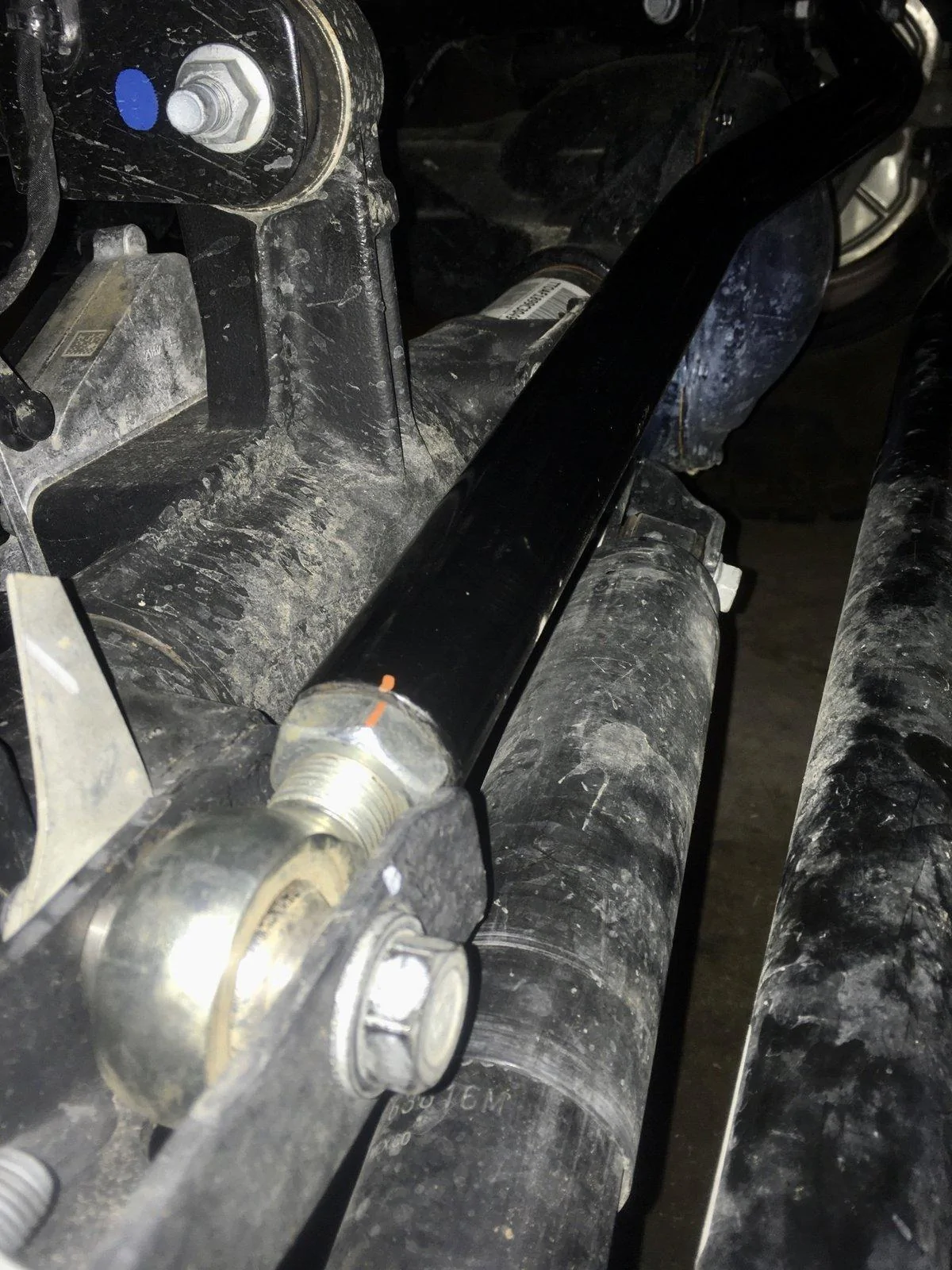

Well, the build has definitely slowed down since a mysterious (not really) disappearance of funds from my bank account occurred around Christmas. A local JL owner helped me out though with a great deal on some upgraded front lower control arms. These are Rough Country adjustable, and were desperately need due to my Daystar polyurethane bushings wearing out after only 5,000 miles.

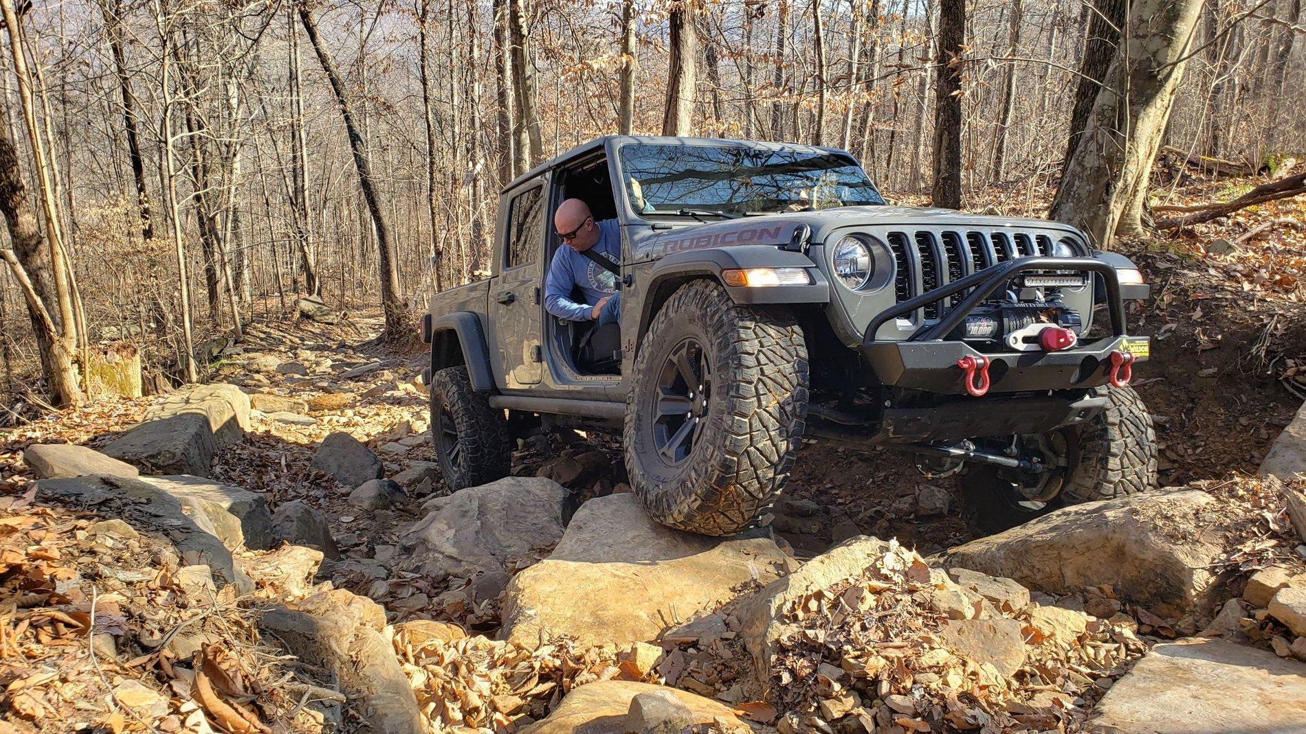

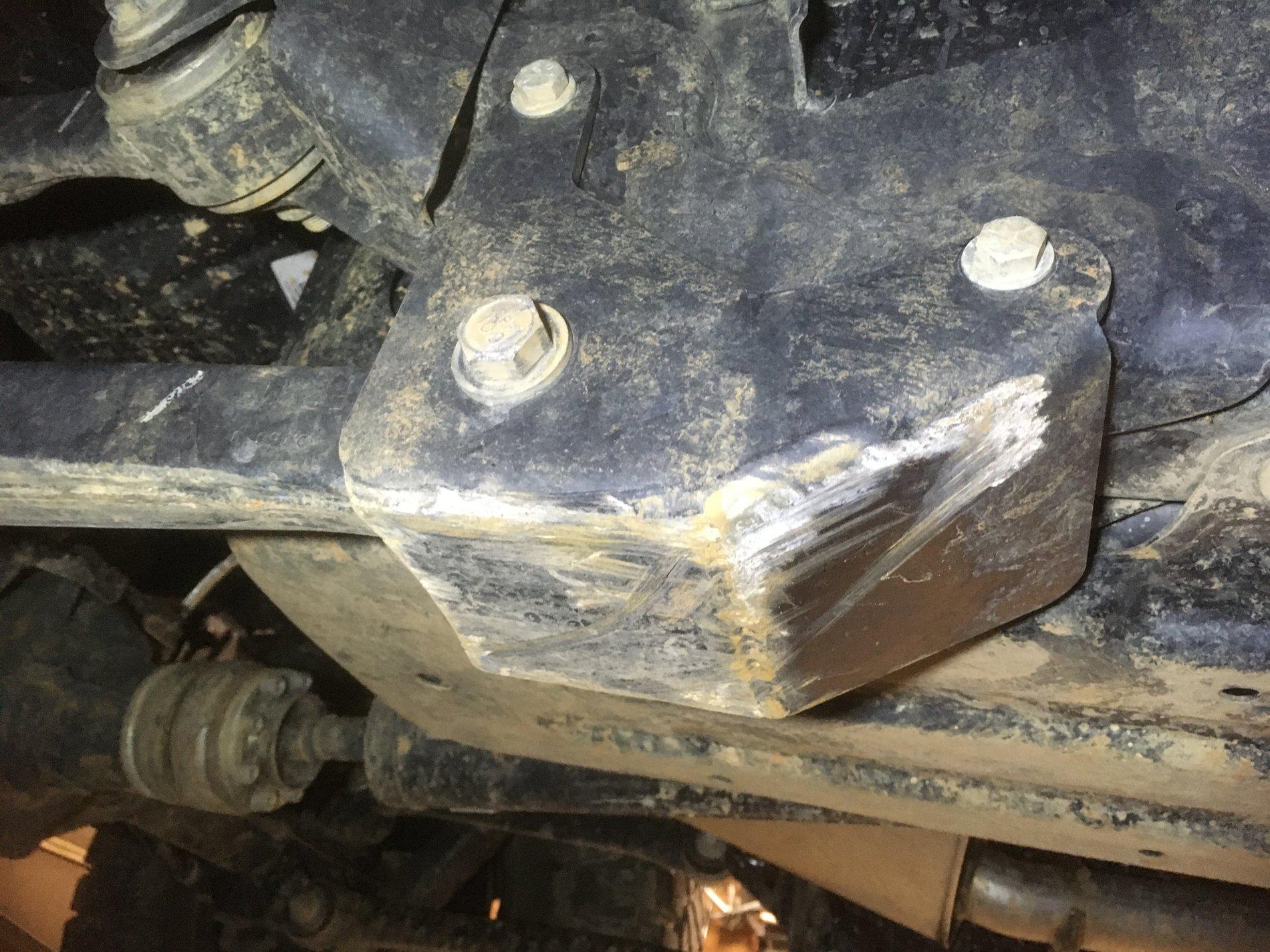

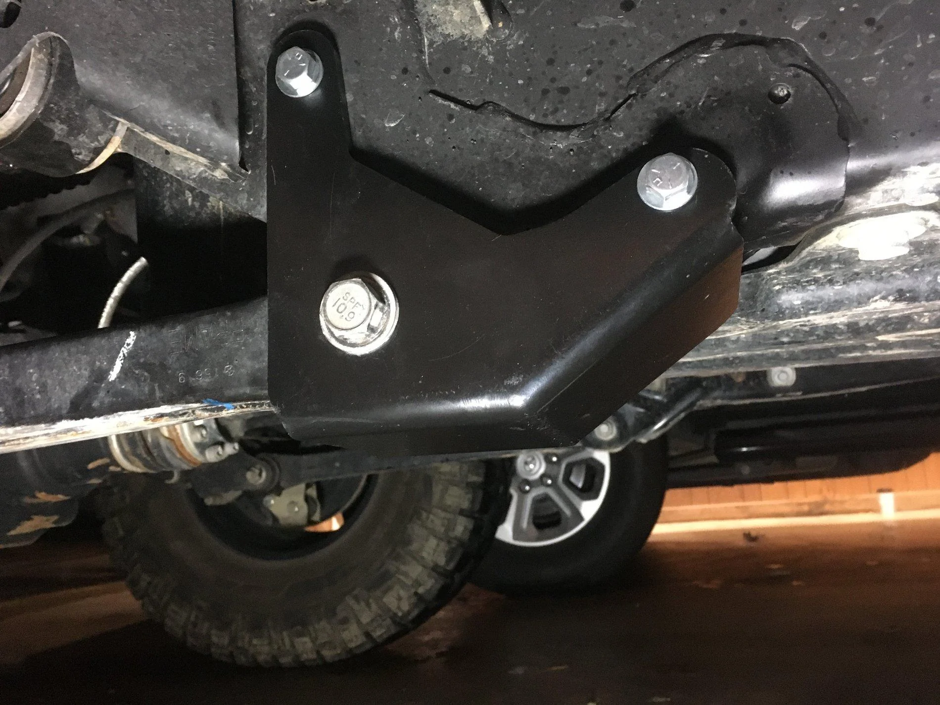

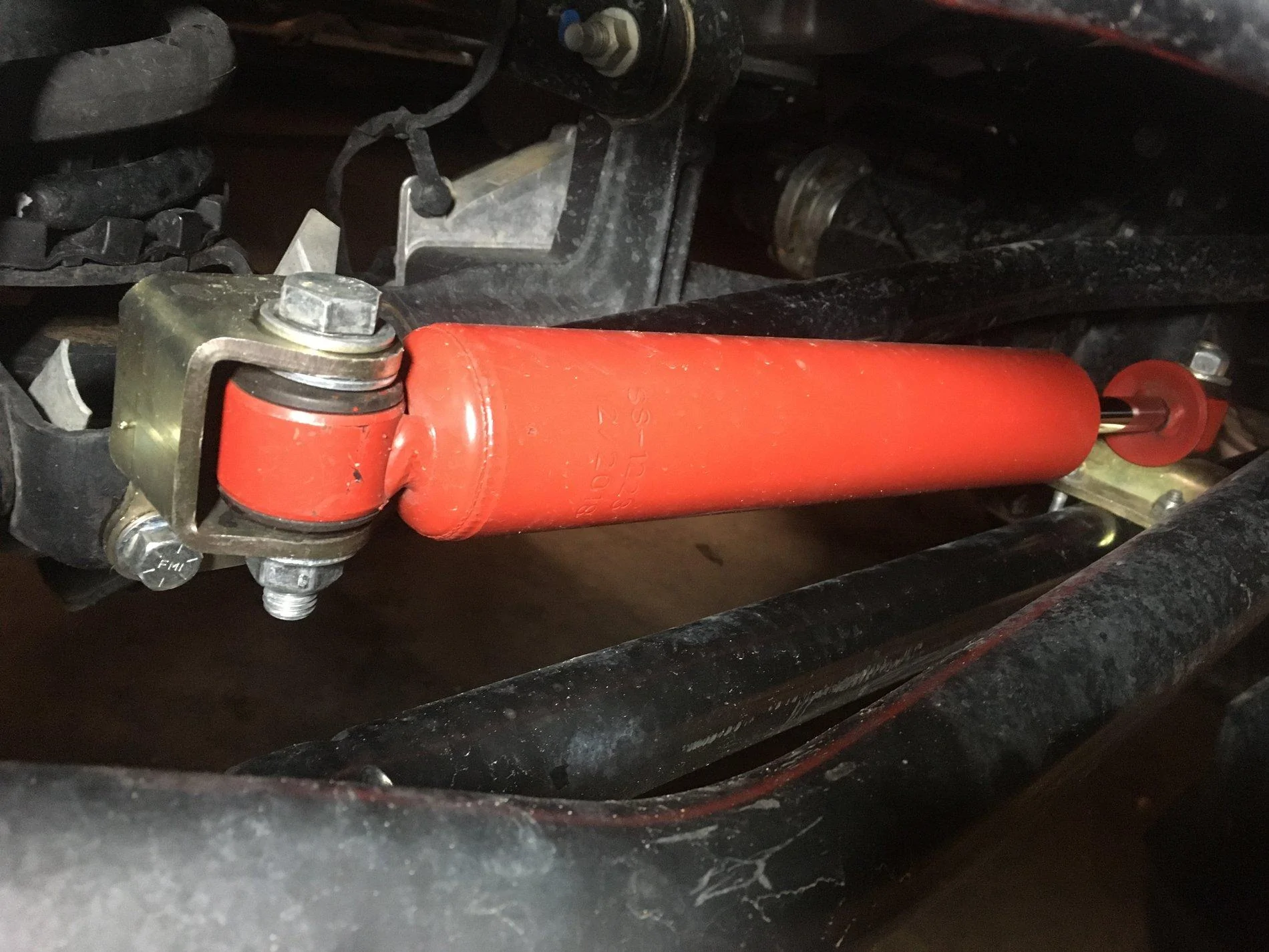

Slowly moving along, I’ve added a Metalcloak steering stabilizer and relocation bracket, and Rusty’s lower control arm frame skids. I was really beating those stock brackets up...

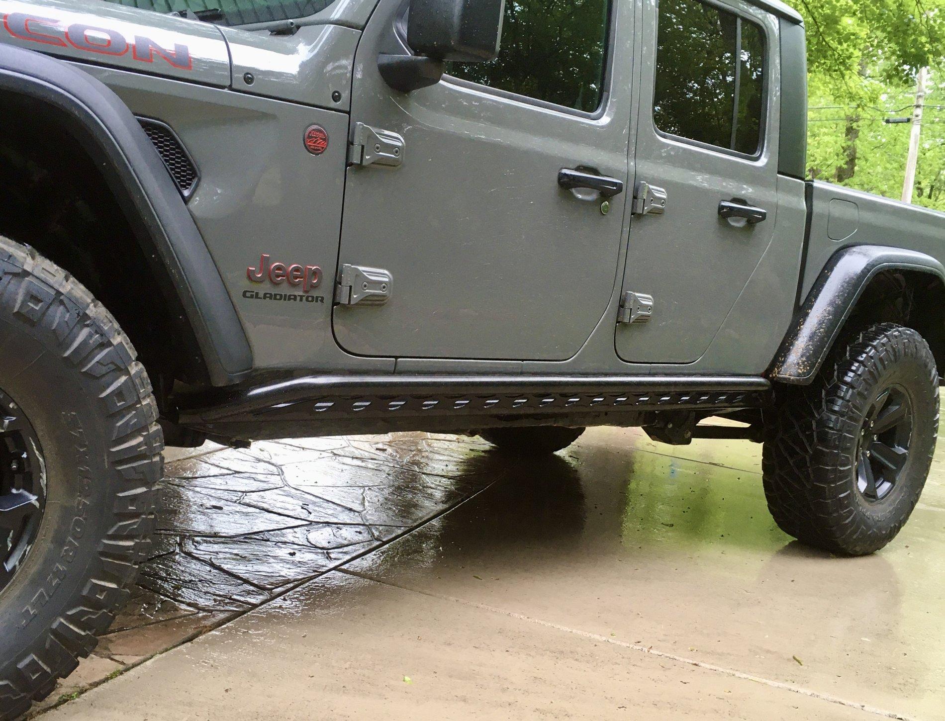

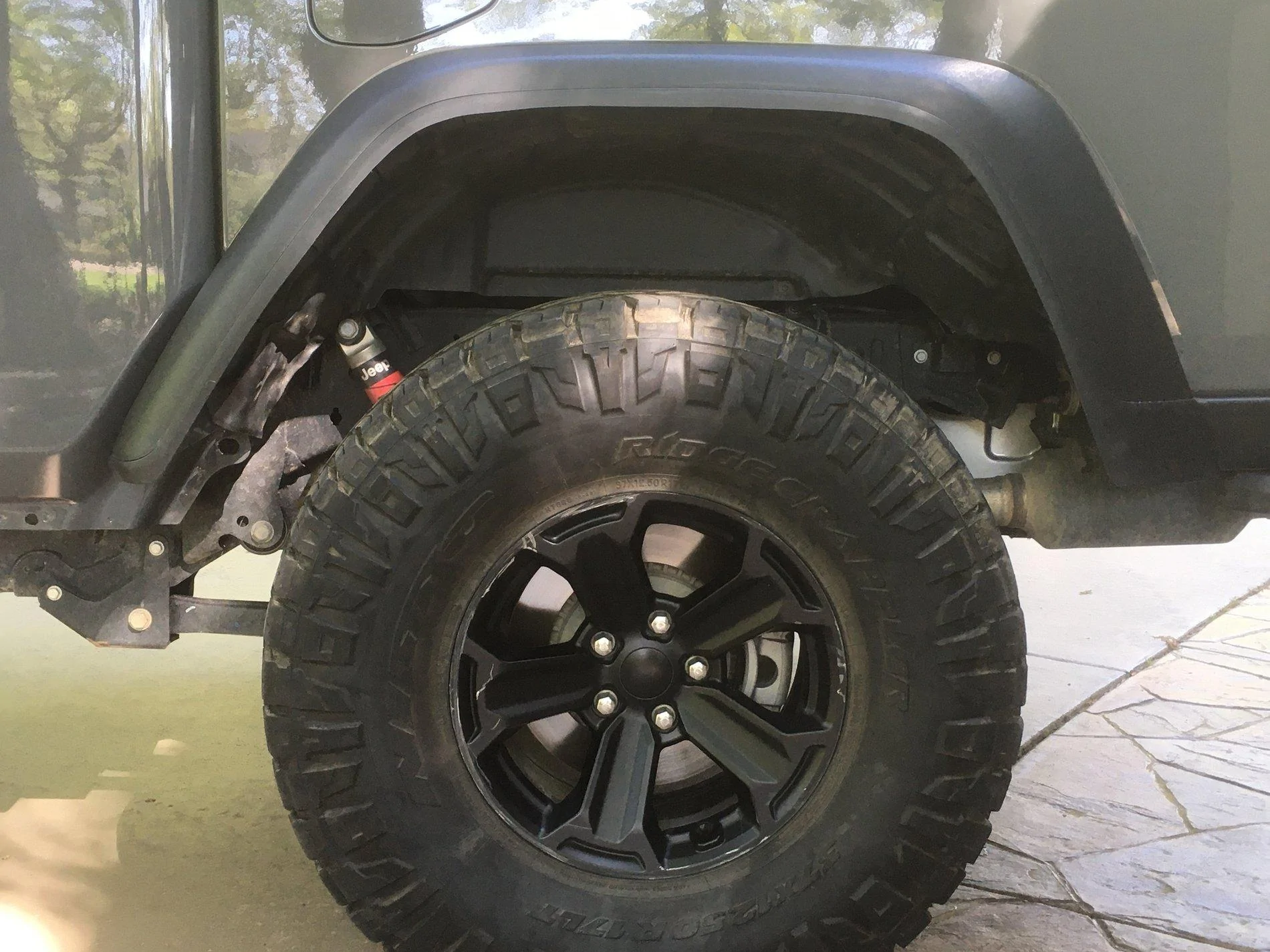

Well, thinks have been a little slow lately because I bent my DV8 sliders, and have been working on getting a replacement. After some negotiating, I put on some Rusty’s Offroad frame mounted rocker guards, and I also trimmed my rear fender flares and modified the inner fenders to allow more up travel (no bump stop extensions). I look forward to testing them out soon.

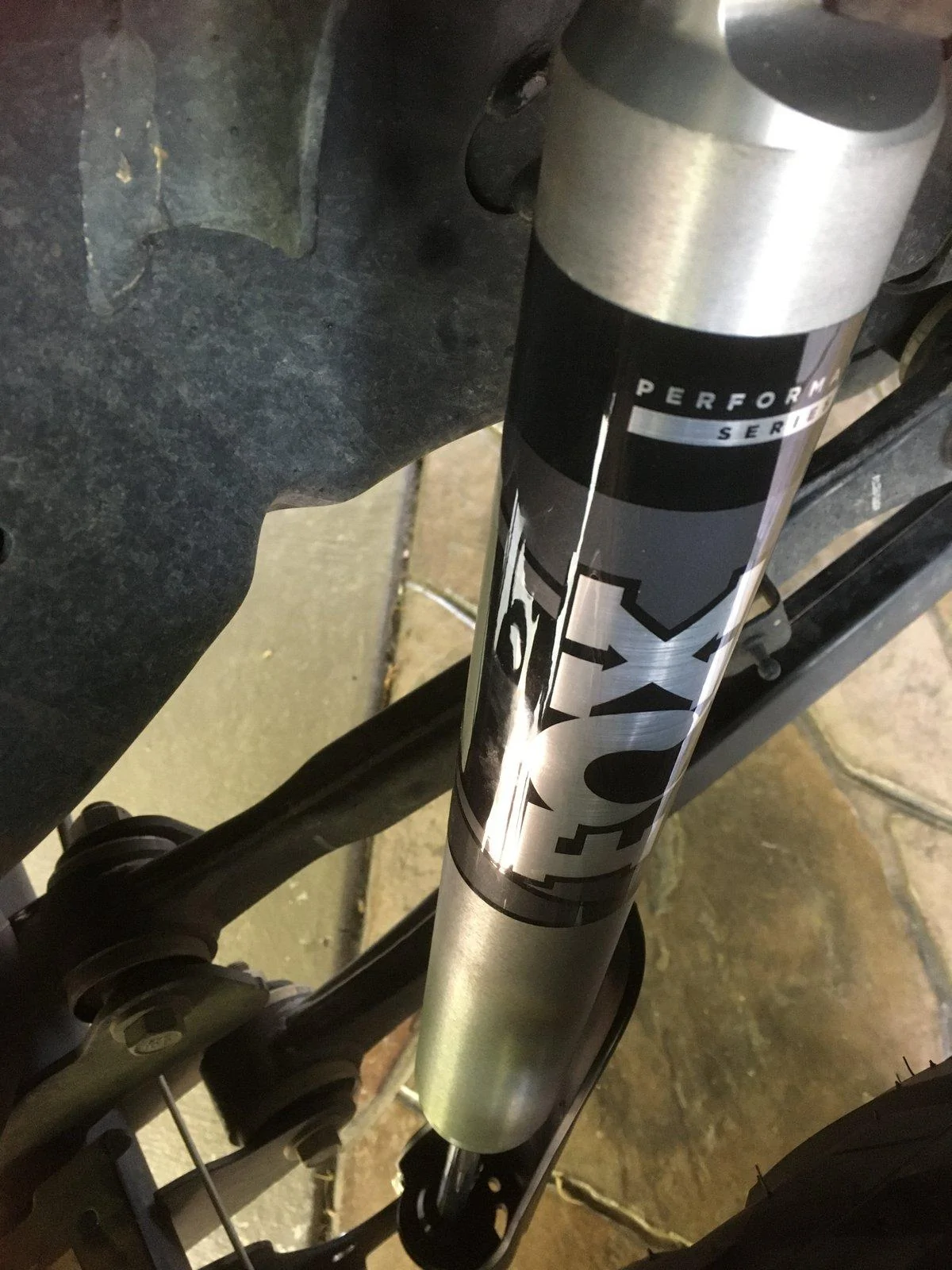

And for my final mod of the week (and probably my last for a while), I put on these JKS-spec Fox 2.0 Performance Series Shocks on the rear. They have 10.6” of travel (27.95” extended), and offer a bit more dampening than the Rubicon Fox Shocks.
