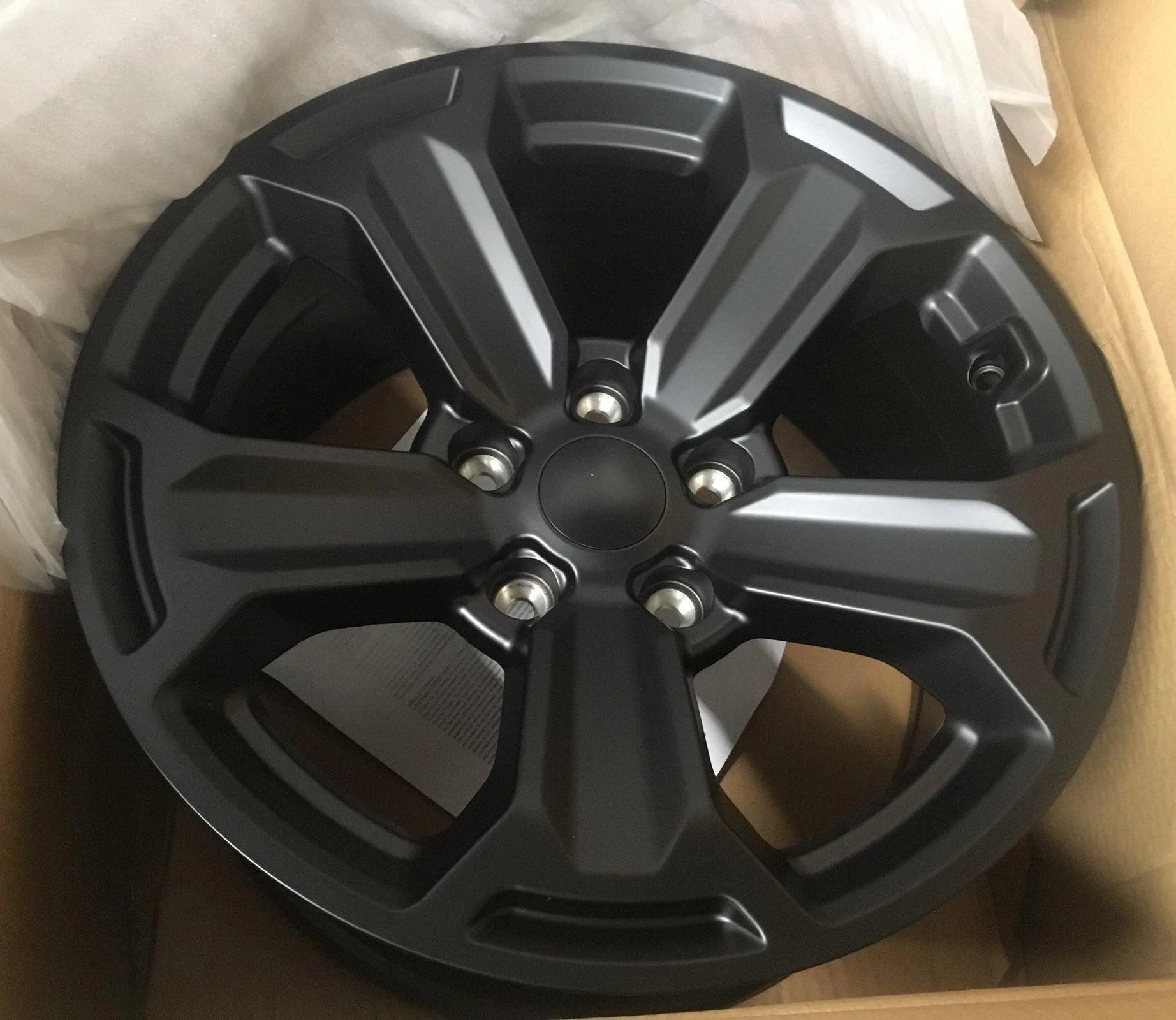

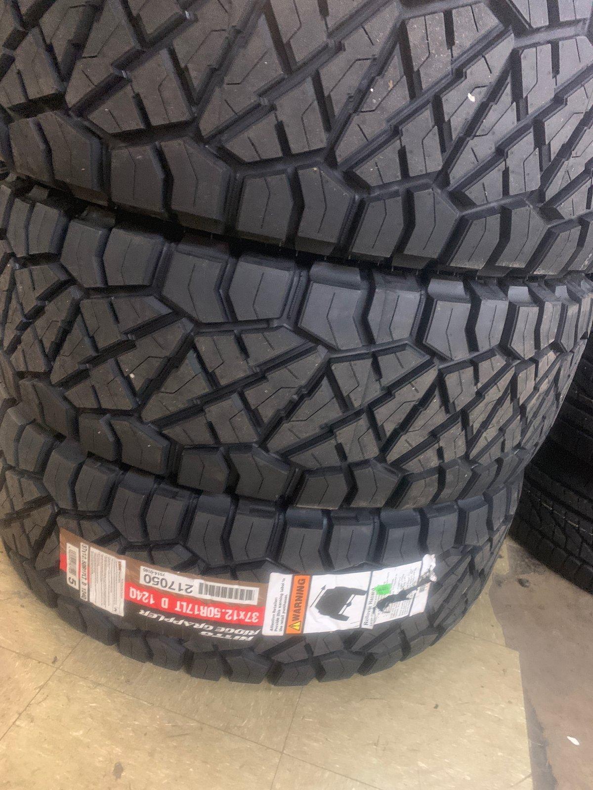

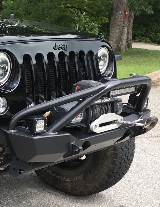

Well, the day is finally arriving. I am picking up my Sting Gray Rubicon at Tri-City tomorrow. I hope to add the bumper, winch and lift the day after I return, then tires and wheels the following day. Here’s what’s going on the first phase: Hansen bumper and Smittybilt winch from my JK, Daystar 2” lift, Quadratec Recon wheels, and 37” Nitto Ridge Grapplers. Rock sliders and rear bumper will come next, then a more advanced suspension as more options are available.
What color are these wheels? Satin black or Gun Metal Gray?

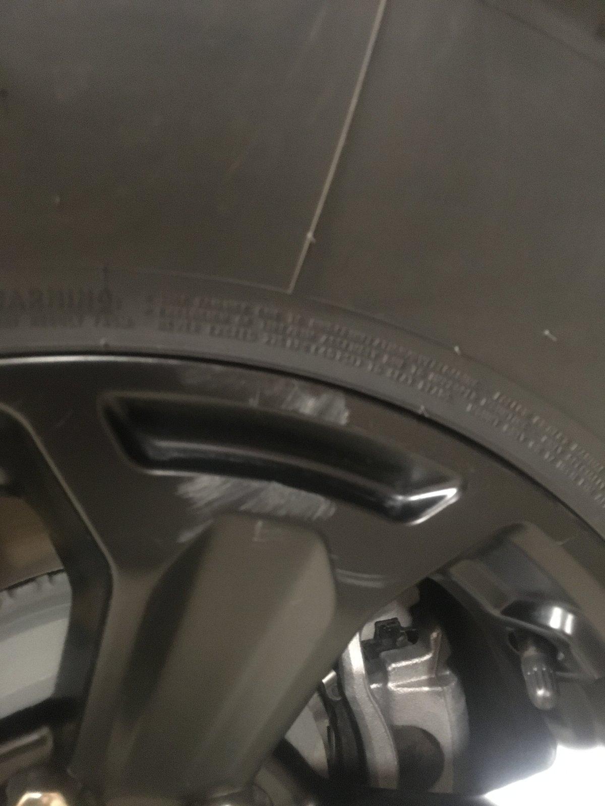

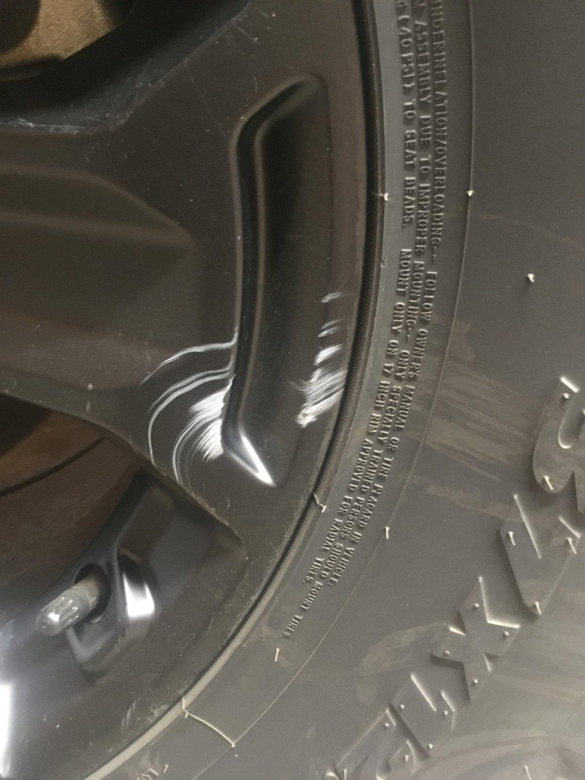

Thanks @Renegade . They look really sharp. How are they holding up so far?
Well, they do have a couple of rock scuffs, but those are to be expected considering what I do with them. I will eventually respray them with a coat of Krylon satin black. I am really pleased with the offset and general performance for the price. Given the opportunity (and same financial constraints) to do it again, I would make the same choice.

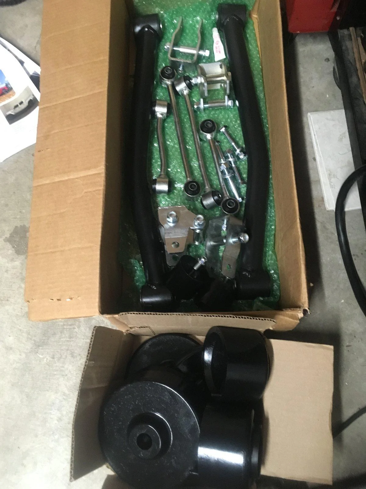

The kit arrived with .75” spacers, but a package with 1.5” spacers arrived a couple of days after the first. I believe they changed the kit to include the 1.5” spacers instead, but had shipped me an early kit. The kit also includes rear shock extensions which weren’t in the kit description, and they emailed me updated instructions which included the shock extensions.

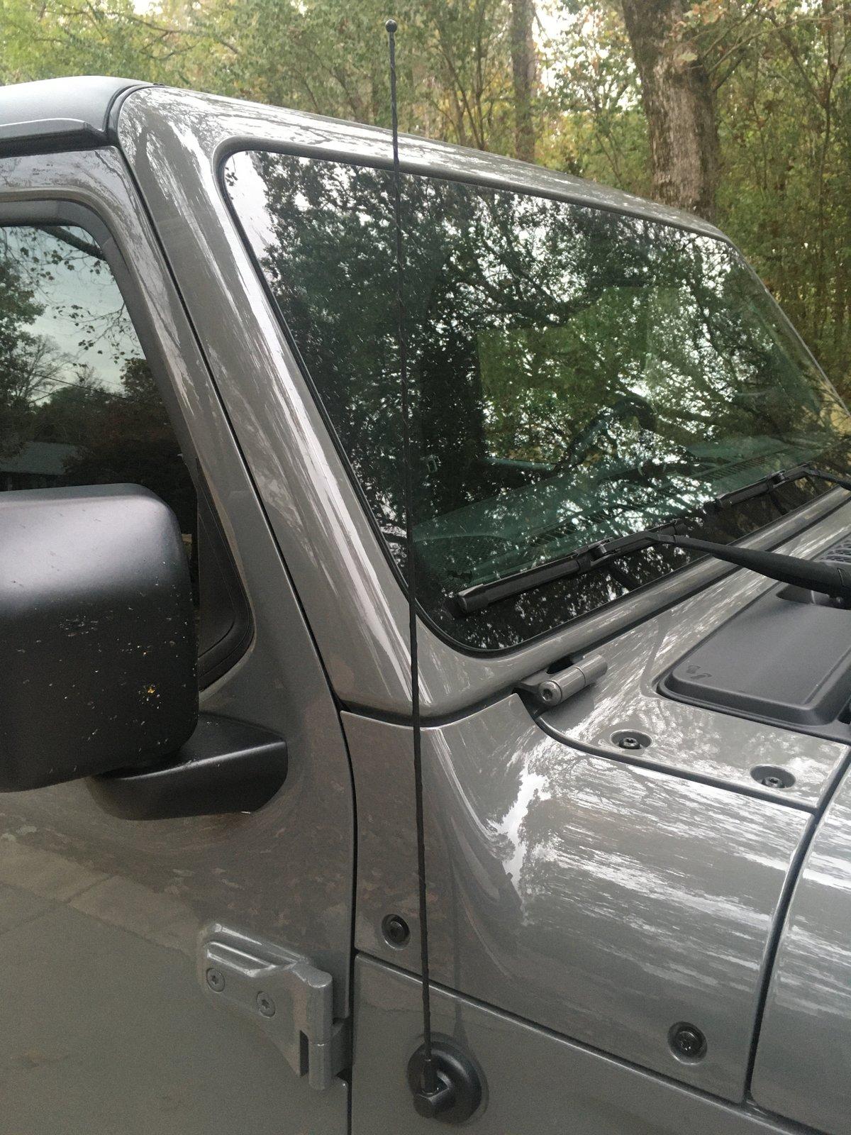

Here’s a really minor mod I did a few weeks ago. I probably wouldn’t have thought much about it had I not seen some post by others, but I replaced the really long silver factory radio antenna. I went with a 27” antenna from Antenna Source. It’s 27” long and black, so it matches the other accessories better. The 27” length still allows it to receive well, but is lower than the windshield frame, so it doesn’t hit my garage door opening. It was $30 on eBay.

I'm looking to buy this kit, do you have a good link you used? I have 37"s but 13.5 wide tires. Hoping it will work for me as well. Concerned about all the ones I find not listing the rear shock brackets, I also see a 3 star review on amazon with no context...
Also if it originally came with .75, and then 1.5's which did you use? just the 1.5's? Does it include spacers for the back?

https://www.suspensionconnection.com/kj09188bk-gladiator.html
It has 2” spacers for the front. I used the 1.5” rear spacers, leaving the .75” for a later purpose if needed.
I think this could definitely be a permanent solution if it meets all of your needs/desires. Forum member @smoverland and I were talking yesterday about how good of a deal it was considering what you are able to do with a JT and only a 2” spacer lift. I still plan to upgrade as funds allow, but this allows me to do pretty much everything I want to do with a daily driven Jeep.
