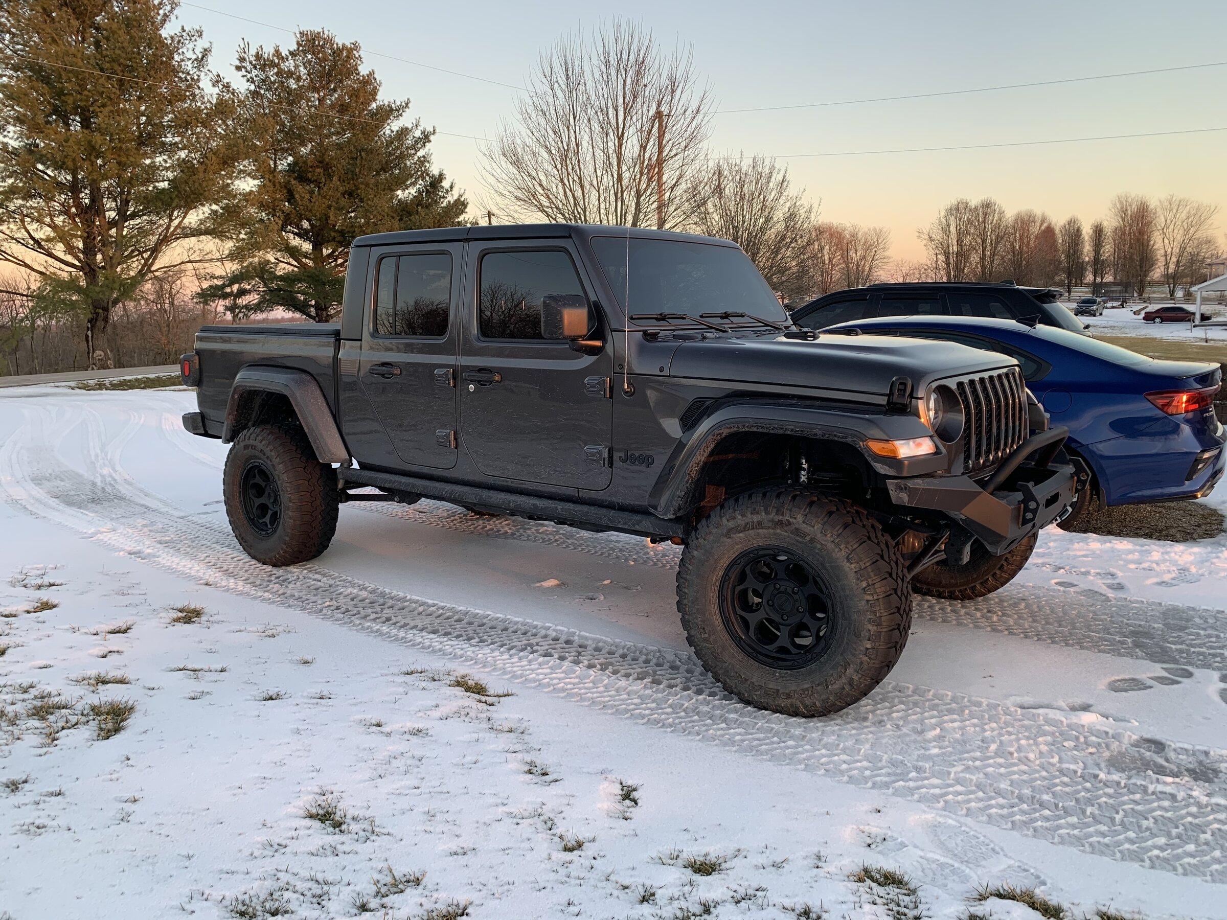

Running Metalcloak 3.5" Game Changer lift with 35's. Very happy with setup overall. Lot's of flex and great highway ride when slabbing to different locations. Still running factory 4:10 gears... may move to 37's but not without a gear change in the future. Not in a hurry as this setup has been great so far for my needs.
Jeep Gladiator Request: 35s with a Lift? IMG_4947
Approximately 10K with suspension change. She is fully loaded and heavy with all my gear...but ready to go and comfortable for me and the Mrs.

Are those the KMC Dirty Harry wheels? Either way I love, your rig looks great!
As a matter of fact they are! Combines two of my passions. And thank you!

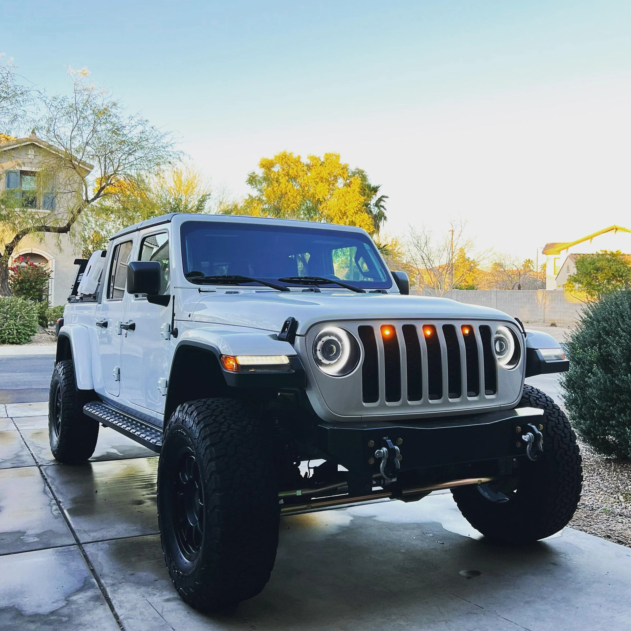

35” KO2’s and AEV 2” lift and Rubicon front springs and shocks all around.
I think 2” lift is good for 35s but starting around 2.5”+, the 35s start to look a little small, IMO.
Jeep Gladiator Request: 35s with a Lift? AC6AC2BA-1262-4B70-822C-3C29BB557DC3

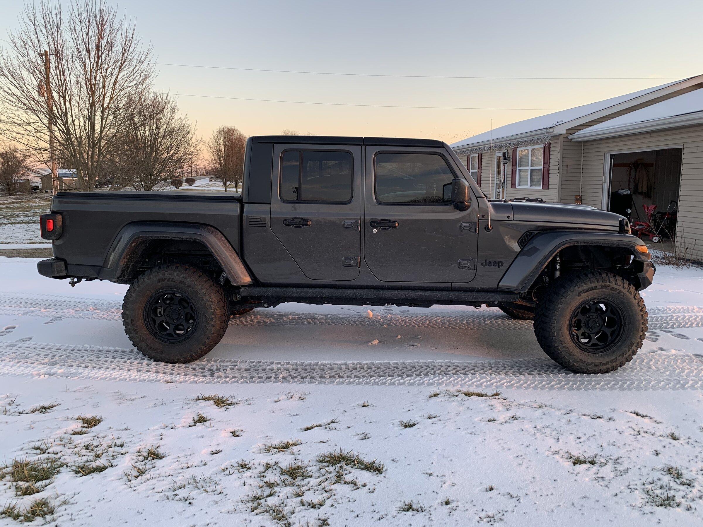

Jeep Gladiator Request: 35s with a Lift? A60D472F-BCFA-4C63-86C0-13E7A15D5368
Here’s a clean picture.
I agree, I think my tires look kind of small after the amount of actual lift I got from evo.
