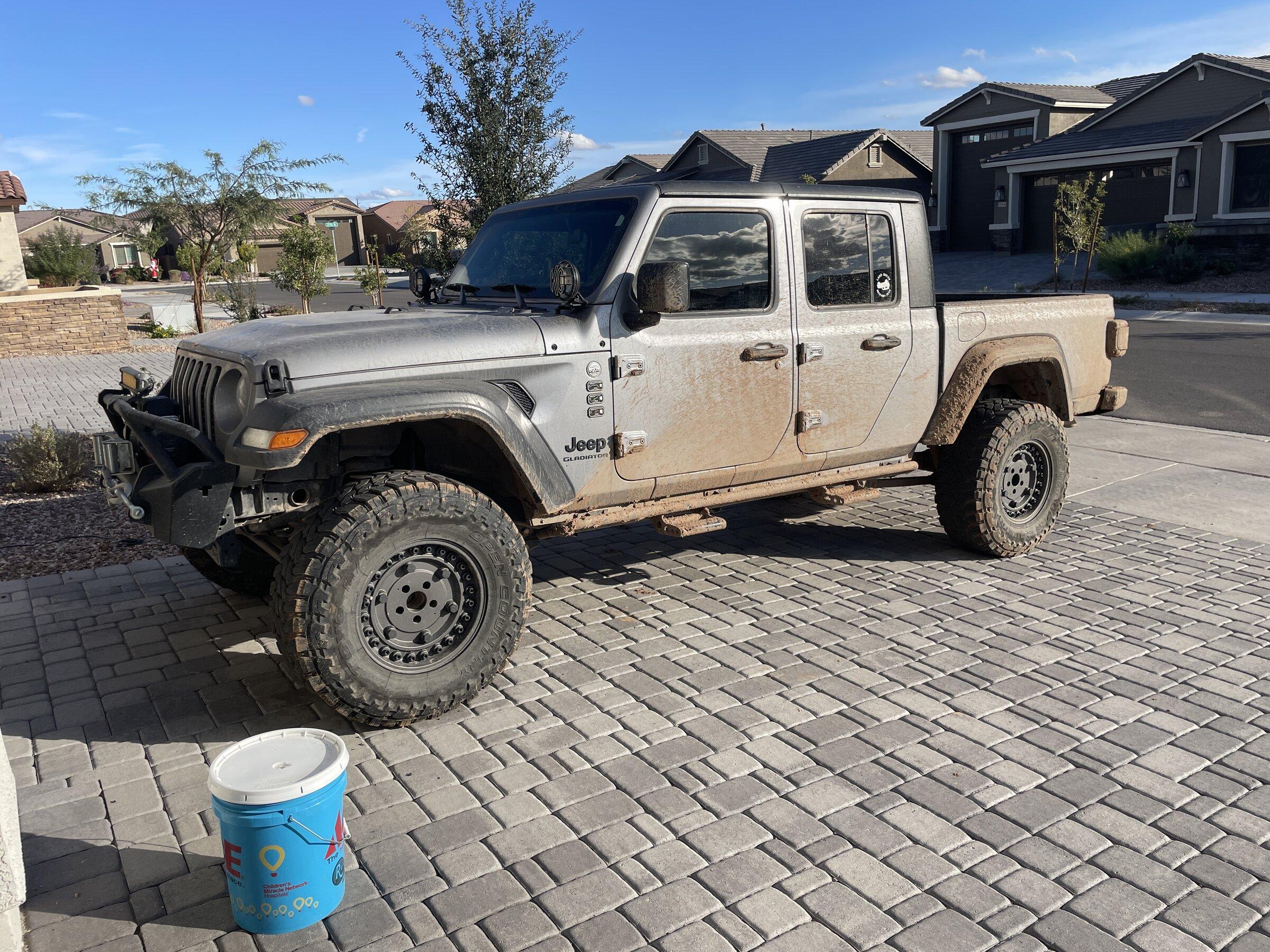

35s with a 2” Mopar lift. Tons of room

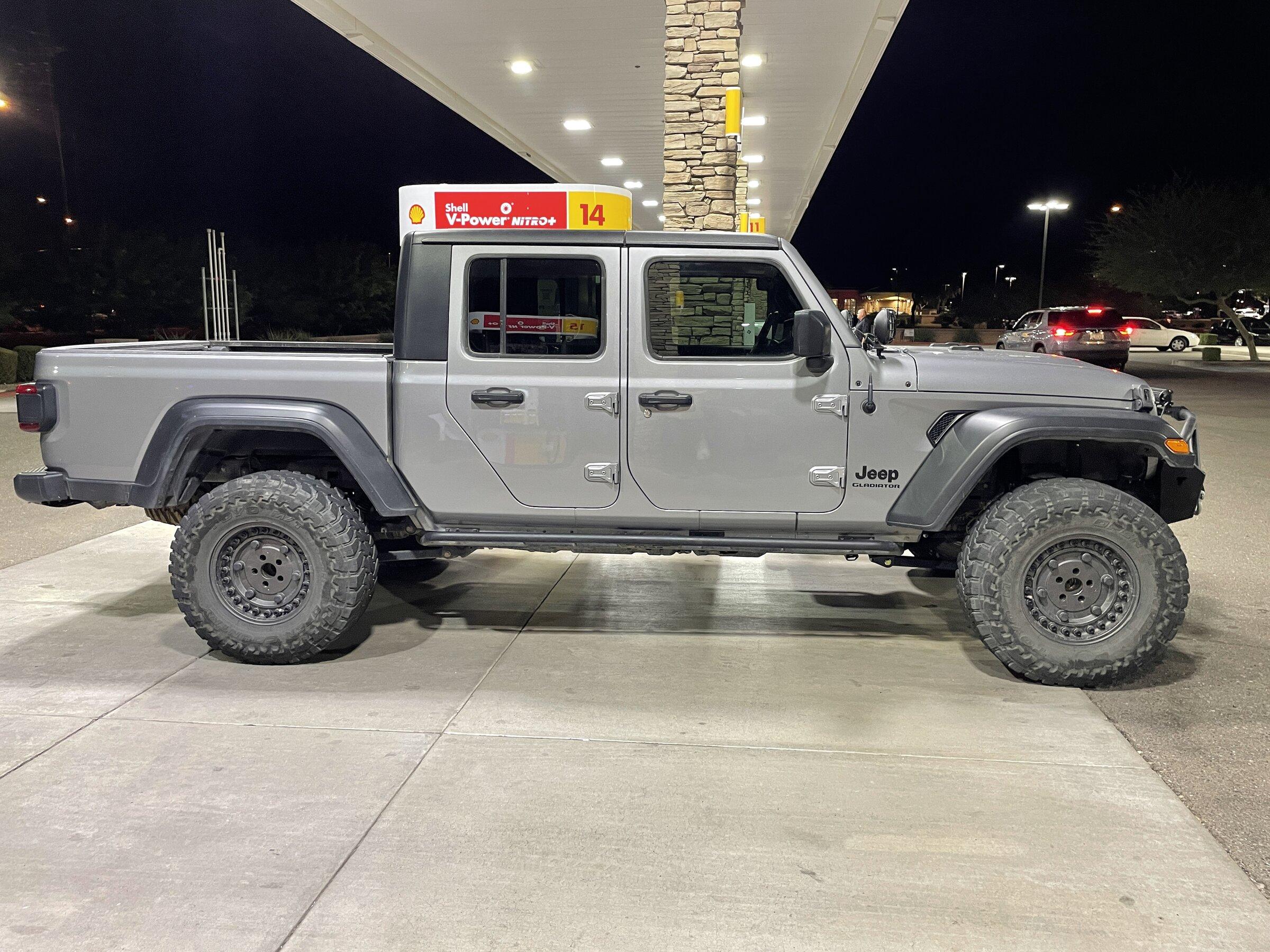

2" Mopar lift with just the 1" spacer up front and 35" BFG KO2's. Researched for a year before I pulled the trigger. Saw many other members with the same dimension setups (different brands) and really felt this was the "look" I wanted. Plus if I went with larger tires I knew I would feel the need to regear, and that was more than I wanted to get into. I also planned to plow (am doing so now) so I didn't want to get too high off the ground and screw up the plow push angle. This is my daily driver and although I want to offroad, I've not done any yet, so don't feel the need for crazy lifts and tires. Mileage has stayed the same, and the ride quality is very minimally affected (a bit more bouncy).
I friggin' love how my jeep looks!

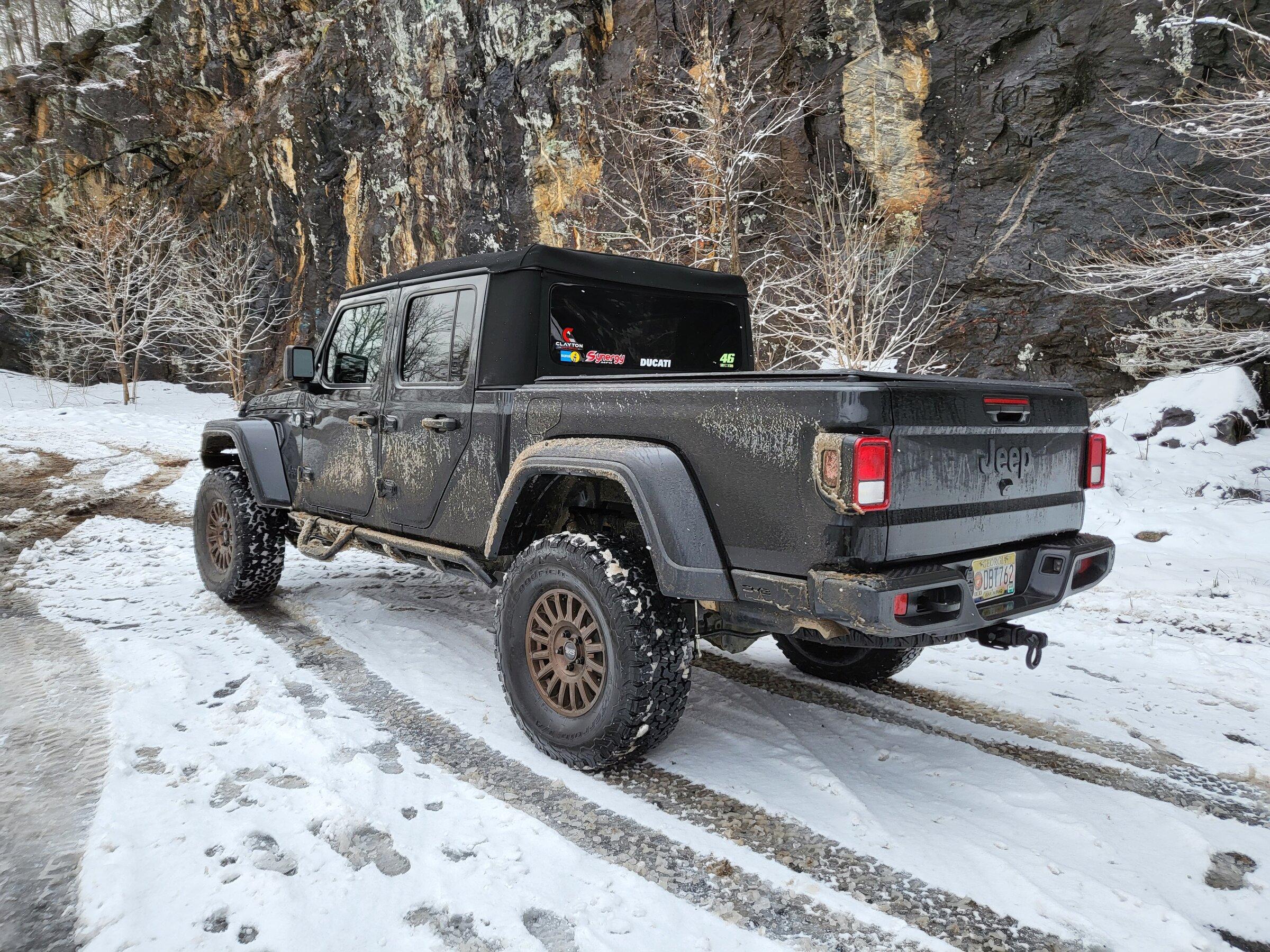

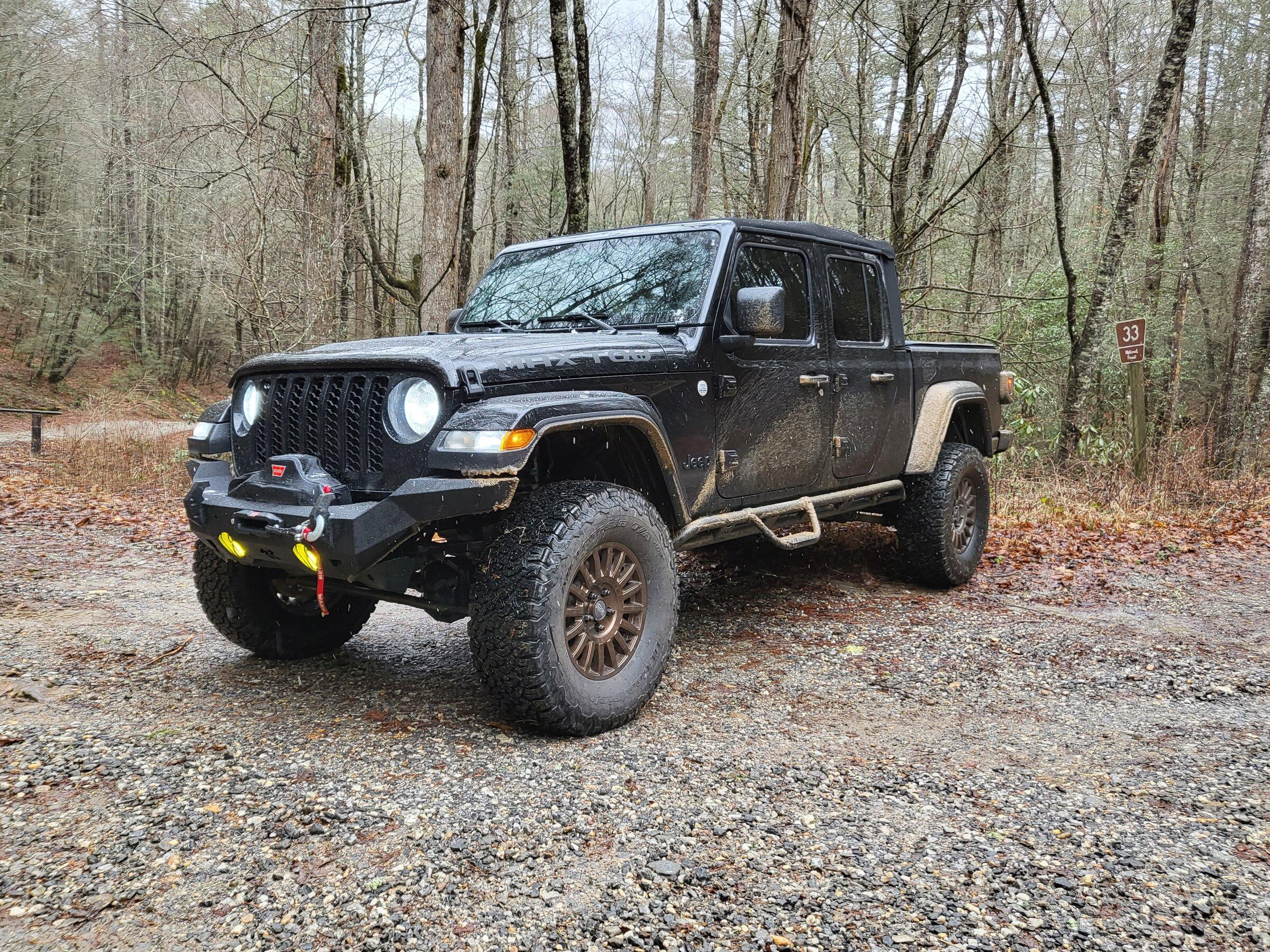

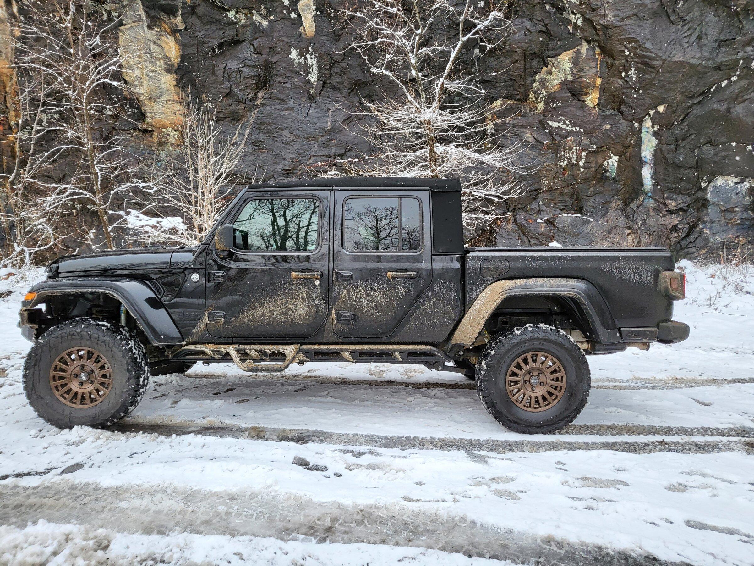

Clayon 2.5" Right Right + with Bilsteins, Mopar LCAs, JKS disconnects, and Synergy Mfg Steering, with 315/70/17 BFG KO2s.
I've been thinking of going with a 34x11 tire.
The new thing in the Jeep world is running 38 to 40" tires, which is great, but you better not be doing that on factory axles. I don't care about that one guy who has had 40s for 5 years without breaking anything. I don't believe it.
These Dana 44s are great axles, but 37s are the absolute limit. I highly recommend 35s as the safe limit.
Also 35s "should" have 4.56 gears to retain the factory ratio range, while 37s need 4.88s.
You can get away with 35s on 4.10s, but once you go 37s you really should regear.
I've had three lift kit versions on my Gladiator.
First was just a Teraflex leveling kit to keep the 35s from rubbing until I decided on a big boy lift.
Then I experimented with the Rubicon Launch Edition front springs, which gave me an inch and quarter in the front. I paired them with an one inch Teraflex spacer.
I went on my first legit, moderate to hard off-roading trip, and quickly realized that I needed more height for clearance and articulation. These Gladiators are long... with bad departure angles.
I'm really happy with the Clayton kit.
Buy once, cry once.

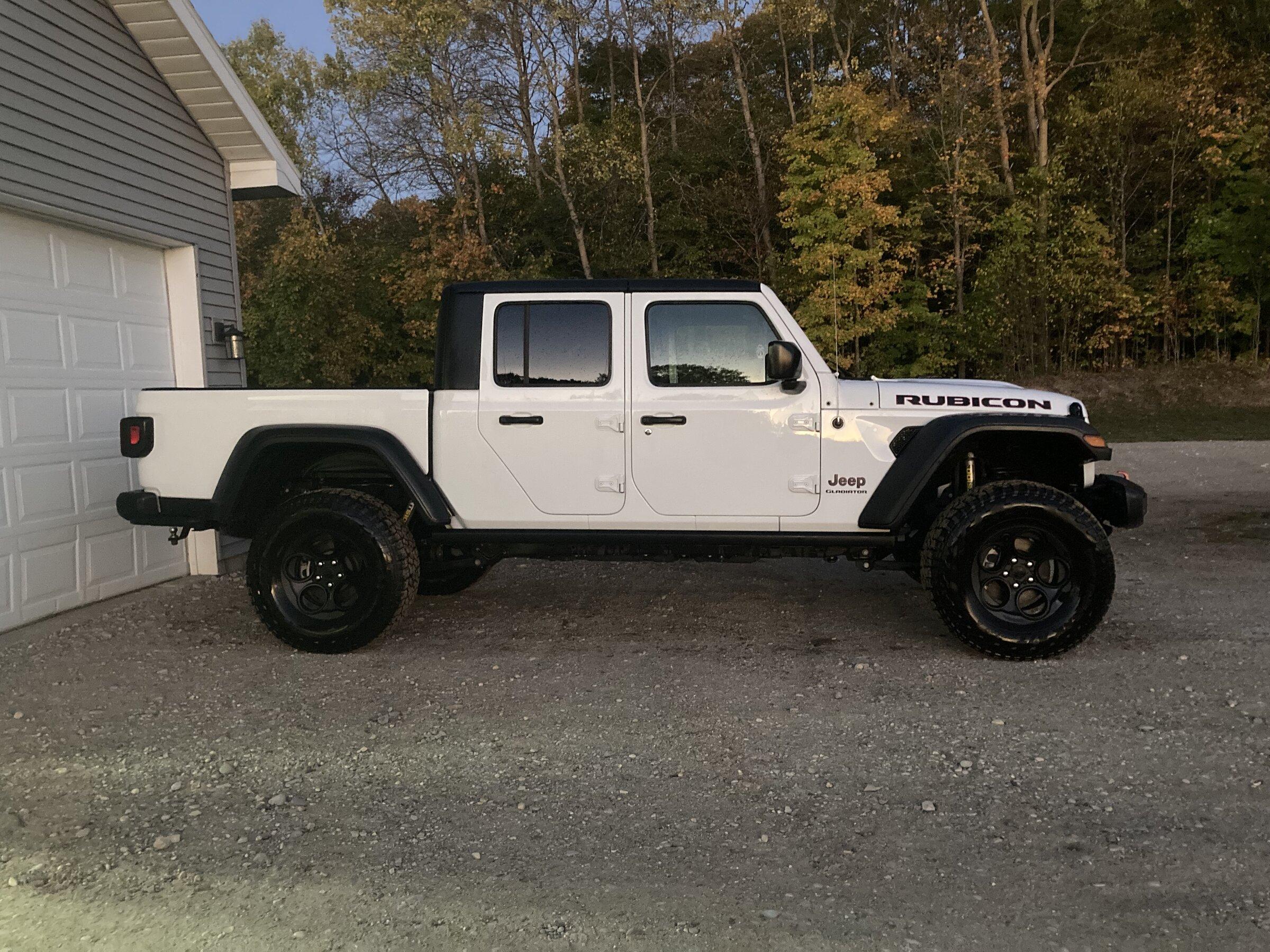

I ended up going with the AEV 2.5 lift and 35 Falken at3w’s. Wasn’t going to lift it at first and drove it stock with 35s for while. I didn’t care for the soft rubicon ride. I chose the AEV lift because of AEV’s reputation, and the triple rate springs since I do tow a fairly heavy boat. Super happy with it!
