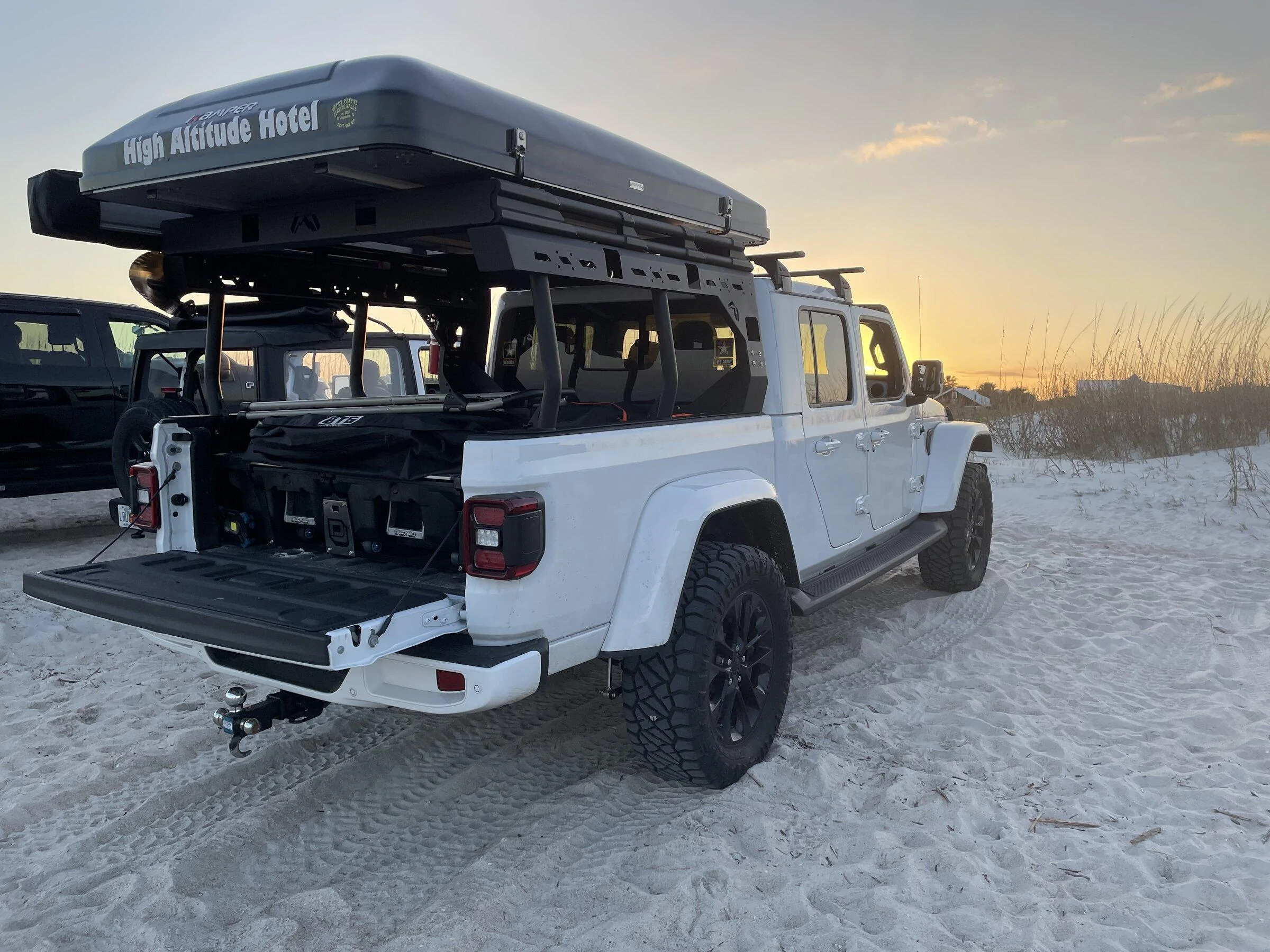

Nice setup. Do you know how much weight you're hauling?
The Fab Fours Overland rack weighs 200 lbs, the iKamper RTT is 130 lbs and the Decked drawer system is 200 lbs. So 530 lbs all together. I also have the Overland 270 awning that weighs 50 lbs.
So almost 600 before passengers, gear, and extra fuel tank? Is that tank going to put you over the payload?

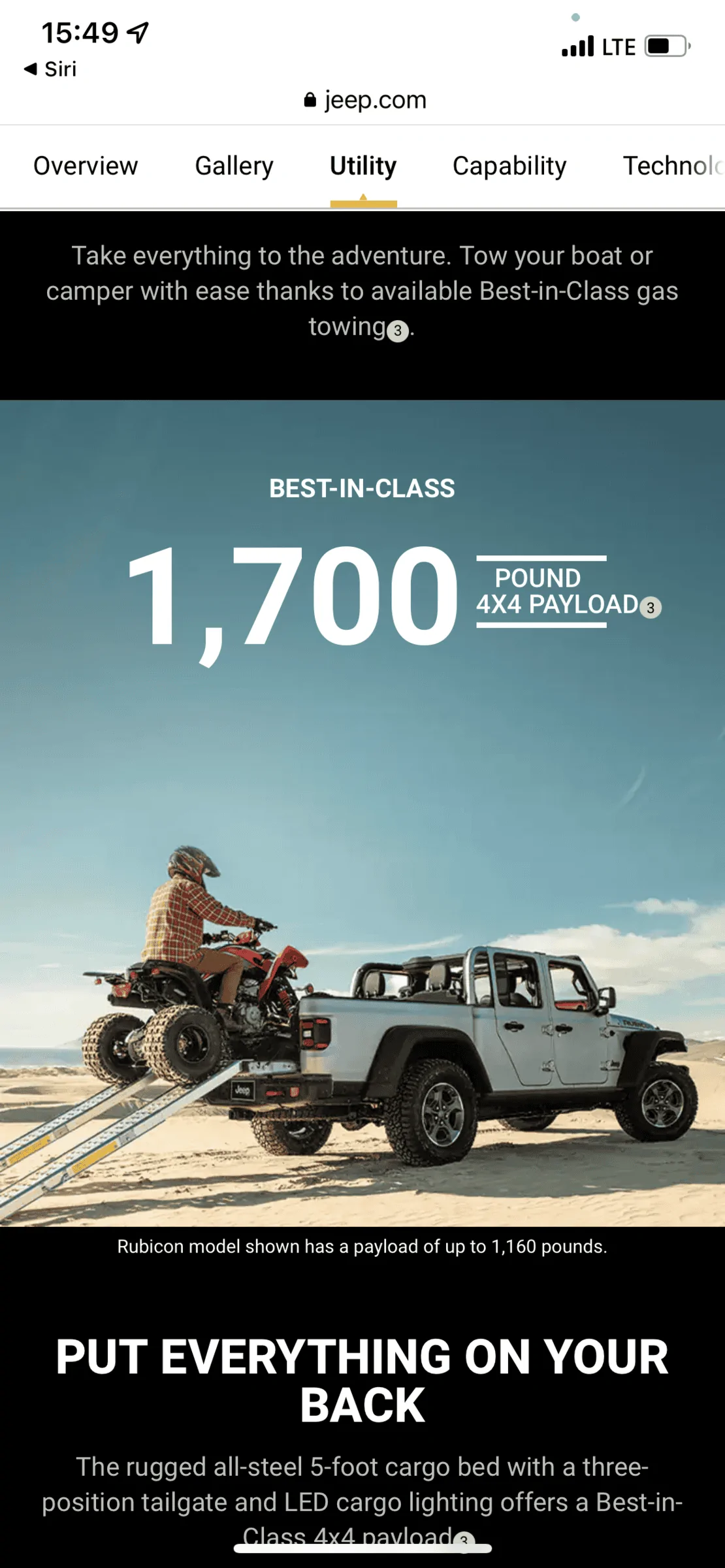

1700 lbs according to Jeep

It’s what Jeep advertising says!

Lol that's advertisment for ya. That's the payload of a manual sport S.
Just like they say it can tow up to 7500 pounds, that's a specific gladiator trim with the right options
Every jeep is different. You need to check the side of your driver side door for the payload. I've seen gladiators with a 900ish lb payload because of how it's Spec'd.
Just trying to help man, you don't want to overload your new rig.

Yes, according to my door, it’s 967 lbs. I’m well within the limits most of the time.
