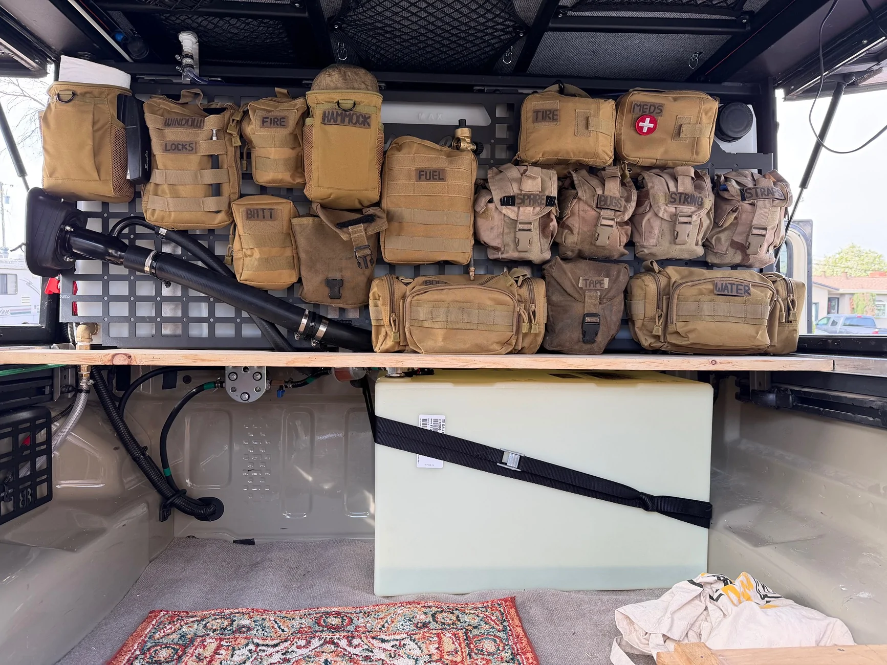

My diesel install with a 20 gal Moeller marine fuel tank:
Jeep Gladiator Diesel: Aux Tank or Larger Fuel tank IMG_0777
I’ve got a transfer pump under there (Carter 4070) but it usually gravity feeds just fine without it
That’s pretty much exactly how I was imagining it. Maybe without so many pouches but pretty similar. That’s a butt ton of pouches!!!! :CWL:

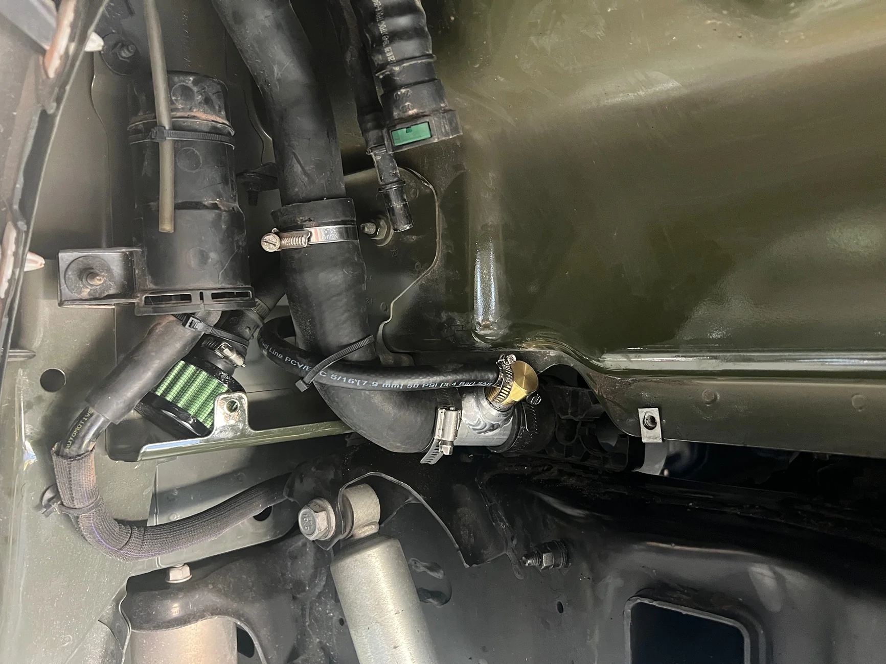

Do you have the tank vented?
Yes - the plumbing ended up being a little complex. There’s the 1.5” fill hose from filler neck to tank (biggest one visible in the pic), 3/4” air relief from tank to secondary pipe on the filler neck (to rapidly vent air from the tank when filling), then 5/16” hose from a T-fitting on the 3/4” vent that goes to another T-fitting inline with the factory tank vent (to relieve pressure changes over time).
