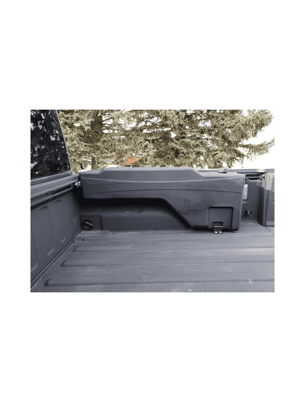

I plan on using a Titan Sidekick:
Jeep Gladiator Diesel: Aux Tank or Larger Fuel tank 1651634888790
And then using a valve tapped on the bottom of the tank, then running a gravity line to the OEM filler neck with a "T". I will also have a "T" near the Titan tank to tap diesel for my diesel heater. What could go wrong?
