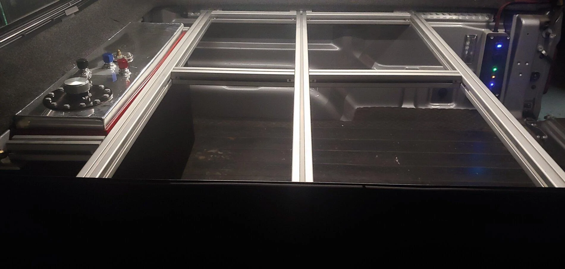

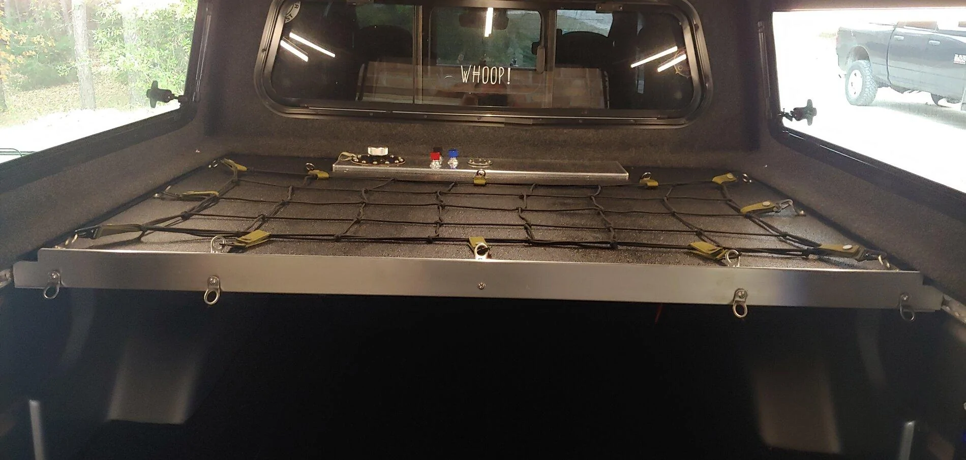

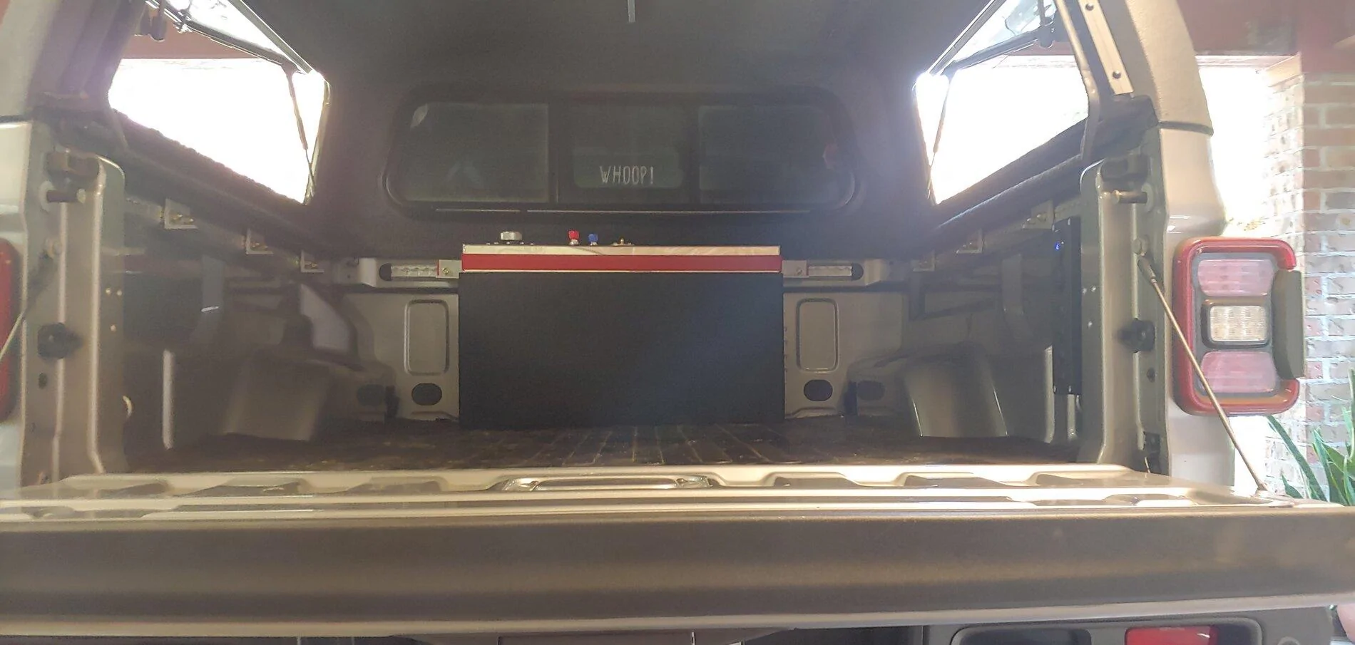

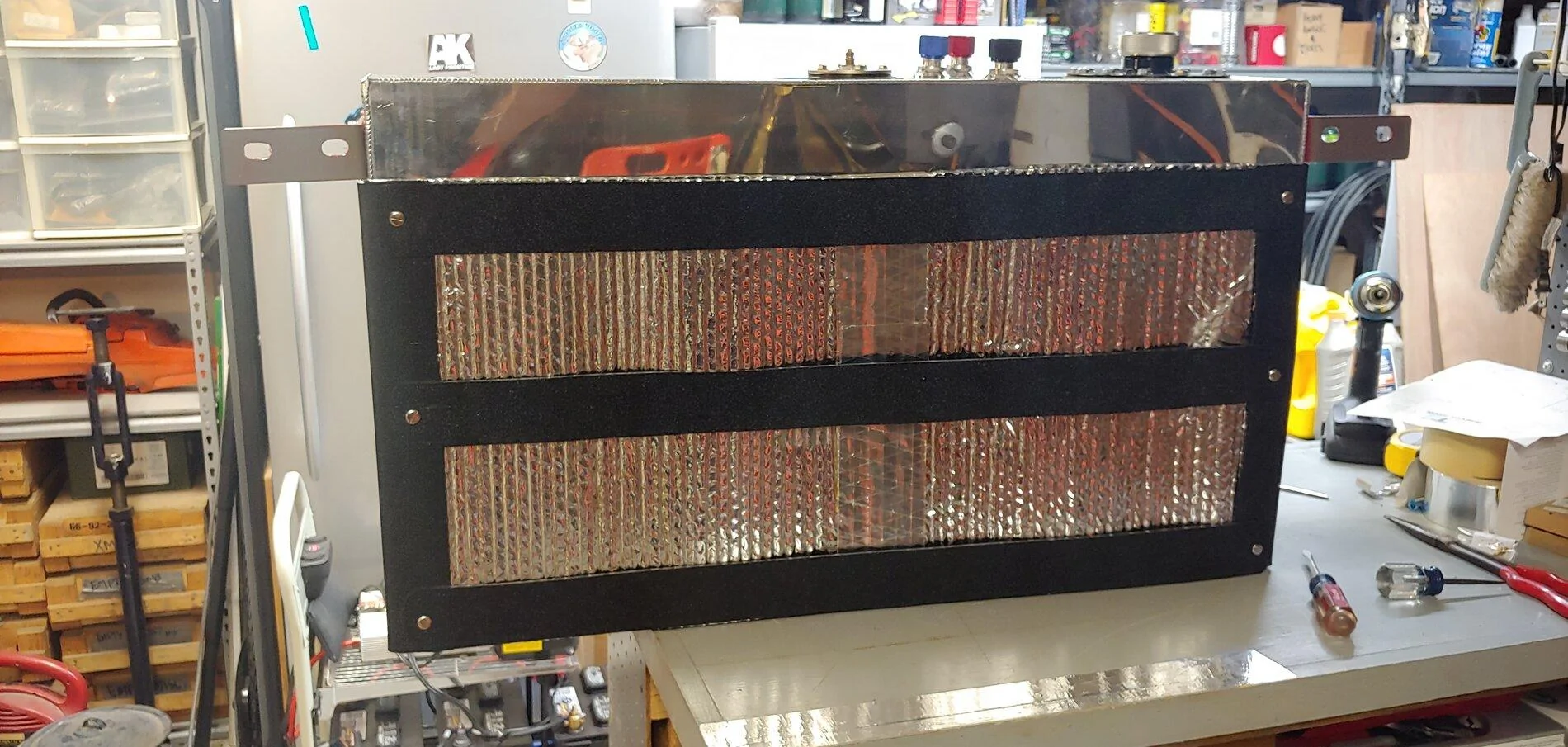

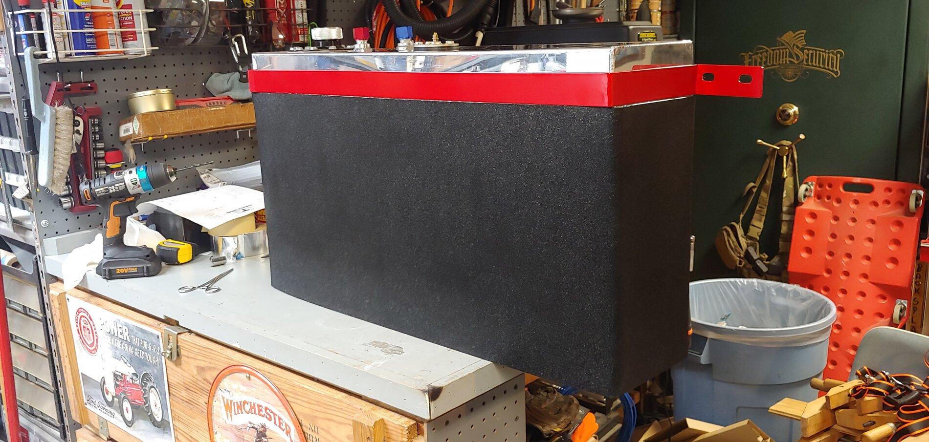

it is a welded aluminum tank, 17 gallons , DOT is not concerned with anything under 20 gallons. You can find them on ebay listed as "racing fuel cells" I wrapped it in reflectix insulation, armored it with .125" Kydex, and strapped it to L Track rail with 1.5"x .125" mild steel strapping. It has a roll over valve that is vented to a home brewed charcoal canister, with is vented out of the bed using a draft/venturi tube.
I've posted some pictures here before I "upgraded" to 5G which crippled my ability to share pics. I try not to harbor malice but I hope the Verizon engineers finger punches through the toilet paper every time he wipes his ass for the rest of his life.
