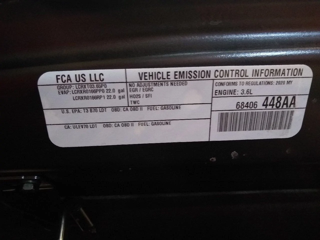

I’m still trying to figure out how the tank is 22 gallons... my fuel range went down to 11 miles and when I filled up, all I got was 18.5 gallons in the tank. The fuel I had must have been .5 gallon, which makes the tank 19 gallons. Does the low fuel indicate range until you hit the reserve tank or empty?
