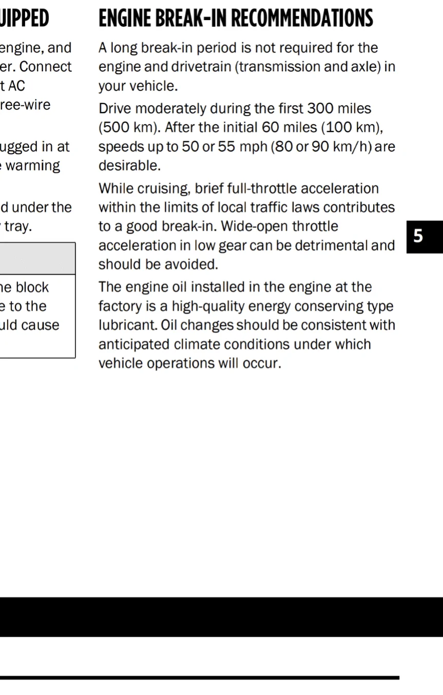

The manual says stay (p.158) below 55 for the first 60 miles:
So, how fast do you drive for the first 60 miles - 10 mph, 20, 30, 40, 50 or? Or does it say for the first 60 miles under 55, and after that stay under 140?
So we all should get bitchen gas mileage for the first 300 miles or 60 miles whatever it's saying, then it's down to 16 mph! I haven't received by JTR yet, so I have some time to unravel the poorly written sentences on page 158 (and elsewhere). Geez.

Yeah I drove that speed for the first 300 miles, since that’s what’s desirable. I drove 55 MPH for 400 miles never exceeding that actually until I went over 400 miles. I averaged about 29.5 MPG

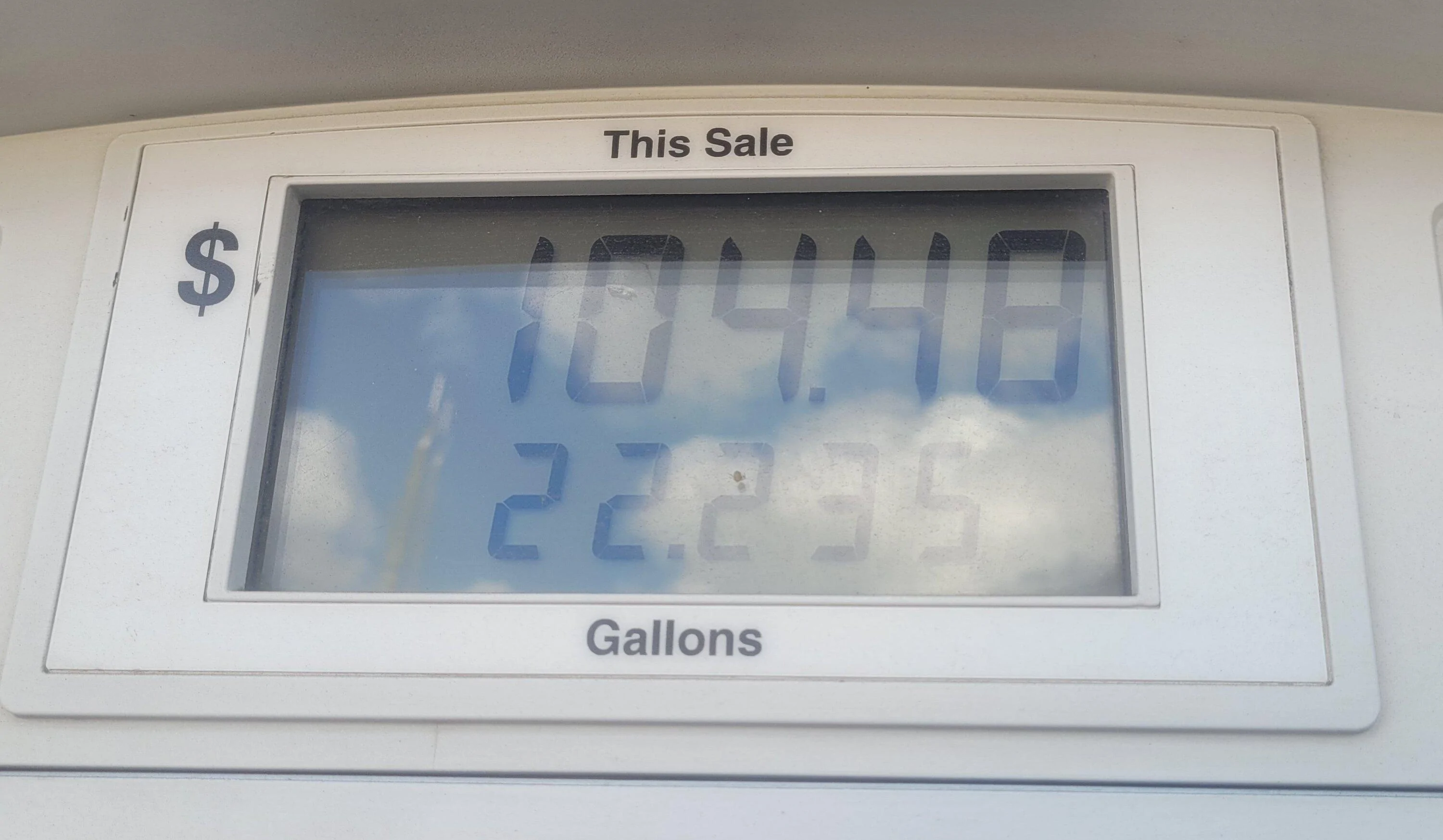

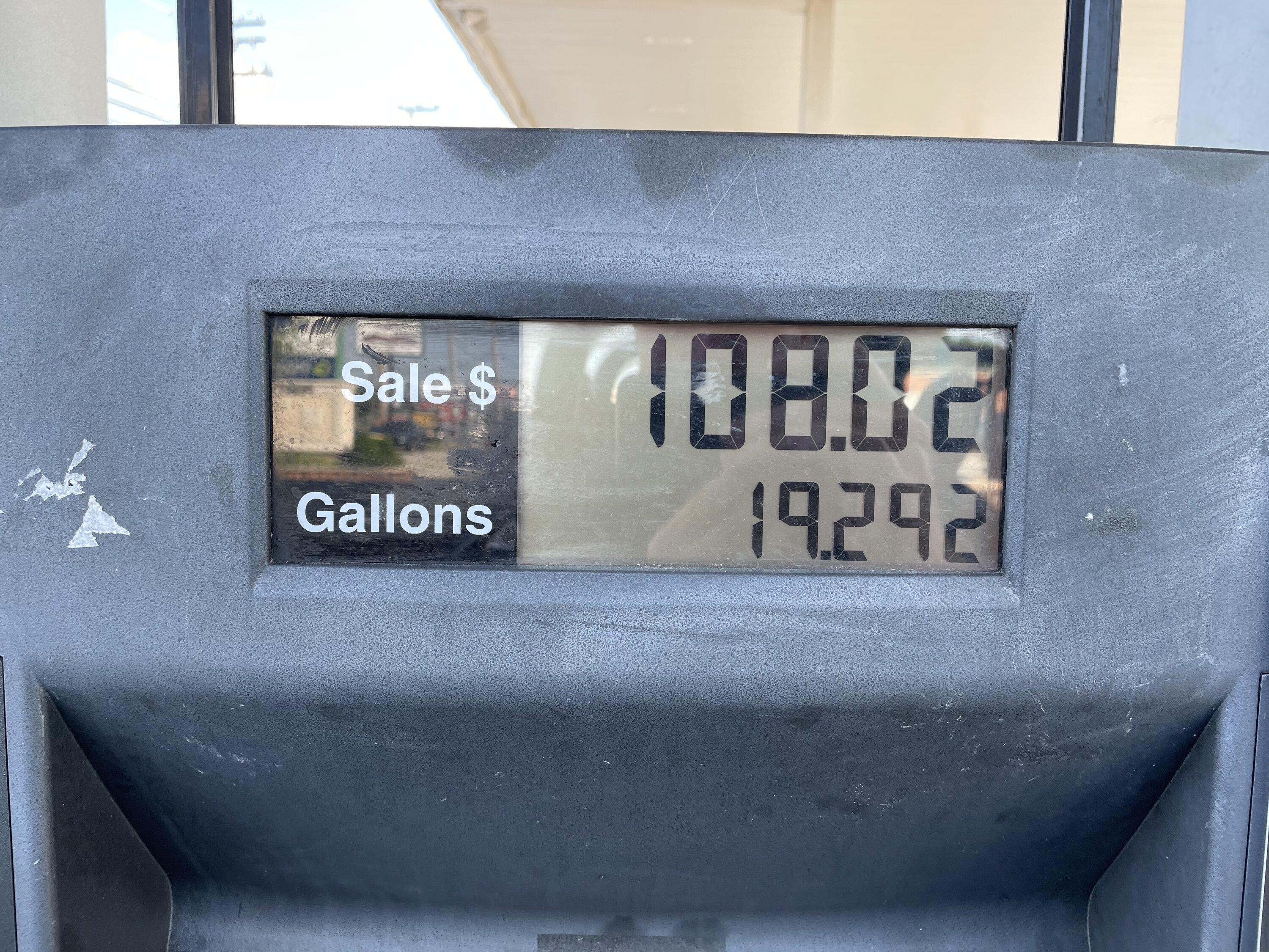

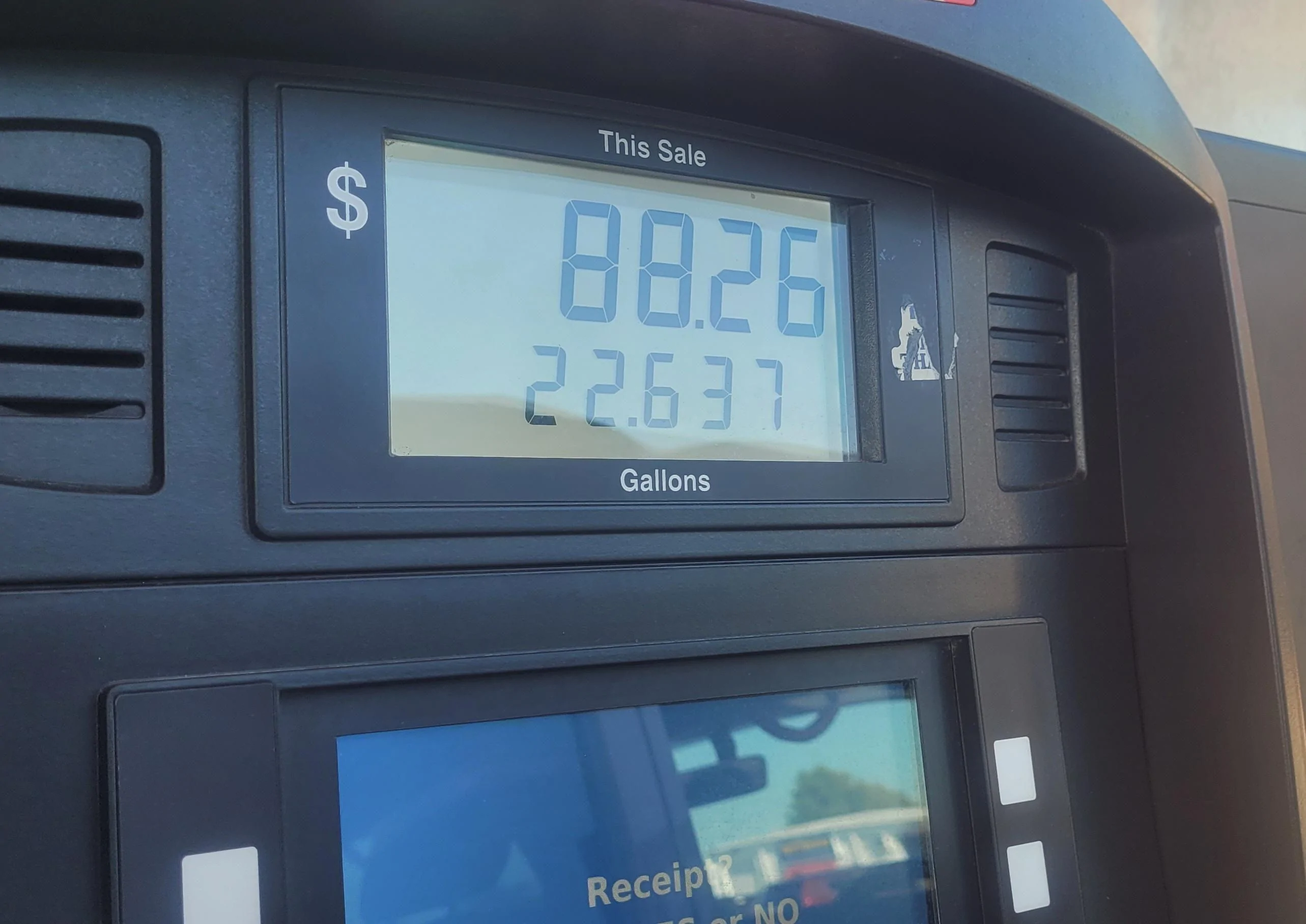

Yesterday on the way home from work, I ran it as low as I basically could to see how much I could get in it. It went from 10 miles of range to LOW for about 5 minutes before I pulled into Speedway and filled it up before it auto shut off. I got 19.848 gallons.

Next time you fill-up, pull the nozzle part way out and keep filling, as slow as possible. Wait a couple seconds each time the pump kicks off and resume filling. Sounds crazy, but if you are slow and very careful to not overfill, I bet you can get at least 2 addtional gallons in your tank. I've tested my theory at dozens of fill-ups at different gas stations in 6 different states, removing all blame on the gas or the pump. I'm able to add 2 to 3+ gallons of gas after the pump kicks off the 1st time. I've topped 22 gal after the burble has kicked the pump off under 20 gallons and range below 20 miles. I hear that this practice is bad for the evaporator or something so I've done it only in the middle of a long trek, knowing I'm stopping again for gas. Can anyone confirm if there's a legit risk to my baby or is it an environmentalists' story for preventing spillage?
And your dealer shop will love you - flooding the canister...............
There is a very real risk trying to prove how much you can get into that tank. Read back a year or two.
It's a real risk. People have had to have things replaced after trying to prove others wrong.
Topping off for over 22 gallons is really risky, and really not smart, depending on circumstances. Gasoline expands in heat. If you fill it and top off and get 22 in it and the outside temperature is upper 80s or better, when the fuel expands it will have to go somewhere.
We aren't talking "spills" - we're talking flooded equipment.
