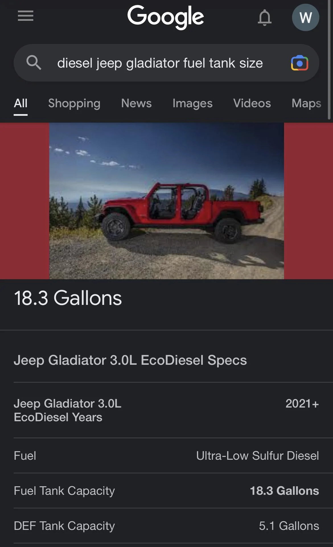

No way you’re putting that much fu
In a diesel Gladiator
(also, who hurt you? Why record that information? I don’t even know what I had for dinner last night… lol)
Mine's a gas-burner, not a diesel.
No one hurt me, it's just something I track on my own because I was curious. I log the info on my iPhone before pulling away from the pump, so it takes a few seconds. Plus, Missouri announced a program where you can get a refund of the gas tax increase they implemented last year (which increases each subsequent year) if you have receipts for your purchases. They were probably guessing few people will take the time to record and submit for the refund. Challenge accepted.

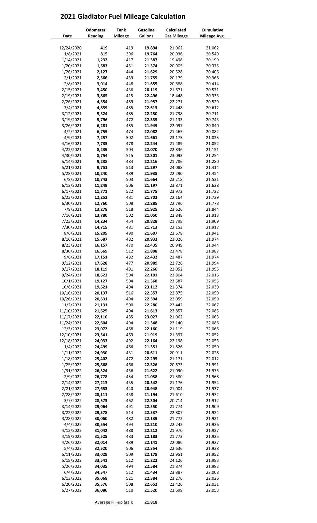

It's definitely possible to add more than 22 gallons. I've logged every fill-up since new.
Is that an app or just a chart you designed on your own? Thanks
What's shown is just a simple Excel spreadsheet, nothing fancy. I also track (but didn't print out) which fuel station, as it's become apparent that some have better fuel than others.
The mileage at fill-up and gallons added are kept in my iPhone in a Notes page. When I have time later on, that info is added to the spreadsheet.

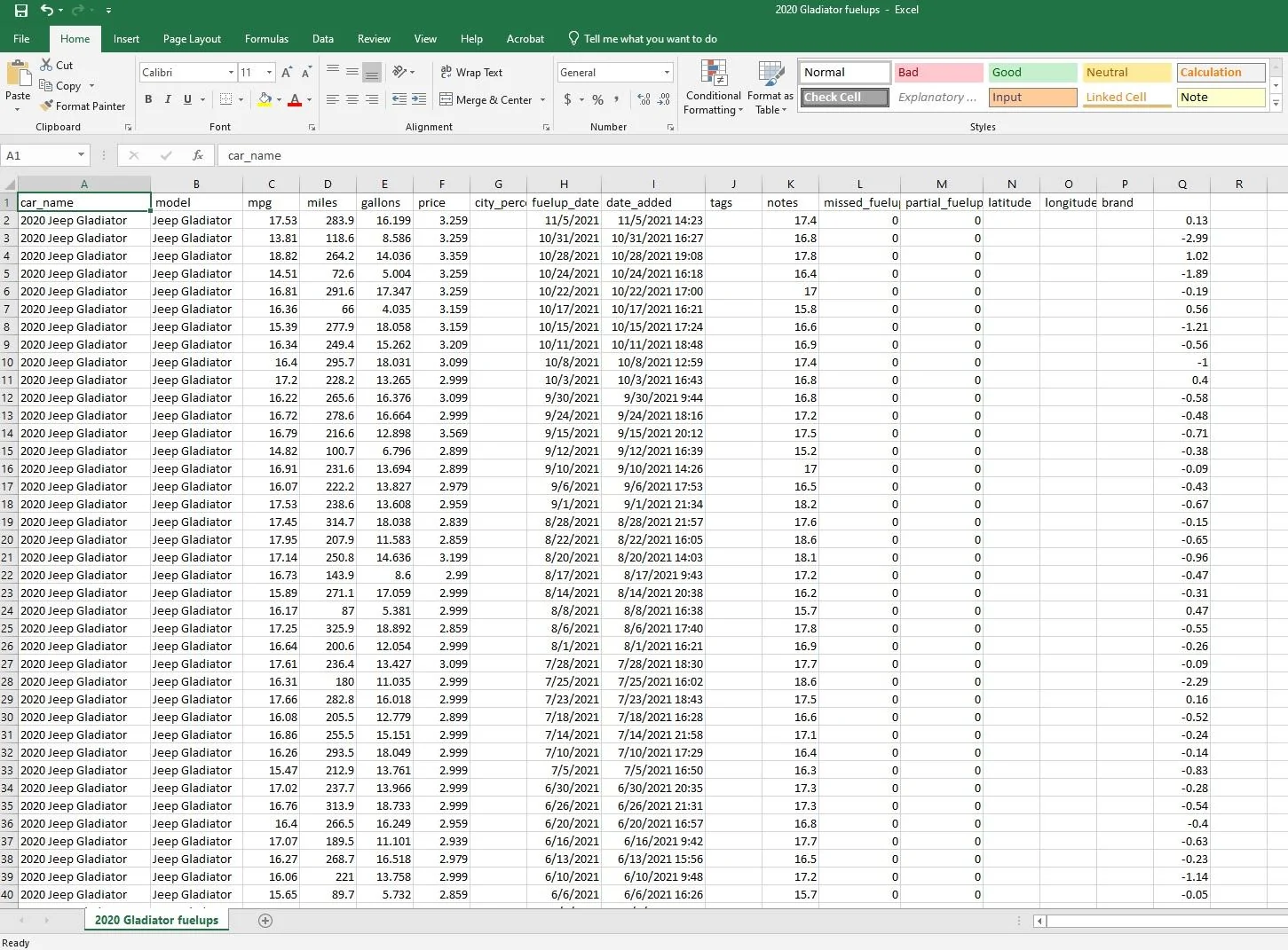

I use the Fuelly app to track mine. That data can be ported to a CSV file and then extrapolated in an Excel based spreadsheet.
As to being hurt, well that can be subjective.
Jeep Gladiator Max fuel capacity Fuel U

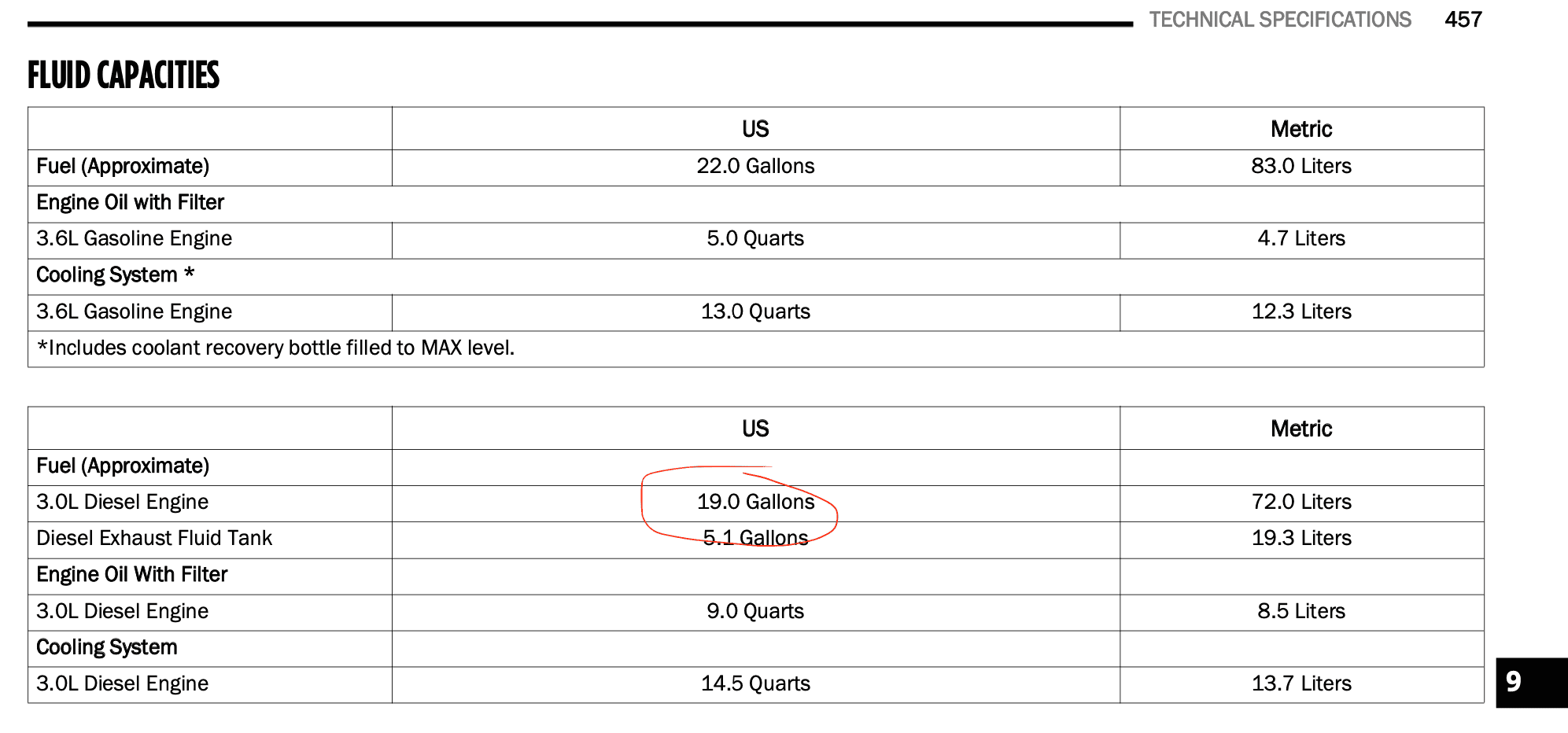

My truck is diesel, fuel tank capacity is 18.3 gallons to give some room for the DEF, It shouldn’t be able to get an additional gallon in there, especially since I probably had a gallon in there still
Clipped from the manual:
Jeep Gladiator Max fuel capacity Screen Shot 2022-07-04 at 1.17.18 PM
