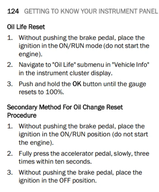

how do you reset if doing your own oil change? thanks
40,514
54,041
Do you have an owners manual? If so, it's in there. If not, download the PDF version - it's in there, too.
Almost every such setting or display question is in there.
much obliged. did not know that
