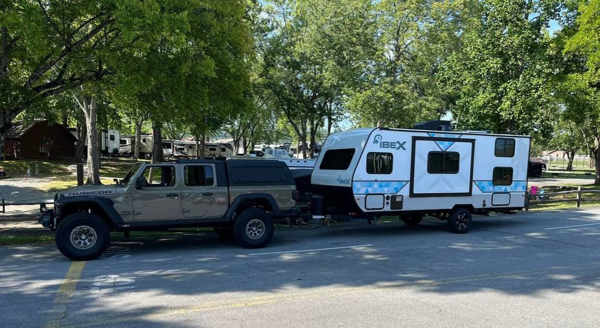

We are going to Colorado and Utah from Tampa Florida in September. We may bring our camper that has an off-road suspension. It’s a 2023 Ibex 19QBH. The gladiator is on 38’s with 5:13 gears and a Magnuson supercharger. My question is has anyone driven from Montros Co to Moab Utah pulling a camper? Thoughts?

I would not take a trailer of that length. There are some tight turns.

I have done the Rimrocker from Montrose to Moab, and you cannot pull a trailer on that route. The first 40 miles out of Montrose are mostly forrest roads but after Nucla (I think that is the town) it would be impossible to pull a trailer.

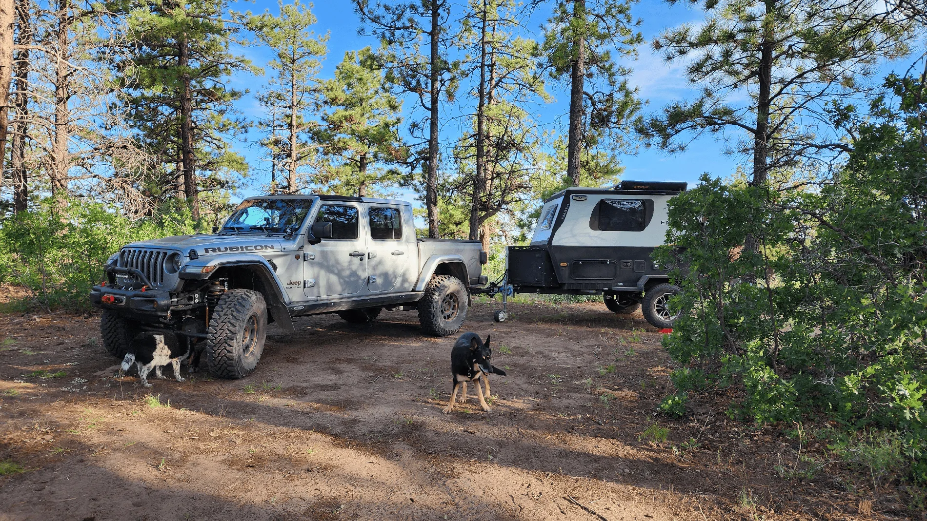

I did the RimRocker last summer pulling a trailer, but not one of that size... my JT has a supercharger, lol.
The JT could do it, that trailer is not going to make it without damage if the intent is to do it all without breaking off. My previous trailer was the size of your rig.
Just my thoughts:
  • Montrose to Nucla is doable for that rig.
  • Everything between Nucla and the 141 crossover is rough and tight, especially coming down to 141. You won't make it towing that.
  • 141 to Buckeye is not as rough, but still on the tight side and you're going to spend a lot of time navigating ledges. If you do it, you'll want to stick to the main trail.
  • Buckeye to Moab is doable.
Hope this helps.
