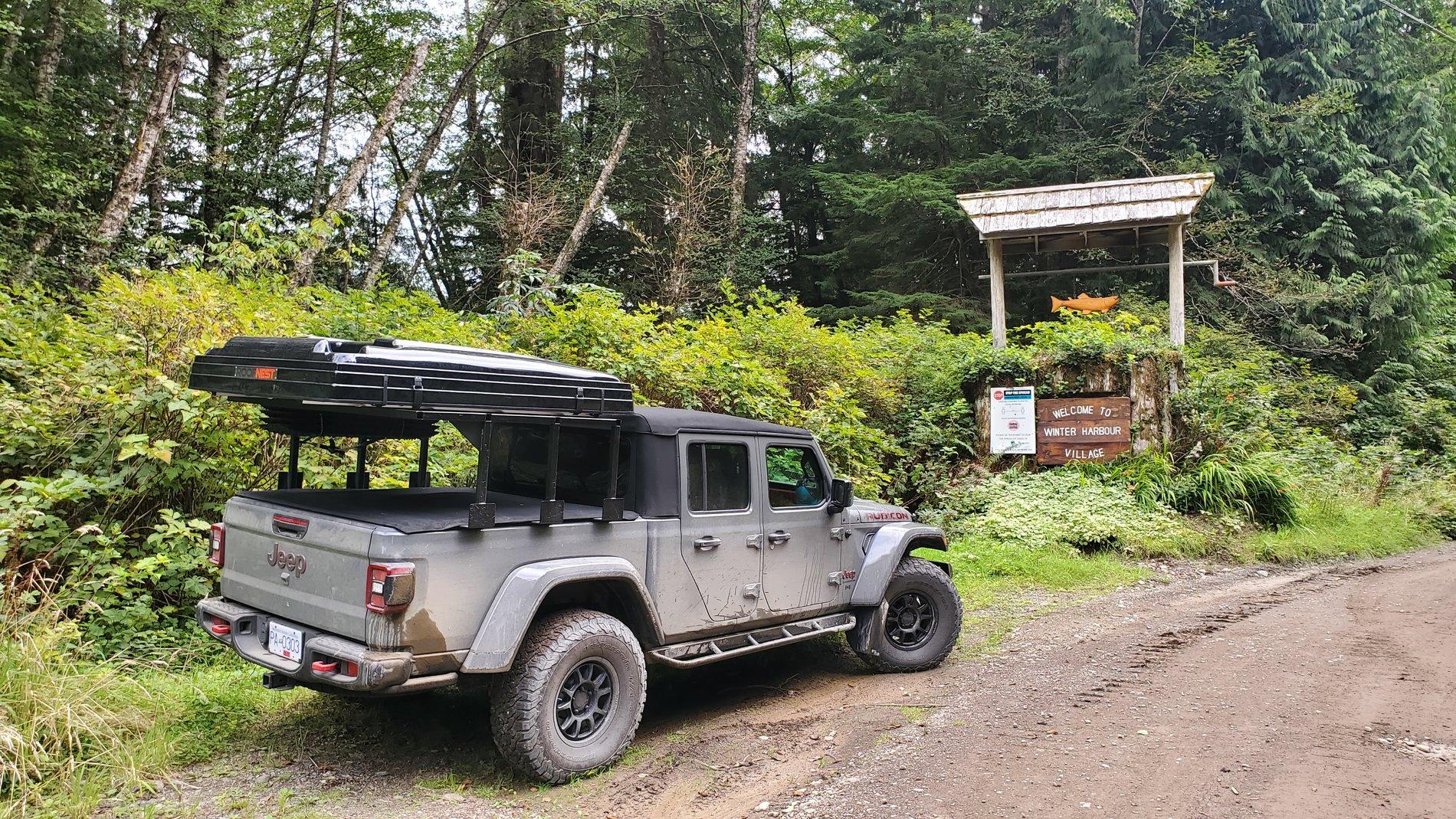

It’s Finally starting to cool down enough in Texas to mount the Ikamper Mini and do a little camping

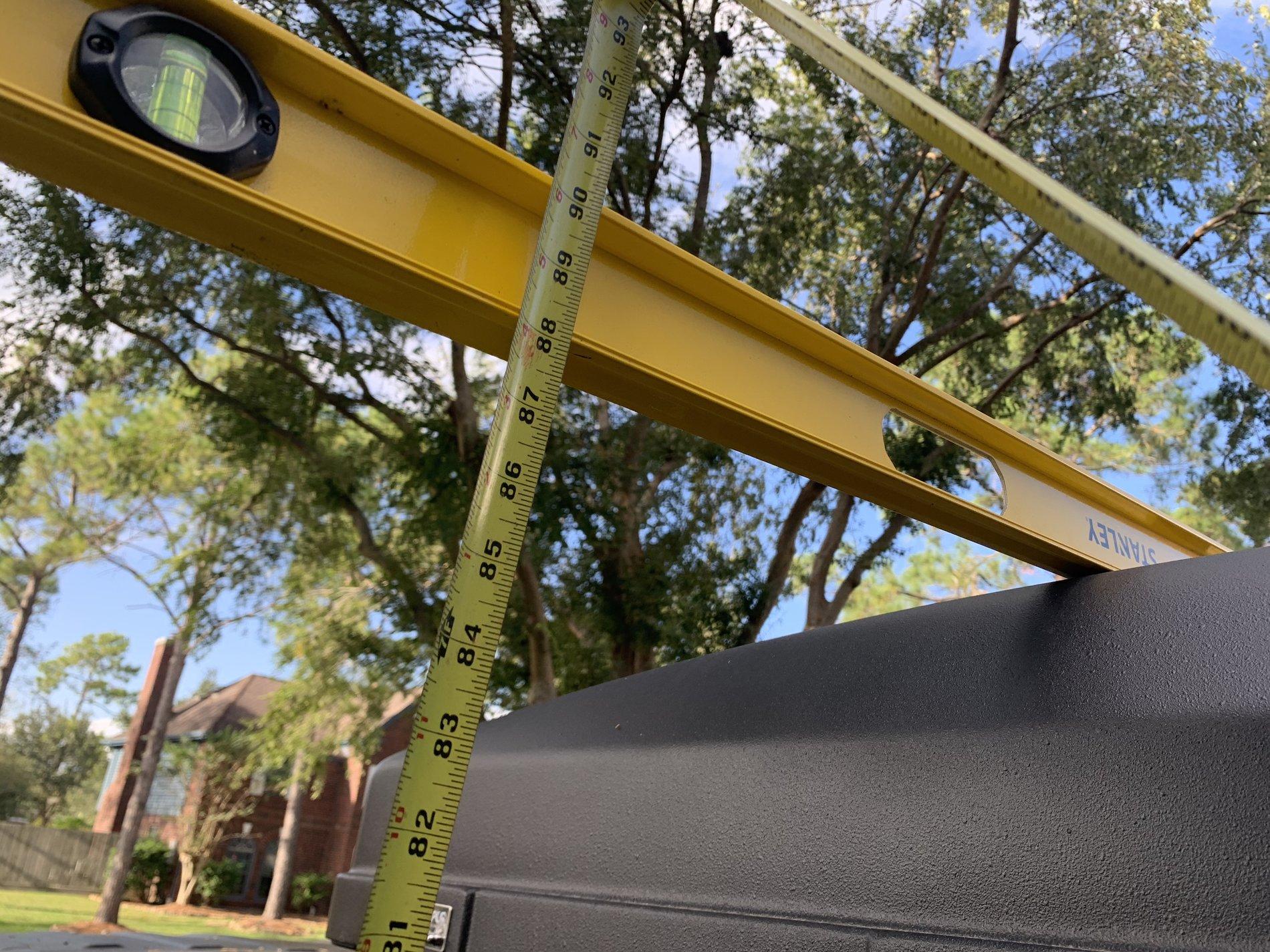

Just got myself an Ikamper mini and they have an RLD available too. Yours looks great! I got the mini cause i thought I'd be putting the tent below the cab level..but this set up looks nice..whats the total height you have from ground to top? 85"? Hows the weight? New suspension necessary? added the airbags 1000? you put any cupboards in? thanks!

I have the same set up, took the tent down for the winter so can't get the height, but I did put in the AirLift 1000 airbags, and added the adjustable Falcon shocks - work great as my rear load changes dramatically when I go from full camping to no tent / no gear I can adjust the airbags and shocks.

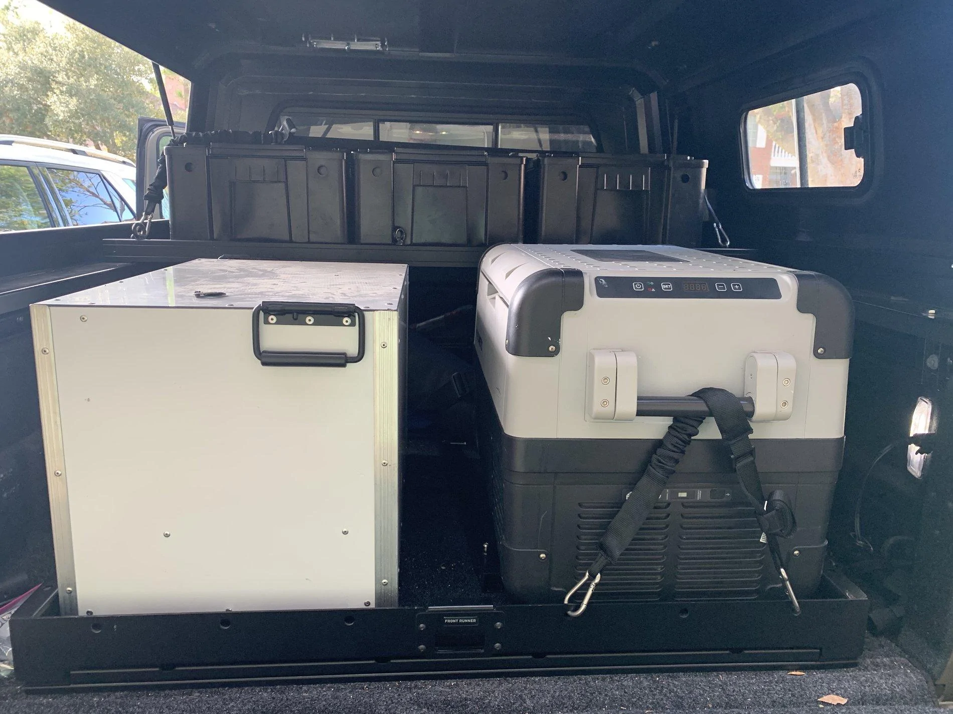

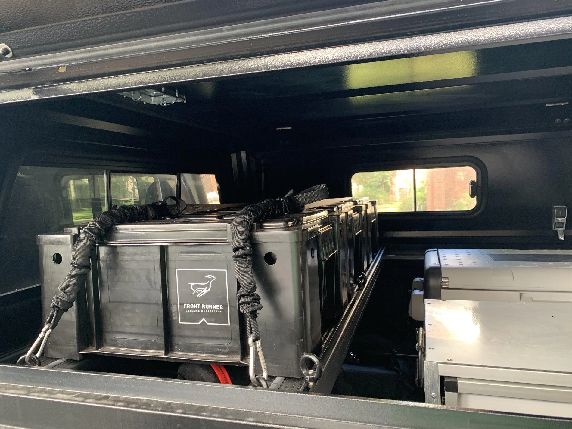

I love the RLD !!! I'll measure the height when I get home, I do have a 2 1/2" EVO lift on it, went down about 1" in the rear. I have a shelf in the front half of the canopy and a bed slide. I'll take some pics

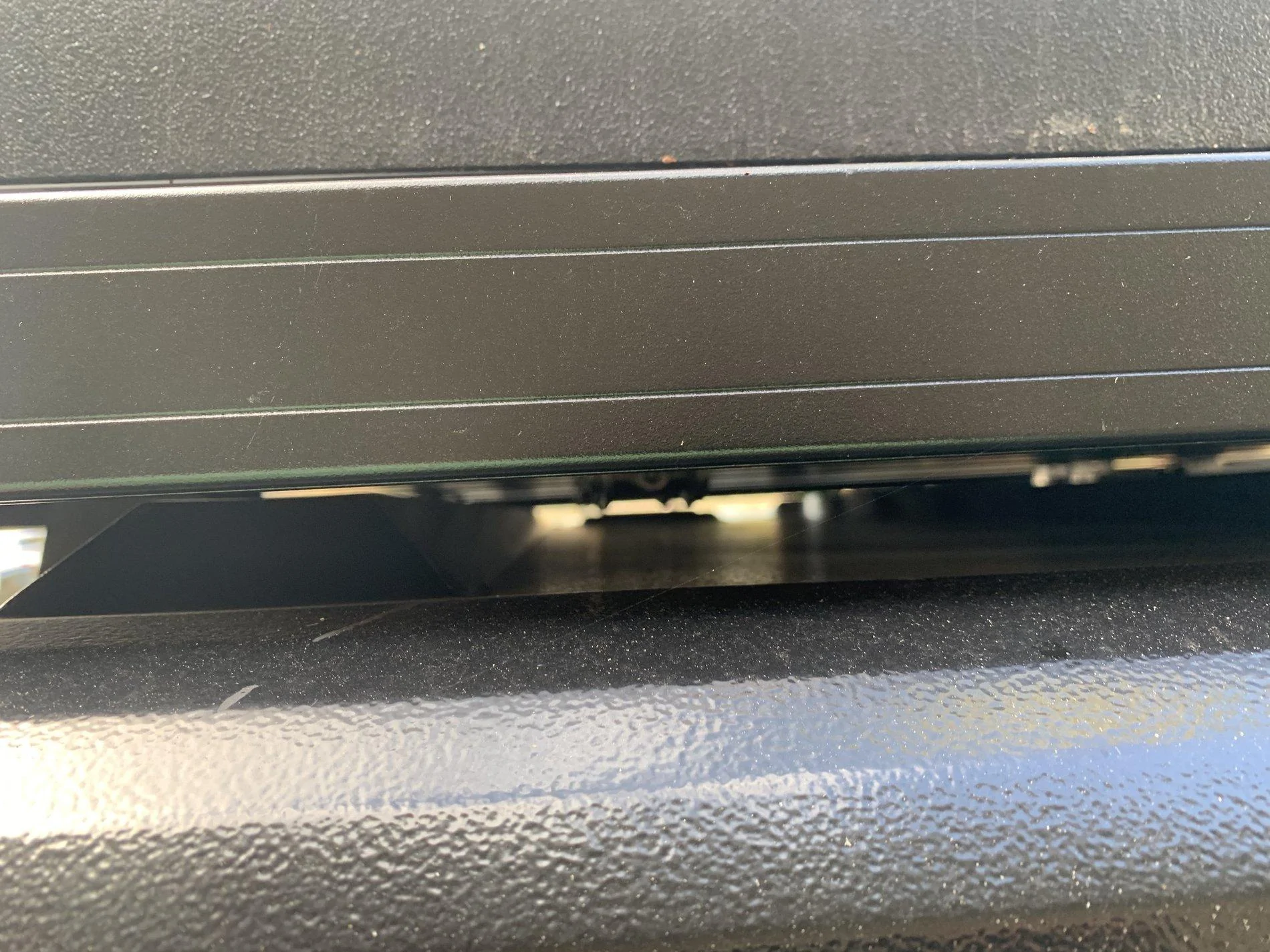

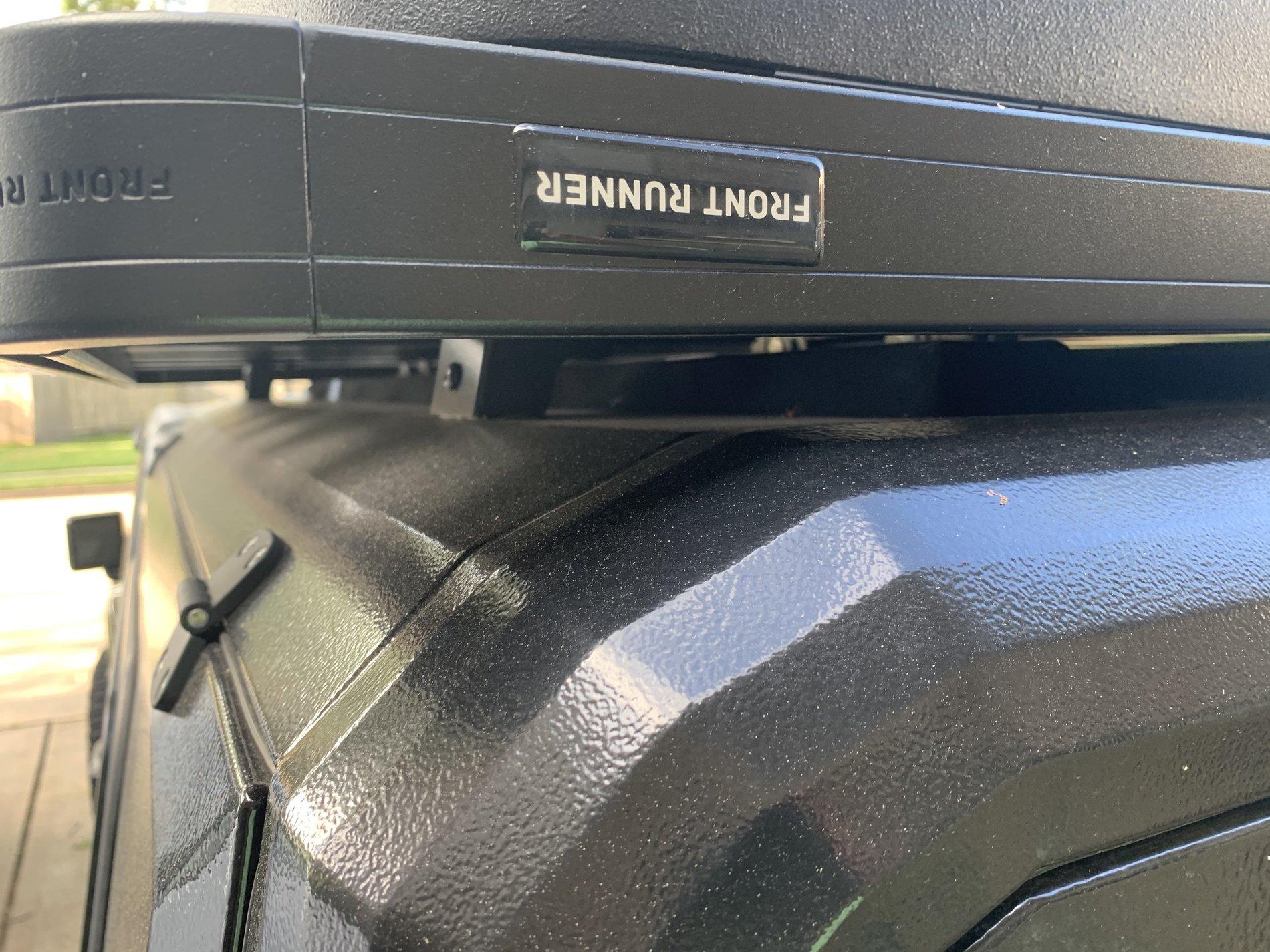

Mine measures 88" with the lift and 35's. I installed the Frontrunner rack upside down using the brackets mounted to canopy. the brackets gives me the clearance for the tent brackets and also lets me take out 4 screws and lift the rack and tent off.
The shelf is from frontrunner that I had in my JKU.

Thanks! Good information! I’ve got 91” of garage. Lol. I’ll make it! Innovative flipping the front runner over.
