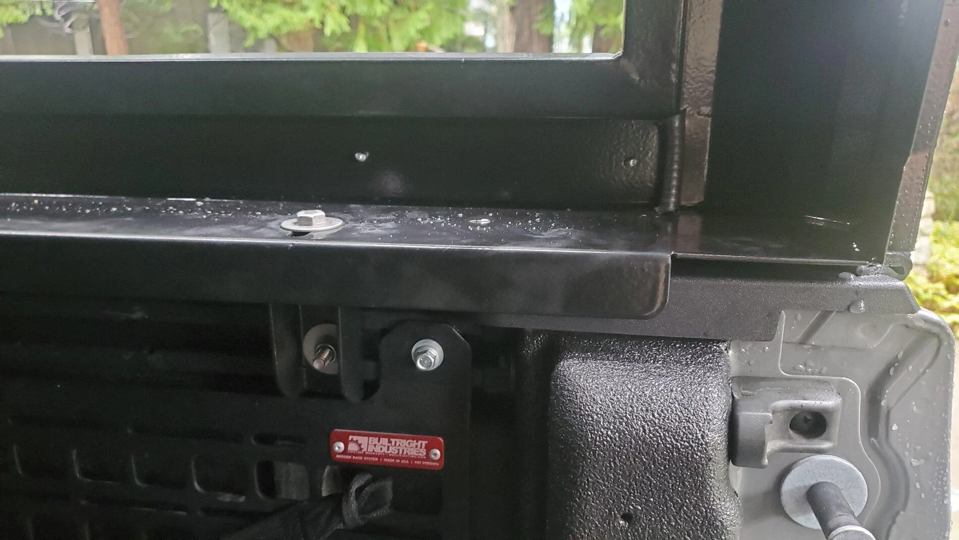

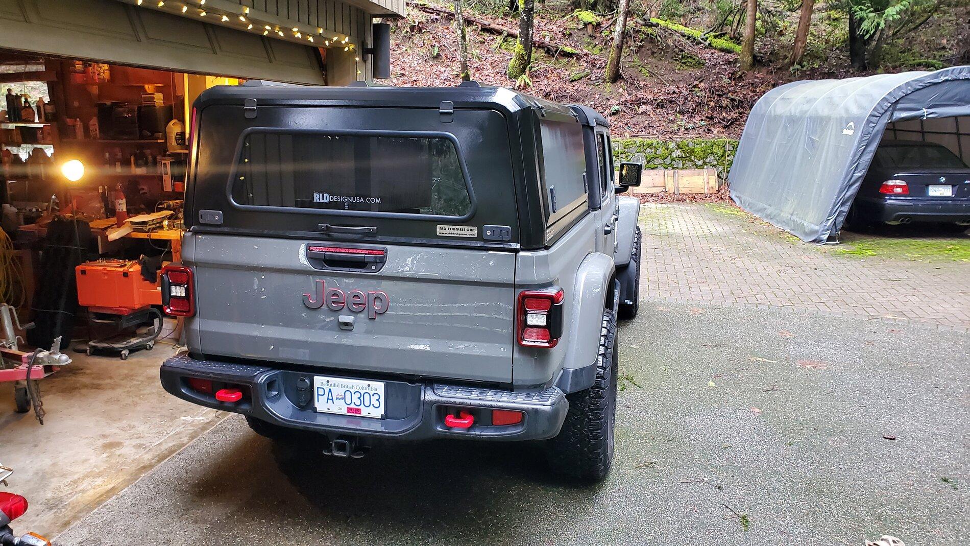

So I've got it on there today, finally. Been a struggle in the PNW to find a dry day where I could get an extra pair of hands to lift. As it sits, I have all the brackets installed finger tight, and the final note in the instructions says "The D-shaped seal should only compress +-30%" -this statement has me confused.
I am considering getting my 200 lb. Friend to sit on the roof while I make the final torque. That way it would be all snug with the seal pre compressed for when this thing takes a load on top. Or I can pull down each one individually and tighten them down. But I don't want all the weight of my roof top tent and my family to be on the bolts!
The instructions kind of suck, or maybe I'm applying too much overthinking logic... what did you do?

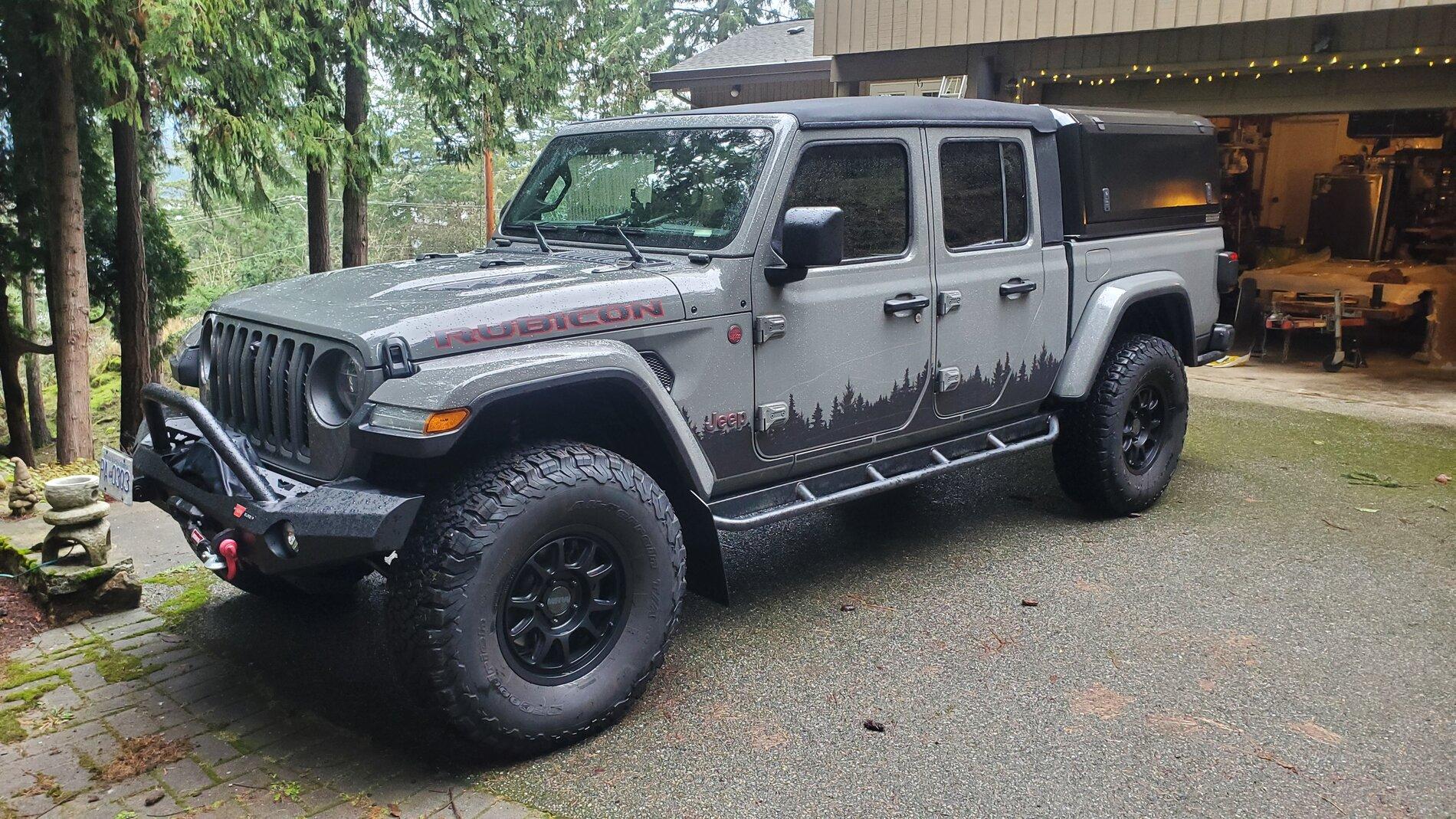

That graphic is great. Where’d you get it??

Best way to do it is to get the bracket where you have a slight gap between the bracket and cap and then tighten the rail bolt completely. The weight of the cap and the cap-bracket bolt will get you plenty of squish.
I also strongly suggest adding a layer of adhesive-backed foam to the top of the front rail or you're probably going to have a slight gap. Easier to do now than later.

Trail scales, awesome product! They're extra thick and have been amazing for protecting the side of the truck from bush damage and pin stripes. The graphic i chose, you can chose Adobe files and they can print whatever you want on the vinyl pieces. I went with clear, to match the colour, it comes out a little matte.

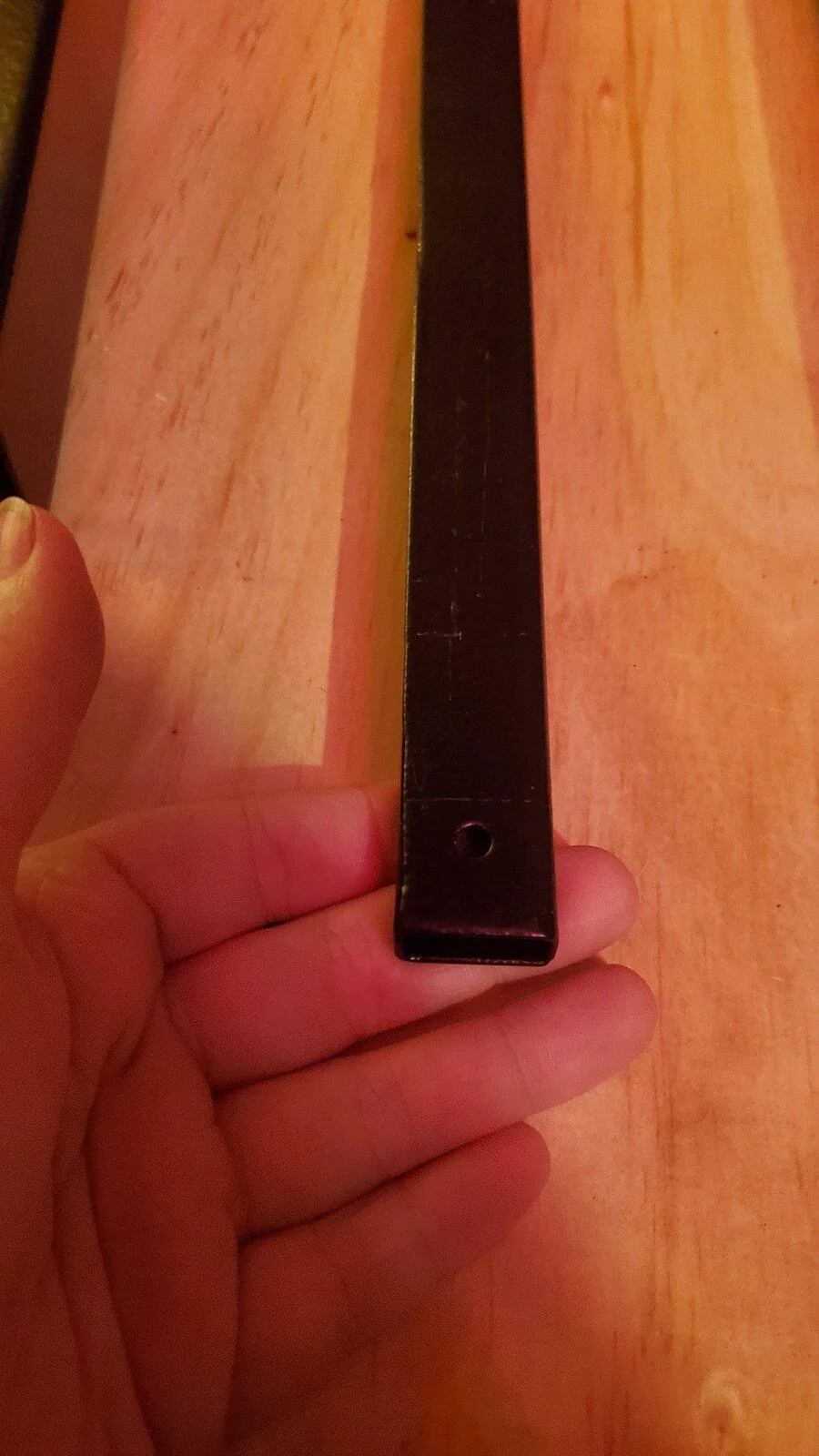

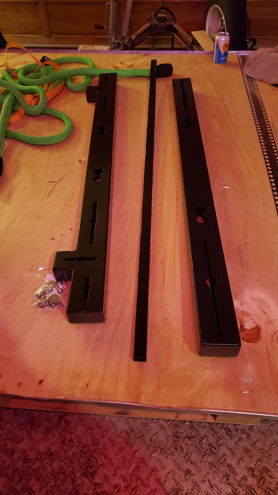

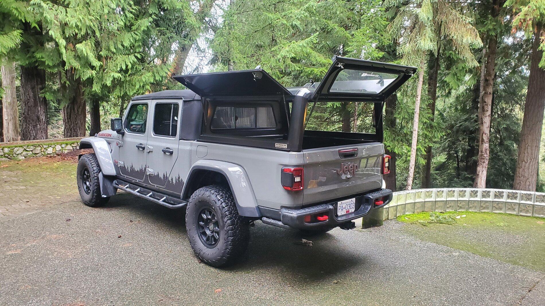

I did end up getting my friend to sit up on top while I tightened everything down, it worked great and compressed the seal great. I didn't have to do any cutting or bending or drilling, even with my built right panels in place. Just lots of micro adjustments and messing around. I'm blown away by how perfectly it fits! Seems like they really have it dialed in now.
The only thing I cant figure out, is what this long skinny piece is for. I think it came with my crossbars? Its stainless steel like everything else, and powder coated like everything else too. It has 2 small holes in the ends, smaller holes than any 9n the bolts provided.
But its not listed in the instructions or materials list anywhere. And I am losing my mind trying to figure out where it goes...

hey I had the same question with that bar. Found out it’s supposed to sit on the front of the bin before you attach the canopy. It fills the gap there, as the bin on that side drops down a bit. I didn’t figure that out till after I installed and as of now I can’t be bothered to redo everything, especially given the weather seal is tight back there (although not +-30%). To be clear, I’m talking about the side near the cab.
