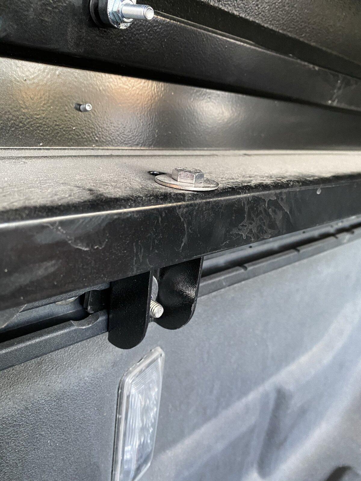

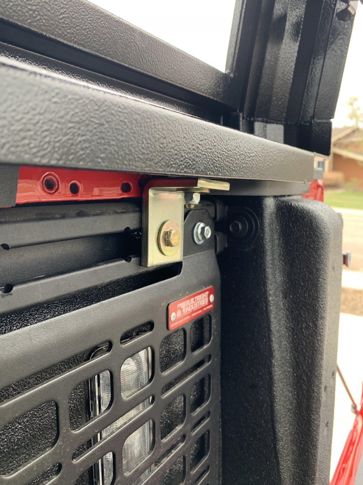

Which is really odd to me beacuse a 1/2" bolt barely fit and 1/2" ~~ 12.7mm or so which is a really common 12mm washer ID. I guess I should probably get some new square nuts cut so I can do them at the right size... I'd rather not have the risk of my rack sliding and wearing through the finish.

I almost want to drill and add some more bolts for retention and security.

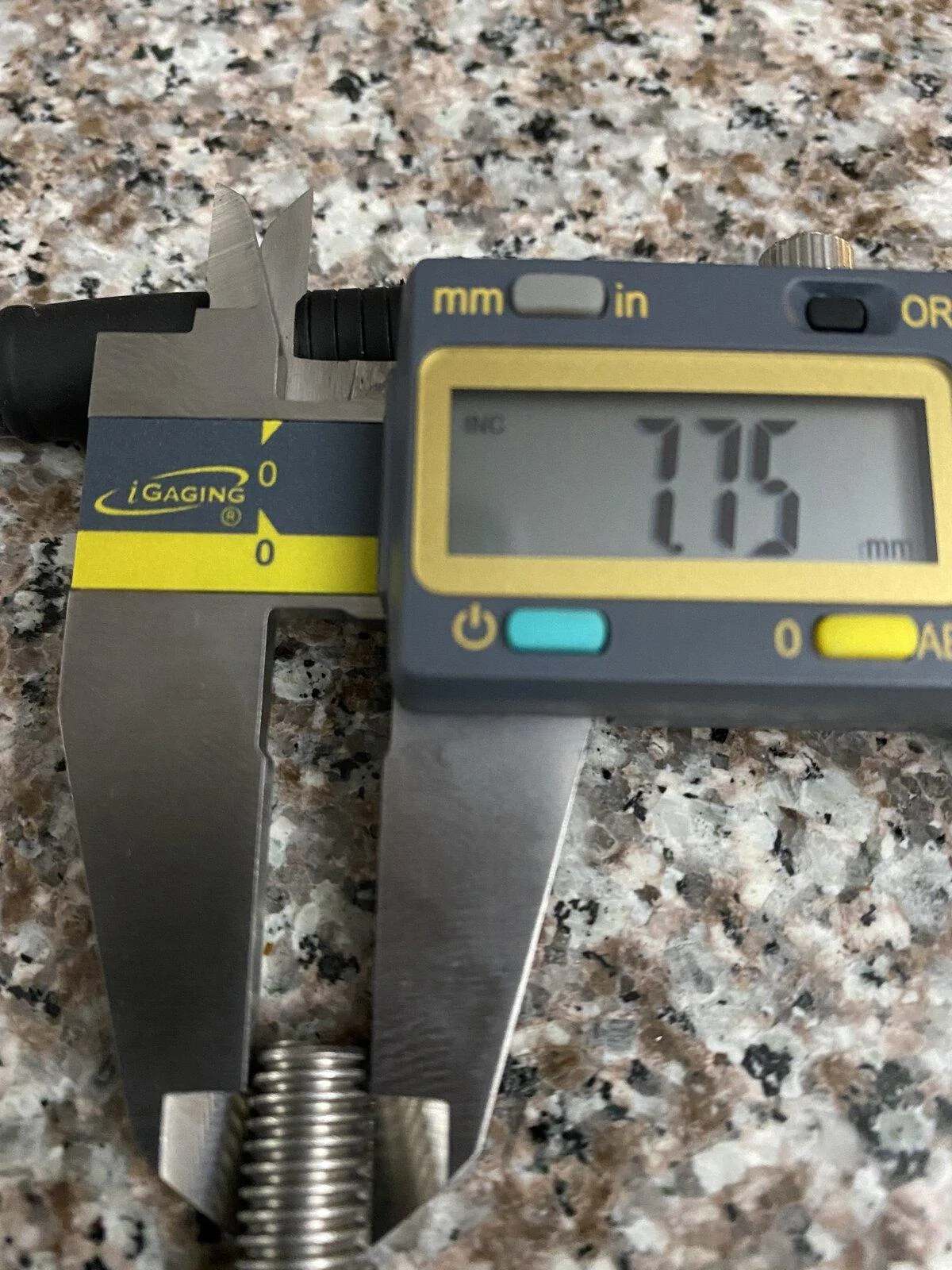

Nice looking caps boys, 1/2" bolts are huge, you need a 3/4" socket to tighten that, do you mean the wrench size is 1/2"?
I have an RSI, it seems all the cap companies take a bit of time to get it dialed in where they all fit easily. The latches are I think the the same on the RSI, RLD and Alumcab, all come from the same neck of the "woods"
Very valid question actually... curious if you're right but then that's like an 8mm bolt which I think would be way too small... I feel nervous about mine with a 10mm.

Good point. And you are correct. 1/2" socket used. Meow I need to measure the diameter of the bolt.

I think it will be 1/4", the square nuts that fit in the RSI channel are M8, which is a little bigger then 1/4", I had to drill my Yakima rail mounts out to fit the socket head bolts in, just get them tight and use lock washers or locknuts. You get your Beer Koozie yet, winner winner!

Wow that's a lot of wiggle room in that hole then. Feeling a lot better about my setup now.

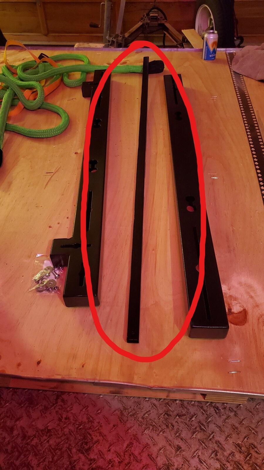

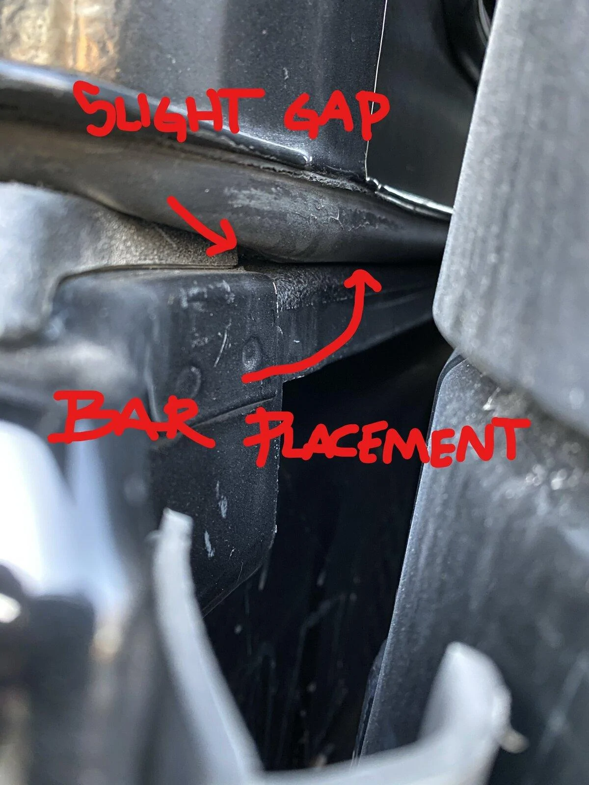

This thin metal bar is meant to fit between the bin and the canopy on the front side pictured below. There was no included hardware to install it, and no where on the included instructions is the bar ever mentioned. You can see I didn't figure out what that piece was for until after the canopy was installed, leaving a slight gap where the lip of the bin dips down. I don't plan on going back to install the bar now, the seal is tight enough for me right now.

My canopy came with two sets of brackets. One set installed into the trail rail system on the sides, very easy.

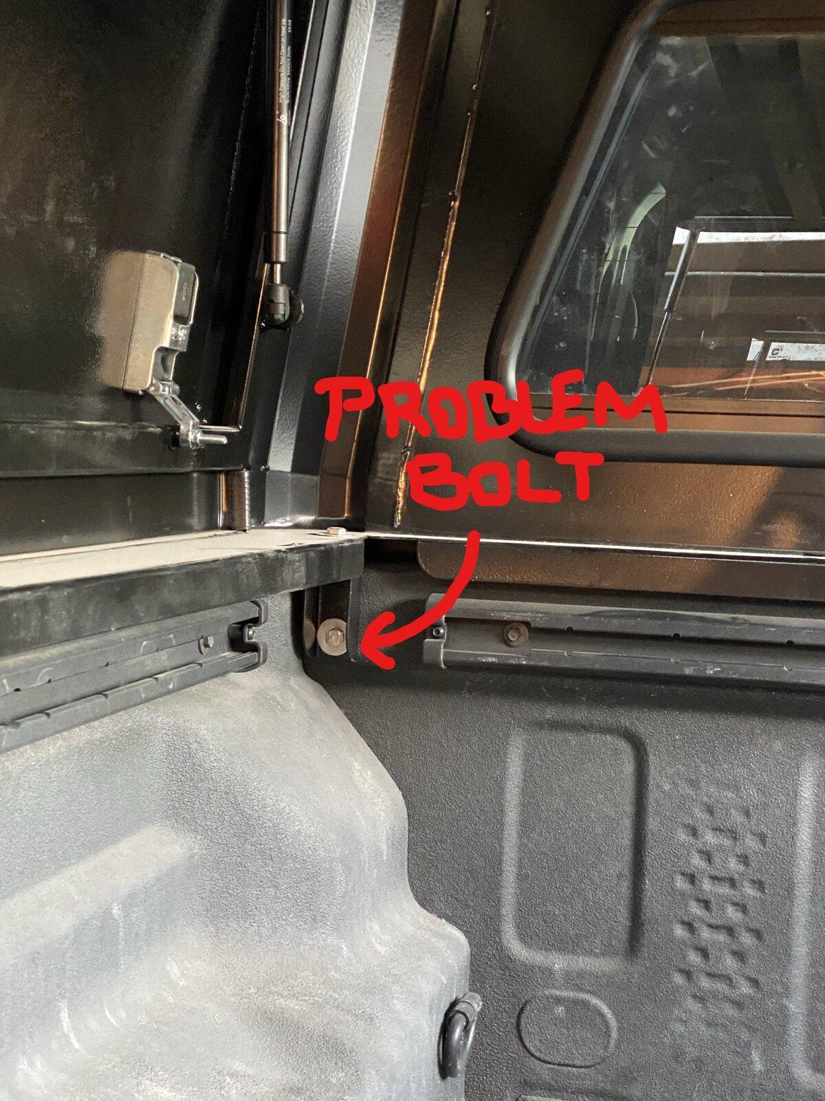

The second set however, installed into the bin itself towards the front, proving to be a pain in the ass for me.

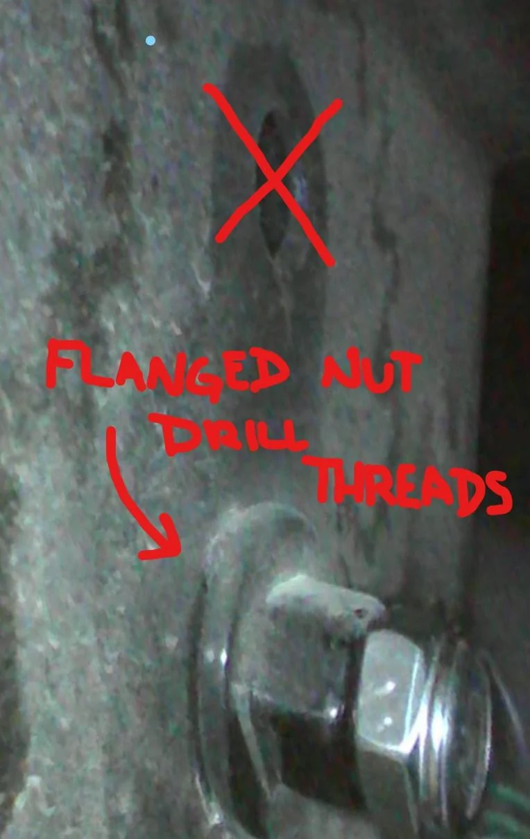

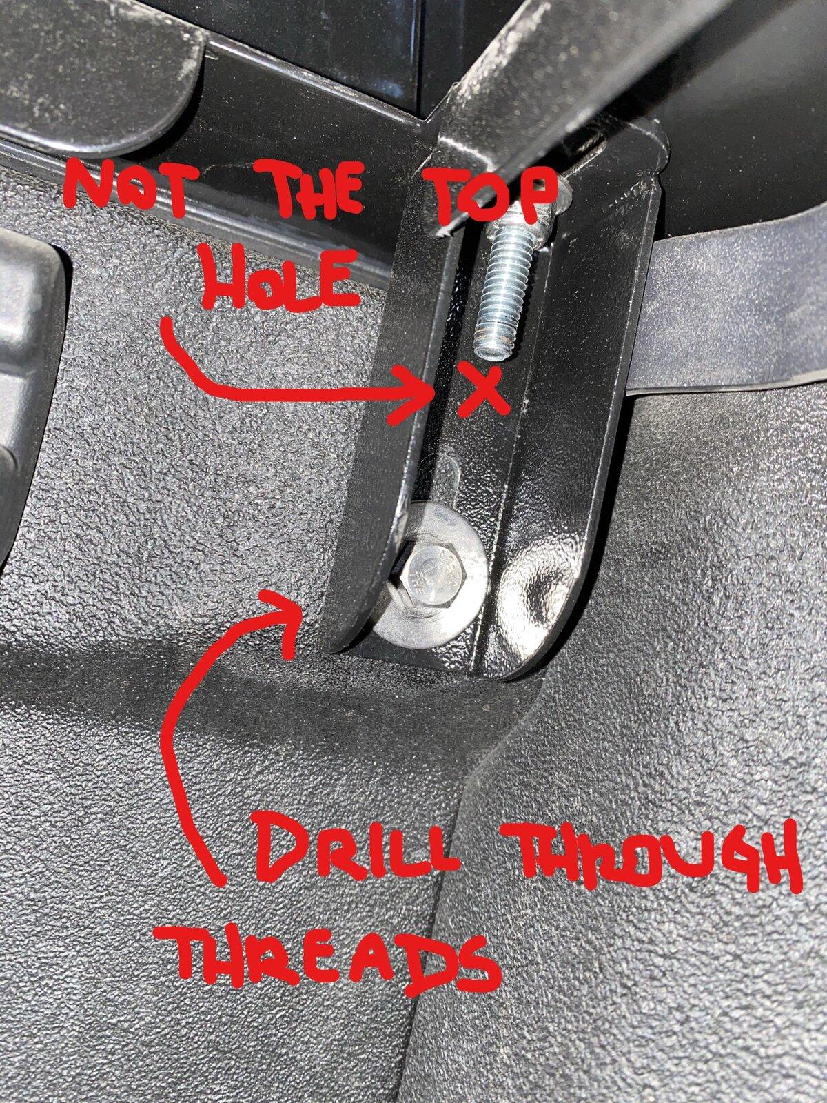

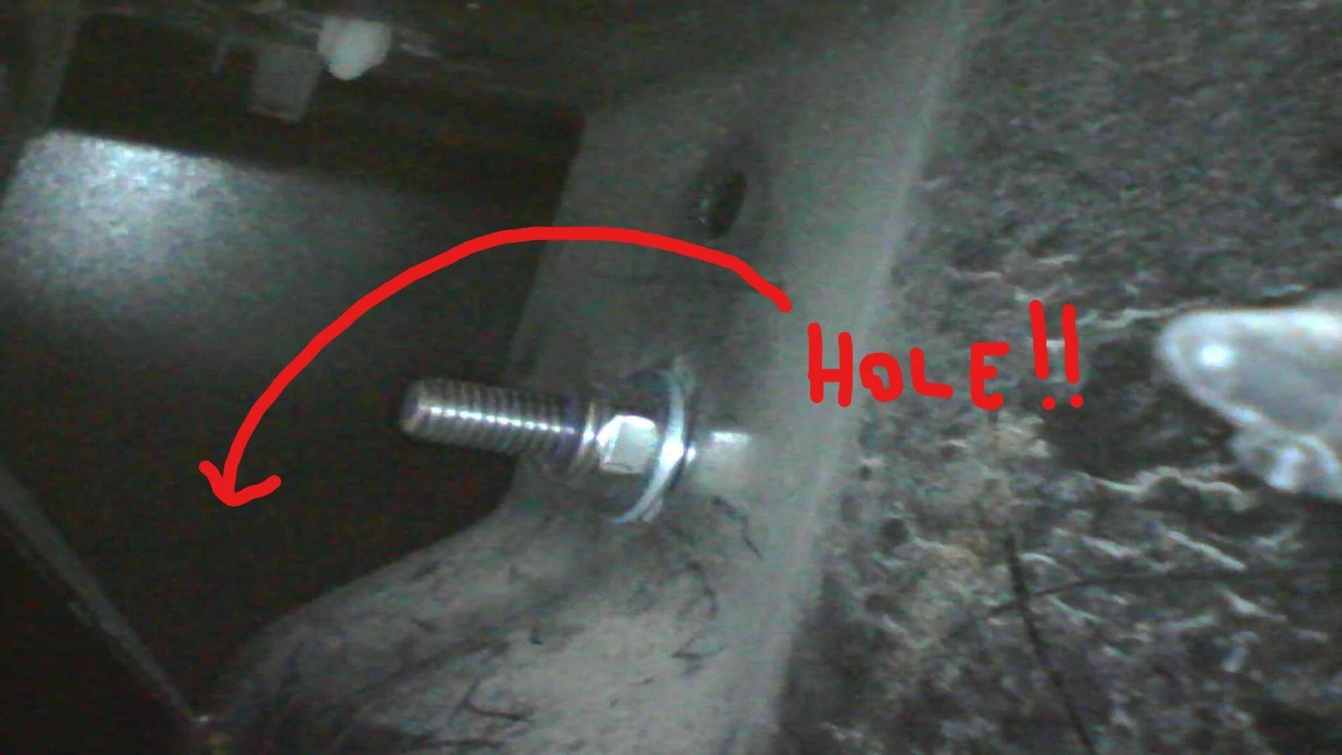

First, there are two holes you can insert the above bolt through, use the bottom hole. But first, you'll need to drill the threads out of the flanged nut on the backside (which you can do so from the front). You can see a backside view below. I used a flexible borescope to help see, came in handy later.

Now, the hardest part of this whole installation was threading the nut onto the bolt from the backside. Some of you might have easier methods of doing so, but I used a socket extension to reach the nut from the bottom of the truck, while a friend torqued from inside the bin.

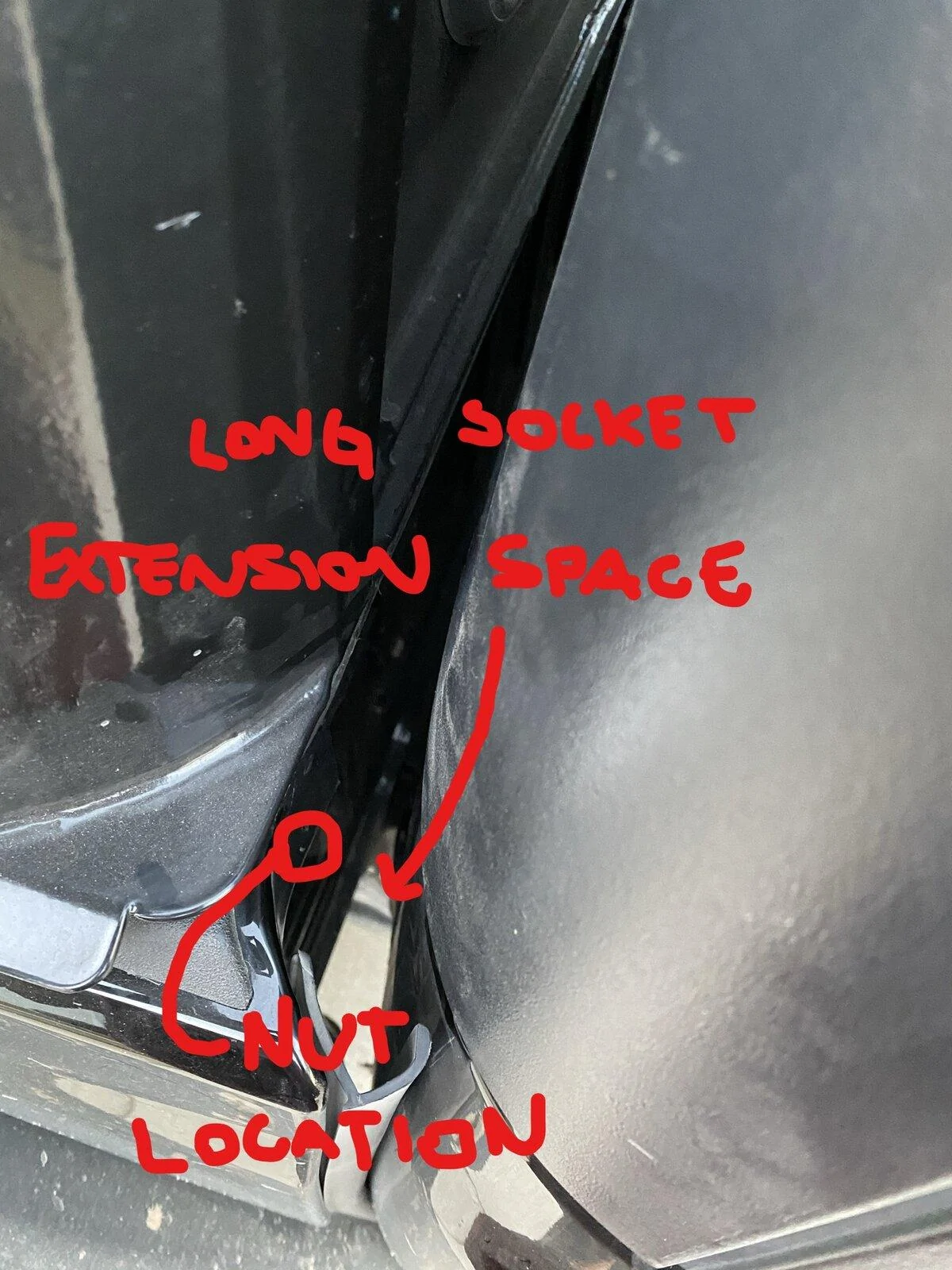

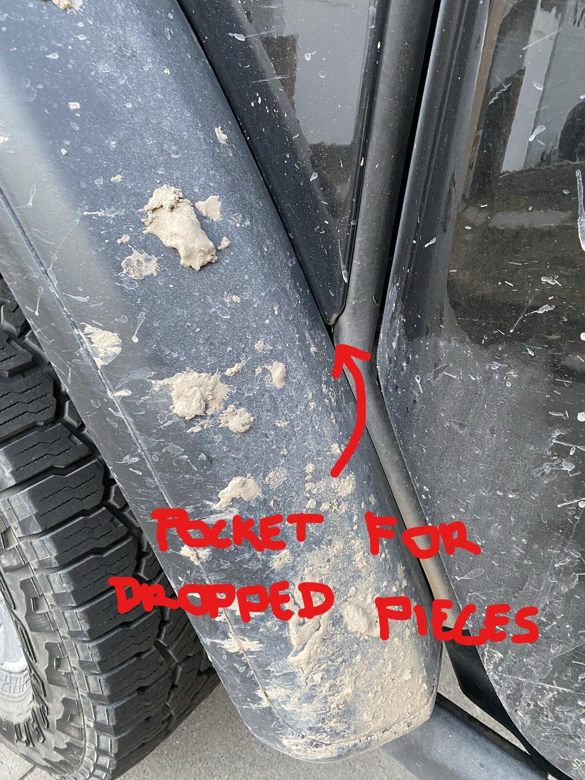

Be mindful, between the bin and canopy where you'll thread the nut onto the bolt, there is a gap towards the side of the bin that drops into the side of the vehicle. I broke the flanged nut off the bin which dropped with the installation nut and my socket into the paneling of the truck bed. HUGE pain in the ass to get out. Don't be me.
Jeep Gladiator RLD designs pic request Inkedd2b702c4-c344-469b-9727-be3c8ca32a7e_LI
This is where the borescope came in handy, two ours later I fished all the pieces out of the vehicle. And then I dropped the nut in the gap...again. FML. But at least I was practiced enough to fish it out a lot quicker.
The pieces drop right behind this rubber trimming

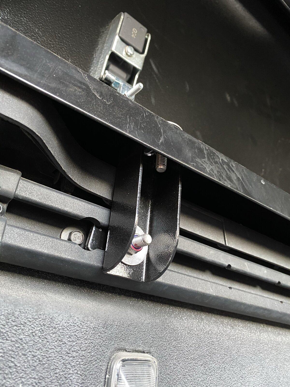

For mine... the two front brackets I cleaned all the bed liner out of the factory flange nuts and the hardware that came with the brackets simply threaded in.

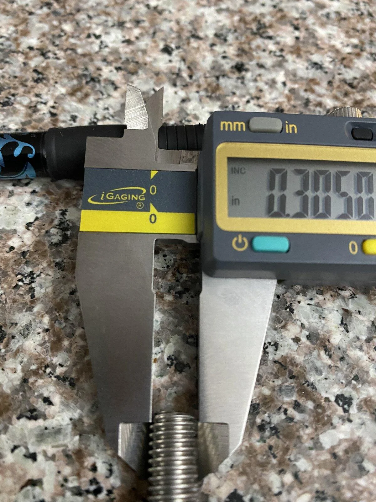

Diameter of hardware for the rack.
