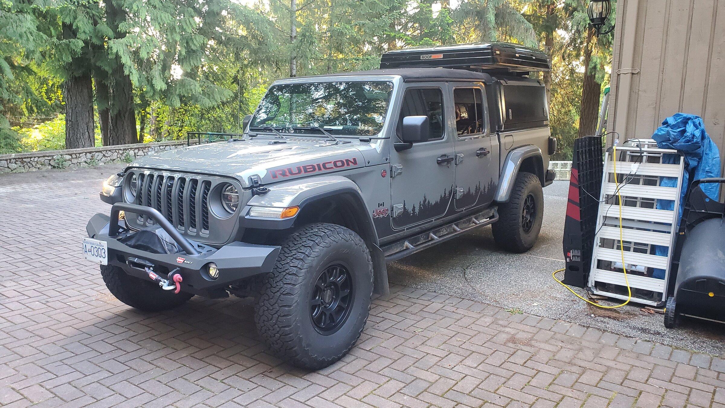

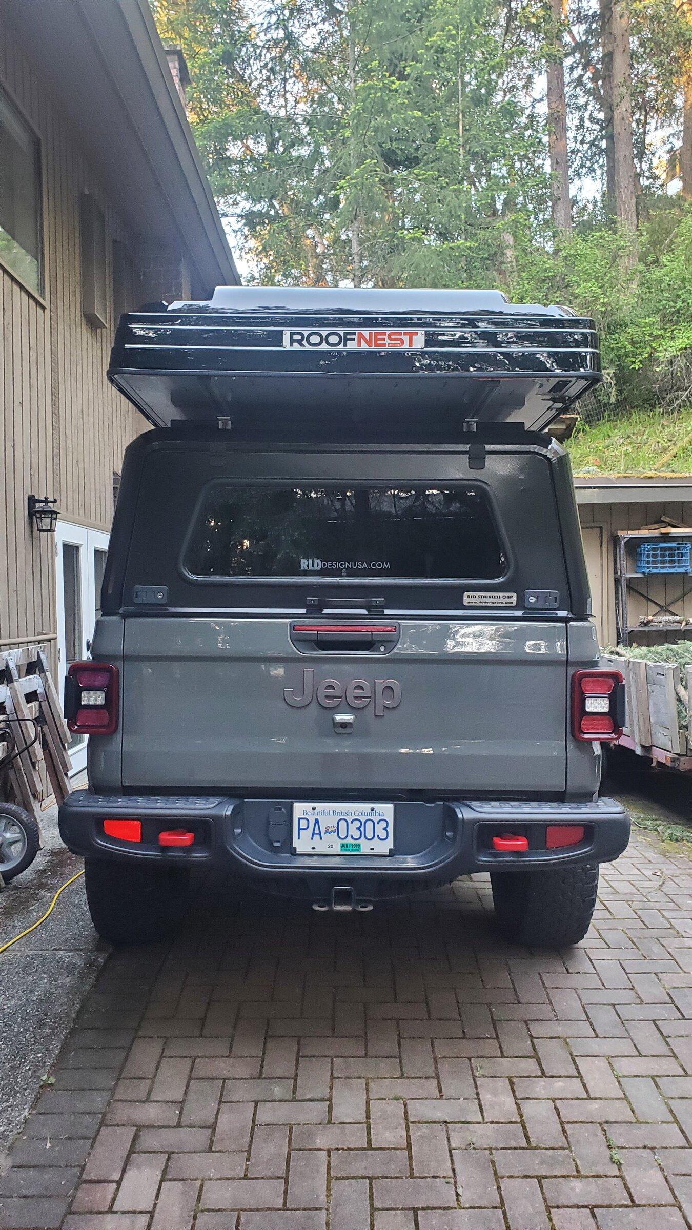

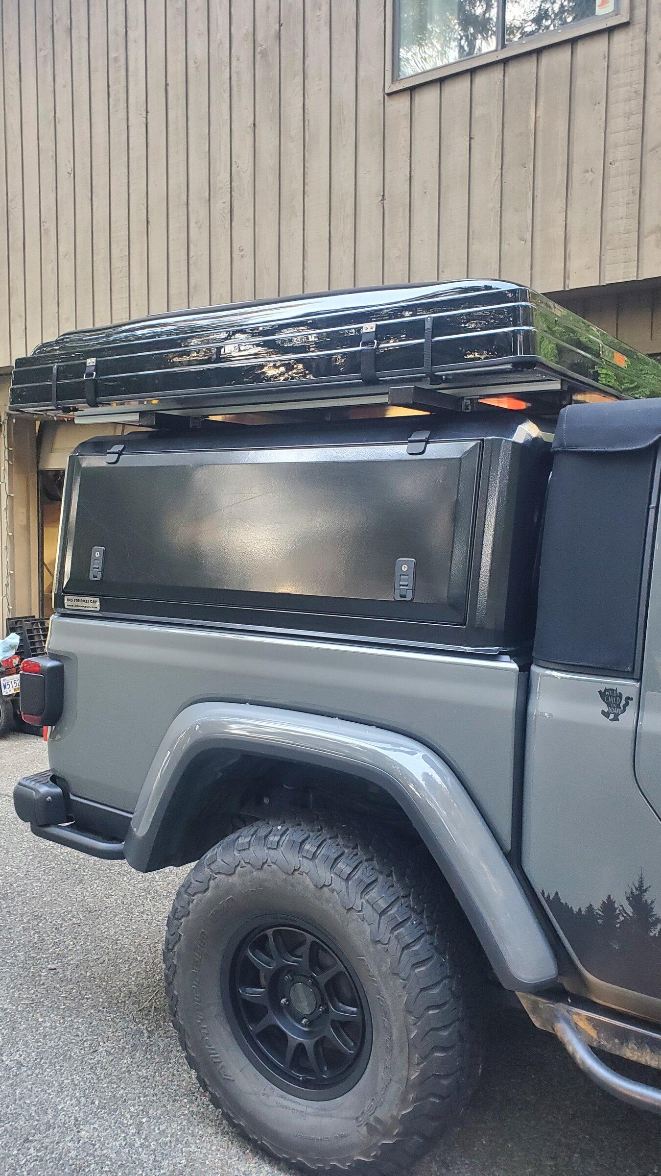

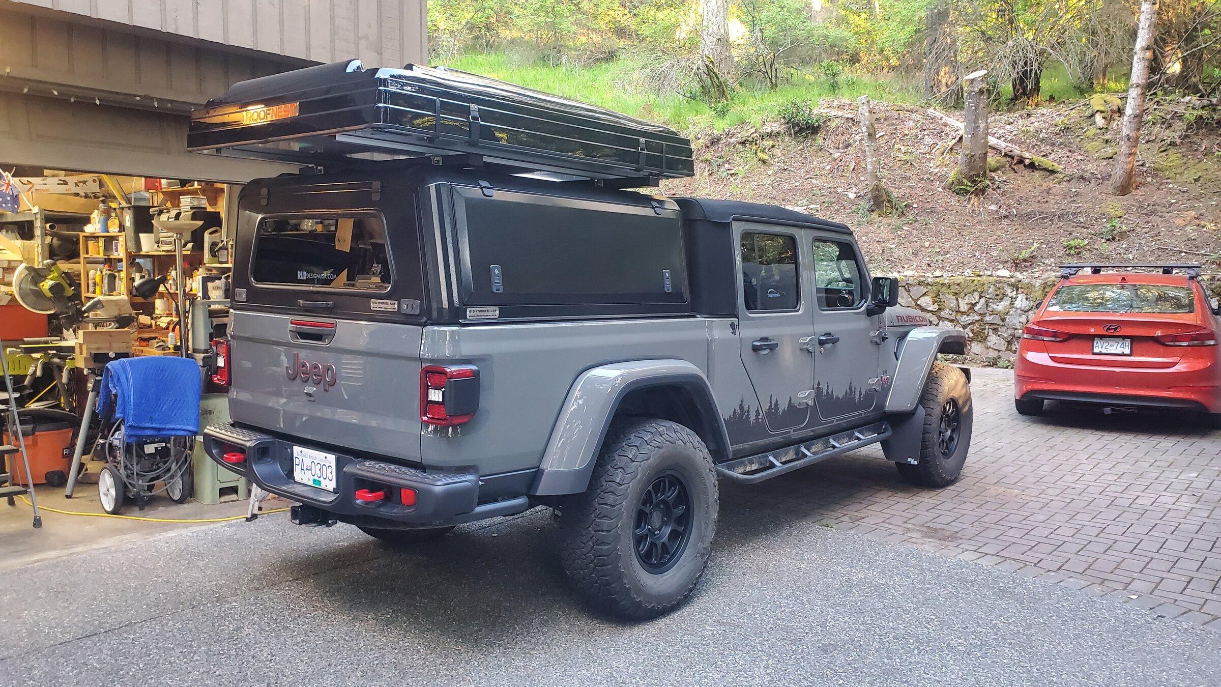

Finally got my RoofNest Condor XL mounted! Was a serious painin the A## having to reseal my windows. The gen 2 window rubbers leak in the PNW climate, had to use Sikaflex to lay beads around the windows, which looks awful. But that meant removing the canopy again.
Overall, after over a year on my JT, I have had some serious issues. Water leaking being the biggest. Kind of defeated the purpose of having a covered bed of water just pours into through the windows. Once water was in the back, the condensation would fog up the windows making them inpossible to see though. RLD would not fix it, directed me to Adventure Ready, who said to get it fixed and send them a bill. But I didn't trust anyone else to do the job (thats why i became a mechanic in the first place), or that I would be reimbursed for all the hours of cleaning, drying, and prep, so I did it myself. They didn't even reccomend a sealant to use! Terrible customer service in my experience.
I also have corrosion forming on the nameplates, the aluminum rivets look like they are going to break. All the latches have paint peeling where corrosion is bubbling from underneath, which looks horrific. The locks dont work well, despite lock-ease spray. They freeze shut and become inoperable in the winter here in Canada. Have to pour hot water on them to unfreeze, just to be able to open a door. And the plastic end pieces on the inside of the latch break and fall off.
i love the look and strength of the cap, but I can't believe the issues I'm having with what I paid for a premium product.
