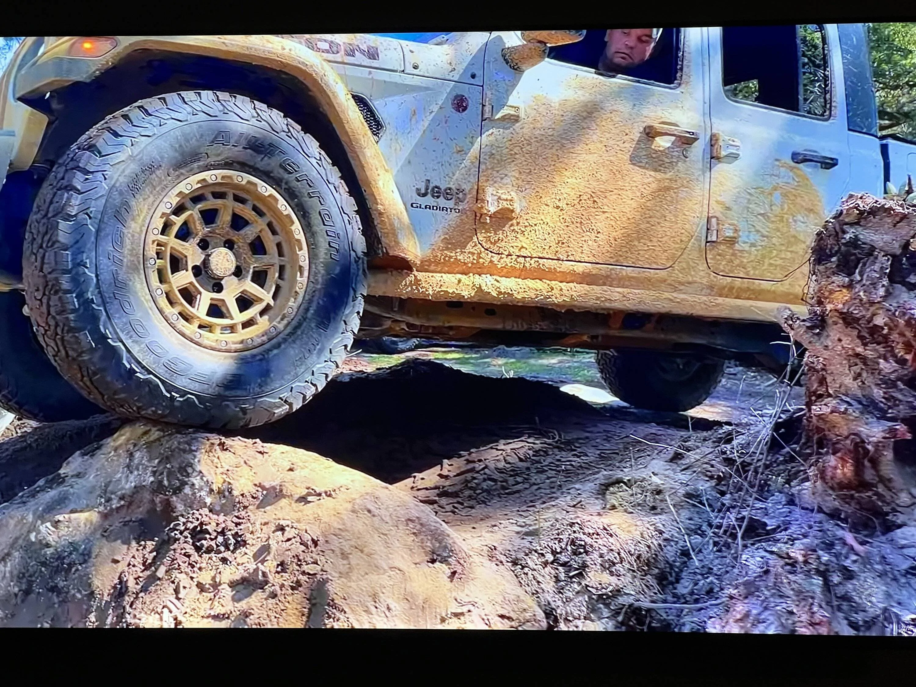

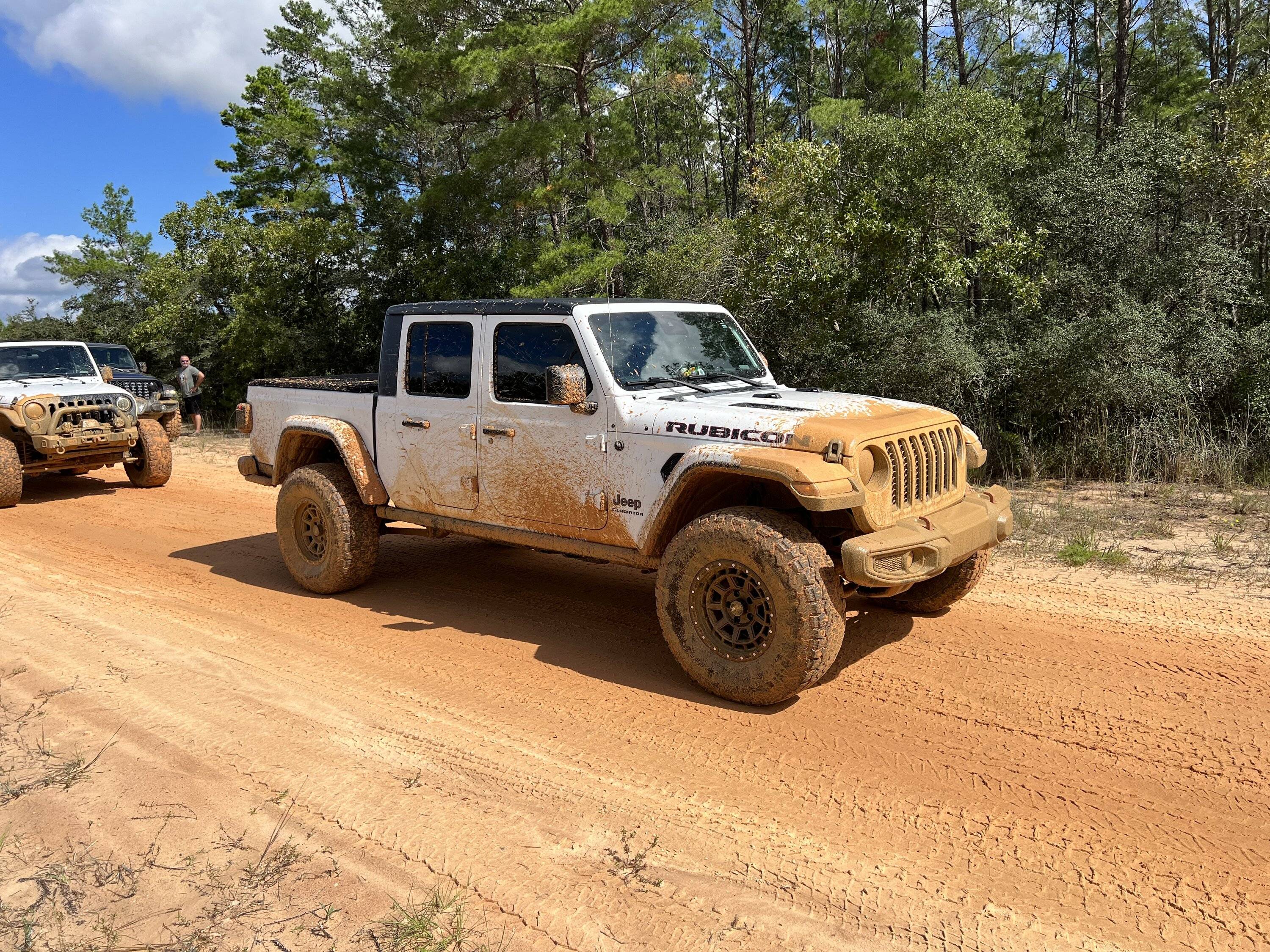

I have a 2020 Rubicon, I put on a 2" spacer lift, 17x9 Rock Trix 114's with -12 offset and 37" tires. I know the Rubicon has taller fenders, but even with just a 2" lift. I recently attended Jeeptoberfest in Ocala FL, the only time I had any rubbing was at full stuff and trying to turn a sharp corner. Even that could have been alleviated with the right bump stops. A +12 offset should pull the wheel in by almost an inch. (25.4mm per inch).

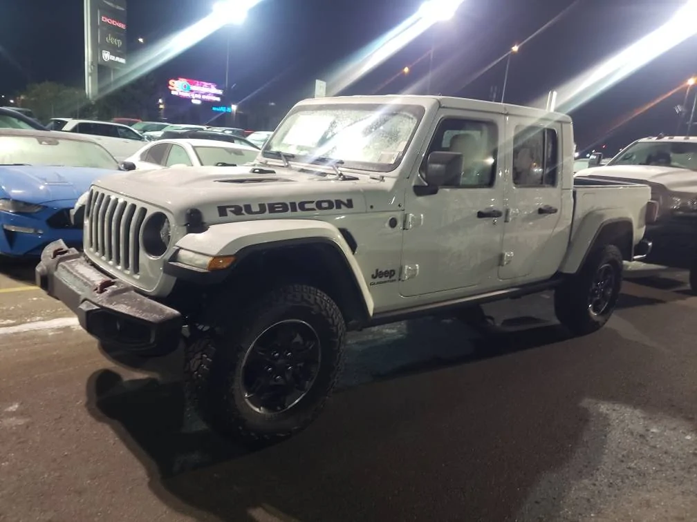

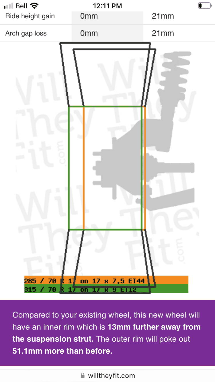

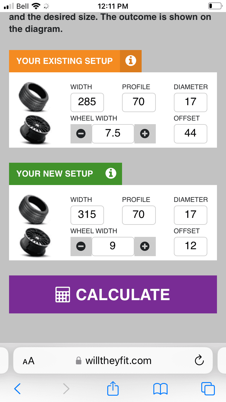

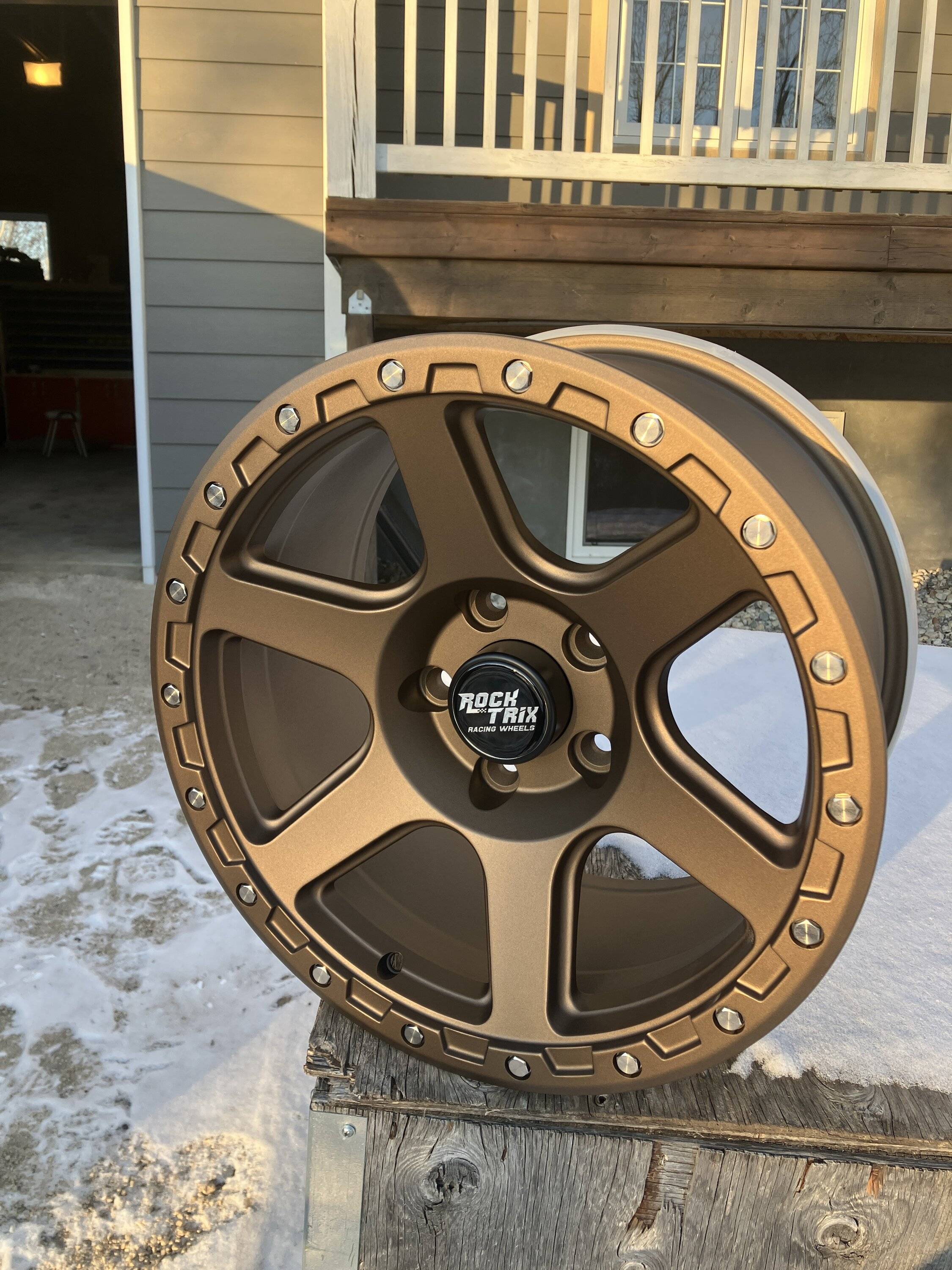

Sorry to keep dragging this on. I’m still looking for someone to chime in that has this exact setup. Here is a comparison screenshot, and it look like it wil work. I mean, it might rub if I’m trying to stuff it up there off-road, but till I get a level or a lift, it will be ok.
Jeep Gladiator Rocktrix RT112 wheel in a -12 or +12 offset? IMG_2442
Jeep Gladiator Rocktrix RT112 wheel in a -12 or +12 offset? IMG_2443

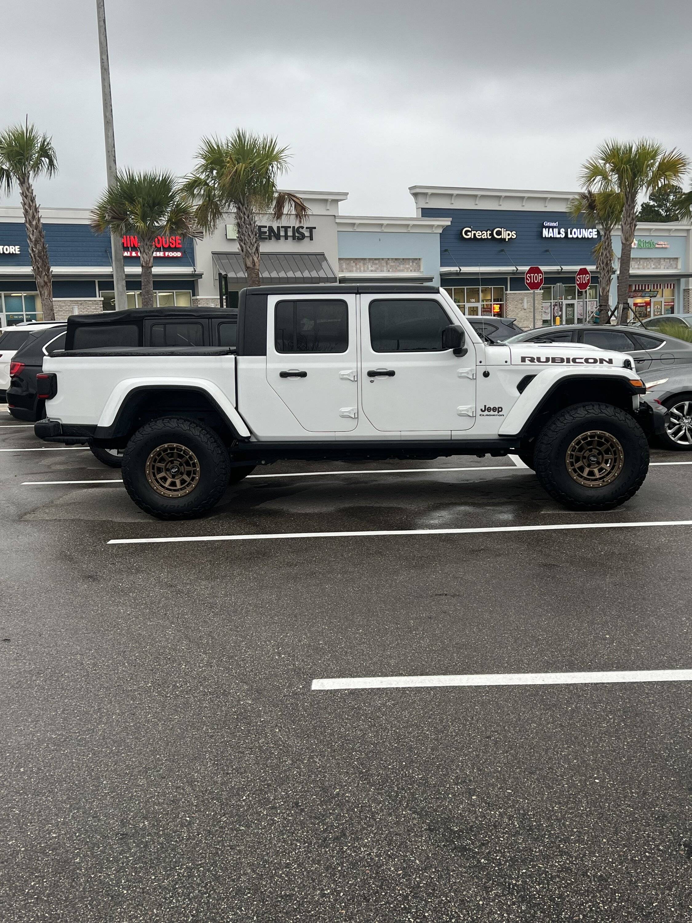

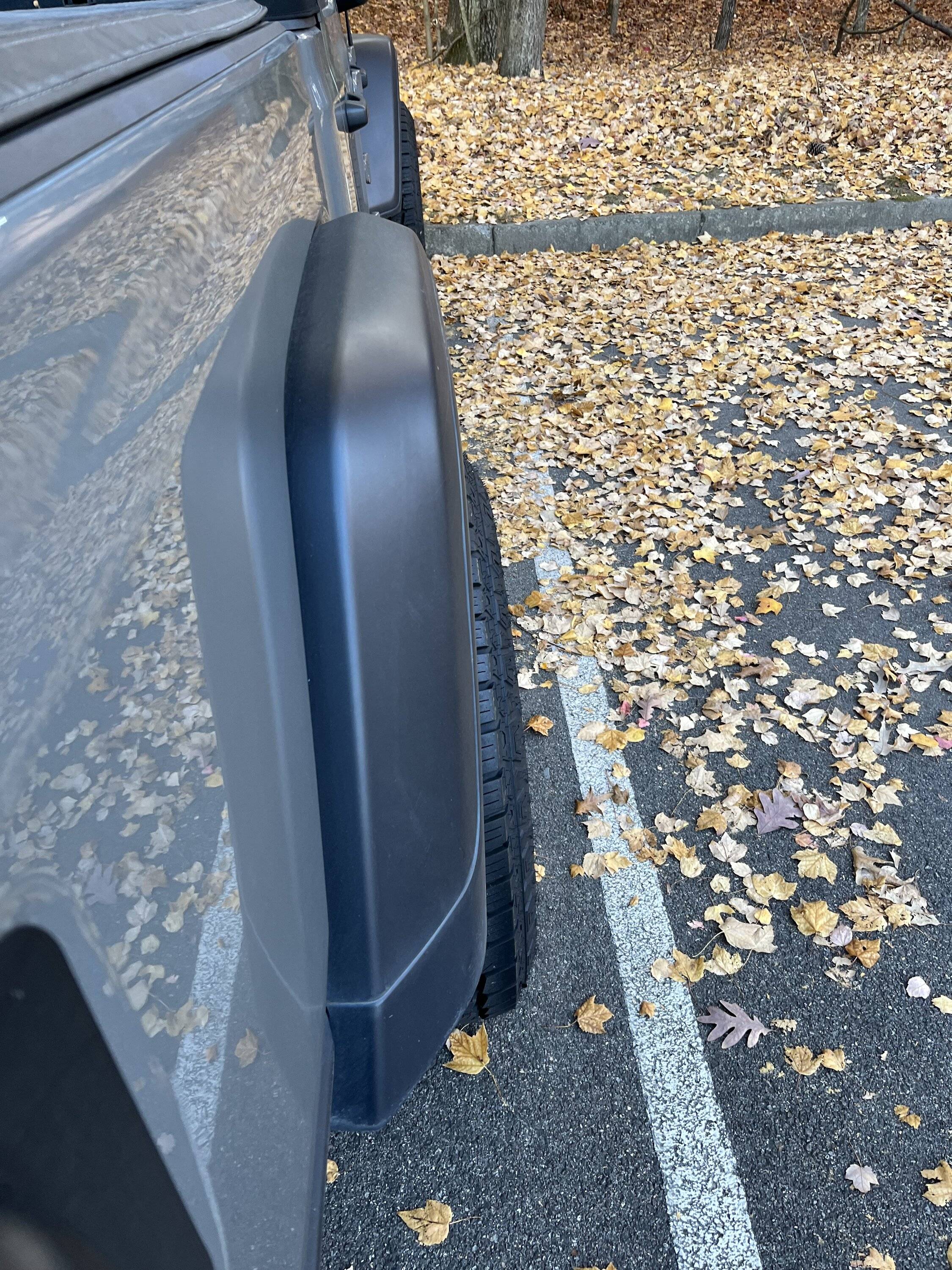

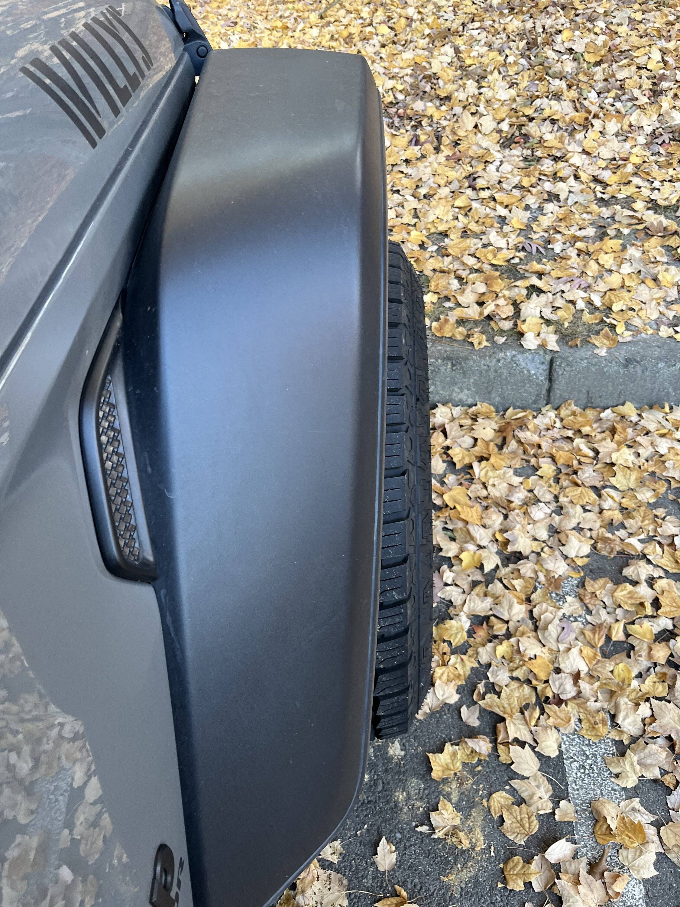

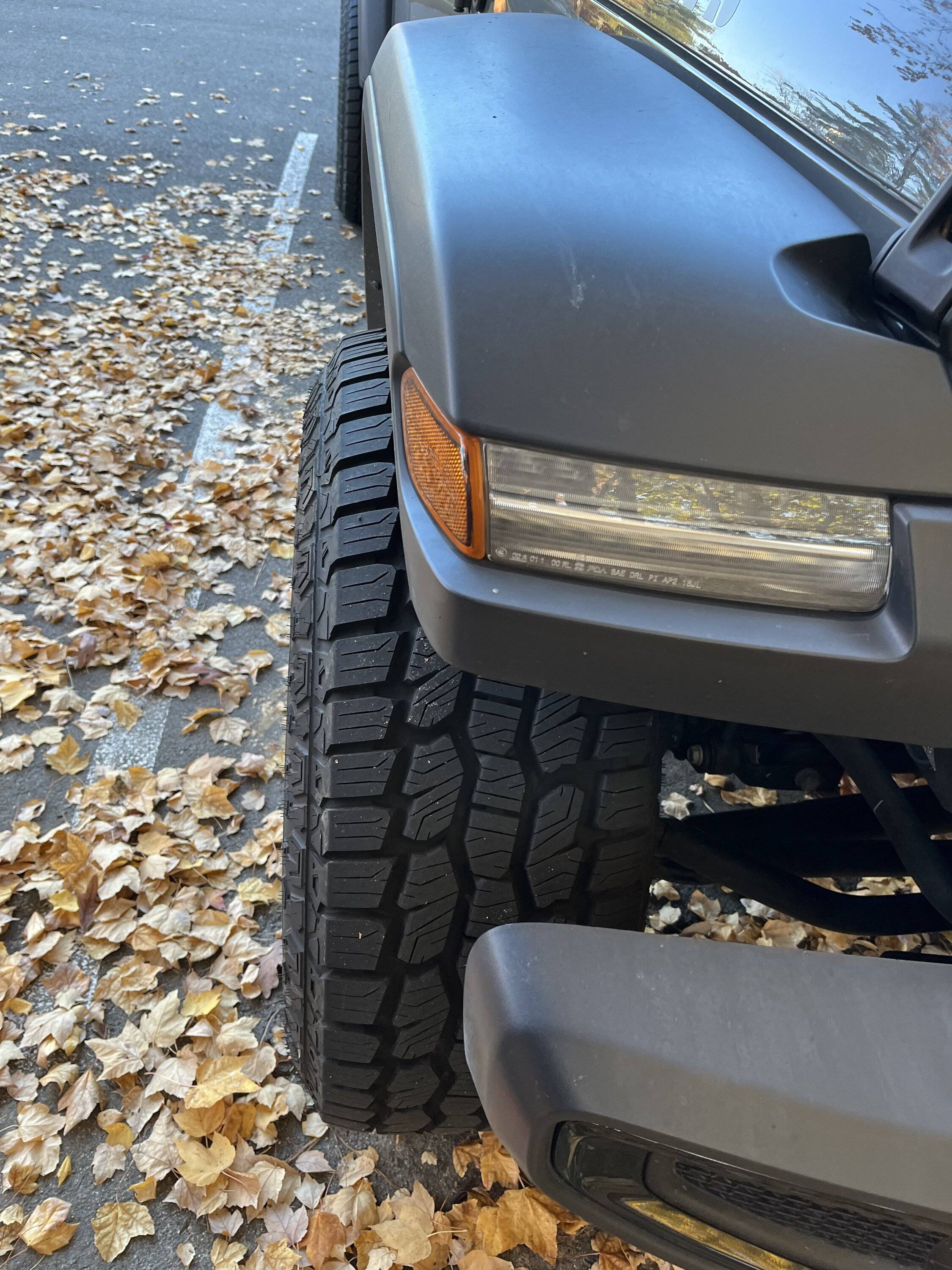

This is with 17x9 -12 on 305/70 tires. A Willy with Rubicon fenders.
Jeep Gladiator Rocktrix RT112 wheel in a -12 or +12 offset? IMG_4477
Jeep Gladiator Rocktrix RT112 wheel in a -12 or +12 offset? IMG_4476
Jeep Gladiator Rocktrix RT112 wheel in a -12 or +12 offset? IMG_4475

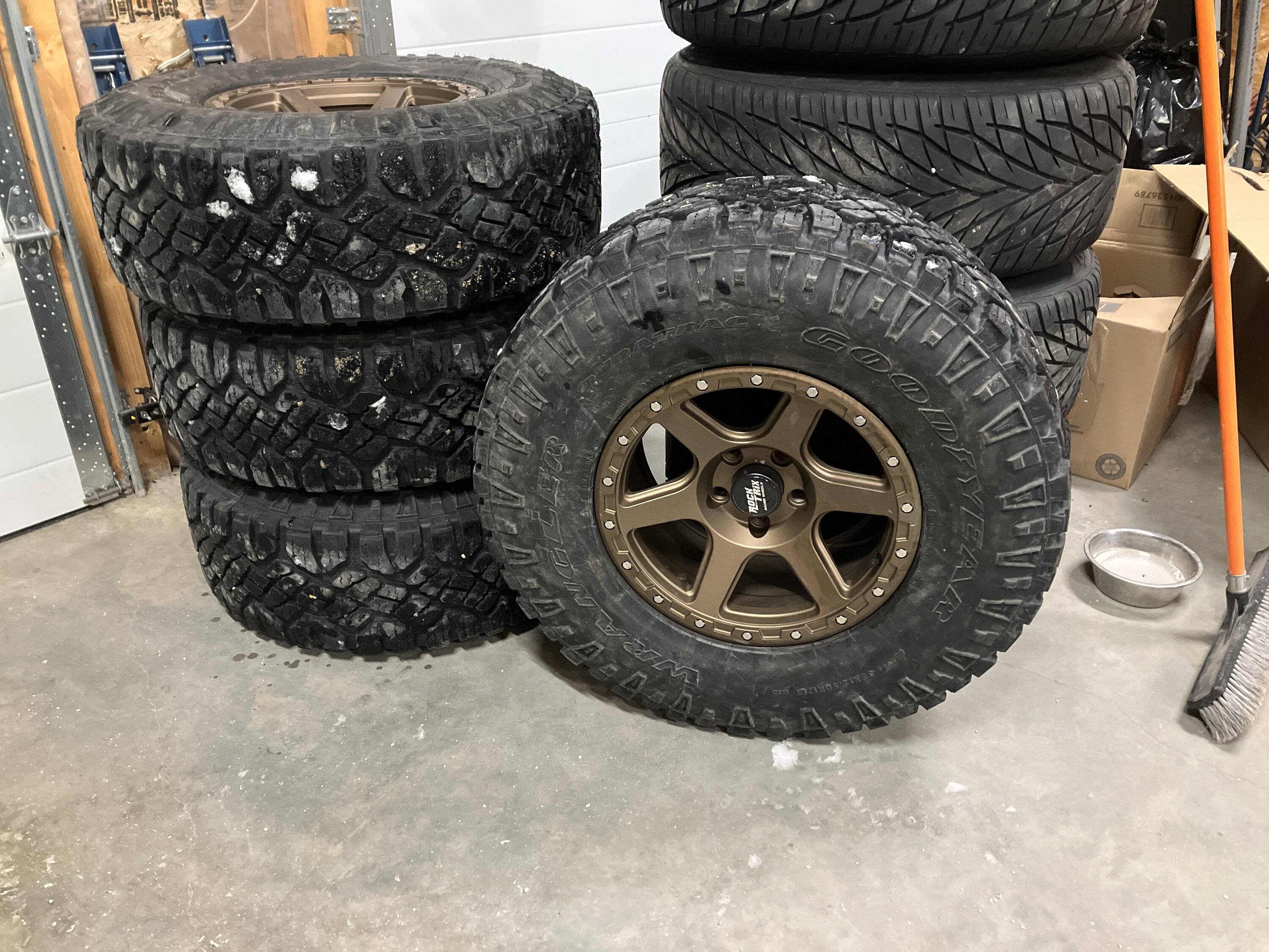

Thanks for the pictures. So yours are a -12, and the ones I just ordered are a +12, so that's 1" tucked in more, but with an almost 315 tire. So if my "calcumalations" and kuzinta's are right in my head, I should be about the same as where you are. Maybe a slight more tucked in. Like 1/2" or something.
I just pulled the trigger and ordered them. If something doesn't work out, I'll lift it till it does!!
Thanks all who helped. I will come back and update with pictures when they are on, as everyone likes a visual comparison, and loves pictures!!

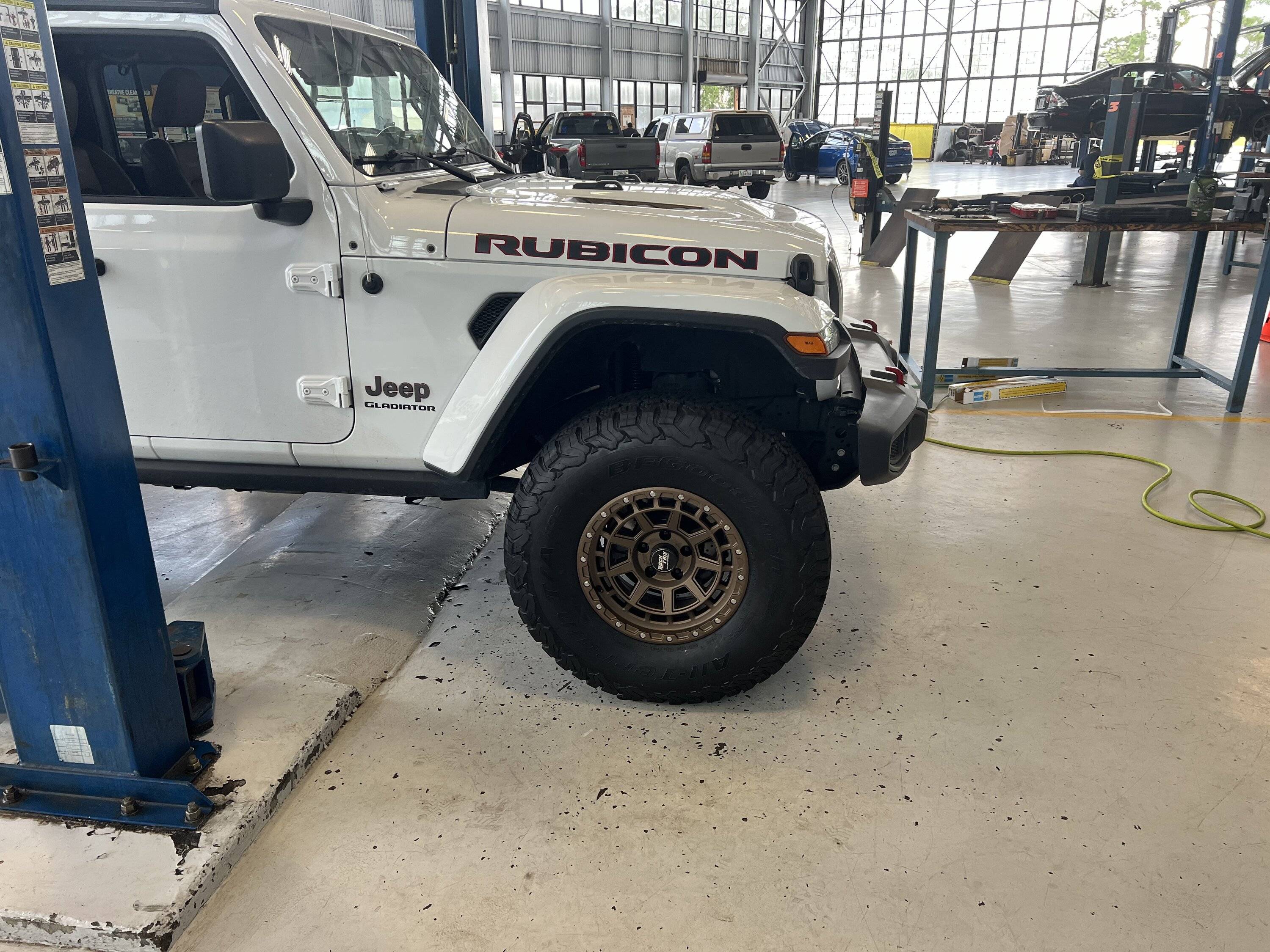

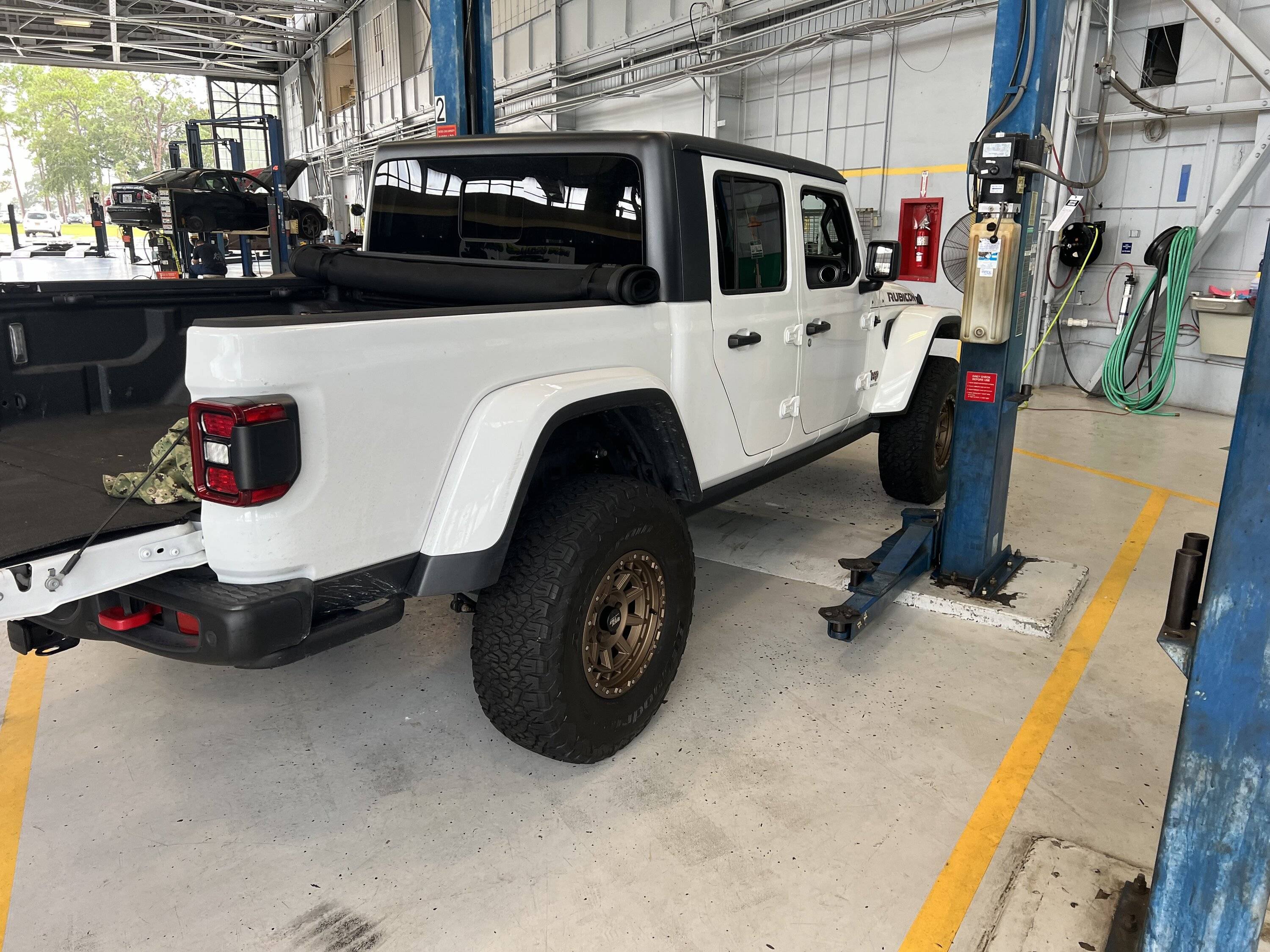

I've got a 2020 JTR with Rock Trix RT114 17X9 with -12 offset with 37" BFG KO2'S. I am also running an Iron Rock 2 inch lift with Bilstein shocks. I really like my offset and overall stance. I may decrease the front rake, especially when I install my new winch and bumper.
Jeep Gladiator Rocktrix RT112 wheel in a -12 or +12 offset? IMG_3345
Jeep Gladiator Rocktrix RT112 wheel in a -12 or +12 offset? IMG_3343
Jeep Gladiator Rocktrix RT112 wheel in a -12 or +12 offset? IMG_3344
Jeep Gladiator Rocktrix RT112 wheel in a -12 or +12 offset? IMG_3350

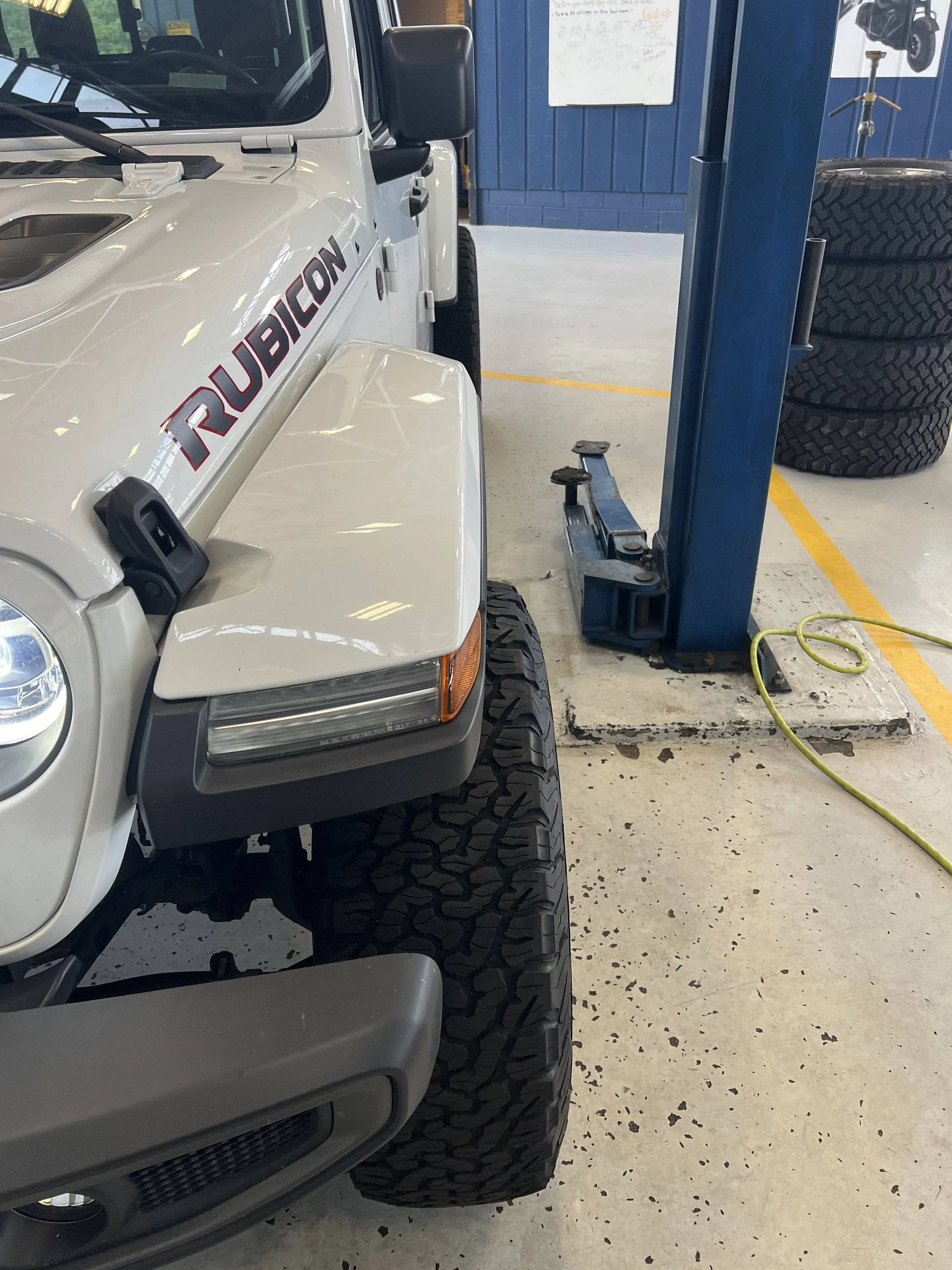

Okay!!! It’s here! What a crazy ride with the dealer to get it in my driveway. I said I would post follow up pics. The poke is more than I would like. Eventually when these 12.5’s wear out, I will move to a skinnier 35”. Just got home last night with it, and started work on it this morning.
Jeep Gladiator Rocktrix RT112 wheel in a -12 or +12 offset? IMG_2740
Jeep Gladiator Rocktrix RT112 wheel in a -12 or +12 offset? IMG_2738
