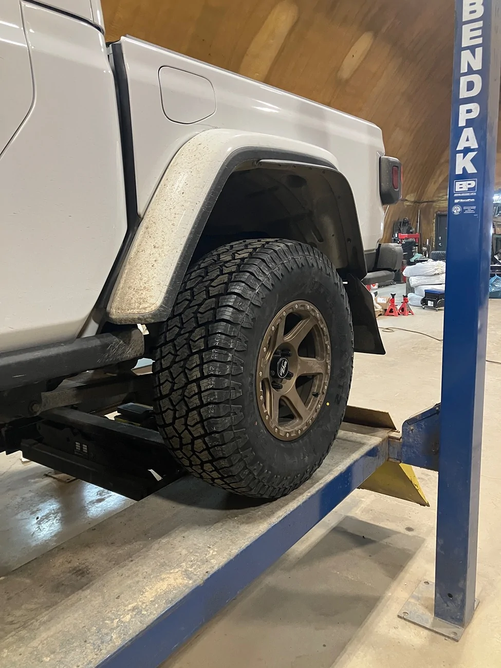

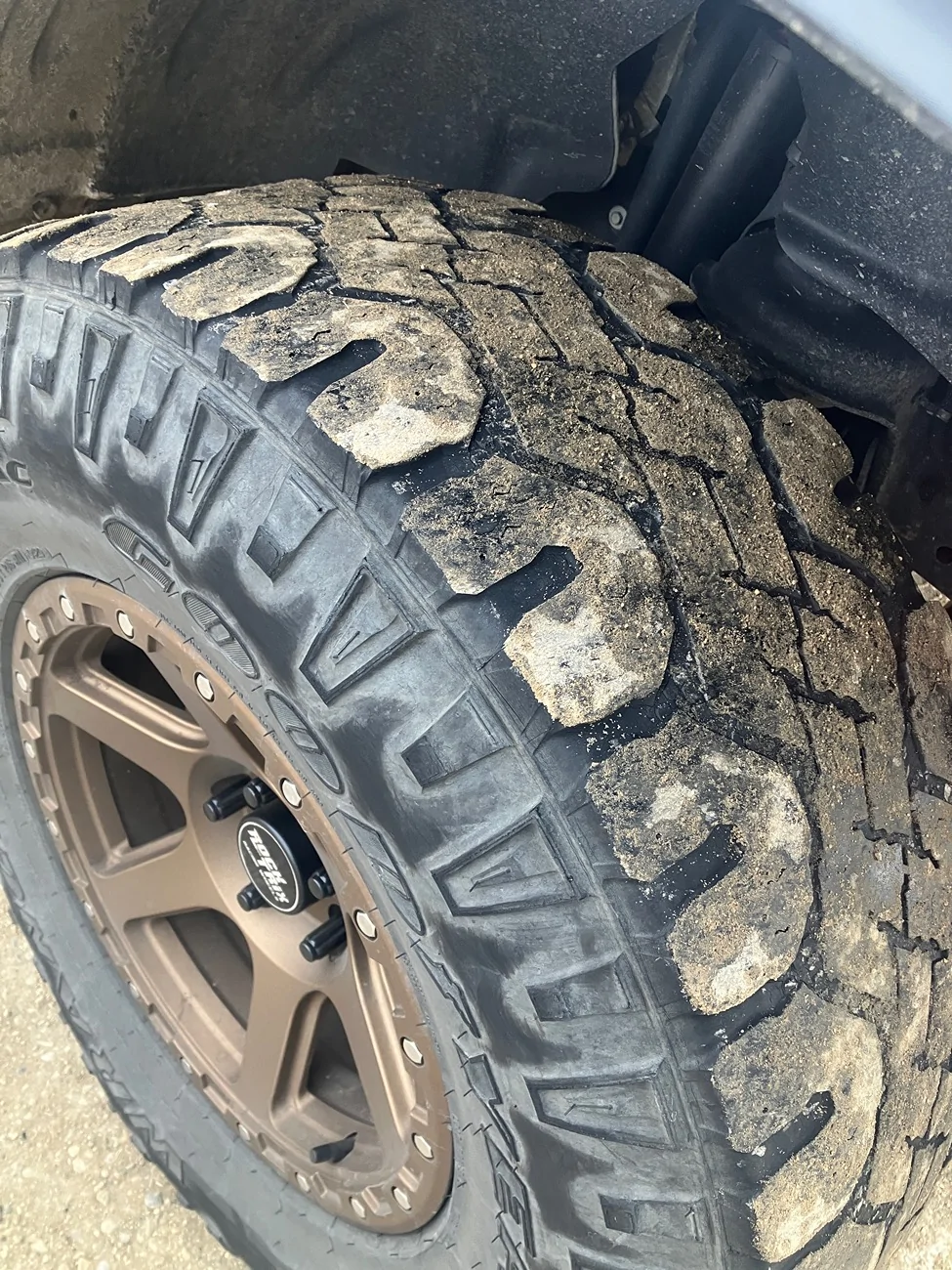

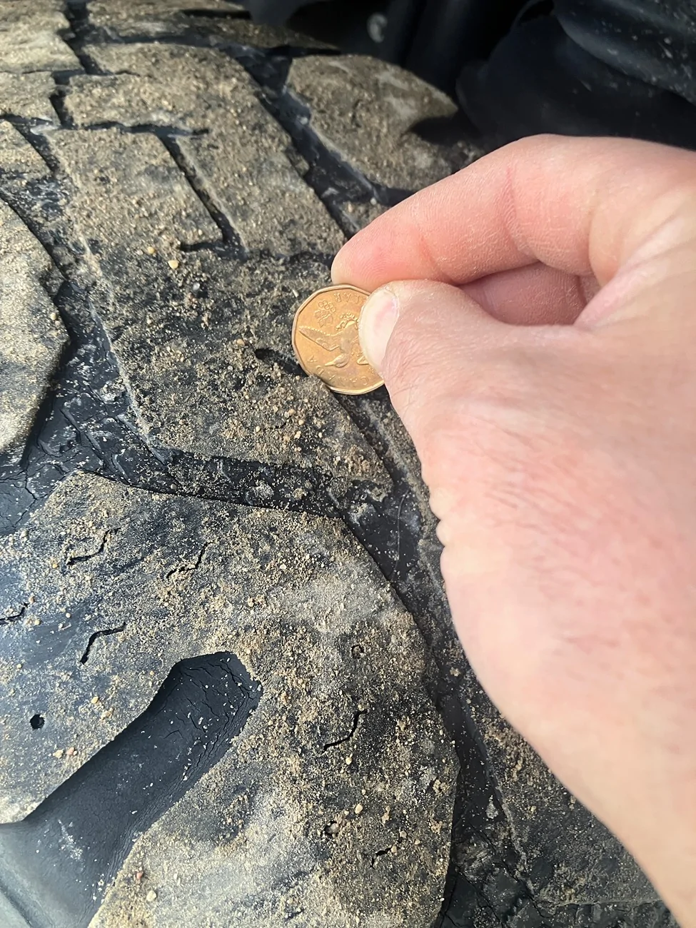

Bringing this back up from the depths.
Time for some new boots. I have gotten almost exactly 106,000kms out of these tires. Crazy. I think I got my use out of them!
Jeep Gladiator Rocktrix RT112 wheel in a -12 or +12 offset? IMG_6146
Jeep Gladiator Rocktrix RT112 wheel in a -12 or +12 offset? IMG_6147
It’s in the shop now getting 35 12.50 17 sailun terramax AT’s. I wanted the RT’s but we recently moved and will be doing lots of highway. I’ll post a pic of them once they are mounted.
I originally wanted 37” BFG’s, but until I can get the front end upgrades done, I didn’t want the wife to have any issues with anything.
