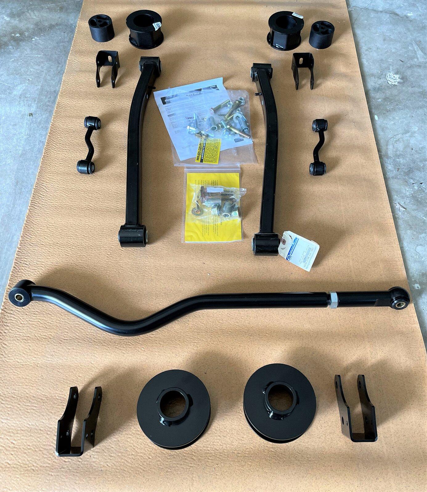

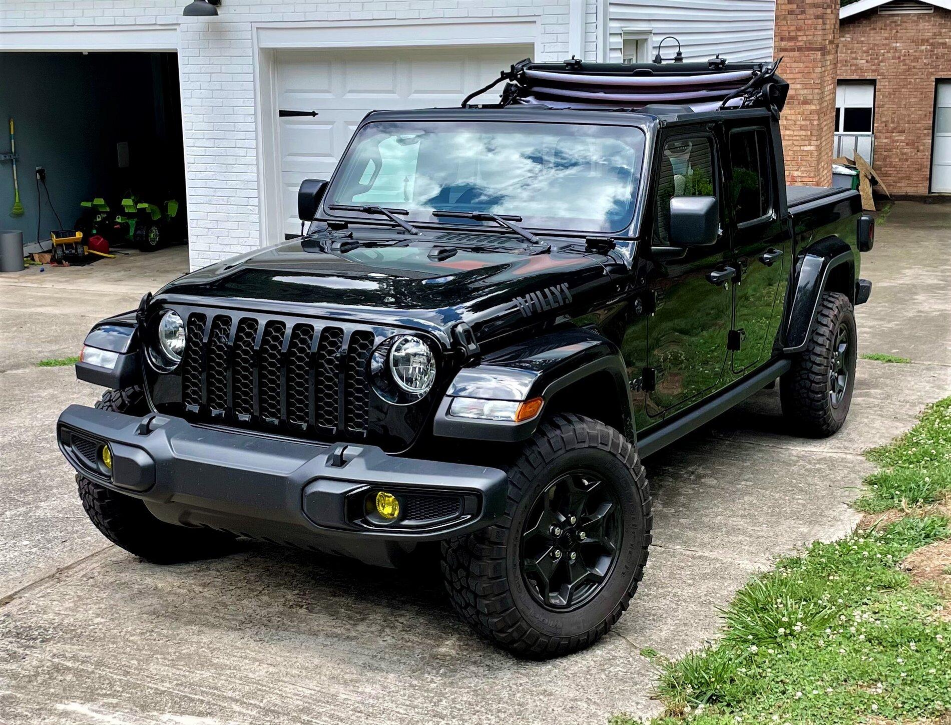

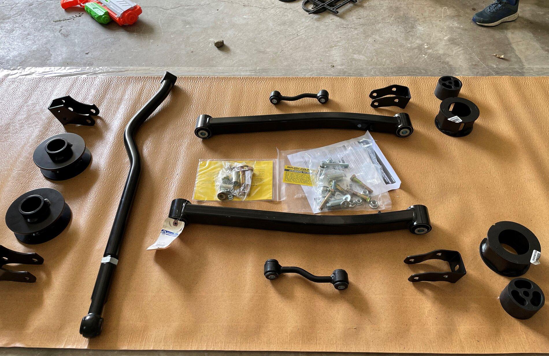

Couldn't find exactly what I was looking for in an out of the box spacer lift, so combined a few different brands that I'll be installing later this week. Was just looking for a little more ground clearance for the trails around here, keep the factory rake and ride, and look a little taller when I stare at it in the driveway ;)
Thanks for all the help on the boards answering questions, great resource and people here!
So this is what I went with:
2.5" Rough Country leveling kit for the front, which includes the 2.5" metal spacers, shock extensions, bump stop extensions and new sway bar links. ($99 for this kit from Amazon). Wanted the full 2.5" for when I put the bumper/winch on in a few weeks.
2" Iron Rock rear spacers ($85) and shock extensions ($50) from Iron Rock directly. Wanted more than just the .75" Daystars because I do tow and haul and can't stand the low back end look. Plus I like some factory rake.
Poison Frog adjustable front track bar to keep the axle centered ($159 from Amazon). Got a good review on here not log ago, and looks great in person, figure worth a try.
Mopar extended front lower control arms from their 2" lift kit ($83 w/shipping for both from AllMoparParts.com).
Only other parts I'm still tracking down are extended rear sway bar links, anybody have a good lead on these? Go with the Mopar ones from their 2" lift kit, or from somewhere else? Don't see a ton of options.
I'll install these when I install the Hellwig oversized rear sway bar ($250) once it arrives. Want this because I'm a big believer in a beefy rear sway bar, always an awesome improvement when cornering on the street in all the trucks I've upgraded.
Also deciding on rear extended bump stops, not sure what best option would be. Could get a set from Iron Rock, any other better options? I've used SumoSprings and Timbrens on other trucks, they any good and a viable alternative on the Gladiator? I'm assuming I would want extended bump stops ideally with the 2" shock extension? I know they aren't included in Iron Rock's 2" full spacer kit though, so maybe not needed?.
Well, sorry for the wall of words, here are the parts laid out.... now just need to find some time in the next few days in the garage to get it installed.
Will be going on my '21 Willys Sport, stock M/T's and wheels with 1.5" spidertrax spacers. (I know I know, if money was no object they'd be 37's with 5.13 gears and a Magnusson supercharger too) :CWL::CWL::CWL:
Parts and a BEFORE INSTALL PICTURE, will post an after install once complete in a few days:
Jeep Gladiator Rough Country/Iron Rock 2.5"/2.0" combo lift install w/pics 20210616_173014818_iOS (2)
Jeep Gladiator Rough Country/Iron Rock 2.5"/2.0" combo lift install w/pics 20210616_173034145_iOS (2)
Jeep Gladiator Rough Country/Iron Rock 2.5"/2.0" combo lift install w/pics 20210611_165647907_iOS (2)

Interesting. Looking forward to seeing the finished result.

Check Synergy for front and rear sway end link relocation brackets.

Readylift makes a kit that comes with 2.5" spacers in the front and 2" spacers in the rear, that's what I'm running on mine. It's a complete kit other than the lower control arms, $429.

I was going to say, I ordered the Mopar end links myself. Good call.
This week! I added the Mopar 2" lift rear sway bar end links to complete the setup that arrived yesterday, should have time to install in the next few days.
