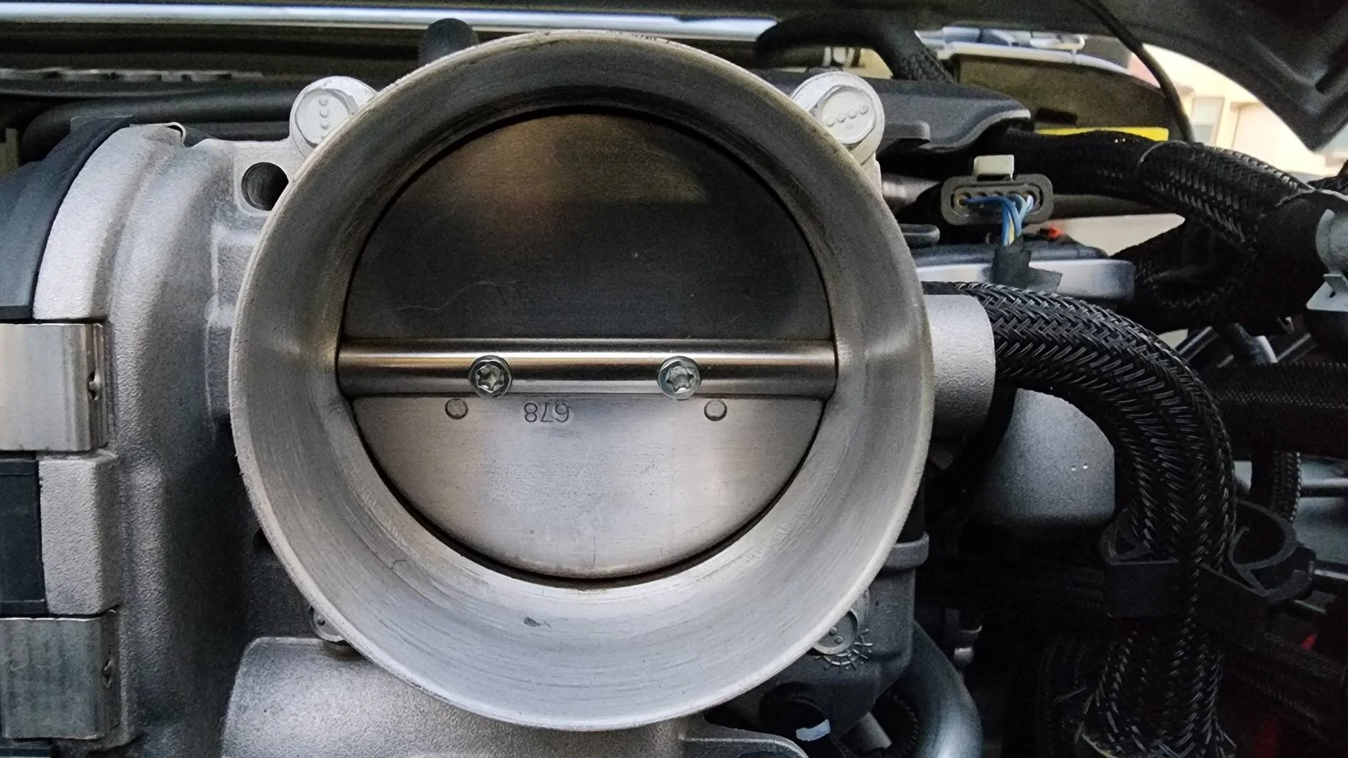

I like it. Thanks. Any pictures of it before you cleaned it up?
Jeepmonster
Jun 1, 2020
499
1,579
Socal
2020 JTR, 1968 Chevy C10
Here's a picture, but I had already wiped a good amount off before I removed the throttle body. You can still see some dark build up on the upper and lower edges of the blade as well as the surrounding area. It was getting dark, so I had to hustle.

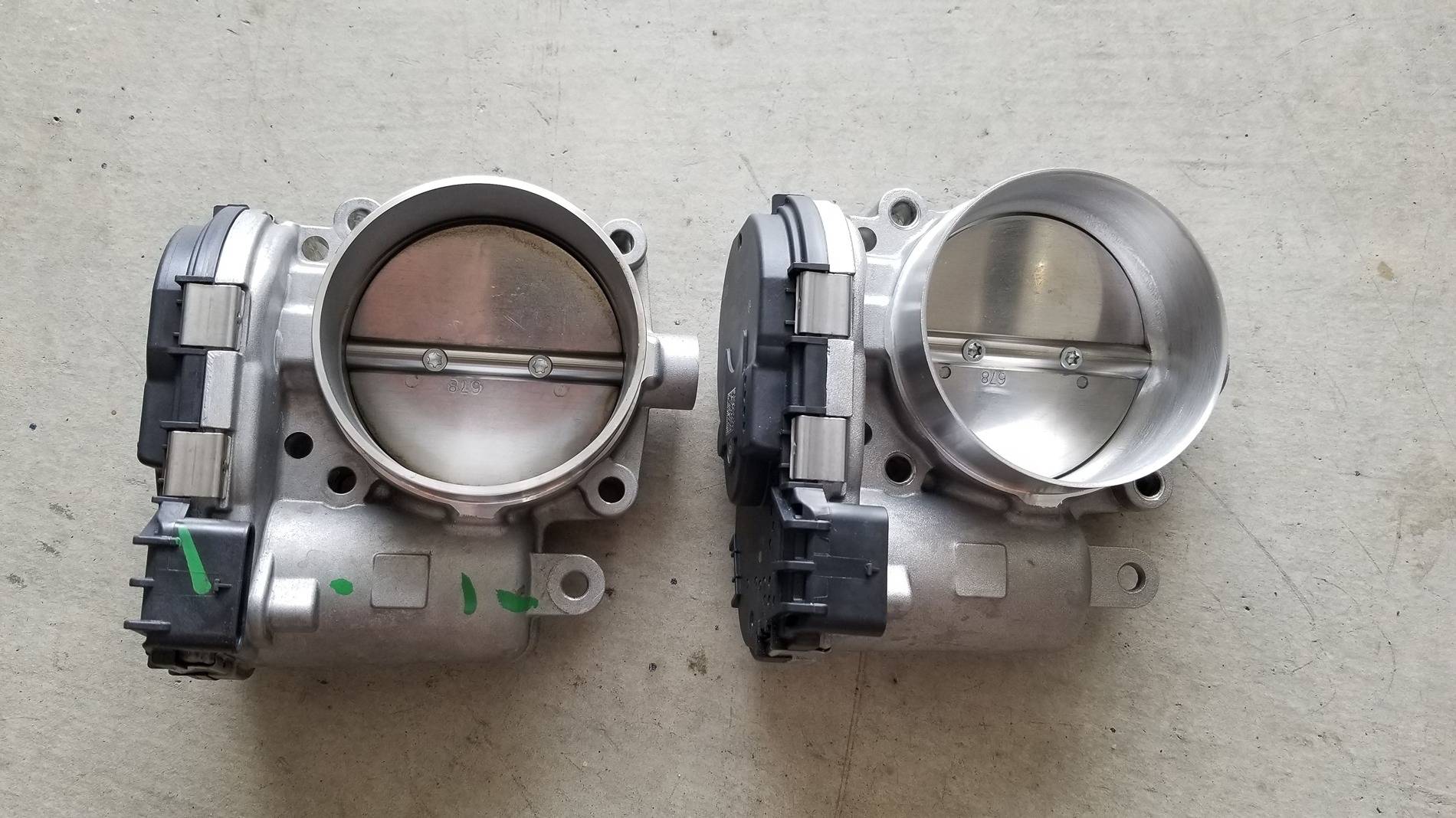

The oil mist comes from the breather tube just right after the air filter box. It doesn't take much to get the throttle body dirty. Below is a picture of the stock throttle body next to the new one I put in (about the time I installed the Mopar CAI kit). You can see some build up on the stock one (left) when it had about 8k miles on it. The one I replaced it with is one from MMX (Modern Muscle Xtreme). It's a factory part with material removed for better flow. With the CAI, it did make a noticeable difference.

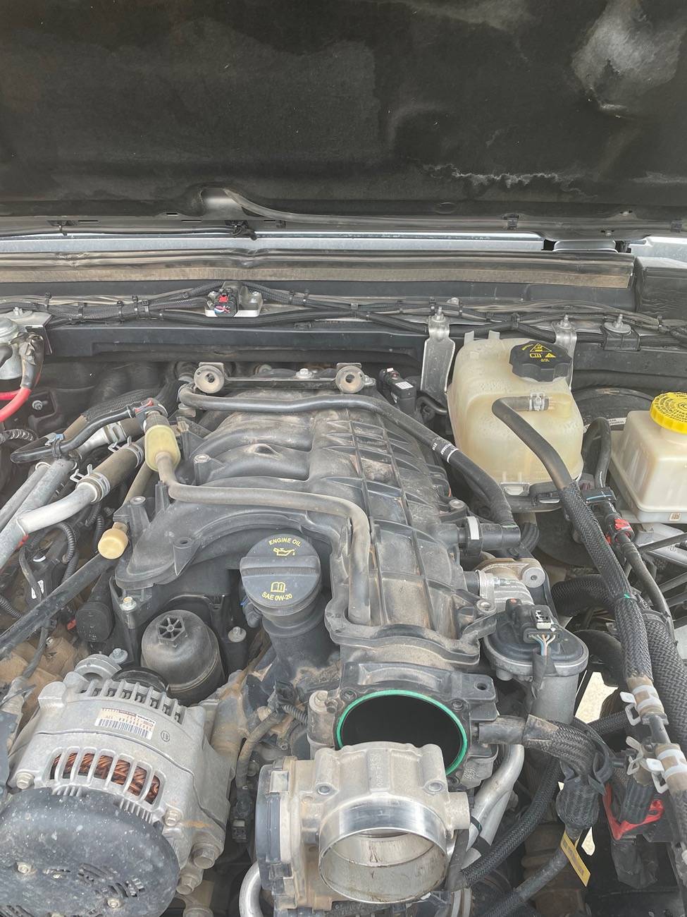

Mine is definitely worse than yours in that picture. Golden brown tarnish sound like what yours was?
WILDHOBO
Sep 24, 2021
78
12,821
19,692
2021 Gladiator Rubicon
Network Engineer
This isn’t a straight on picture, and is from August 12th, but it’s somewhat visible. I’m assuming you used carb clean, @Jeepmonster?

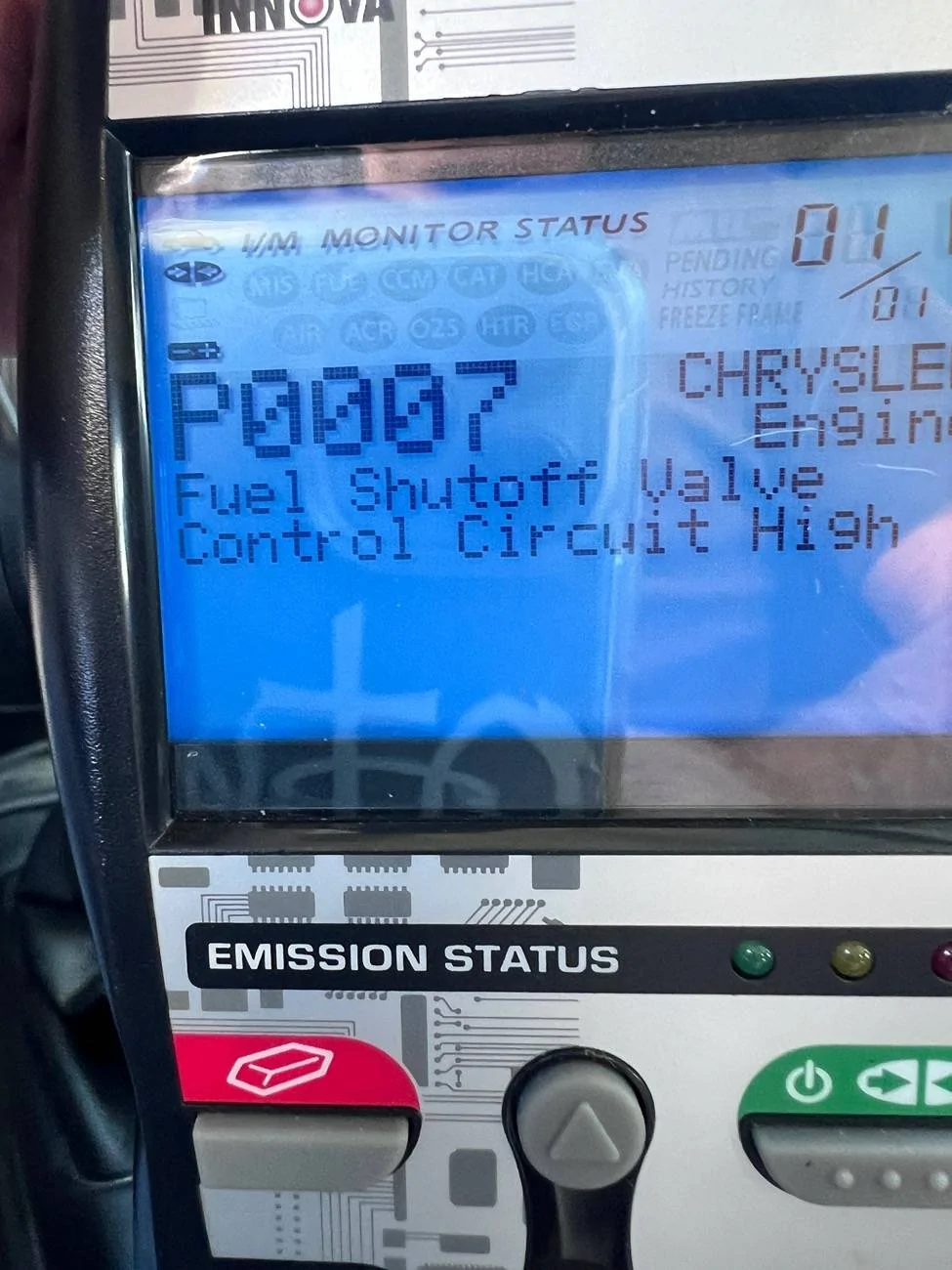

The dealer replaced my engine under warranty because of metal in the oil.
At around 2k miles my new engine developed the cold start rough idle. Once it warms up it goes away.
Today I ran the OBD2 on it and in the advanced DTC section I found the P0007 code.
Jeep Gladiator Rough then smooth(ish) idle after startup IMG_2073
I have already made an appointment with the dealer service before I ran this test and I’ll take it to them and let them fix it.

The dealer inspection on mine showed everything to be okay. Their equipment didn’t find the P0007. The rough idle is pretty slight and they said that was normal. I figured I would go with it and since I had them check it out I am covered on warranty in case anything bad does develop.
