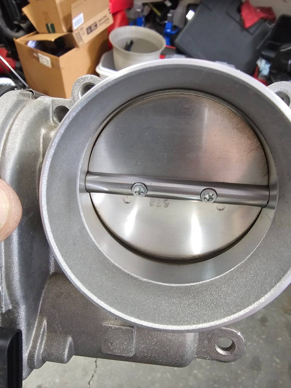

Maybe I should have, but I didn't disconnect the battery. I just disconnected the harness from the throttle body and removed it for cleaning.

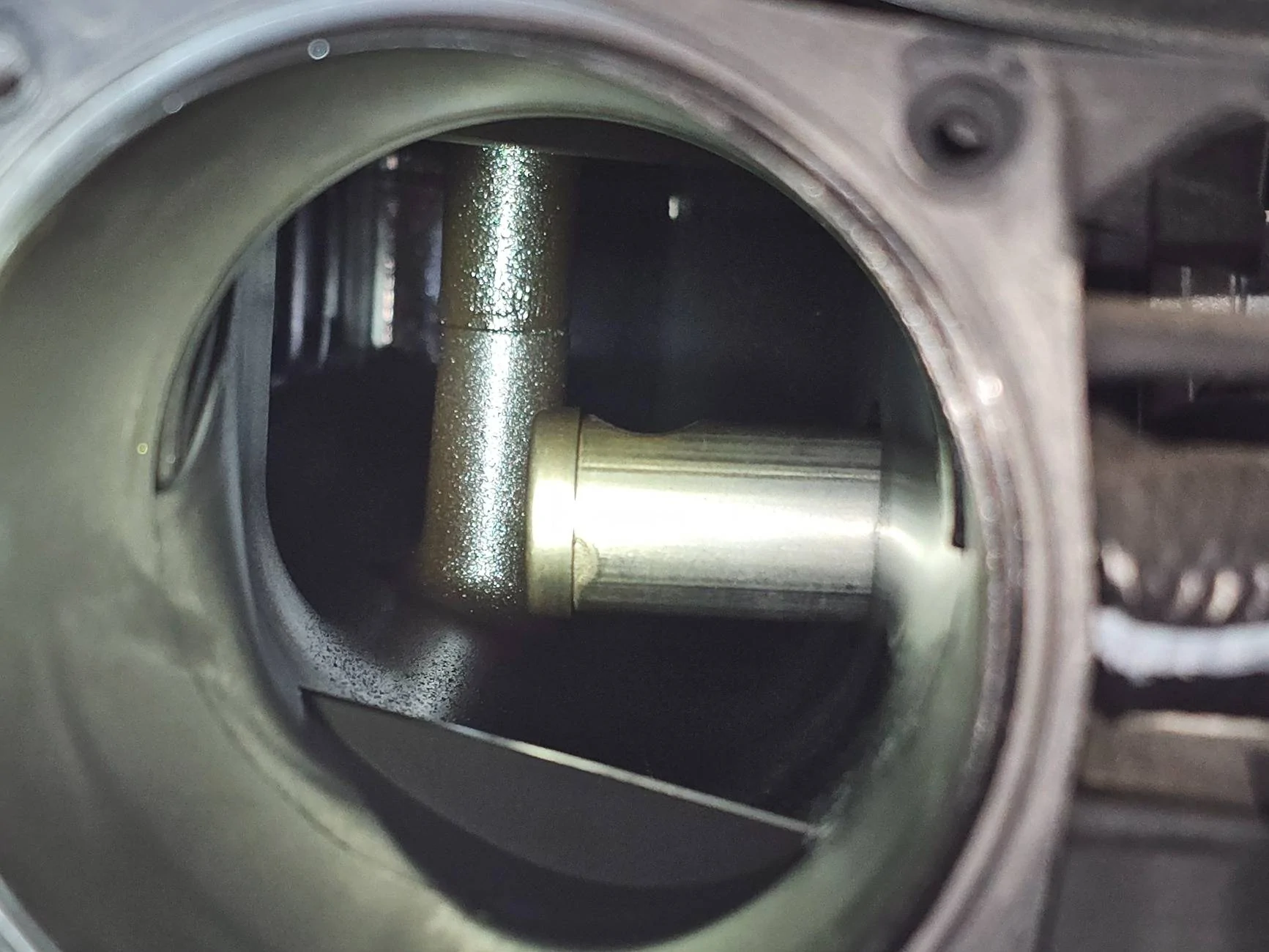

Is it supposed to be that oily in the intake? Only have 28k miles.
Jeep Gladiator Rough then smooth(ish) idle after startup 20241227_114834
Jeep Gladiator Rough then smooth(ish) idle after startup 20241227_114135
Jeep Gladiator Rough then smooth(ish) idle after startup 20241227_114241

Was there alot of oil residue in your intake?

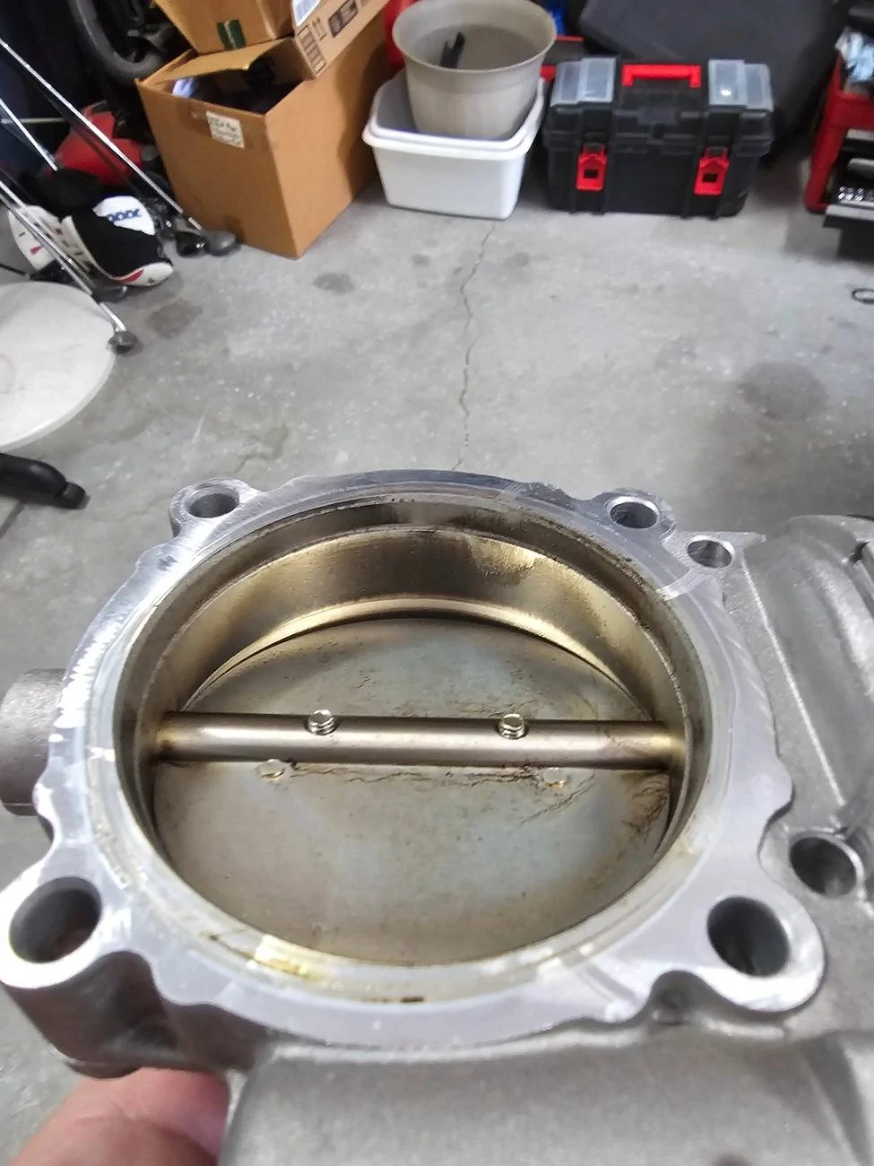

Yes, I had oil in my intake. To me, it looked normal/typical. The throttle body had some dark varnish-like residue (age and heat), and there was light wet oil upstream. Likely source is from the crankcase vent between the air intake box and throttle body.

I took off and cleaned the throttle body and it didnt do much. Not as rough but its still there.
