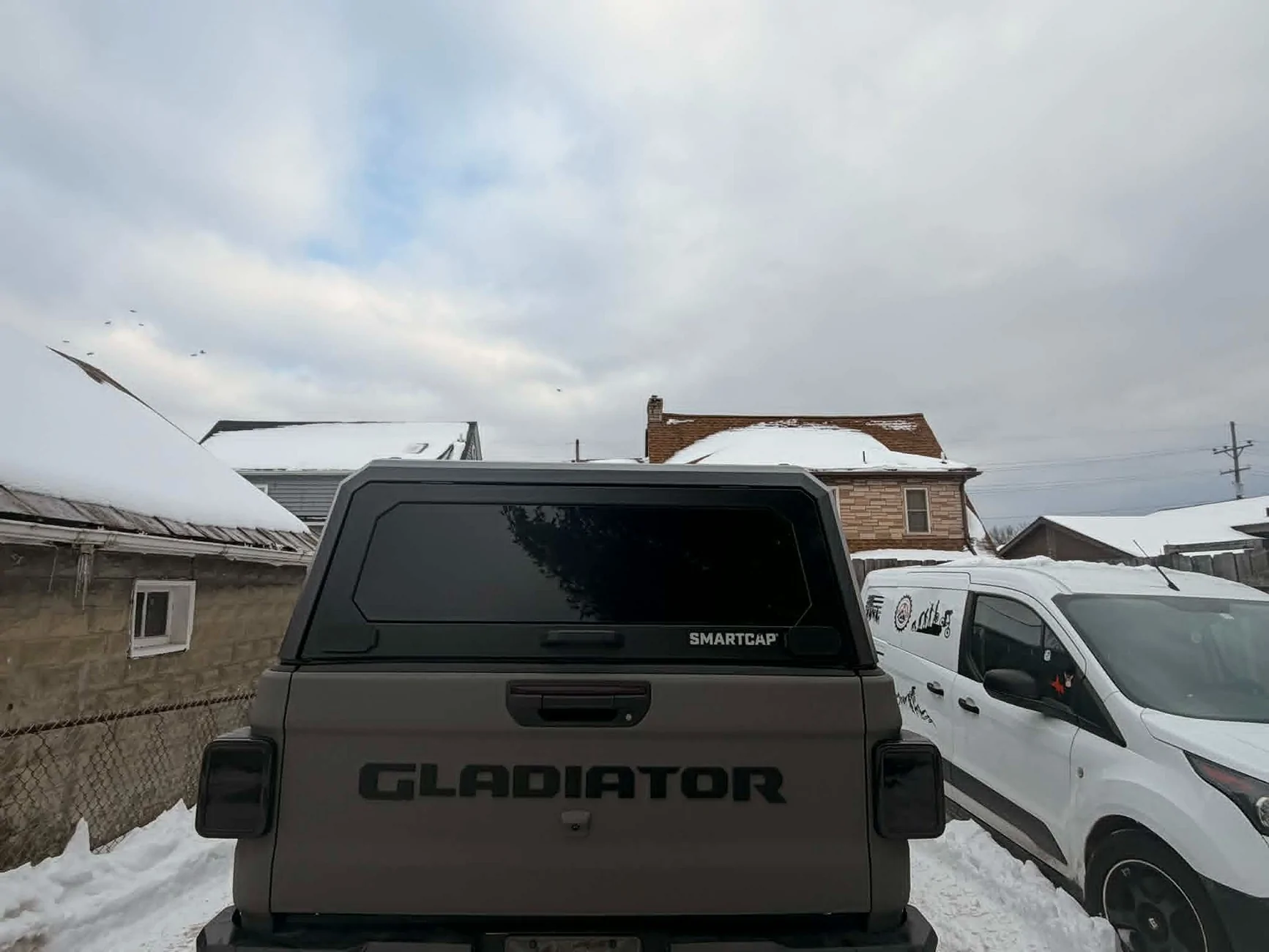

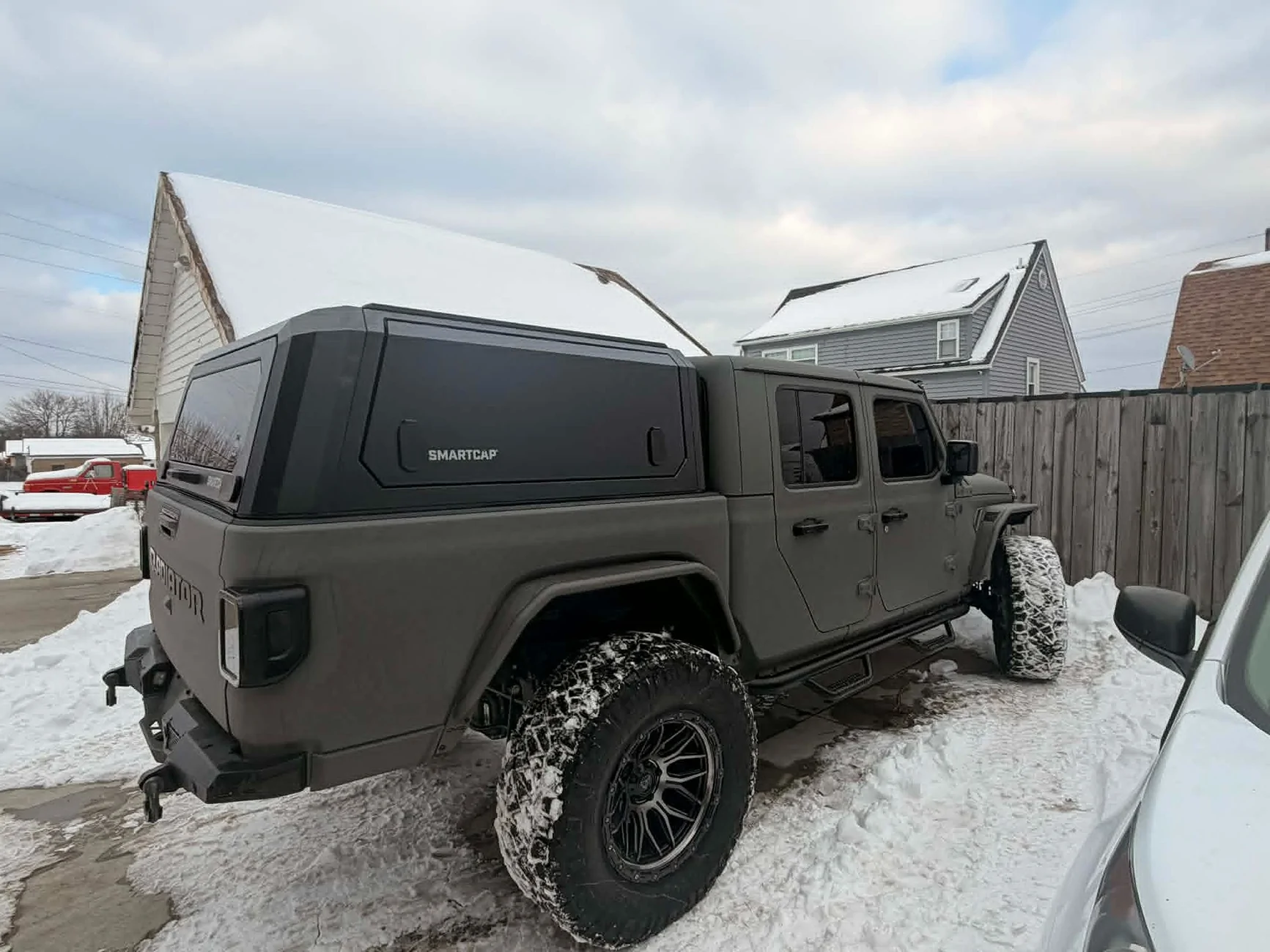

Not too bad. Heavy, thankful to have some help lifting this onto the jeep. Now to figure our what accessories I'll need for it.

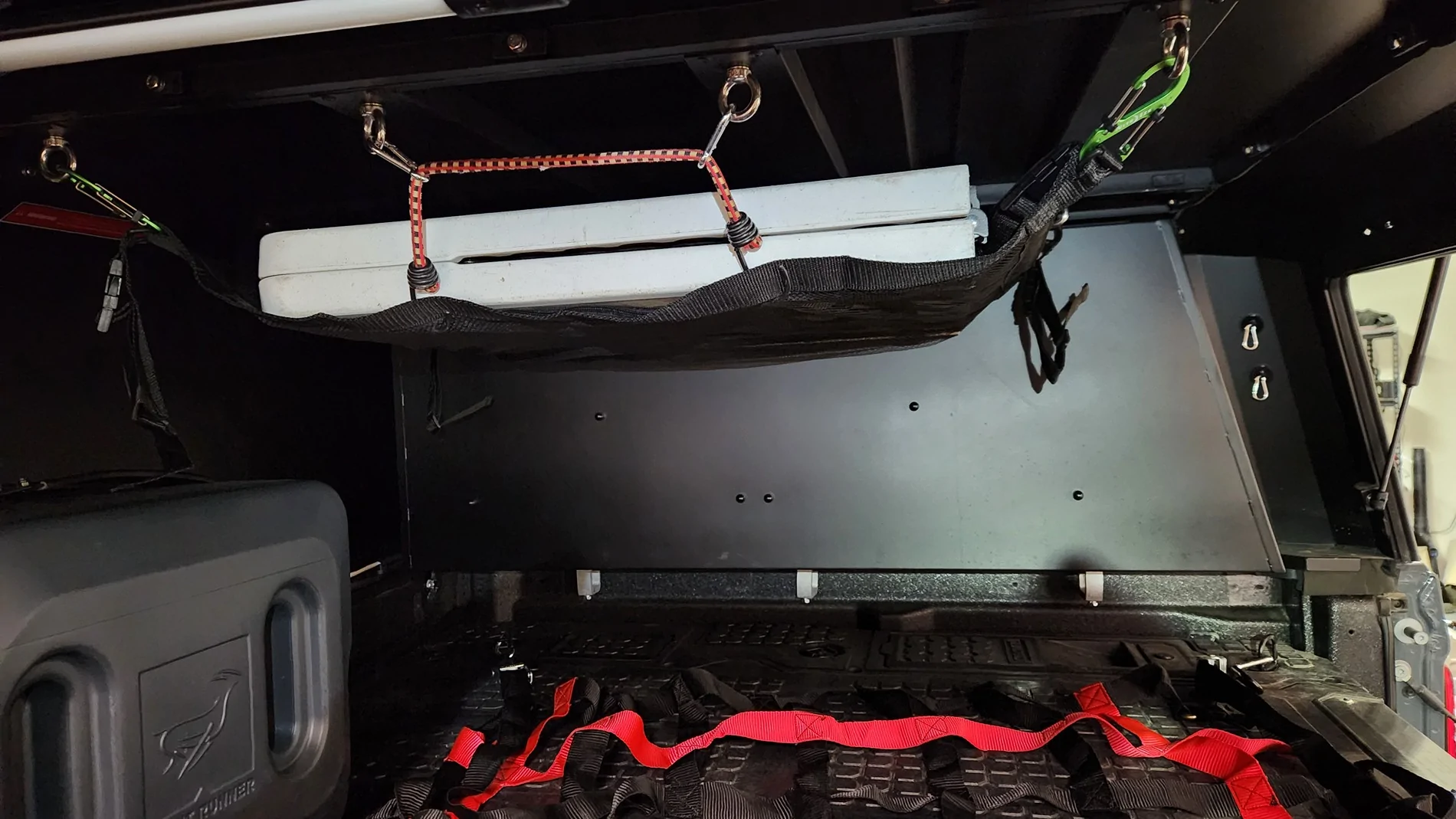

  • Also, if you didn't opt for the stainless table that RSI sells, don't forget about the threaded M8x1.25 attachment points in the ceiling. I grabbed some stainless eye bolts and hung a motorcycle cargo net up there. It's currently holding a small folding table, but it has also held work gloves, boots, and recovery gear this winter as well.

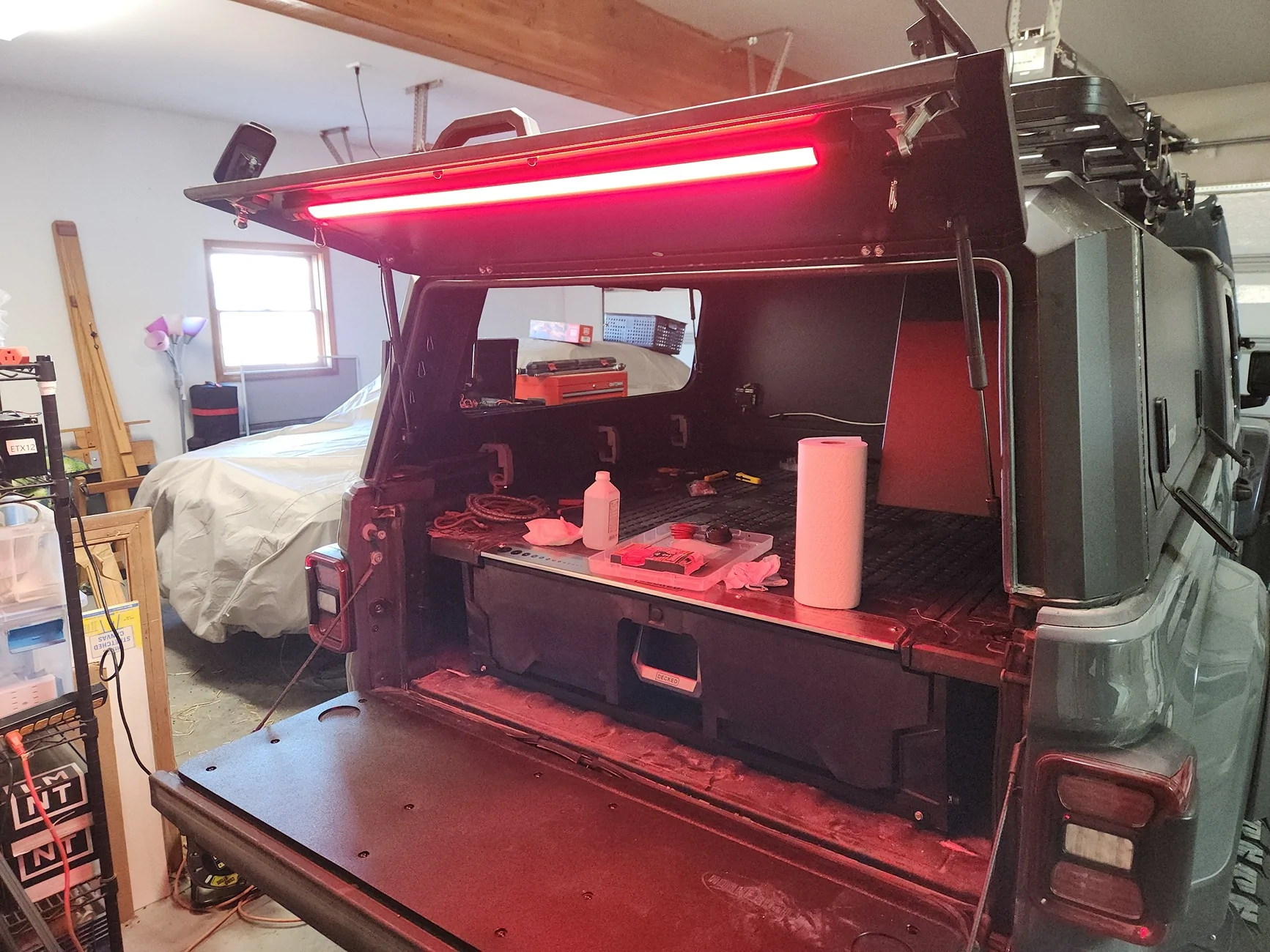

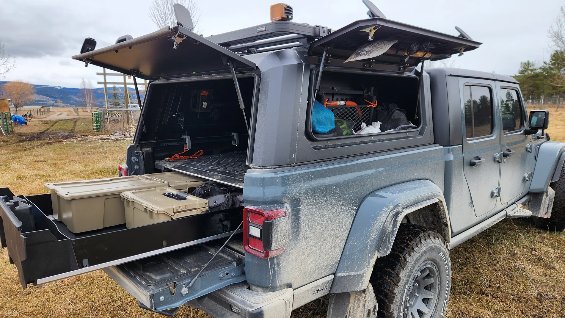

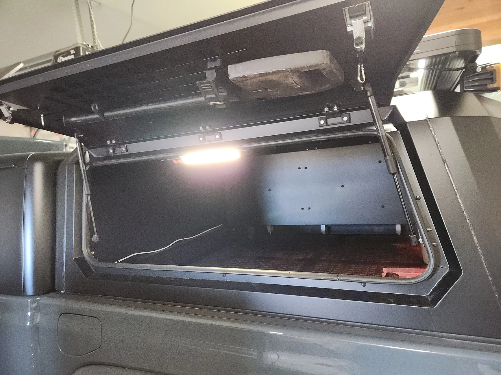

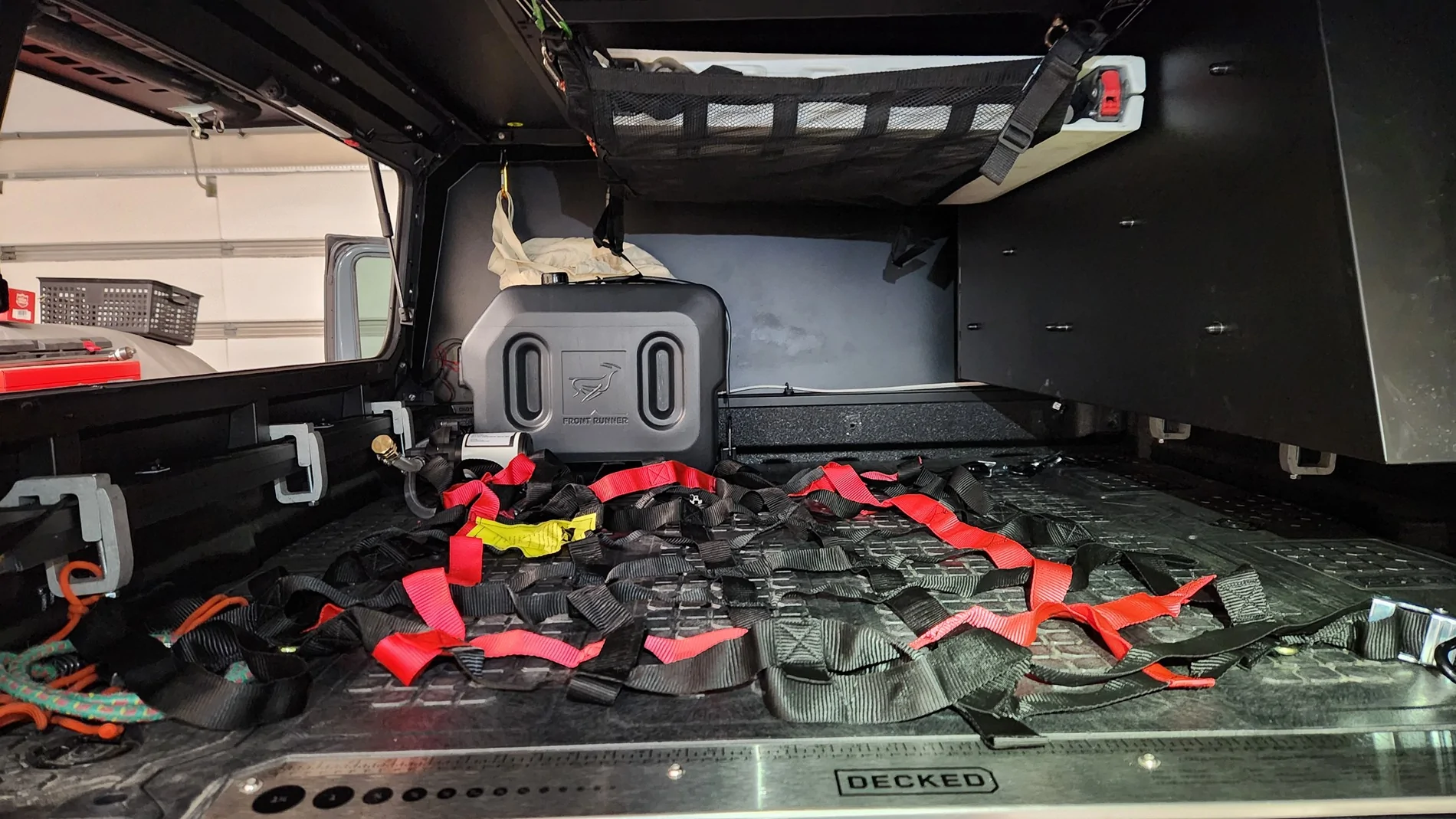

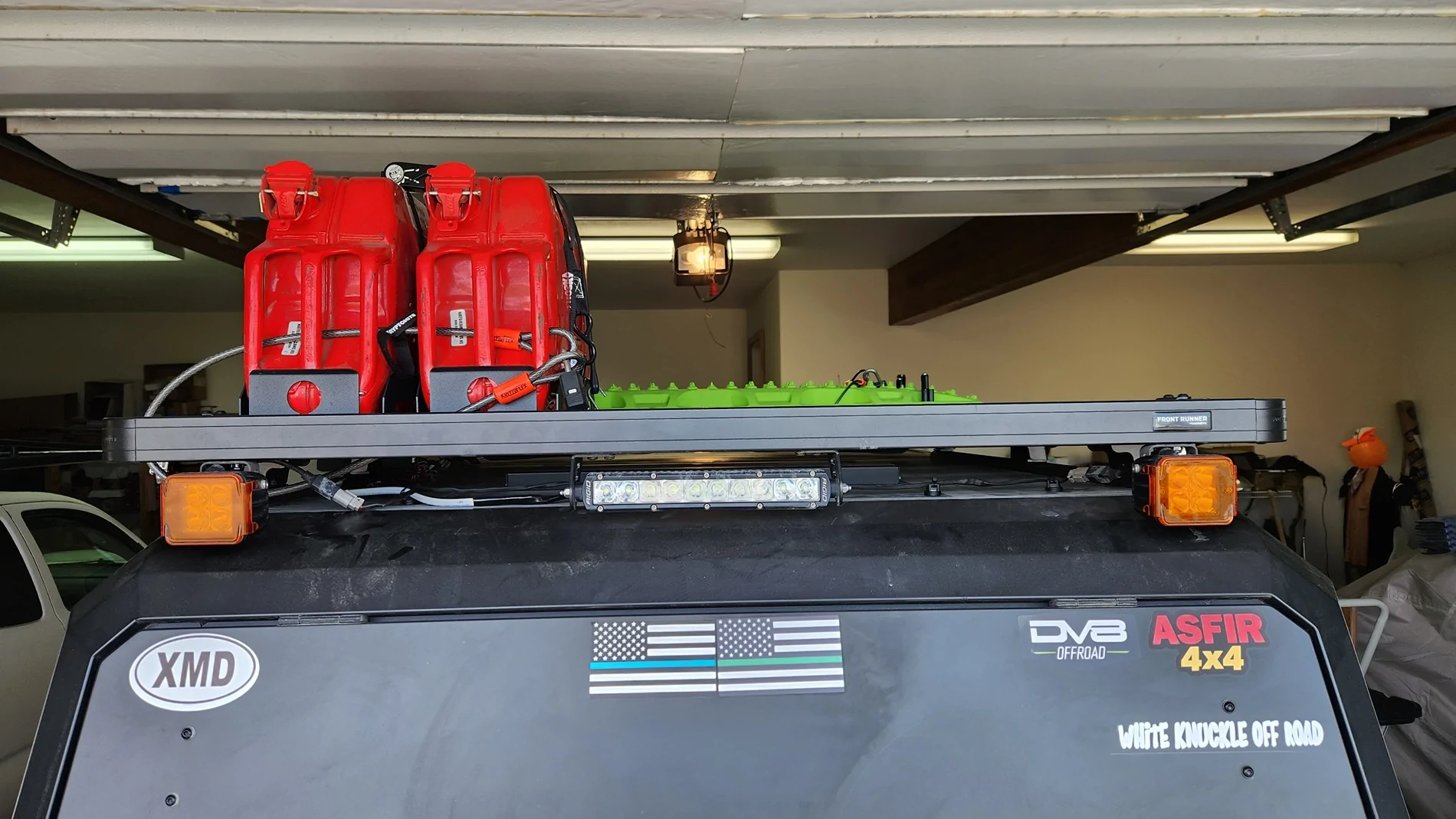

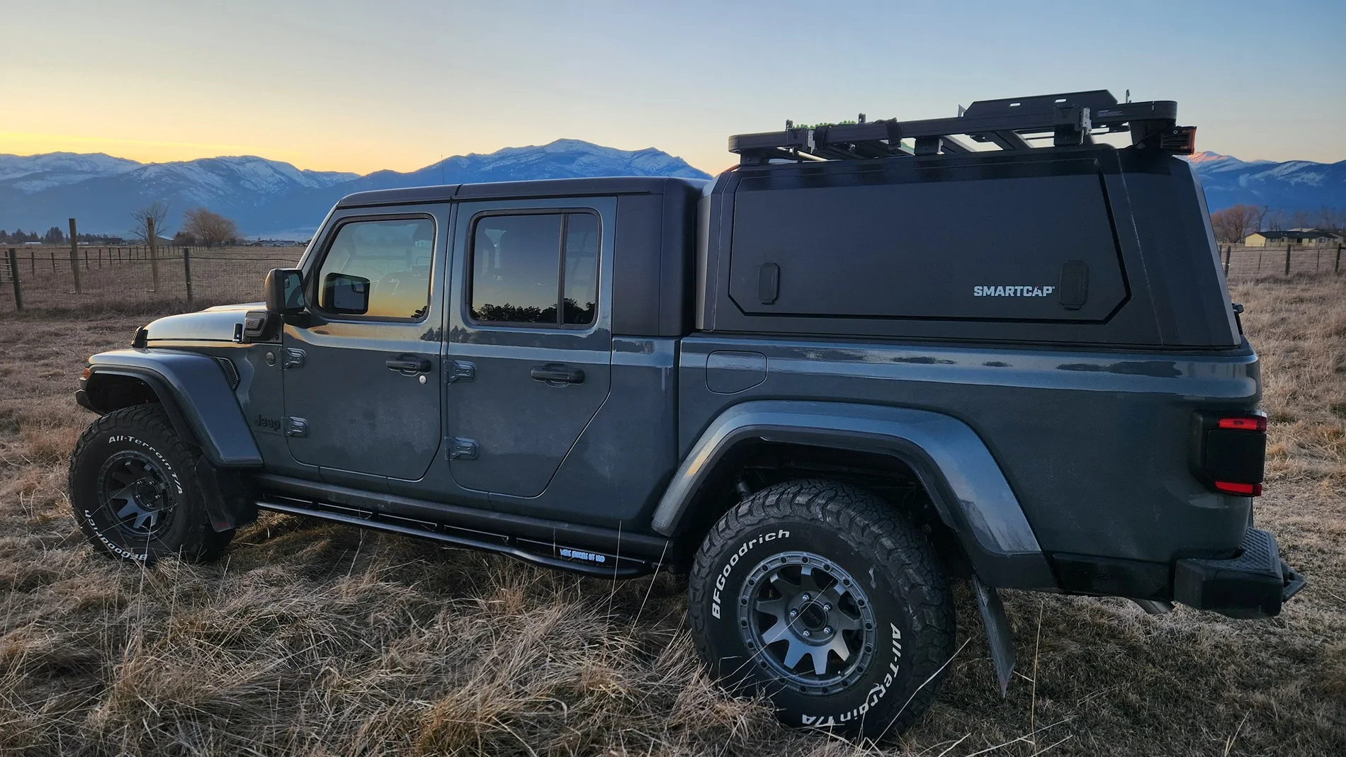

Jeep Gladiator RSI Adventure Cap 20260125_172542
Jeep Gladiator RSI Adventure Cap 20260104_111829
Jeep Gladiator RSI Adventure Cap 33e157b2-eedb-4897-81f0-8576f282b24c
Jeep Gladiator RSI Adventure Cap 20260123_183740
Jeep Gladiator RSI Adventure Cap 20260123_183726
Jeep Gladiator RSI Adventure Cap 20260201_140421
Jeep Gladiator RSI Adventure Cap 0e954e8f-5499-4e14-ad02-44b3c778caf7

Nice set up! did you install the decked system yourself? I have one getting delivered tomorrow. if the weather permits, I'll hopefully get it in on Sunday
CKayaks
Cass
Jun 20, 2025
75
105
Montana
2025 Gladiator Willys; 2010 Nissan Xterra Offroad; 2018 Ram 2500
Thanks!
Yes, I assembled the Deck system myself. Easy install. Another set of hands would have helped but easy to leverage it up into the bed by myself. Putting it in before I put on the SmartCap would have been a whole lot easier! Had to crawl in to get to the corner turnbuckles.
