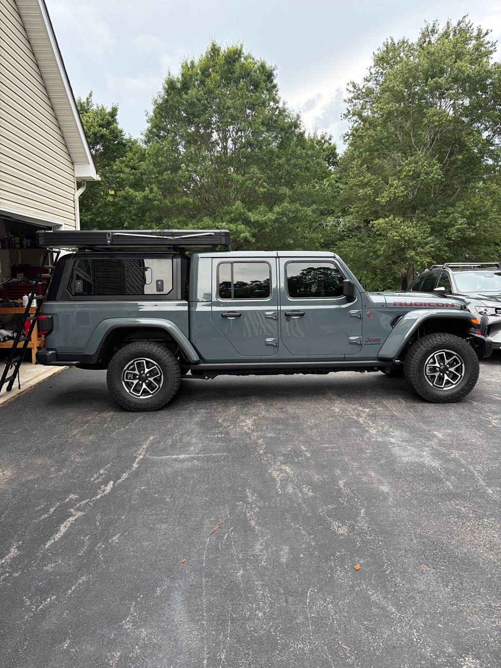

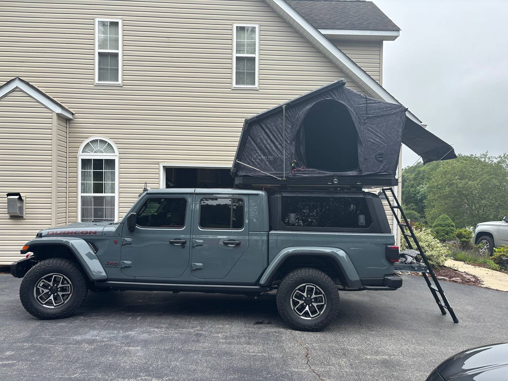

That vent will definitely hinder the ability for a flush mount.

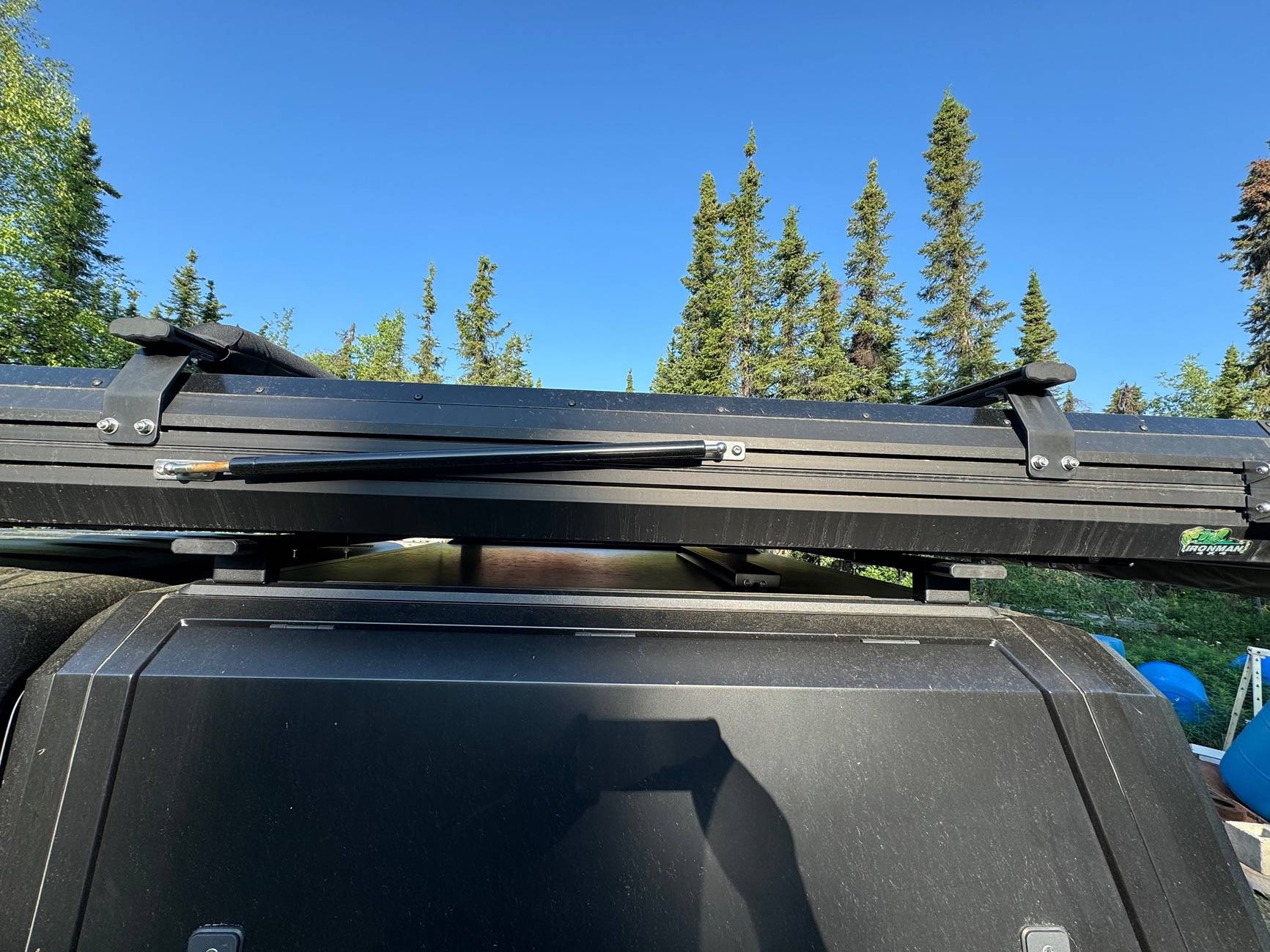

My RTT has two base bars running parallel to the smartcap channels, but well inboard. The crossbars are needed to make the attachment perpendicular to the RTT base bars. You would need a RTT that mounted perpendicular to the smartcap channels to have any chance of attaching to the vertical bolts protruding out of the smartcap channels.

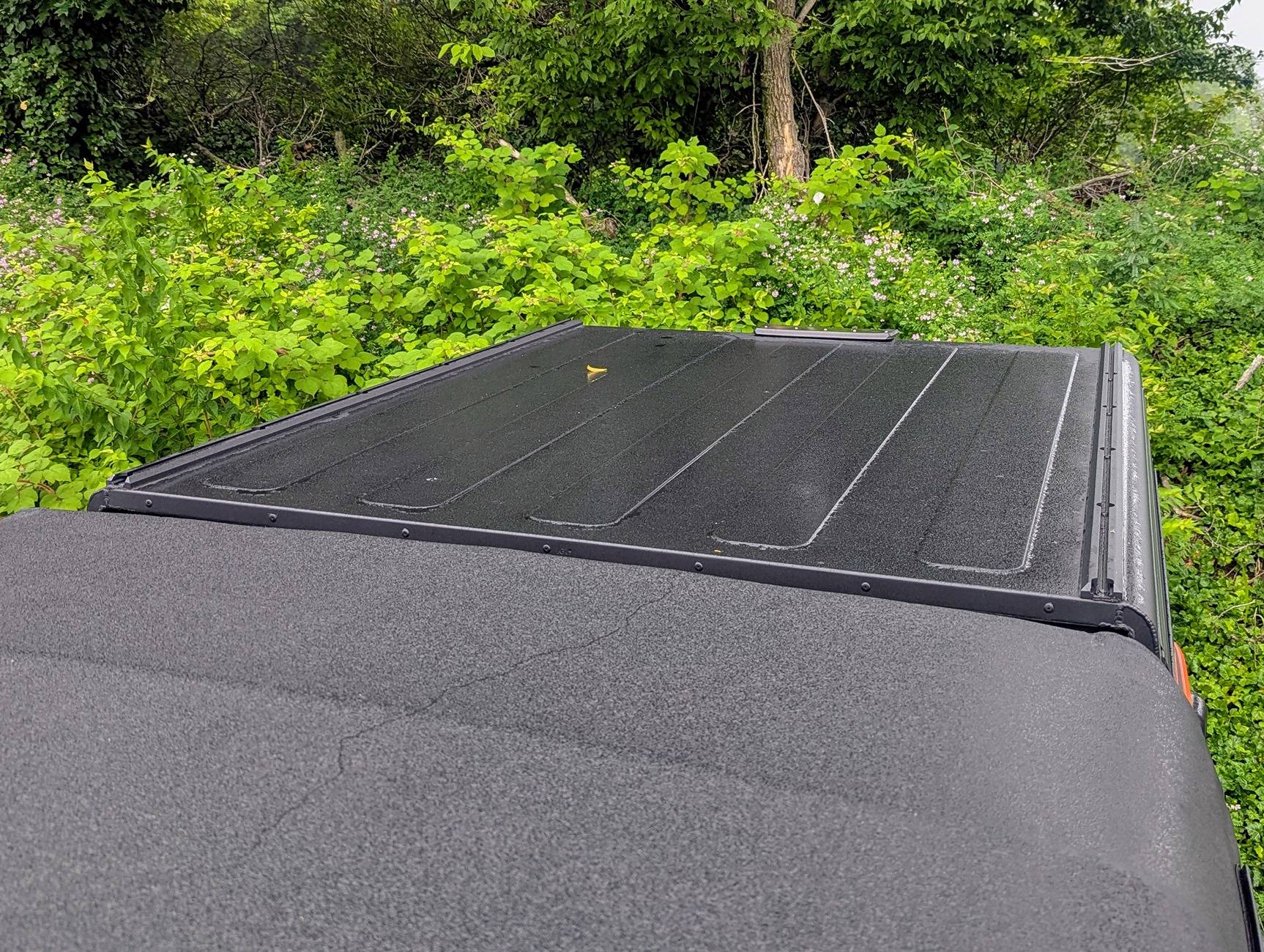

Take a look at the top of my Alu-Cab "Canopy" cap. (Ignore the black lump at the center rear. That's a home brew rear view camera mount )
Jeep Gladiator RSI Smart Cap with Roof Top Tent 1000006115
The top is flat except for the two slotted mounting rails. The fresh air vent is on the front of the cap.
The Alu-Cab is lighter than the RSI and comes as one piece. No gasketed joints to loosen and leak in the future.
