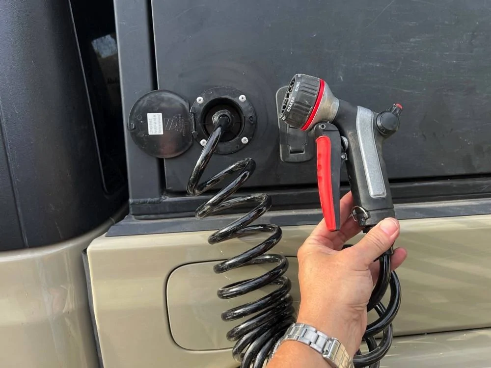

I don't know what your offroad experience is but, man, I even had a ton of heartburn doing this for fear of it getting caught by trees branches:
Jeep Gladiator RSI Smartcap 25_ExteriorShower_1
Jeep Gladiator RSI Smartcap 25_ExteriorShower_2
Jeep Gladiator RSI Smartcap 25_ExteriorShower_3
I finally decided that i can buy a replacement canopy door if "things go sideways."

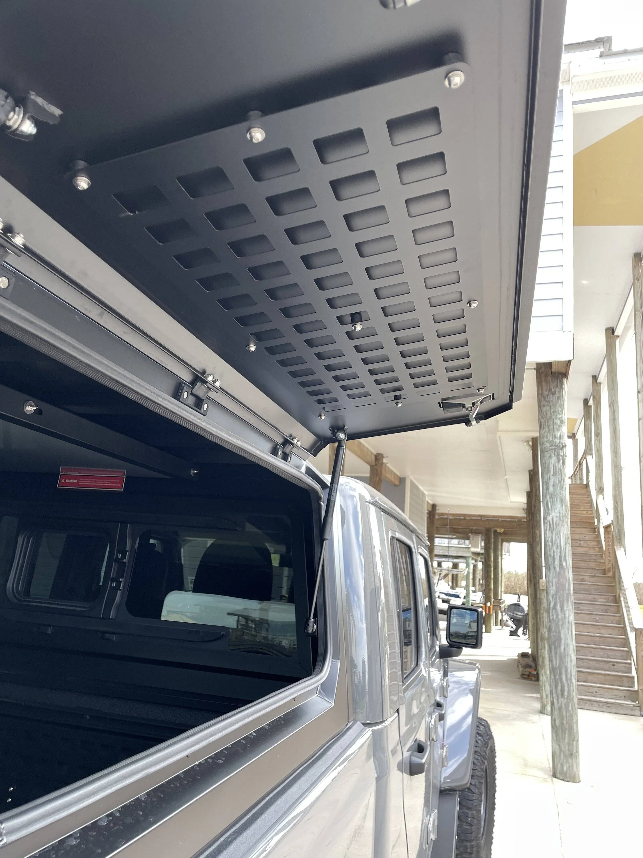

well .. I’m new to all this with my vehicle !! The smart cap does have inside wing doors molle panels
Jeep Gladiator RSI Smartcap IMG_7057

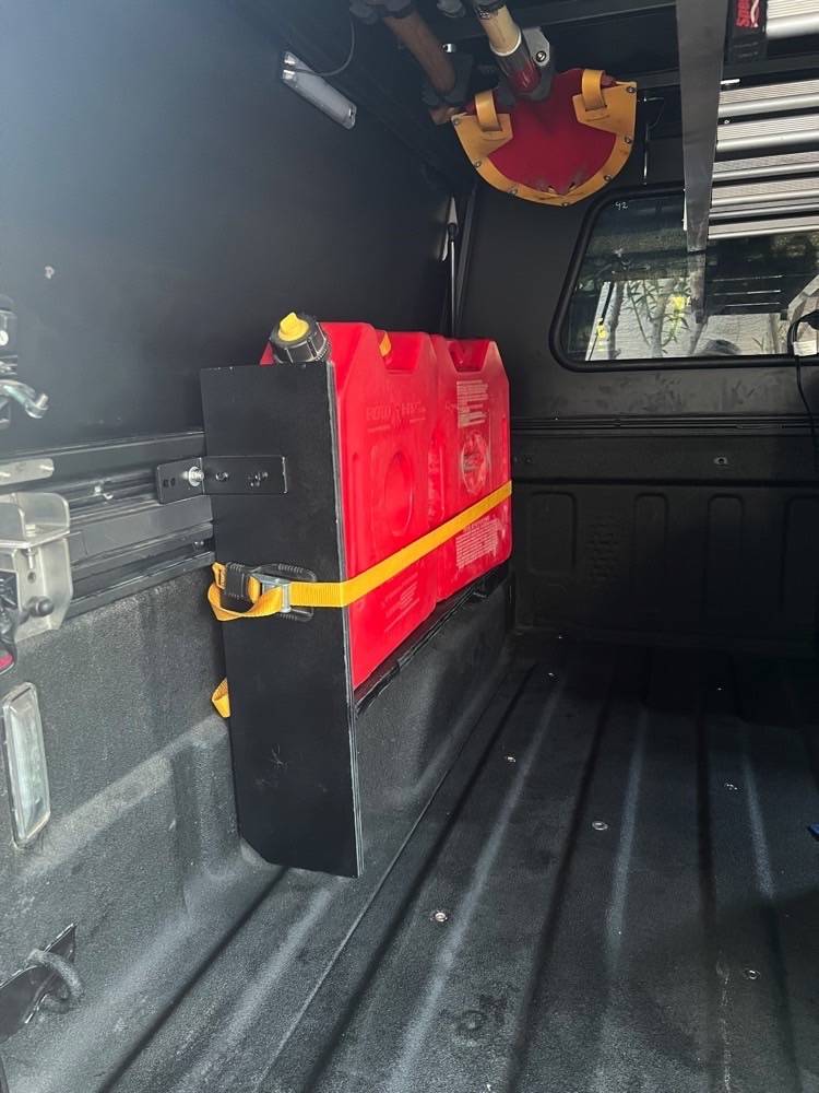

I get wanting to hang some rotopax off those doors but that’s a lot of weight hanging there waiting to tear a door off: 3 gallon RotoPax at 6lbs/gallon is 18 lbs plus the weight of the rotopax and associated hardware. If you try to hang 2 of those on one door, that’s over 40 pounds on that door. That also makes opening the door difficult. Mount them in your bed. That also keeps the weight lower and center of gravity lower.
I built a little rack over the wheel well:

I have been contemplating where to mount fuel as well. I don't like the idea of having it INSIDE my SmartCap, thinking the fumes/smell will annoy the heck out of me. Hanging on the side, have the same concern as mentioned about scraping and dealing with the weight on the doors when opening. So far the only other option I have seen without going on a roof rack are those that hang off the door hinges. Anyone have other solutions?

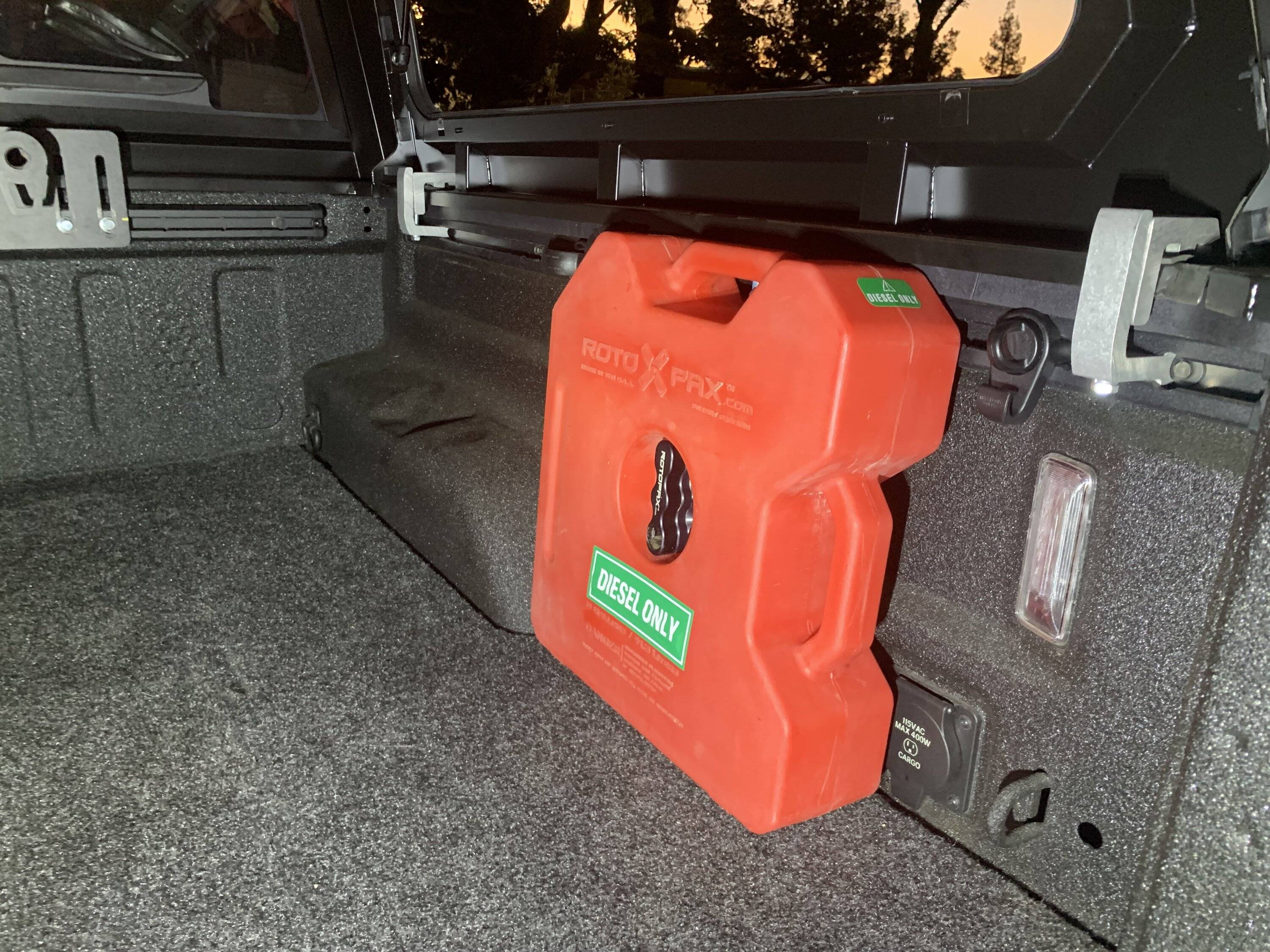

I keep some spare fuel in the bed and never had any leaks, just keep some extra gaskets for the Rotopax around for when they get old. My buddy has them on the roof rack on a JL, no leaks.

FWIW, I was agonizing the same issues. I really didn’t want to do the door hangers because I just wasn’t sure I liked the look. But I’ll be honest with you, I have not ever smelled the gas/fumes inside my canopy with a properly sealed rotopax. If you think about it, if you can smell it, then it means it’s leaking and then you have a different problem.
Try putting one in there for a week and then check for yourself. Seriously, if I only opened the passenger and rear doors of my canopy (so that you couldn’t see them mounted inside the driver side), you wouldn’t even know they were there…
