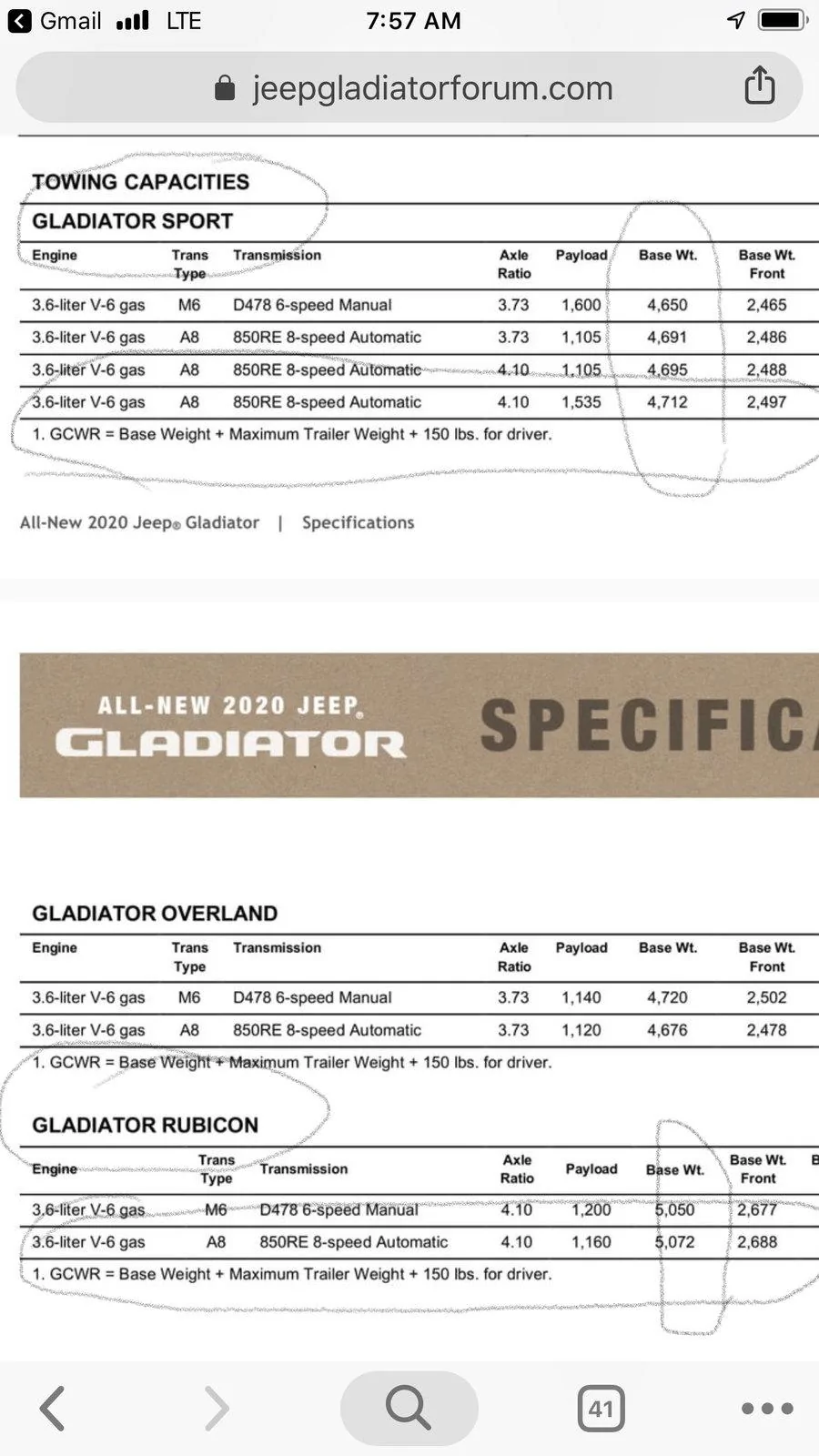

Curb weight with manual transmission (I believe you add something like 25 pounds to each to get the curb weight of each with automatic transmission)
Curb Weights:
Rubicon 5050 lbs.
Sport 4650 lbs.
Overland 4720 lbs.
Sport is 400 pounds lighter than Rubicon.
Sport is 70 pounds lighter than Overland.
Overland is 330 pounds lighter than Rubicon.
Oscar Indy
Curb Weights:
Rubicon 5050 lbs.
Sport 4650 lbs.
Overland 4720 lbs.
Don't forget the MaxTow sport uses same axles and everything but the TCase that the Rubicon has. That makes it heavier than a sport.
Jeep Gladiator Rubi springs change tow? 59C38086-198A-42C3-834D-2039A29CC9B2
360lb difference is two tiny occupants.
On the other side the tire size difference makes about 200rpm difference in all gears.

Right - I was merely pointing out the base weights of each without towing (and in a way how they aren't huge differences) - add the wider axles to the Sport and you add weight to it, reducing the difference.
That will impact payload more than towing in either case.

With all due respect, that chart above has errors in it. For example, how can you get a Sport with 4.10 gears and 1,100 lbs. payload? Not possible. And one error spoils the entire jar. Can't trust it.
I also disagree that the tires have that much to do with it. Sport and Overland both use the same diameter tires, but towing specs are all over the map due to curb weights and other concerns. Has nothing to do with tires.
300-400 lbs. of curb weight has a lot to do with it. My Max Tow was 4,700 on the scales when it was stock. I've seen stock Rubicons pushing 5,100.
The coil springs have a lot to do with it also. More spring rate = better payload = better tongue weight = better towing.
