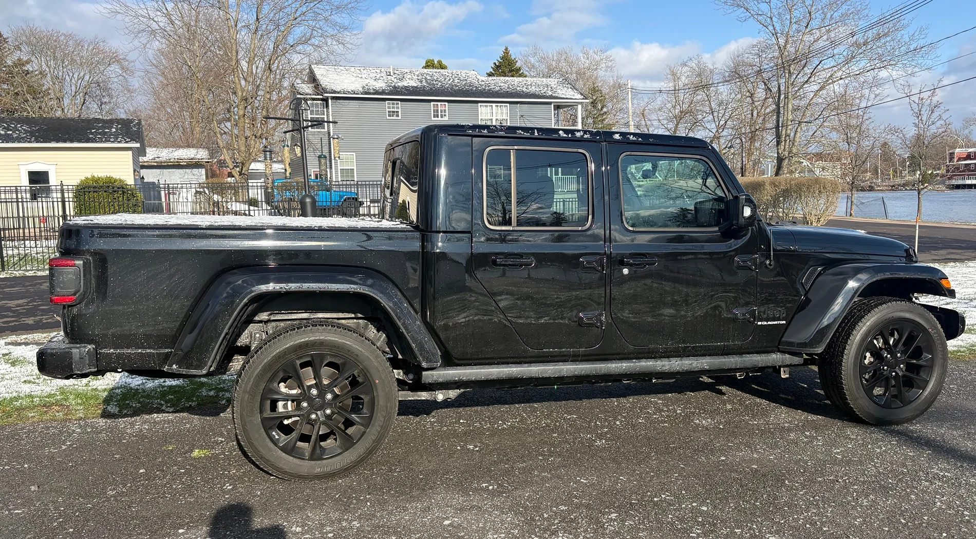

Hi All !
semi new to the forum, but I grabbed a 2023 high altitude, and I’m looking to beef it up with 35’s and a 1.5” teraflex leveling kit.
I’ve done some extensive research and realized the 2” mopar lift will be too much for it and make the 35’s look small.
So my next question is, what should I go with if I want to give it another inch or so from stock+TF Leveling kit?
another .75” daystar in the rear? Or a Rubi suspension? I also think the high altitude has better shocks than the Rubi? So can i just put springs and sway links in it?
I plan on adding the better lower control arms too. And my custom front bumper I made (got some weight to it)
thank you everyone!
(P.s. not a fan of the stock 20” rims on 32” tires - coming off asap)
Jeep Gladiator Rubi Suspension on a High Altitude? (Looking to gain 1-1.5”) IMG_8916
Jeep Gladiator Rubi Suspension on a High Altitude? (Looking to gain 1-1.5”) IMG_8885

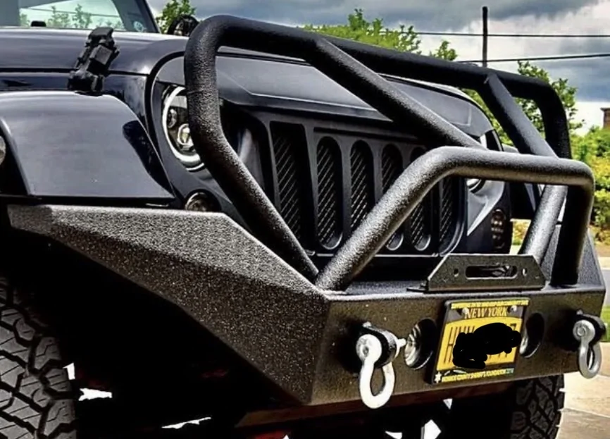

That bumper could take out an Eleyfink!!!! You made the angry grill look even more aggressive!!! Good work on the fab though.

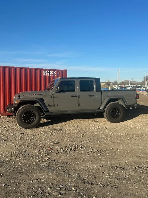

I have the Texas Trail Edition which is pretty much the same as yours with different badging. I got me set of rubi takeoffs and added the 1.5" teraflex leveling kit. Currently running 35s. I love the way it turned out (especially for the price) but I personally think an extra 1-1.5" lift would be perfect.
ah so thinking the 2” mopar lift would be the sweet spot?
I think it is all comes down to personal preference and how much you are willing to spend. Do you plan on taking it out on trails or just as a daily? If it is just a daily, I think my current setup would be just fine and it didnt even cost me $500 (not including the wheels and tires)
I have a good offer on a used 2” Mopar lift I’m planning to grab, just worried it’ll be too much for only going with 35s, but hard to tell from pics only
I dont think a 2" lift would be over the top but totally understand it is hard to tell from pictures.
