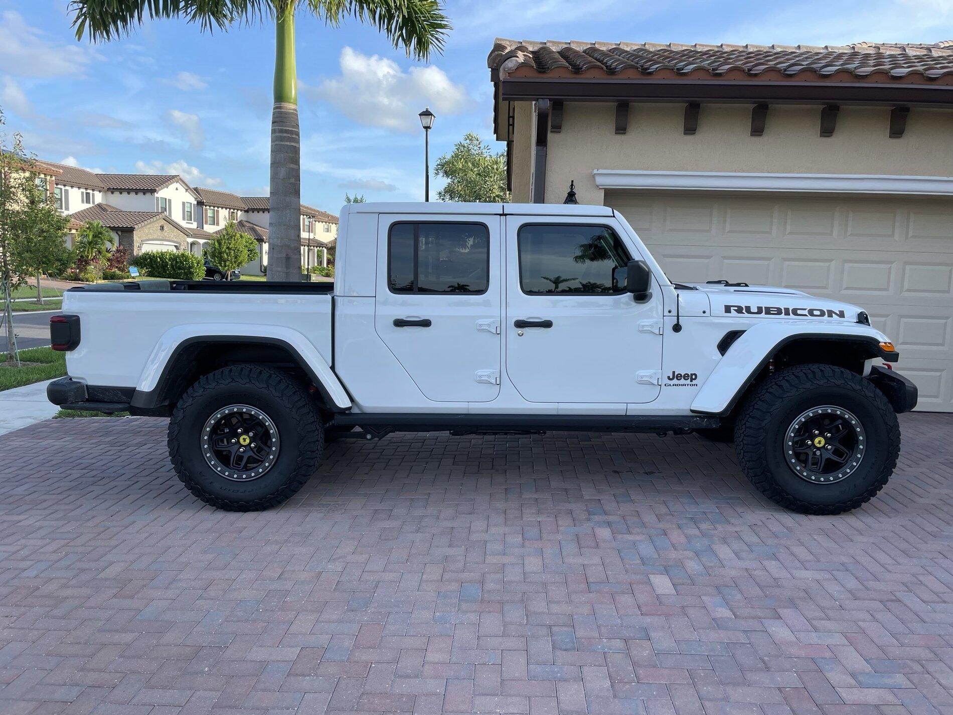

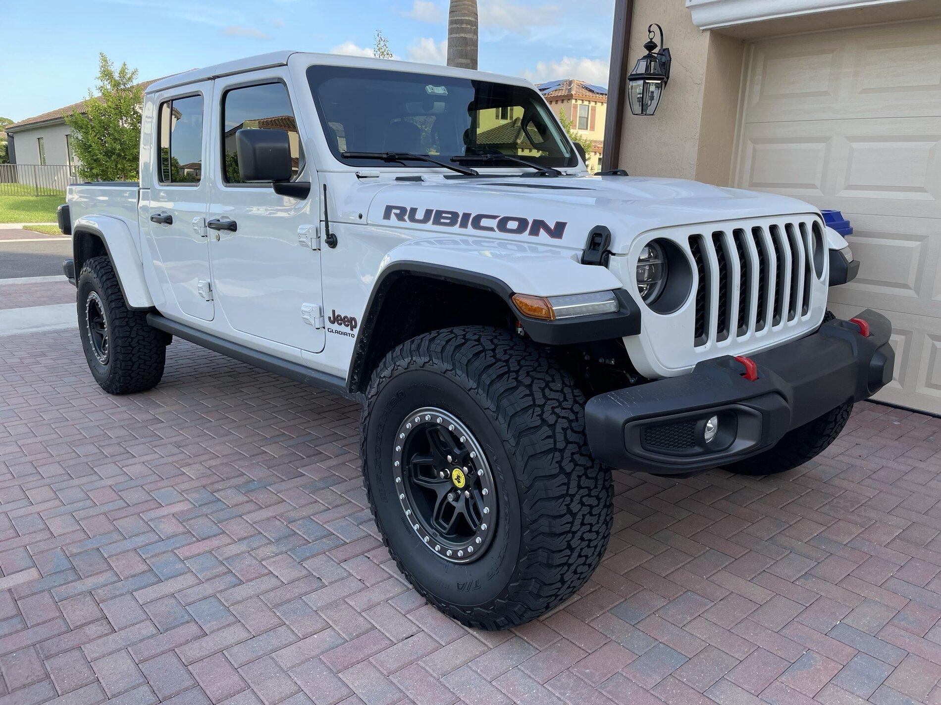

Hey guys,
Just wanted to show off some pictures of my diesel Rubicon on 37s. I had a hard time trying to find this exact setup and was unsure it would work due to rubbing issues. Specs:
2021 Rubicon Diesel
Teraflex 1.5" front
Daystar 0.75" rear
17x8.5 +25 AEV Borah in Satin Black with Onyx protection rings
BFGoodrich KO2 37x12.50R17
Zero rubbing. Haven't taken it off road yet, but it drives beautifully.
The diesel, along with the Tazer adjustment and Pedal Commander installed, powers the 37s just fine. I catch and hold 8th at around 55-60, with no hunting for gears. The power loss was minimal. Well worth it in my opinion! Enjoy!
Jeep Gladiator Rubicon diesel on 37s IMG_9441
Jeep Gladiator Rubicon diesel on 37s IMG_9442 (1)

Looks great. I'd love to hear how it does off road, it doesn't seem like a lot of lift to be running 37s.

Thanks for this! I am looking at 37's and a 3.5 MC for my diesel, sometimes wonder if the 37's would look too big, but they always end up looking great!
