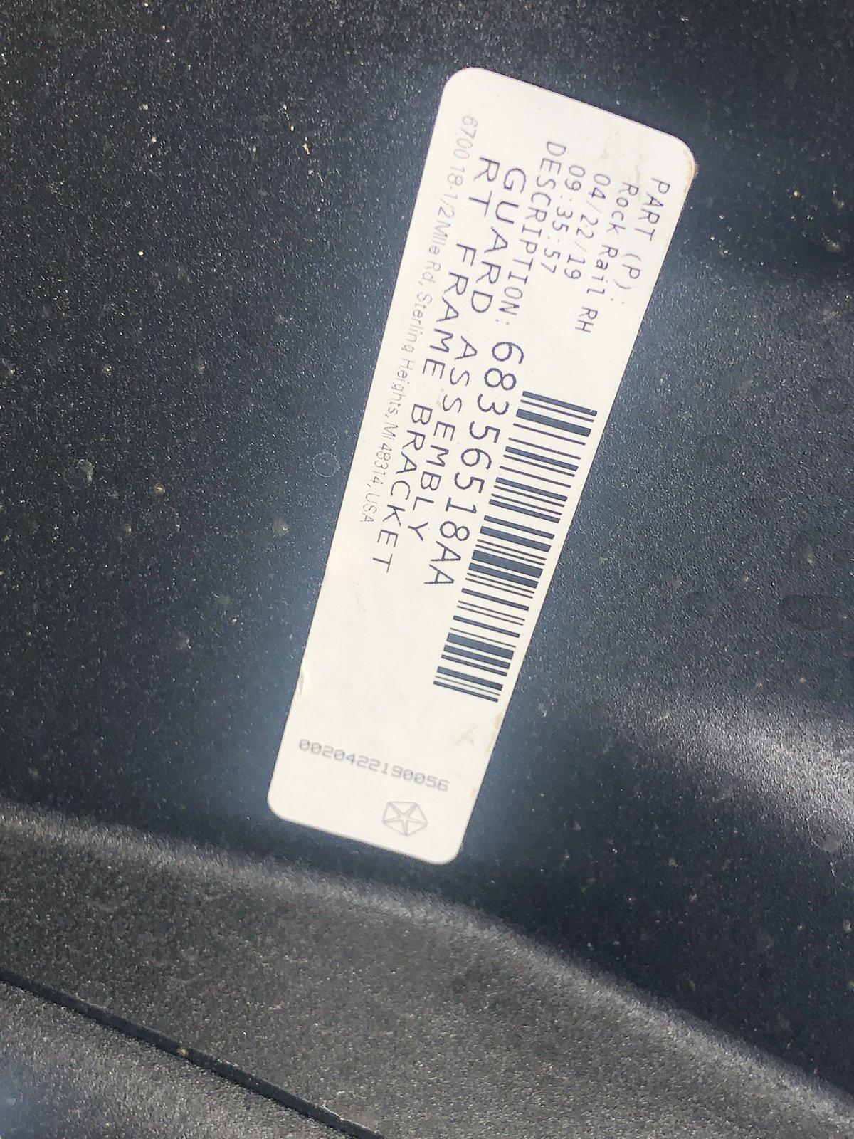

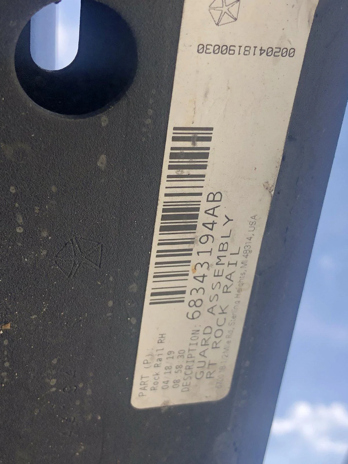

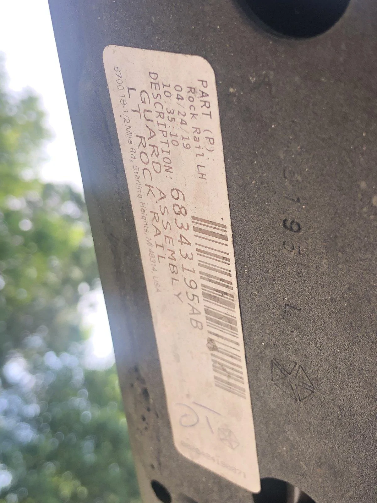

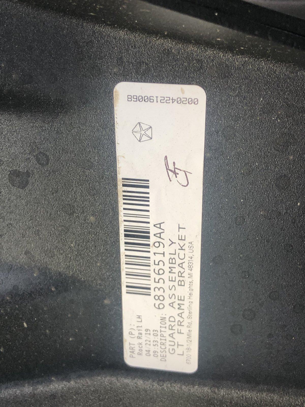

Does anybody have a part number for those rear corner rock rails on the Rubicon? I'm assuming those will bolt onto a Sport. Would like to add them.

Here ya go. Just an FYI, the support bracket bolts to the trailer hitch so you will need it to add the rock rails.

Awesome so as long as I have the trailer hitch (which I do of course) then I can bolt these right on?

All Gladiators come standard with a Class II hitch. So I really wonder why Jeep slaps on a different hitch that costs $250,00 more on every single Gladiator they build. For me I would be just fine with a Class II hitch. And with that in place I think you should be able to bolt on this rear quarter rock rail.

The class II hitch that comes standard is simply a bracket under the center of the bumper so that you can drill a hole in the bumper cover and mount a ball directly to the bumper. It is not a receiver style hitch like what you get with the towing package.
