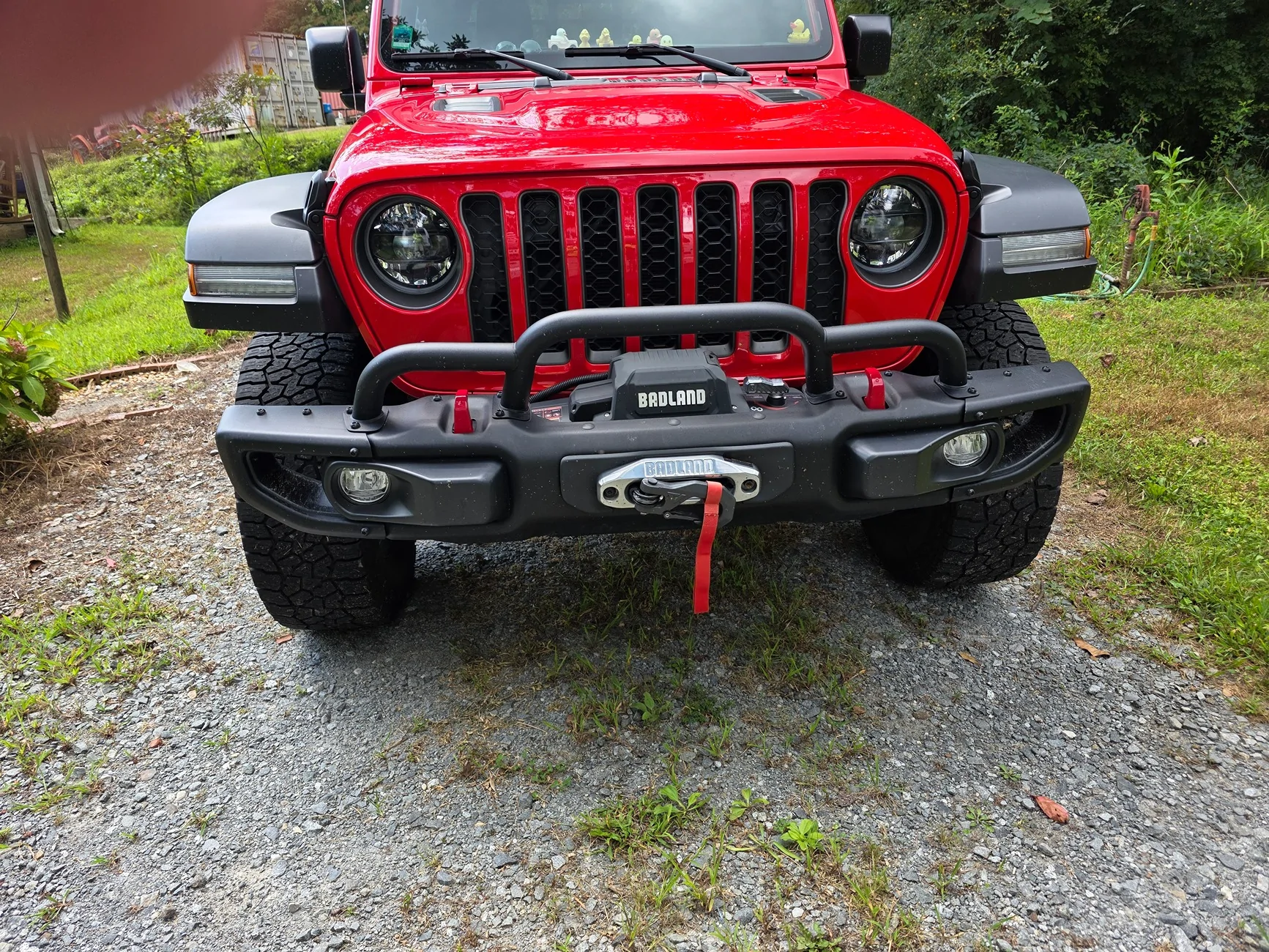

Did we learn anything about this situation? I have a 25 Mojave X that I am putting the Badland 12 on. I would love to use the MOPAR fairlead because I much prefer the look over the Badland fairlead. I also have a 1” factor 55 fairlead on hand.
Jeep Gladiator Rubicon steel bumper ‘winch ready”? IMG_8811
40,514
54,043
Be careful - the Jeep fairlead is likely for the Jeep narrow spool winches that come with them.
Check the length of the opening left to right. The factory Jeep winch doesn't have as wide a spool. They have less rope on them compared to those not sold through Jeep.
I'd love to use that on mine, too - but want to measure one first.
