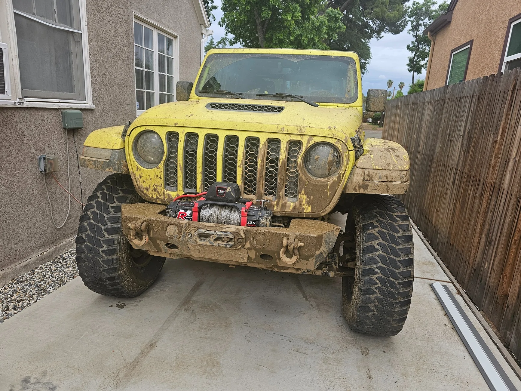

Jeep marketing lie that is now even invading some aftermarket bumpers. Used to be every bumper marketed as a winch bumper meant all you needed was the winch and the components that come in the box to fully install a winch (wiring, fairlead, hook have always come with the winch). Jeeps version of winch ready just means you don't have to cut holes in it to install a winch. So have to buy the winch mounting plate, remove the bumper, etc. The Jeep lie runs so deep now I've even had forum members try to argue that this is industry standard. I've probably bought a half dozen winch bumpers over the years, installed a few dozen, and looked at hundreds. Most are one piece with the winch plate welded in. Some of the newer ones copy Jeeps design with a separate winch plate but it's included with the bumper. Nobody else is selling you a winch bumper you can't mount a winch to. Even the knock off oem style bumpers usually include the winch plate. Winch "ready" once you buy the mounting plate and remove and recount everything.

Generally winches have the same mounting bolt pattern. If you run a larger winch you may run into clearance issues but it's mostly universal. We have the Mopar bumper on our JLUR and I think it's the JCR mounting plate. That said it's not an option is but again. The actual winch bumper on my JT was $400, it's definitely stouter than the Mopar version, and it even came with led fog lights. With the xbull 13.5k pound winch it still cost less than the Mopar "winch ready" bumper alone and it had closed loop clevis mounts which are much safer than the hooks on the Mopar too. I've made some really hard pulls with it without issue.
