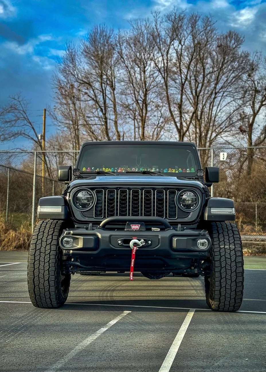

That first pic is what I would call "winch ready" FCA (Stellantis).
If you go out and purchase a Winch, you should be able to bolt it on.
First pic, My pic?
