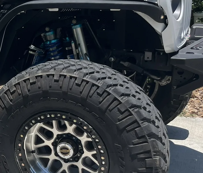

For everyone saying the swaybar has to be level to lock I don't think that is necessarily accurate as mine is definitely not level and has no issues locking and unlocking. This is what mine sits at on level ground locked. It is on the list of things to get fixed but for now it seems to work fine and I have had no issues with it.
