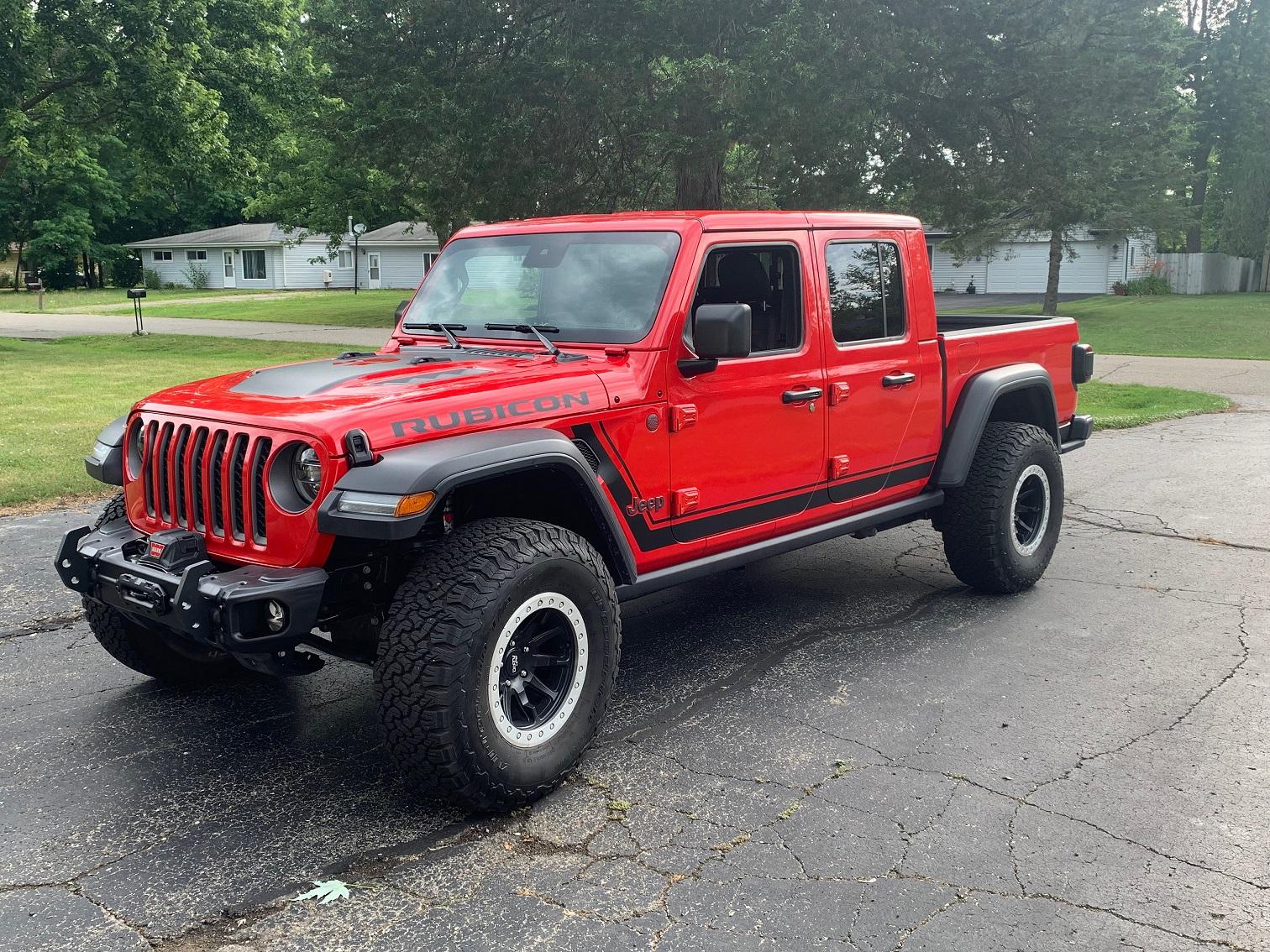

I also want to swap my 33s for 35s on my Rubicon. I have a different question. I ordered the "upgrade" optional $995 wheels on my vehicle, but those are the same dimensions as the stock Rubicon wheels: 17" x 7.5" width. Can I use those same wheels for 35s? I intend to do the 2" factory Mopar lift. If I can't use those wheels with 35s then I wasted $995. Feedback on what optimum width wheel would be greatly appreciated. Ancillary question is what "offset", if any, should those wheels be fro the 35s. I haven't seen this discussed anywhere. Thanks. Spacecat.
1.5” level up front. No other changes from stock. No rubbing. Running @ 30psi cold.
