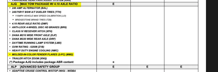

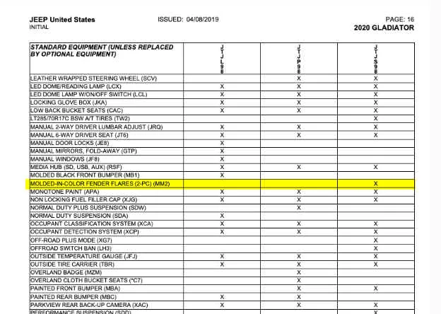

The fenders on Sport with Max Towing and on Rubicon both are listed as "MM2" in the order guide, so apparently they are the same.

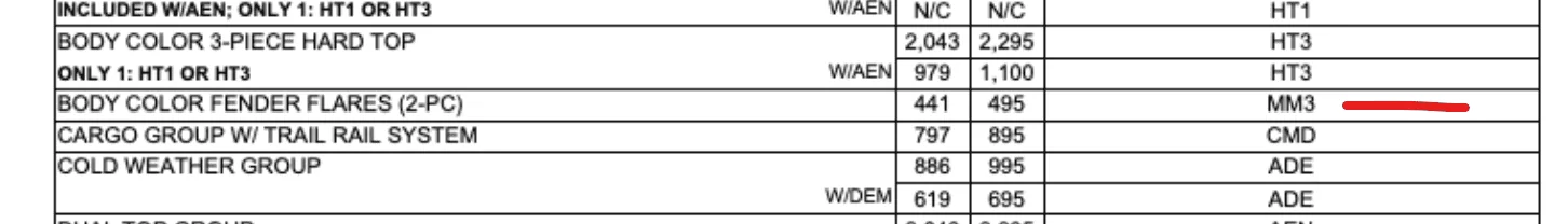

To me the Rubicon on the order guides states MM3, not MM2. I hope I'm wrong but even dealer pictures of max tow on lot seem to show non rubi fenders. I looked at dealers in the Detroit area.
When you look at the order guide, it shows the MM2 fenders for Rubicon and for Sport Max Towing both. Obviously you can get the optional MM3 fenders (body colored) on Rubicon, but the base fenders on Rubicon are MM2.
However, I agree with you that when I look at pics of Max Towing models the fenders don't appear to be Rubicon fenders. So... this is odd.
