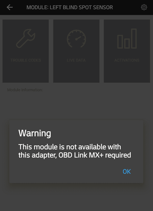

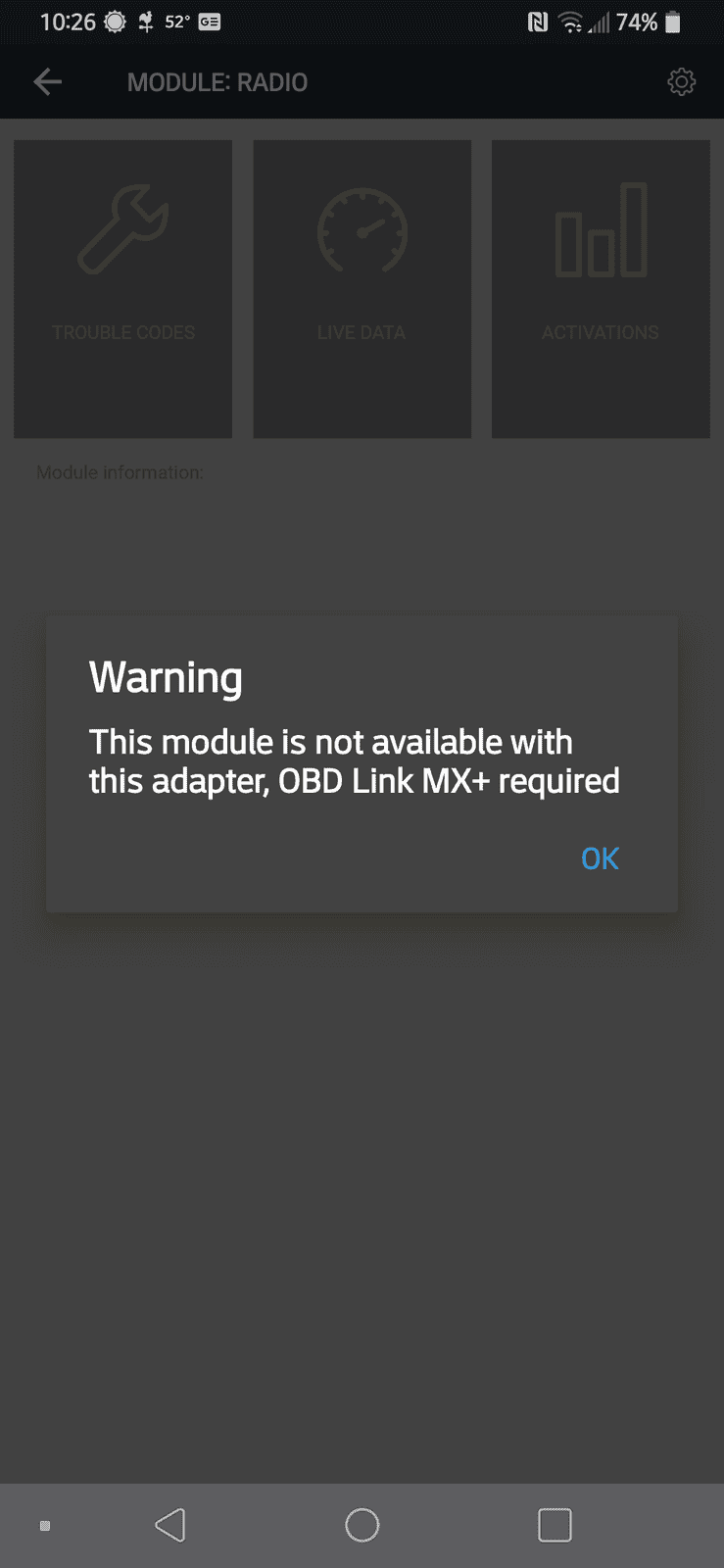

I was "messing around" in jscan and hit these two - but I do not know if there are others, or if these are even important unless you were doing something major. (see pictures below)
Here's what my wife has said to me over and over, and I still don't always listen - "if you dare come home with another cheap version of XXXXXXX, I'm sending you right back to get a better one".
I went through 2 circular saws - she sent me in after a better saw. So I didn't tell her I bought a cheaper adapter and then later ordered a better one - she didn't notice that small charge on the card WHEW.
Are these necessary to ever access? Dunno - I was messing around, snooping, learning my way around jscan and the gladiator settings. I do better by digging and learning by snooping and looking around and trying things.
So far the only thing I have not been able to do with jscan is one of the settings for auto high beam. I like AlfaOBD a bit better, but then, I tend to dig and go just as far as I possibly can on things - it's just how I am.

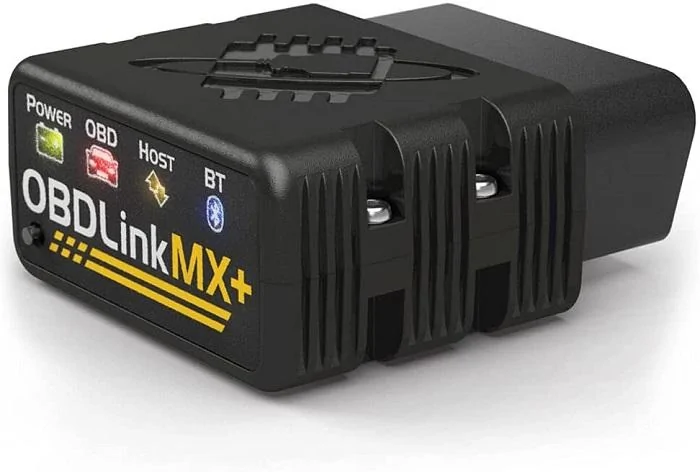

40,463
53,911
Tazer can.
Yeah, so can JSCAN and AlfaOBD with this adapter. (pic below)
It's not like the software can't access it, it's the difference between a $25 adapter vs. a $100 adapter.
I can access all things with the better adapter below.
On the other hand, if all a person wants to do is the tire sizes and common or basic settings, they save a ton of money using jscan and the $25 adapter. 50 bucks and they've got it. No need for fancy expensive hardware.
I can access all things with jscan or AlfaOBD and this adapter - including those spots I showed in the screen shots.
The cheaper adapter just isn't fast enough or able to get to some areas.
