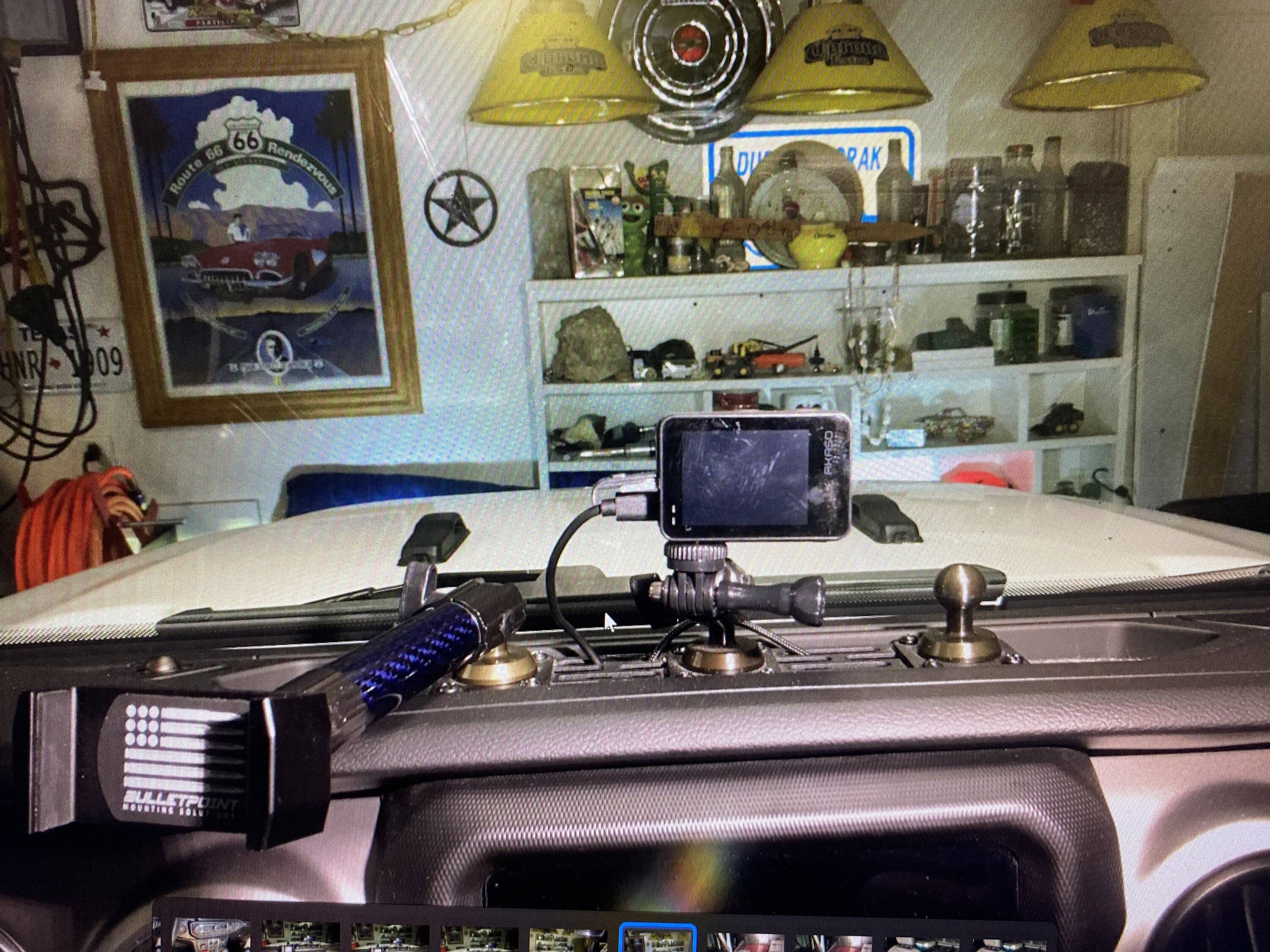

Several have done this and I have seen a few posts and variations of doing what you’re looking for. My version was to use the cigarette lighter circuit since I had removed the cigarette lighter in order to install the trailer brake controller. I wired and mounted a 12 volt to 5 volt drok (from Amazon) dual usb port fast charger under the steering column. From the fast charger I ran micro usb and Apple charge cables up and through dash to phone mount. The first photo is looking through the windshield to the mount.

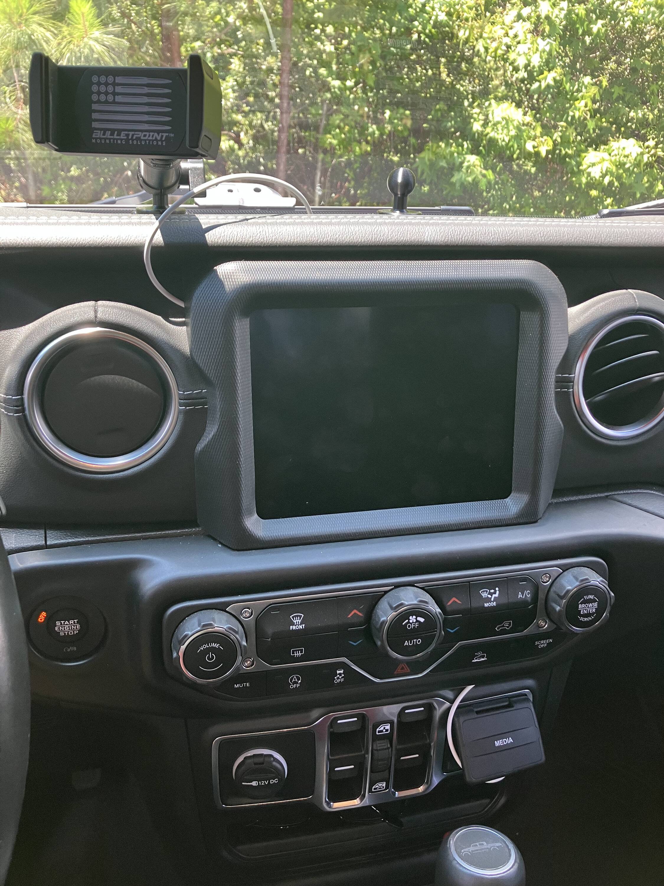

I just removed the temp control bezel and navigation bezel and routed the USB through those areas. I tuck the tag end into the Rubigrid when not using.

These are simply charge cables. No data going either direction.

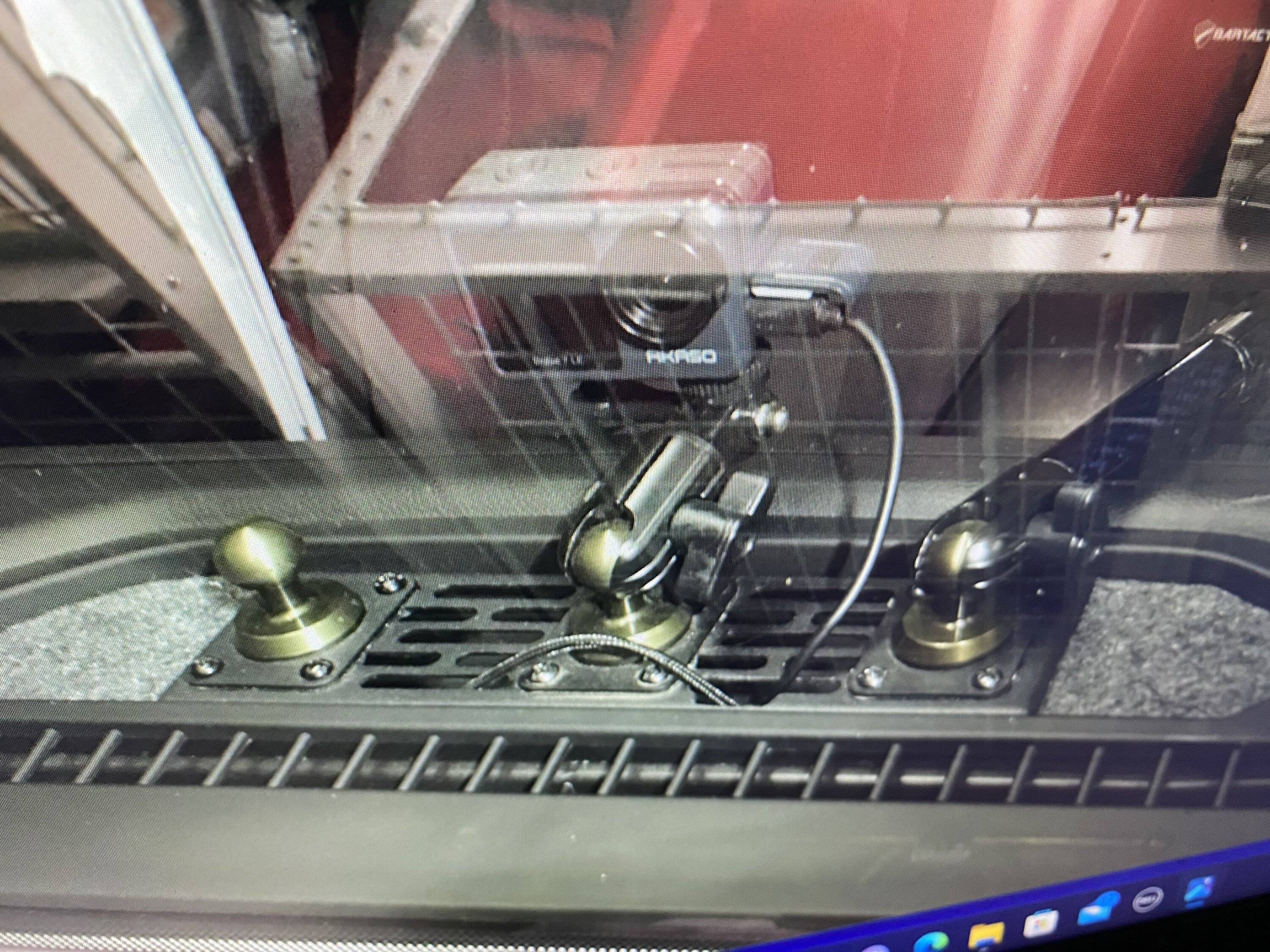

Thanks Everyone - I know this is an old thread, but I wanted to reach out and say than none of the solutions worked for me. It's easy to get USB power up to the RubiGrid and I am happy for all of the suggestions to get me there.
I'm still looking for a solution to get AndroidAuto up to the RubiGrid without external cables. I've become quite a pro working through the dash and removing panels as necessary, I just can't figure out how to run data through the grid.
This looked very promising, but I can't get it to work.
https://www.jlwranglerforums.com/fo...-2-x-20w-pd-usb-c-ports-on-upper-dash.106419/
I even sent items back that didn't match the exact specs as described in the article. If anyone has gotten this to work or knows an alternate solution, I would be very appreciative.
