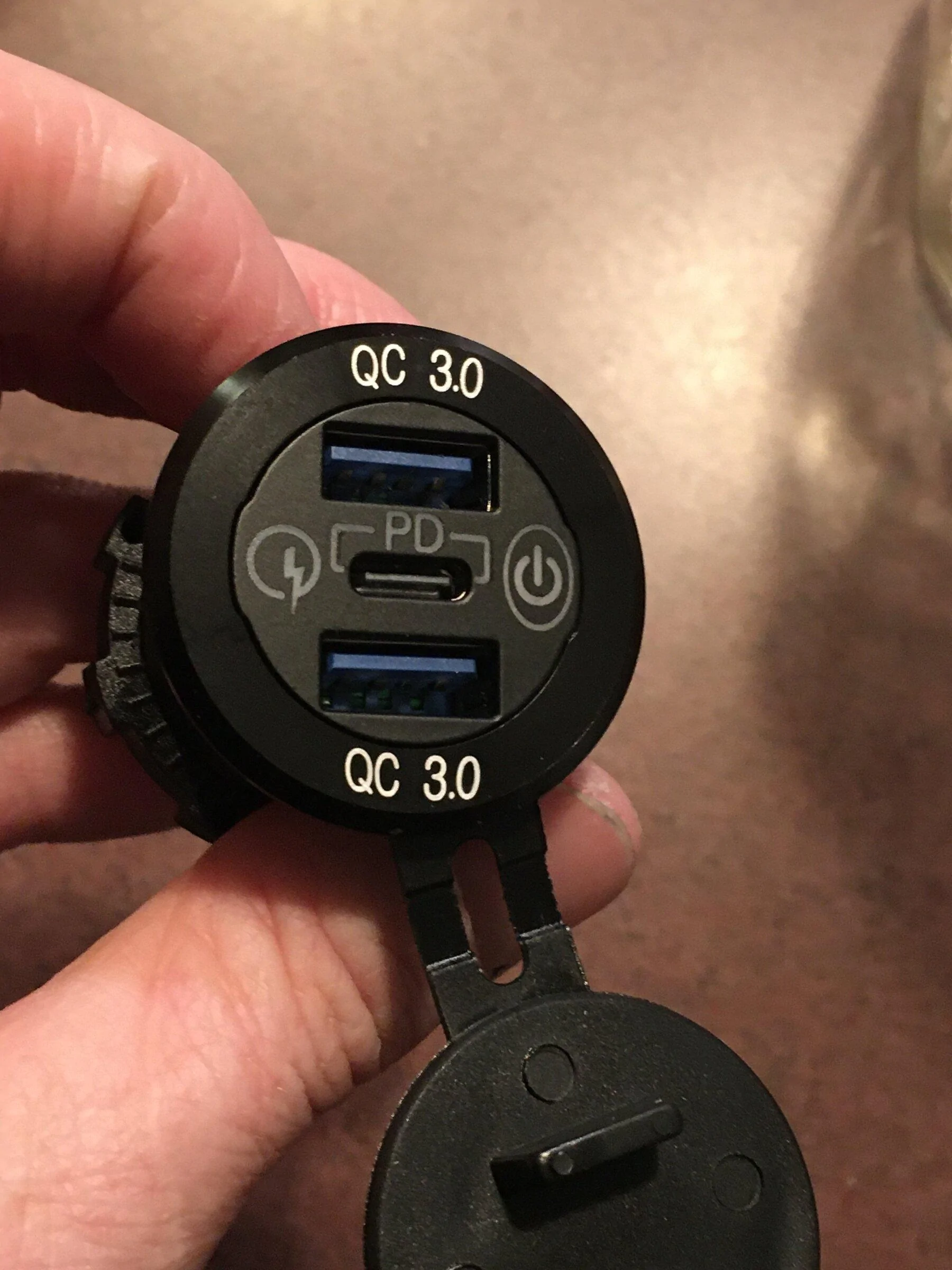

I have a 21 Jeep gladiator and the USB 2.0 ports don't work with a wireless charger because it requires a 3.0 port.
Is it possible to replace one of the existing USB ports with a 3.0? I've been looking all over the web about this and haven't found anything
Jeep Gladiator Upgrade existing USB port? B86D703E-B941-44F9-AD6B-EC0BDB71580C
Replacing my 12v with this.
