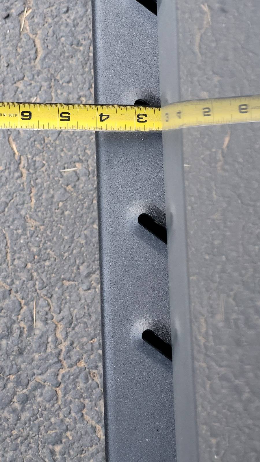

Picked up a set of Rough Country 0.75 inch front lift spacers. Install was super easy. Removed the front tires, removed the lower shock bolt, lower sway bar bolt and lowered the axle. Then I could pull out the spring. I did one side at a time and also had access to a lift.
The only complaint I have is the spacer didn't have the alignment pins that the stock upper isolator has, some of the other brands have these pins. Rough Country recommends cutting the pins off the stock upper spring isolator. Instead I drilled small holes in the RC spacer for the OE to poke into. I aligned the OE isolator up with the top of the springs and bolted everything ba k together, easy peasy.
Now I'm back to the factory rake, or maybe my front is a tad higher, but not much.
There is a good chance that eventually I will install a small lift (1.5 Clayton) down the road. That's the biggest reason I didn't want to cut the locator pins.
Overall I'm happy for the $30 I spent. Took less than an hour using a lift, axle jack, power tools and a second set of hands. My son didn't need to do much, but when he helped it really made a difference.

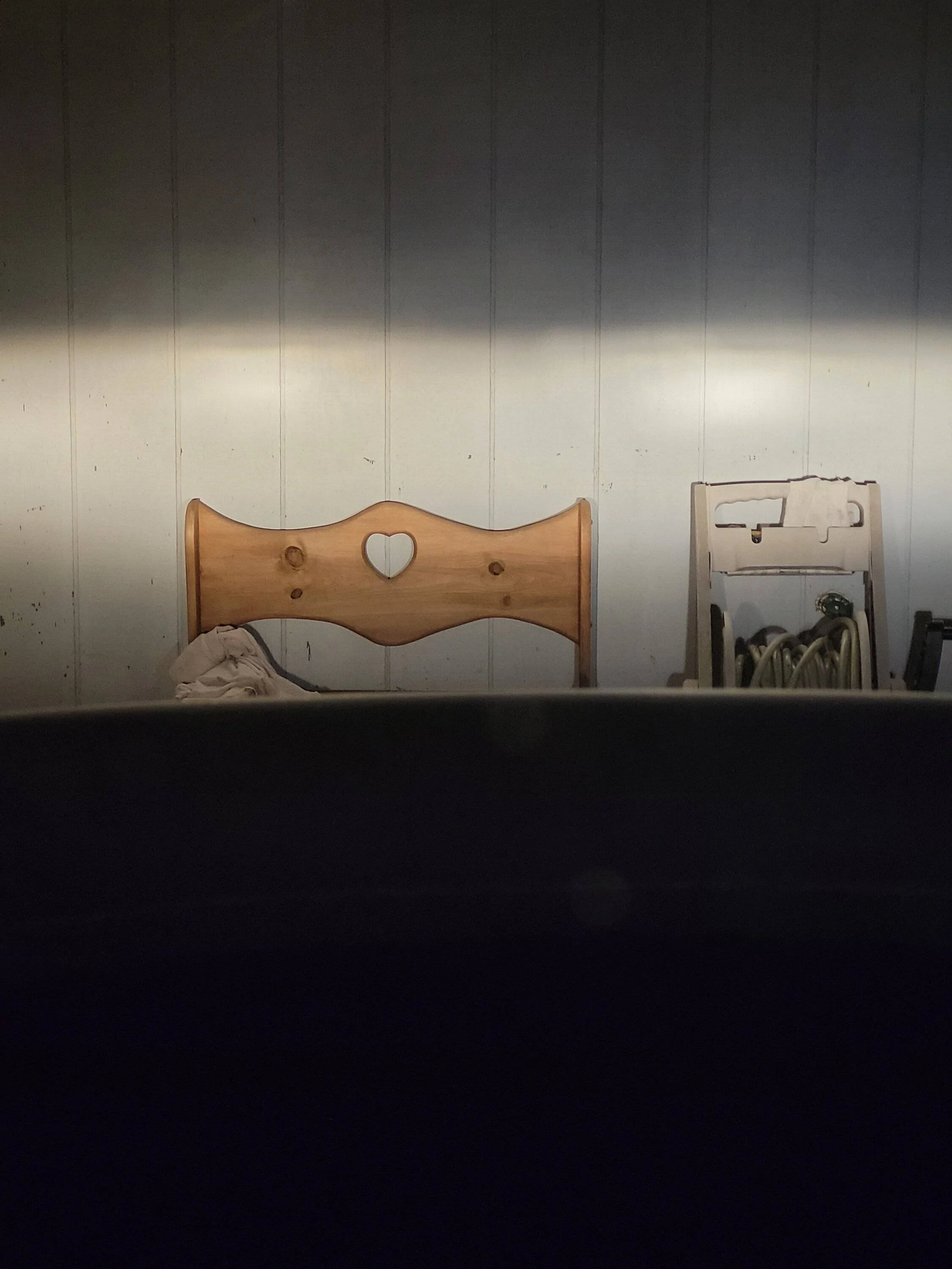

Swapped out my headlight bulbs for a set of Sylvania Silverstar Ultras H13.
Low beam, passenger new, driver OE. Passenger was a royal pain, I have a diesel. After much fiddling around I managed to get the cap out of the way.
Highbeam, pass new, driver OE again.
The wall is the same color all the way acrossed.
The driver side was cake, just pull the airbox out of the way.

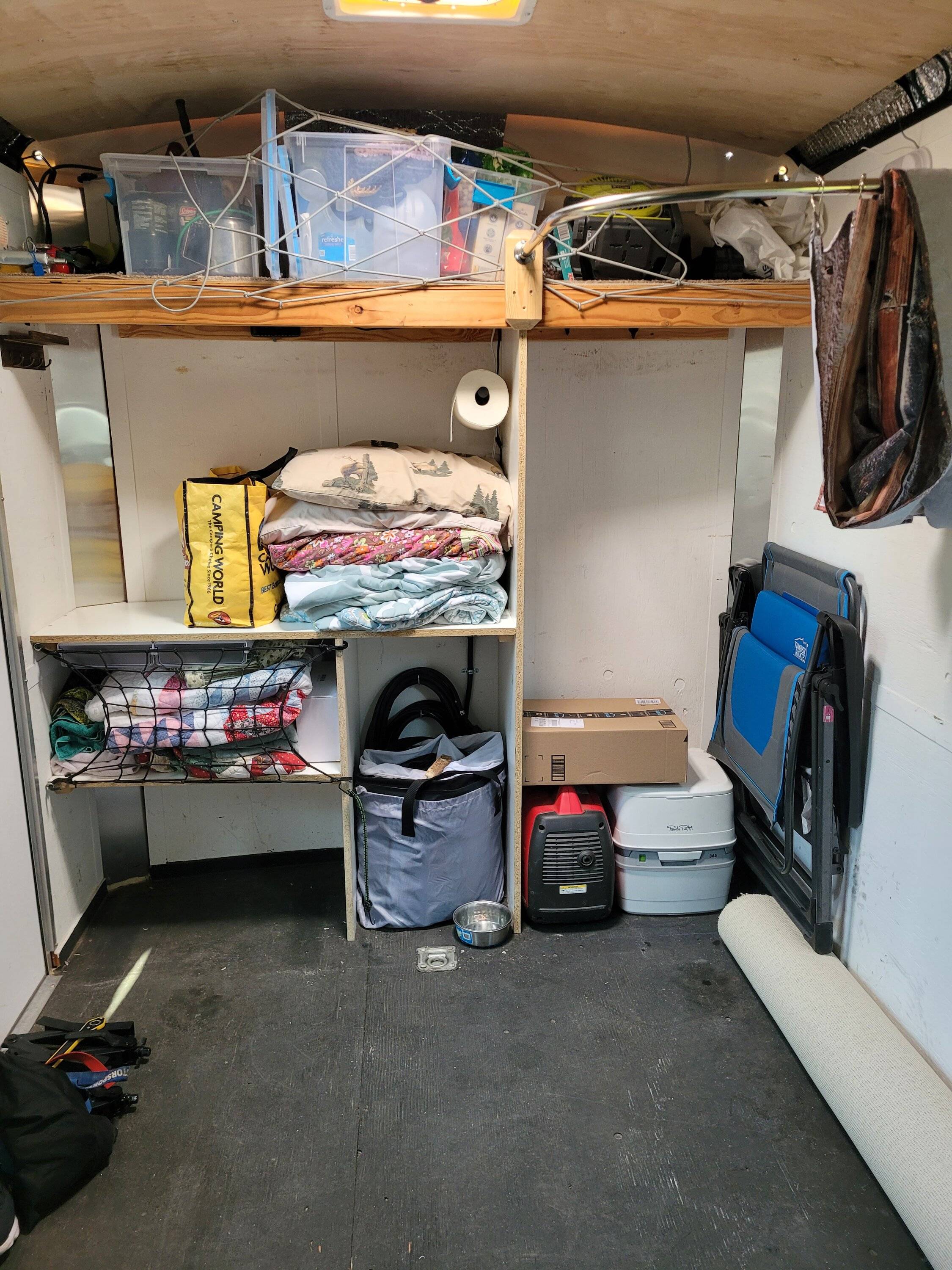

Just a quick couple of pics from our last outing to Florence. Cooler goes in the hole to the bottom left, we have a portable AC that can go in the taller center spot.
Jeep Gladiator RudeJeepin's JTRD Journey 20230705_094619

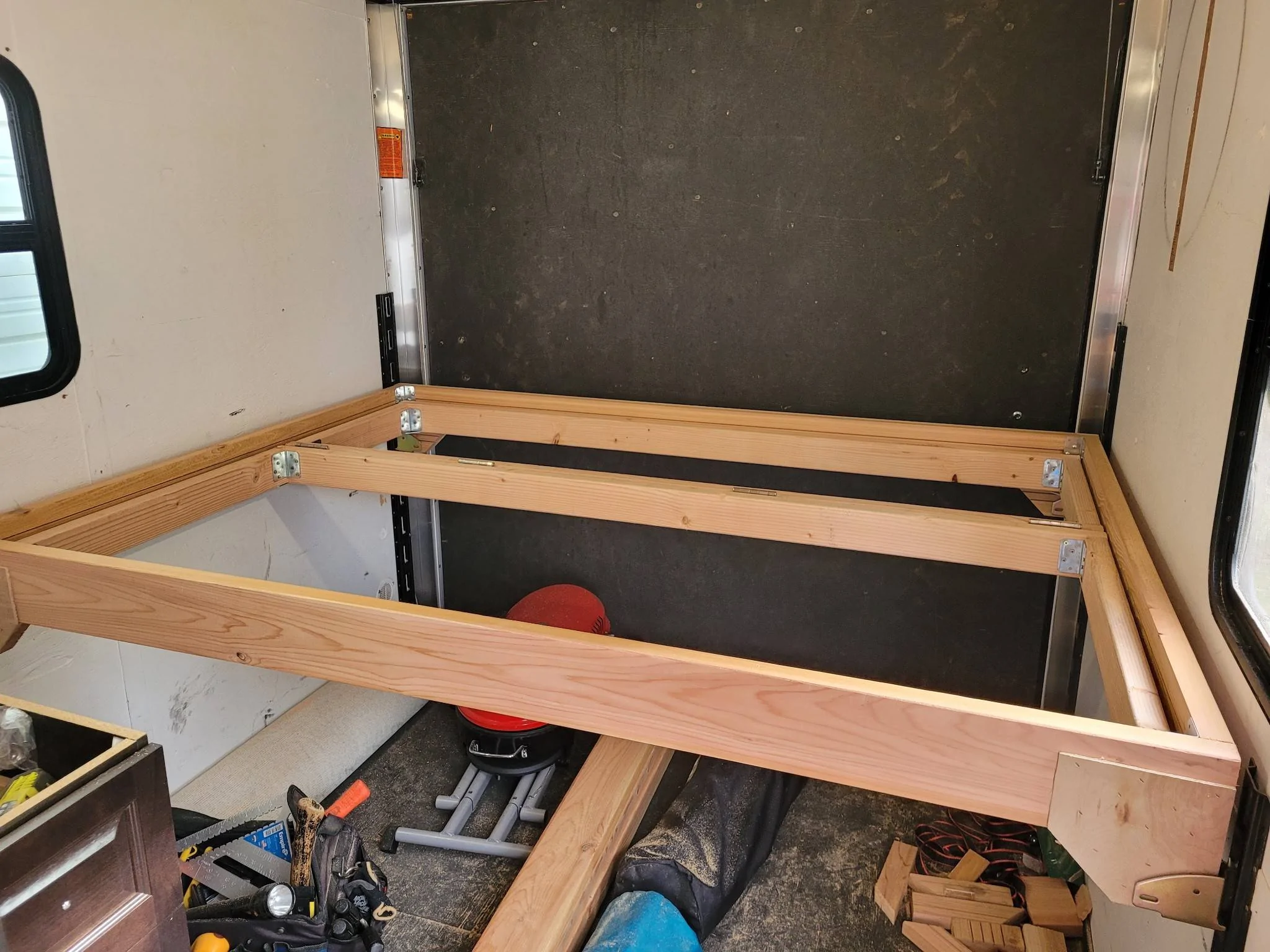

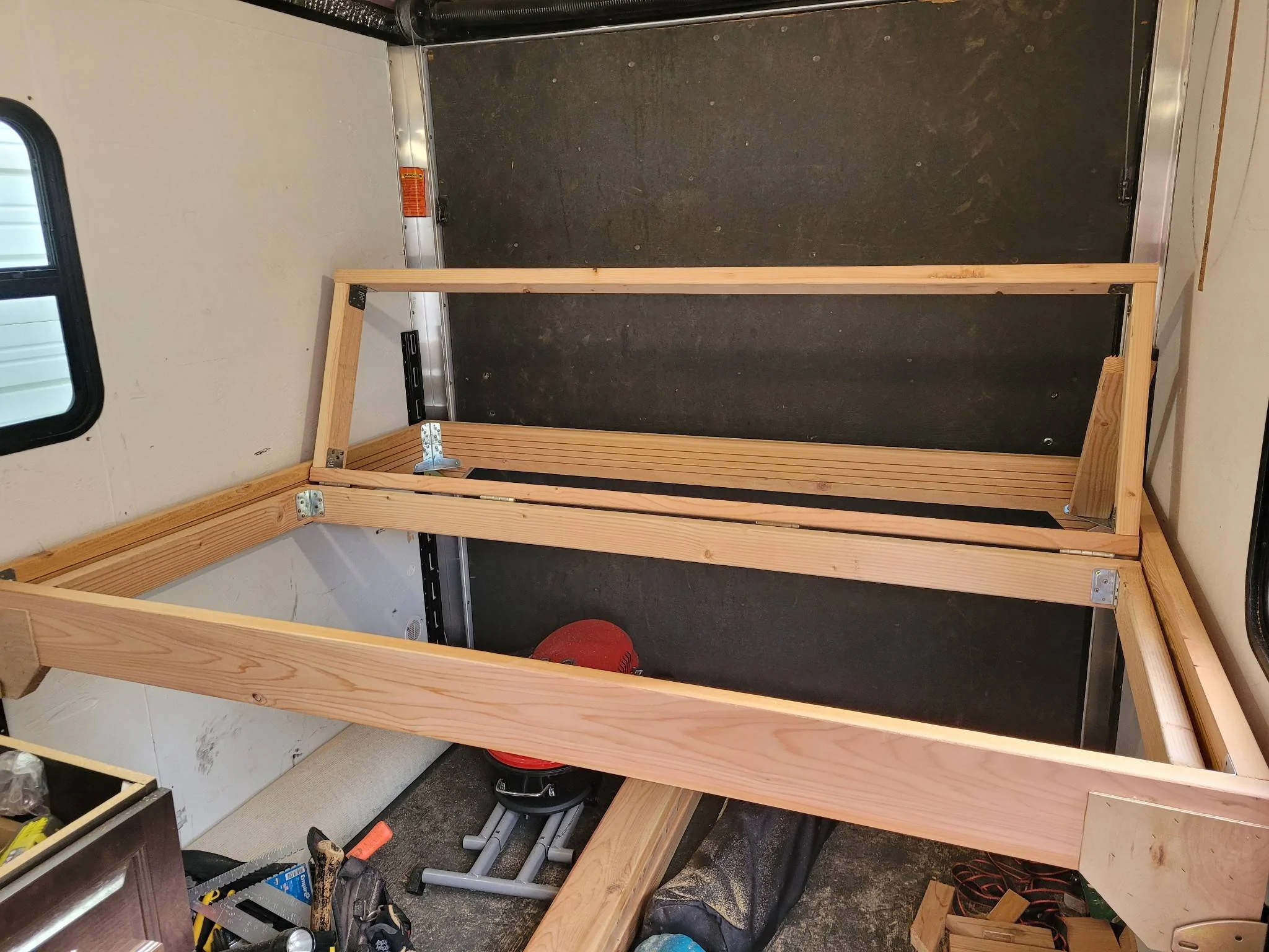

Camping season is getting close. Building out a lift bed in the cargo trailer.
Bed mode...
Jeep Gladiator RudeJeepin's JTRD Journey IMG_20240310_175045
Couch mode...
Jeep Gladiator RudeJeepin's JTRD Journey IMG_20240310_175045 (1)
Still need to add the slats and rig up the winch/lift system.

Would be cool if the Flip bed could setup in either direction, for interior seating or to view the exterior patio!
I'm one step ahead of you. Neither side is anchored, so it can go either way.
The wife decided she wants a different mattress than I was originally gonna use. So once it gets here I might have to adjust the pivot point.

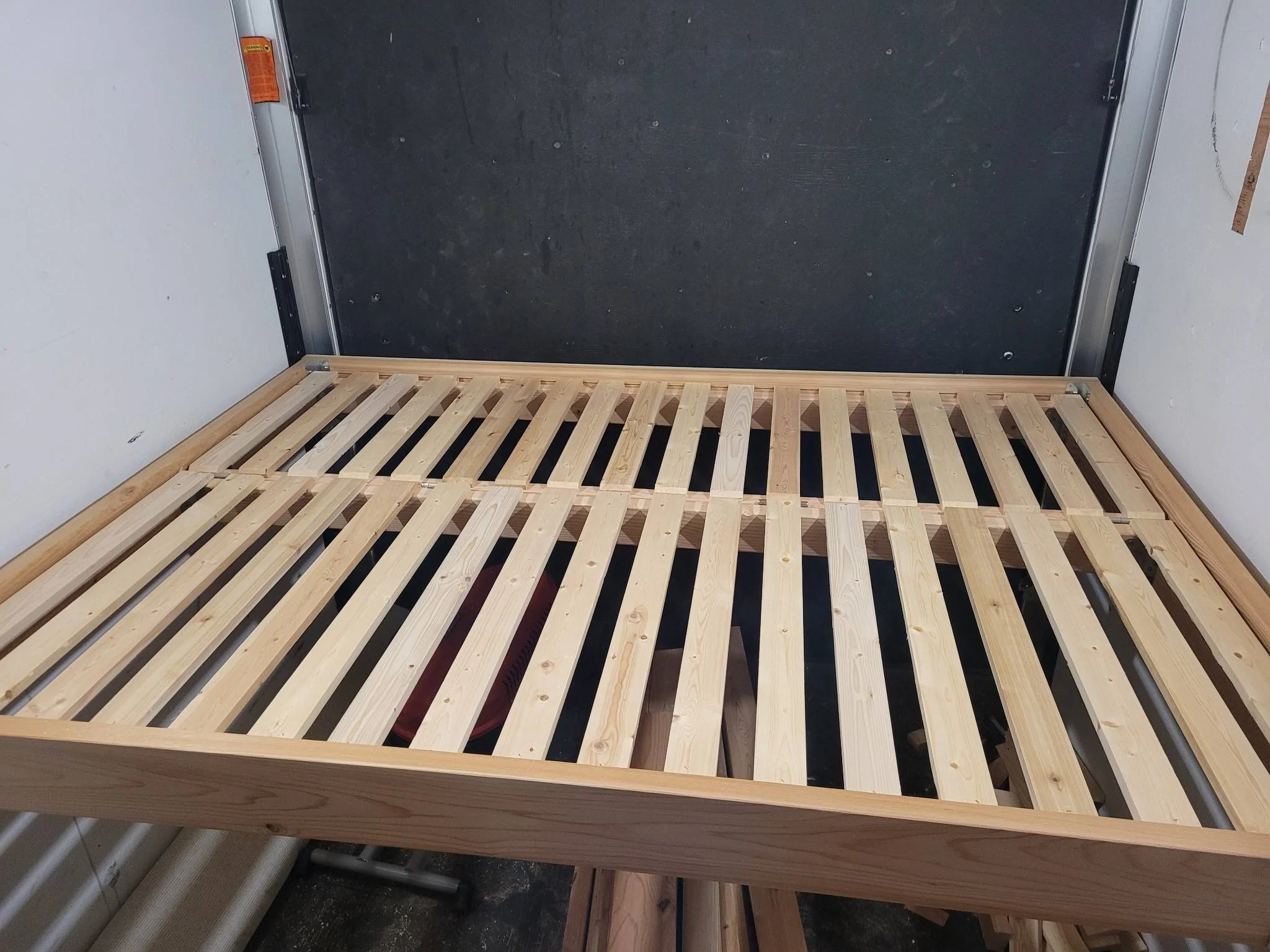

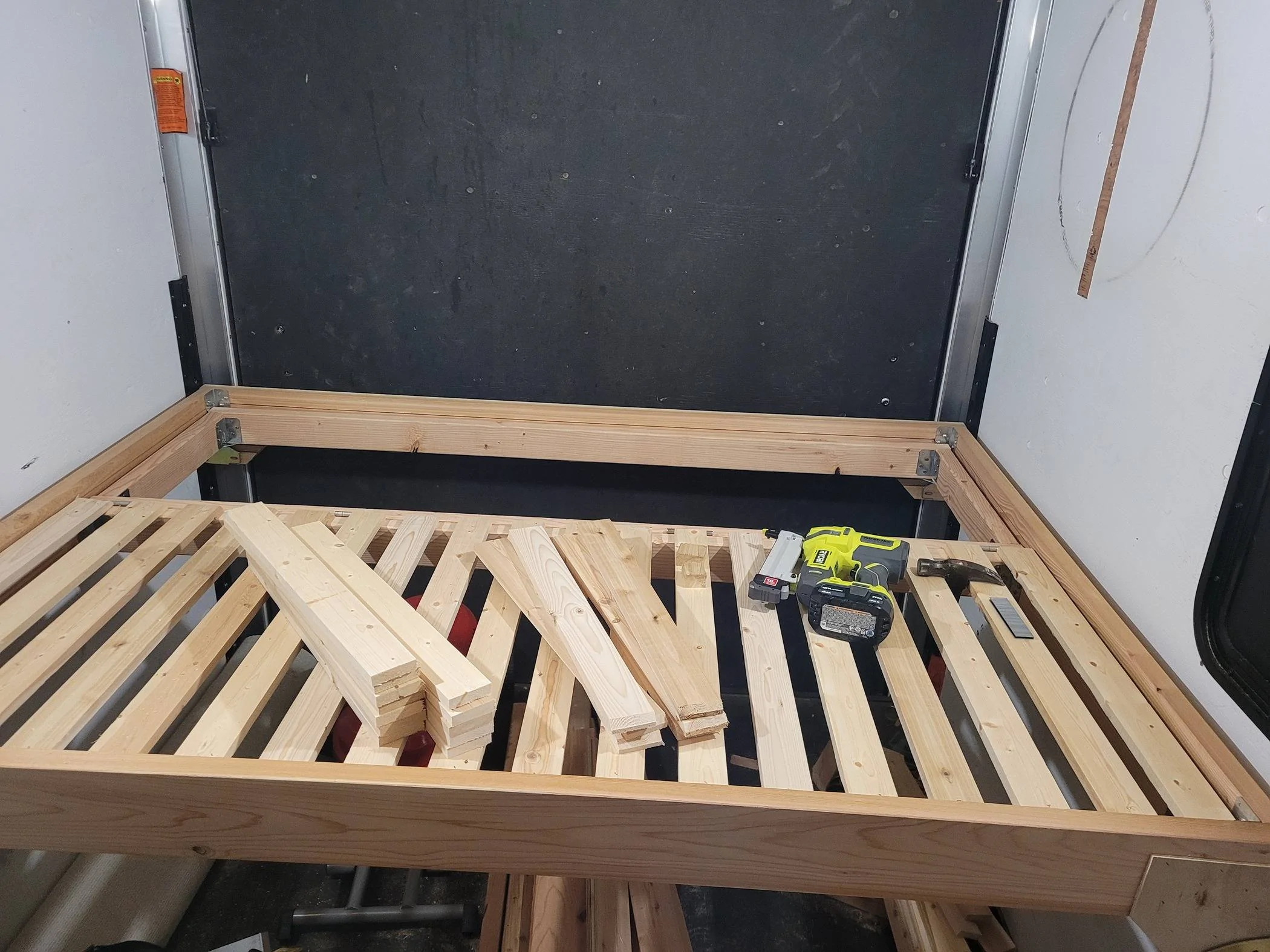

Slats are in, used my cordless staple gun.
Jeep Gladiator RudeJeepin's JTRD Journey IMG_20240322_200947
Jeep Gladiator RudeJeepin's JTRD Journey IMG_20240326_042738

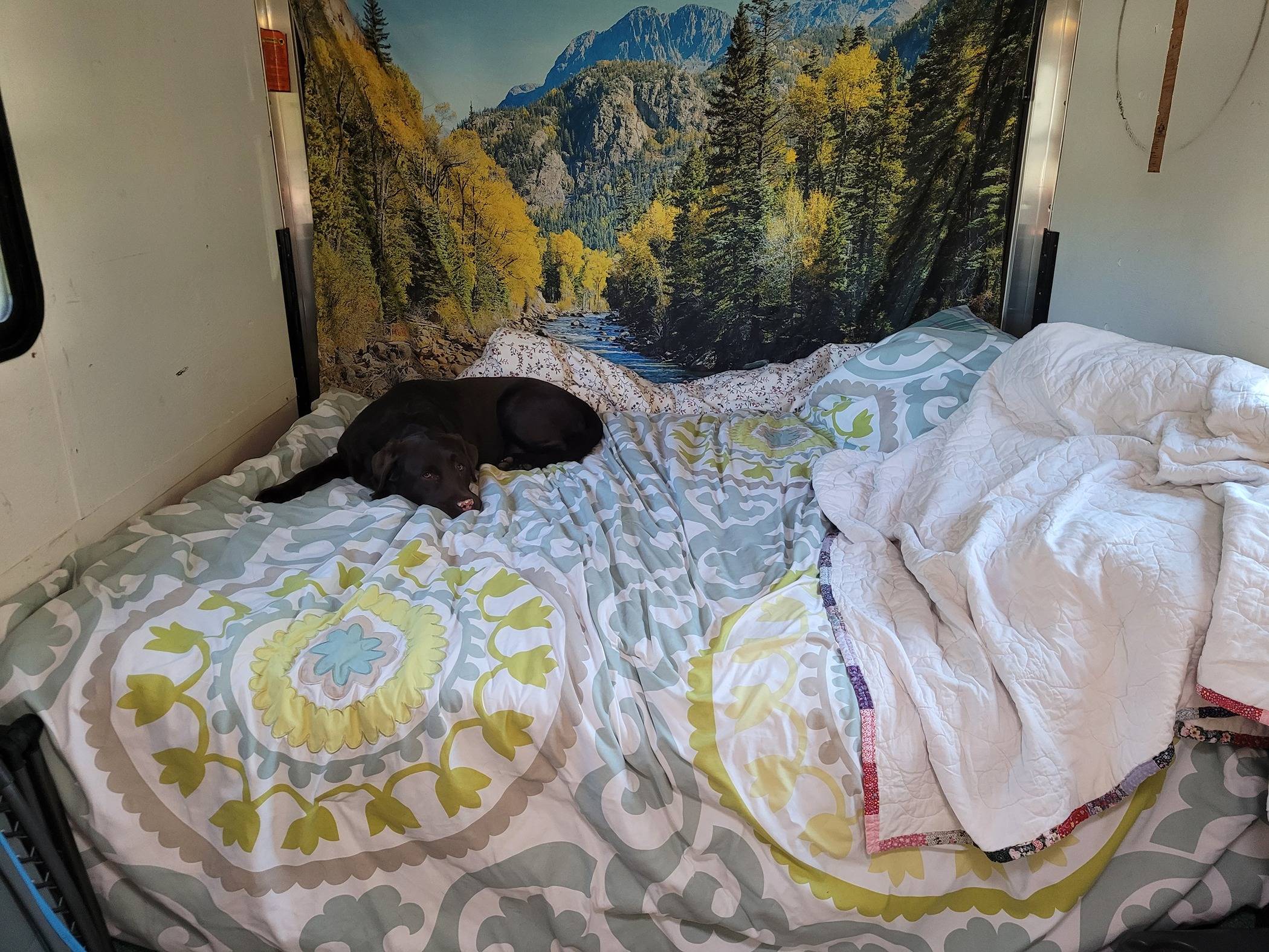

Dog is wore out now. Here is the bed all made...
Jeep Gladiator RudeJeepin's JTRD Journey 20240330_091307
We ordered a mattress from Amazon and then my wife added a memory foam topper. Removed the topper and slept better. Should of got another mattress like the one from Ikea, it had internal coil springs...

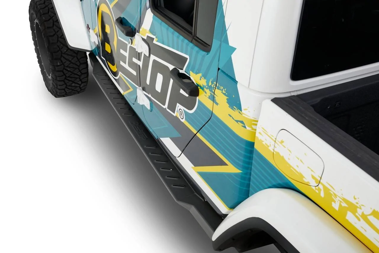

Installed AVS vent shades and Bestop Granite Rock Rails.
Jeep Gladiator RudeJeepin's JTRD Journey 20240404_131804
Jeep Gladiator RudeJeepin's JTRD Journey 20240424_192644
Jeep Gladiator RudeJeepin's JTRD Journey 20240424_192708
Jeep Gladiator RudeJeepin's JTRD Journey 20240424_192631

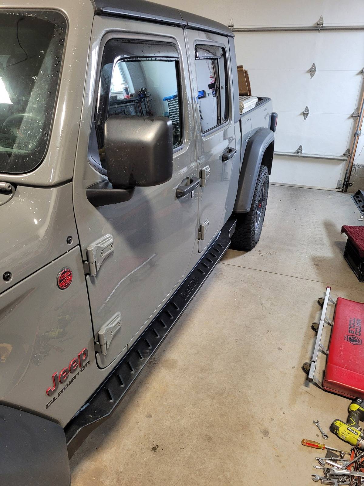

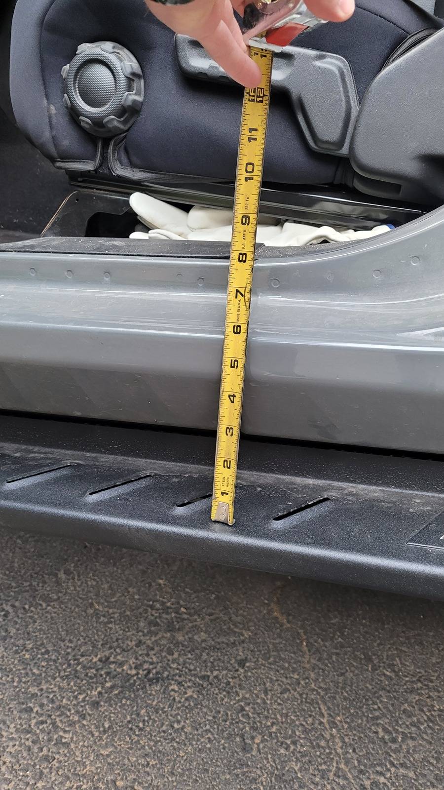

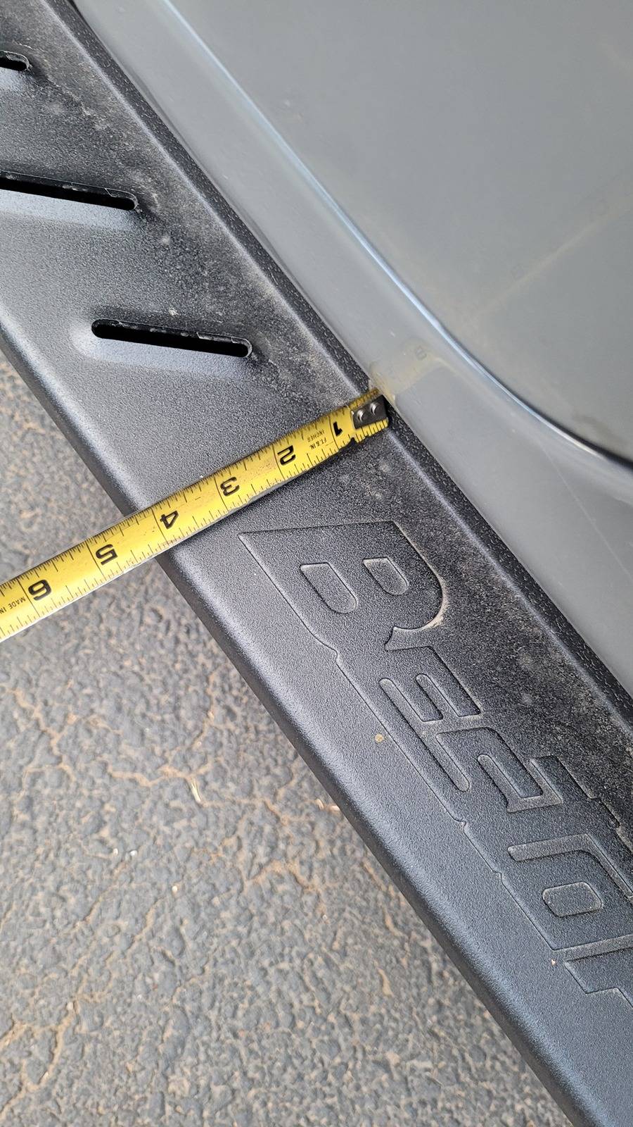

Ok, I've lived with the Vent Shades and the steps for awhile now, so I'll give a little review.
I absolutely love the vent shades. I've left the windows cracked several times when it's raining with no issues of getting water inside. I roll the windows down until their just above the bottom of the shade. Nice part about this is it's almost impossible to tell the windows are down from the outside.
When it's sunny and the dog is in the truck, I'll roll them down about 2 inches or so past the shade. So far that's been enough air flow. Haven't been super hot yet, but we don't usually leave the dog in the vehicle if it's that hot.
Now to the steps. They are pretty beefy and feel solid when climbing on them. I haven't used them as sliders and don't really plan on it. I think they can handle a little rubbing. I'm gonna guess no pivot turns, but could be wrong. I'll report back if I abuse them some.
As far as a step, they are probably too high to really be useful. When I step up on them, I feel like I have to climb down to get seated in the Jeep. But I do like the clearance of them. Plus they should help with door dings in parking lots. And they help with the dog not scratching up the door sills so much.
Eventually I'll put bigger tires and a small lift on this thing. At that time I'll probably look into some kind of drop step I can easily attach/remove from the under side of these.
But for now I'm satisfied, they serve the purpose I got them for. Especially at the clearance price I paid.

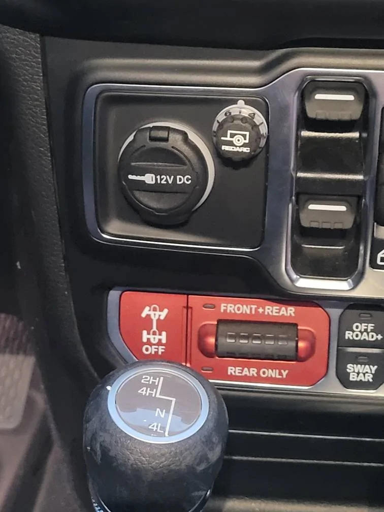

Got the RedArc trailer brake installed.
Hooked up to the Cargo trailer again, this time loaded with 3 dualsport motorcycles and headed to Southern Oregon. Took my 2 boys with to a group ride in Prospect.
Having the trailer brake controller and tow mirrors made the pull that much more relaxing.
