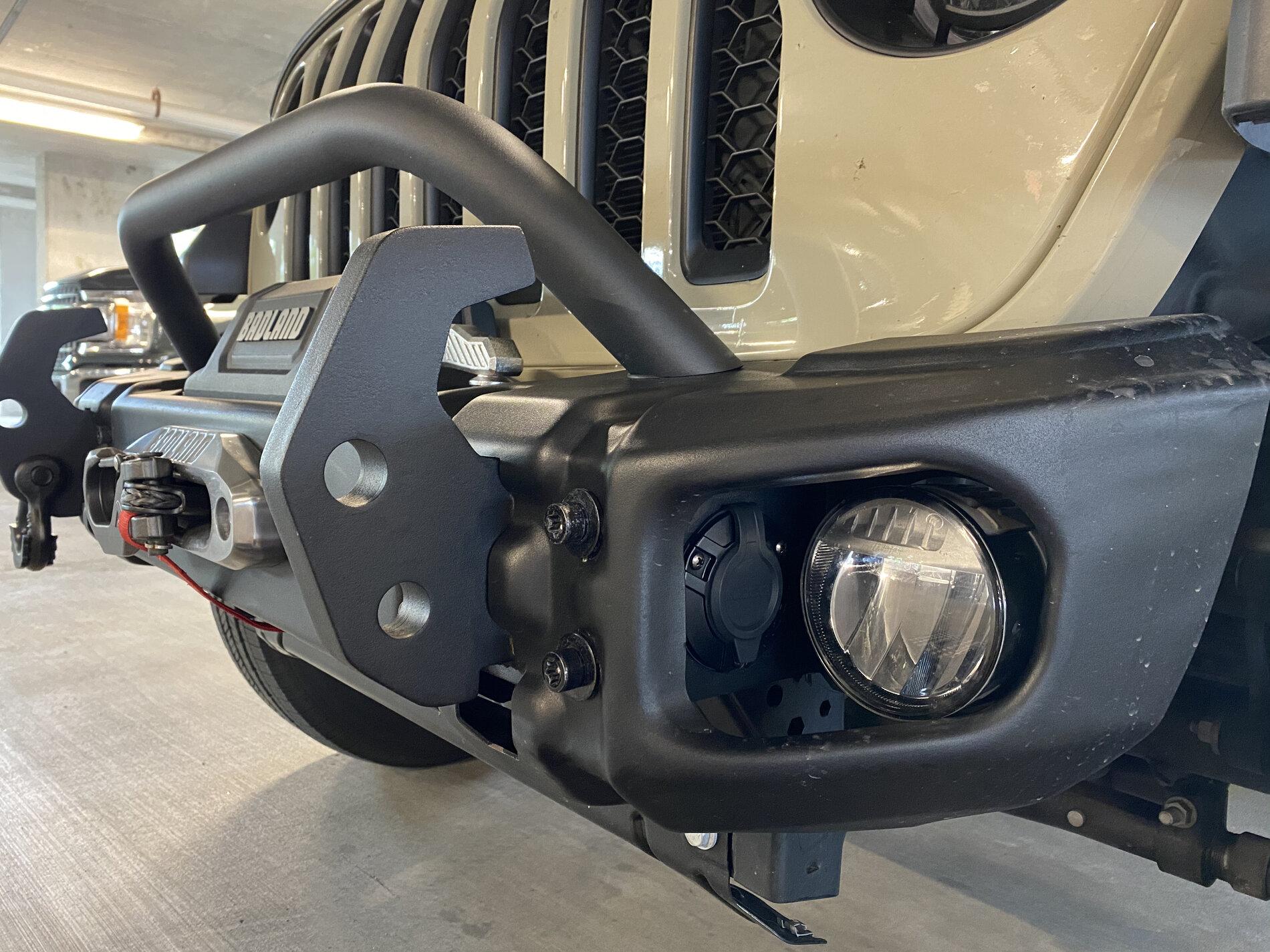

I have the LED package and this bumper. I didn't have any problems installing the lights. Putting that bumper on by myself took some time/

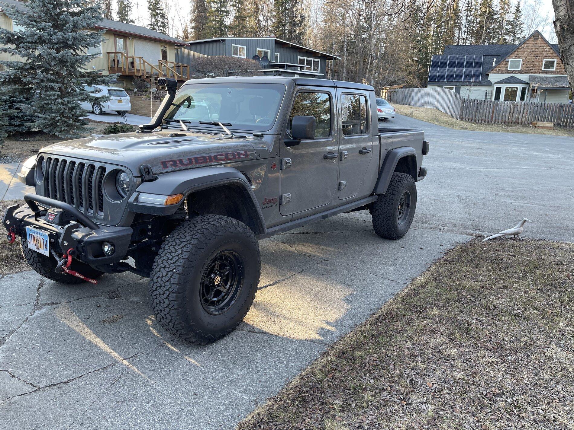

And your not finding any issue? It looks great was it just transfer it over? Or did you rewire also are you running 35’s or 37’s?
Just transferred over have to take front bumper apart to get the wiring. Fake 37’s Bfg ko2’s
There’s no issue with the fogs other than a million screws that you need to remove from the old bumper to get the wiring out. Once that’s out it’s easy peasy.
