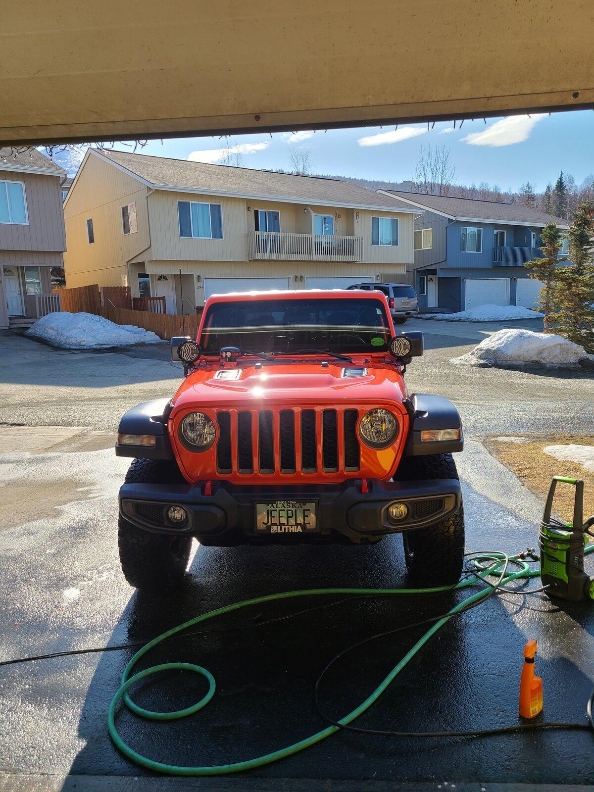

If you want a low mount snorkel look at the River Raider. It's a slick snorkel made in America, contains no plastic, can run your axle breathers to it, contained totally within the engine bay, just a lot of advantages IMO over the external plastic style snorkels. It has an available extension to extend the snorkel to about the top of the windshield for when you need it. No cutting of your hood required and no road debris is getting into it.

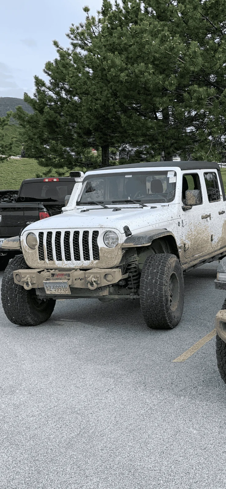

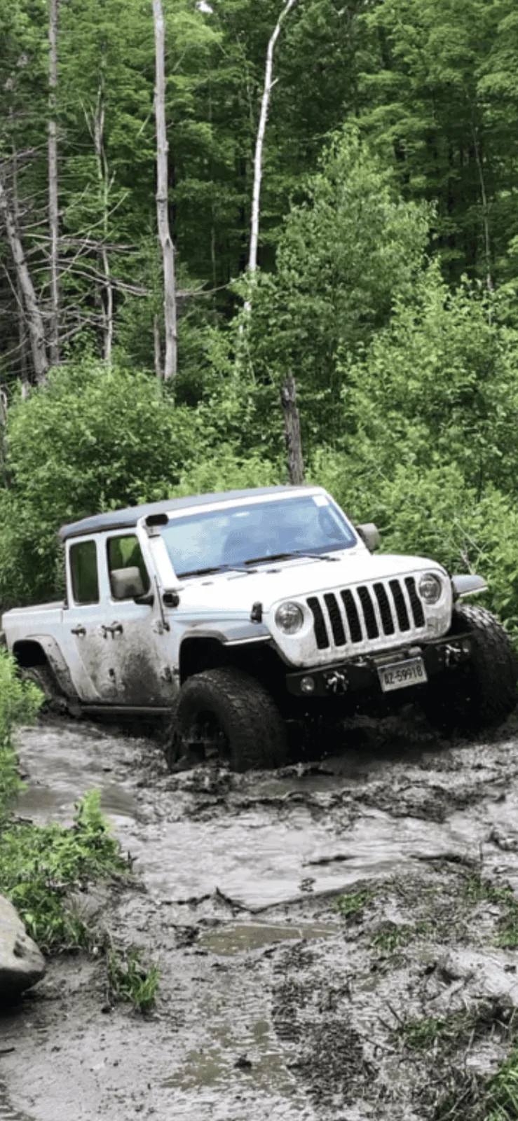

I’m happy with the RR snorkel. In the winter I remove the upper part and run it with just the lower because snow and ice build up around and behind it and causes issues with the wipers.
Not the best photos of the snorkel, but it’s the only pics I have on my phone at the moment.

Hey Puch that is what I was thinking, with the snow getting it lower onto the hood may detract from getting it in there. I know with the snorkel for the Taco Pro they recommend turning the intake to the back in heavy snow. Have any pics of the mods, and have you had any issue with water settling in any of the low points?

I remove the top snorkel in the winter because snow and ice build up between the snorkel and windshield. The wipers start hitting on it. That’s the only reason I switch to the low intake in the winter.
I haven’t experienced any significant water in the airbox after driving in heavy rain/snow. I suspect that the small amount that does get to the air box is from car washes spraying directly into the snorkel. Don’t forget, there’s a drain tube installed in the bottom of the air box and it’s left open for that reason. When you plan on going through deep water, you can close the valve to prevent it from filling through the drain tube.
IMO, the RR snorkel kit isn’t for wheeling through crazy deep water long distance. More for a quick dip through a mud hole or stream and it looks good. If you want a truly 100% functional snorkel, you might want to get something else. This is the first snorkel I installed on a vehicle so I don’t really have anything to compare it with.
