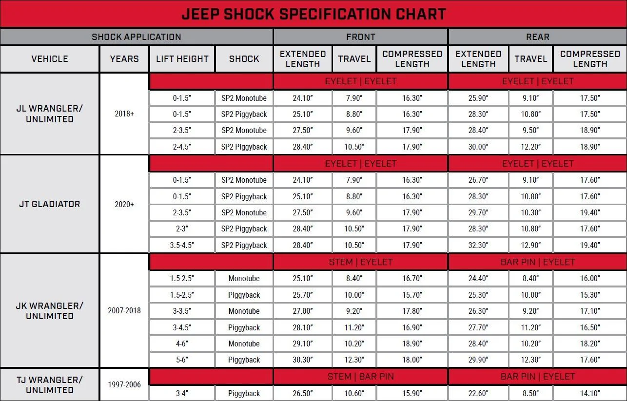

You gotta add some $ amount for a new front driveline if you are going with those Fox shocks. Over 28.65" extended up front and the stock driveline meets with the exhaust. As you can see above the Falcon up front cap out at 28.40" so you won't have that issue. You lose 2" of total extension and a little over 1.5" of total travel with the Falcon over the Fox.
Sass told me the Fox are noticeable upgrade to the Falcon 3.x, he would know, he has Falcons. He went to the Fox vendor pow wow awhile back and got to ride the various types of Fox shocks. My take is the Fox are better in high speed stuff, for crawling either are going to be pretty top notch. The Fox are 1k+ more though and again you'll have to spend 500+ for a new driveline.

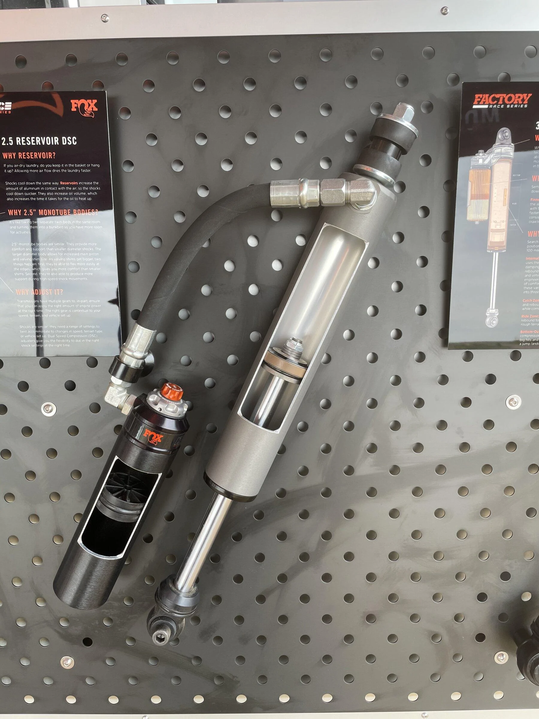

Yep. The falcons are in between the fox 2.0’s and the 2.5’s. The fox rods are bigger by an 1/8 of an inch, the bodies are 2.5” vs 2.25” and you get to adjust low and high speed compression. Now that said if you get into the edapt from falcon… they will adjust on the fly.
