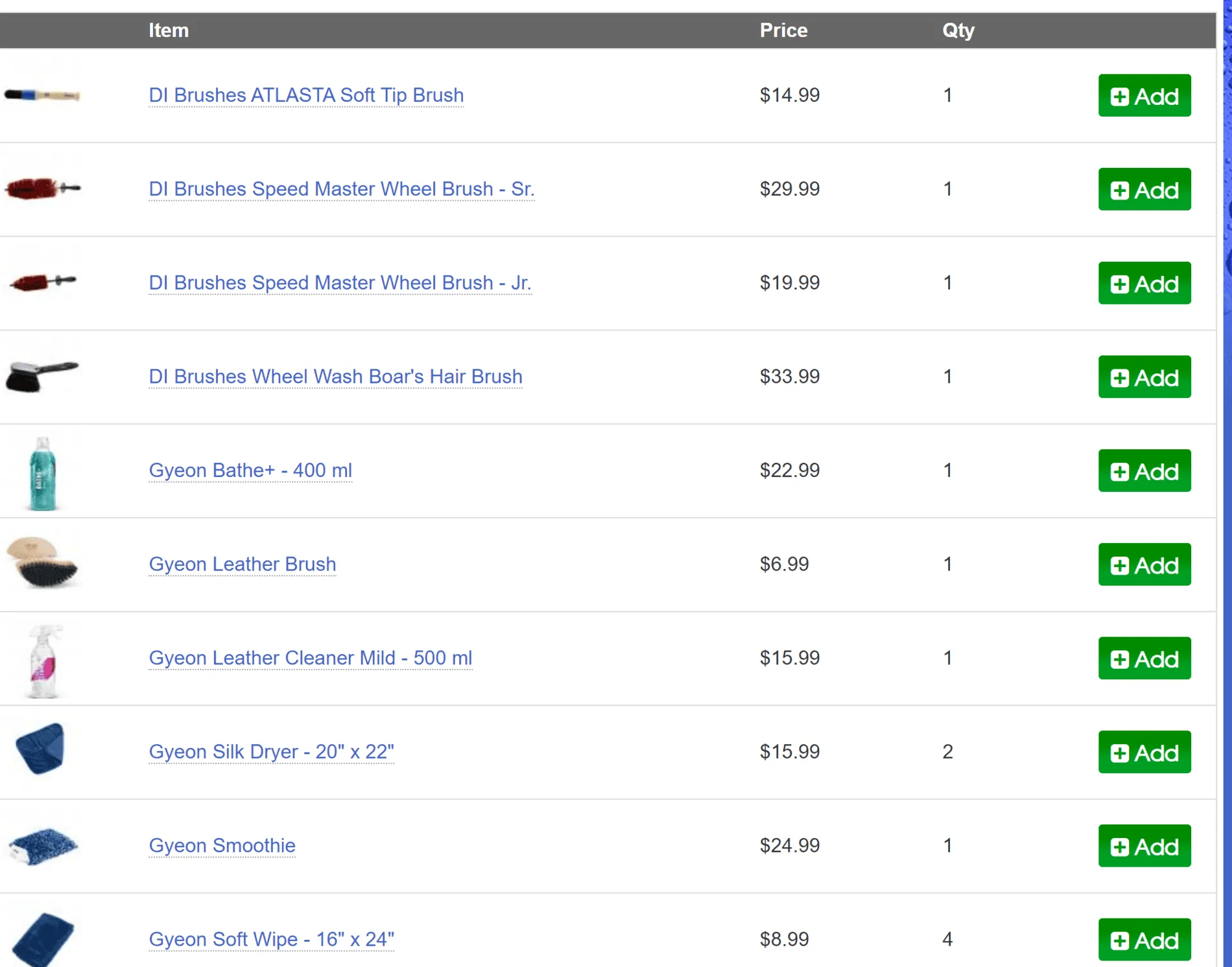

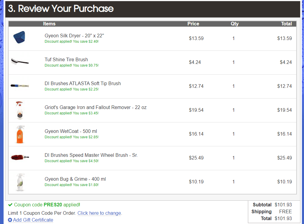

Correct. All outstanding products, and most are ones I use on every vehicle I detail.
OH sweet, pro tips from a pro. I'll load up a few goodies and give them to my wife as a late valentines day gift. :CWL:
