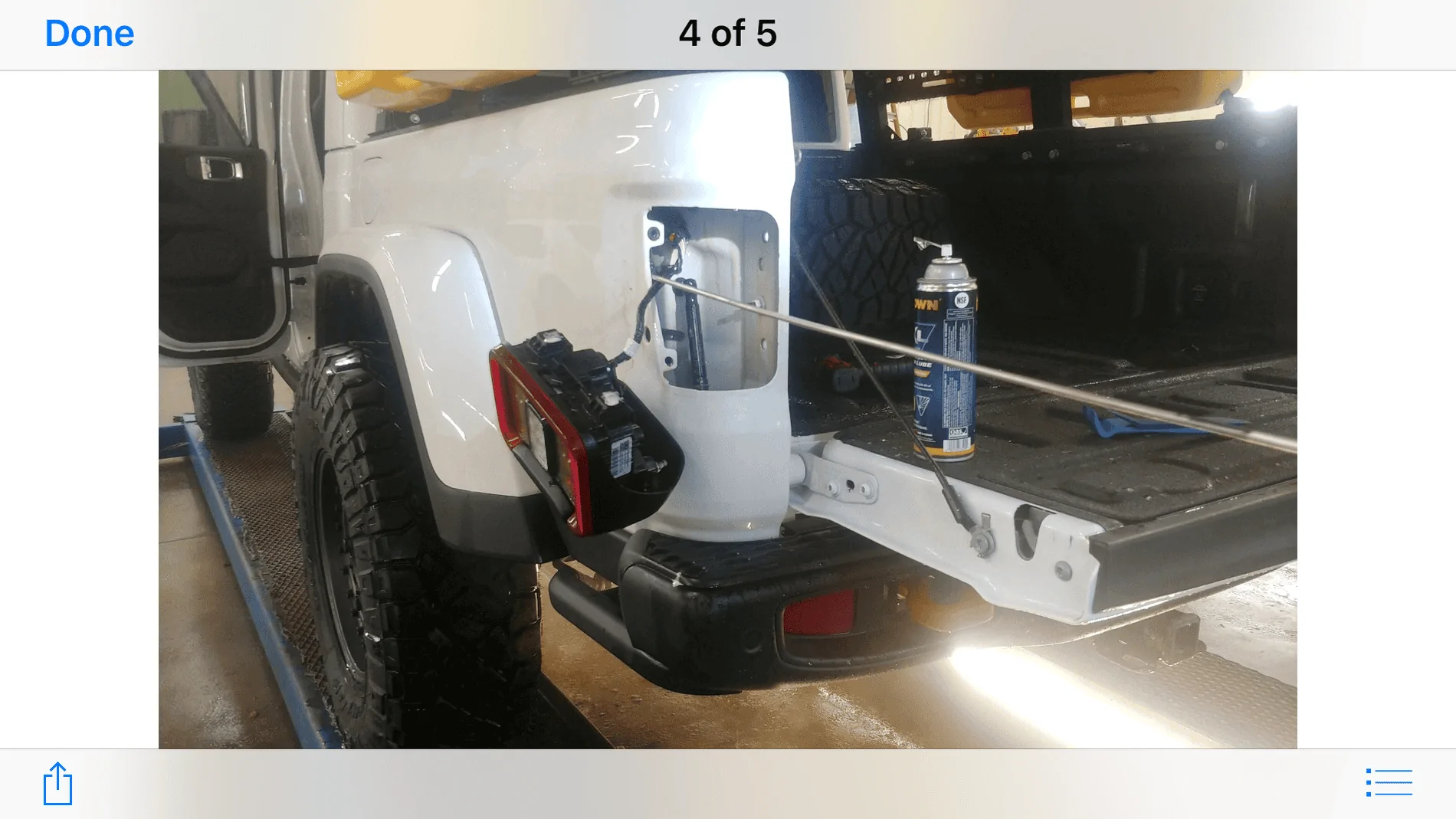

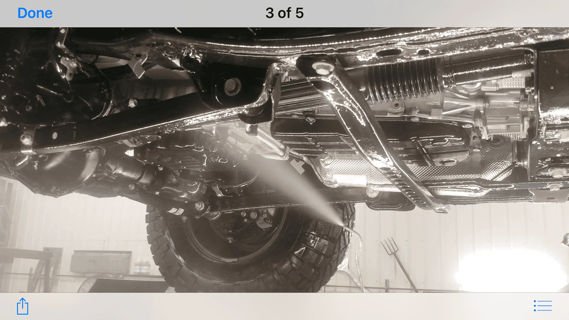

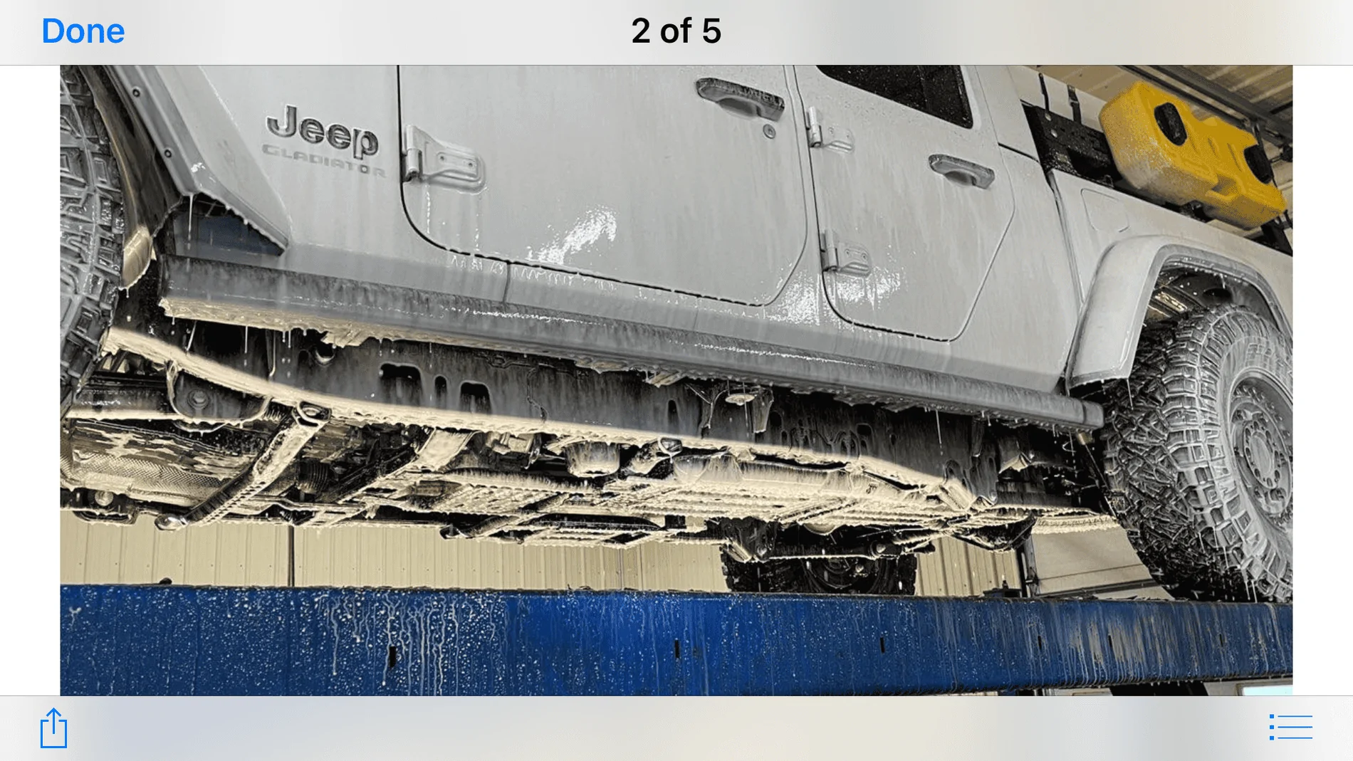

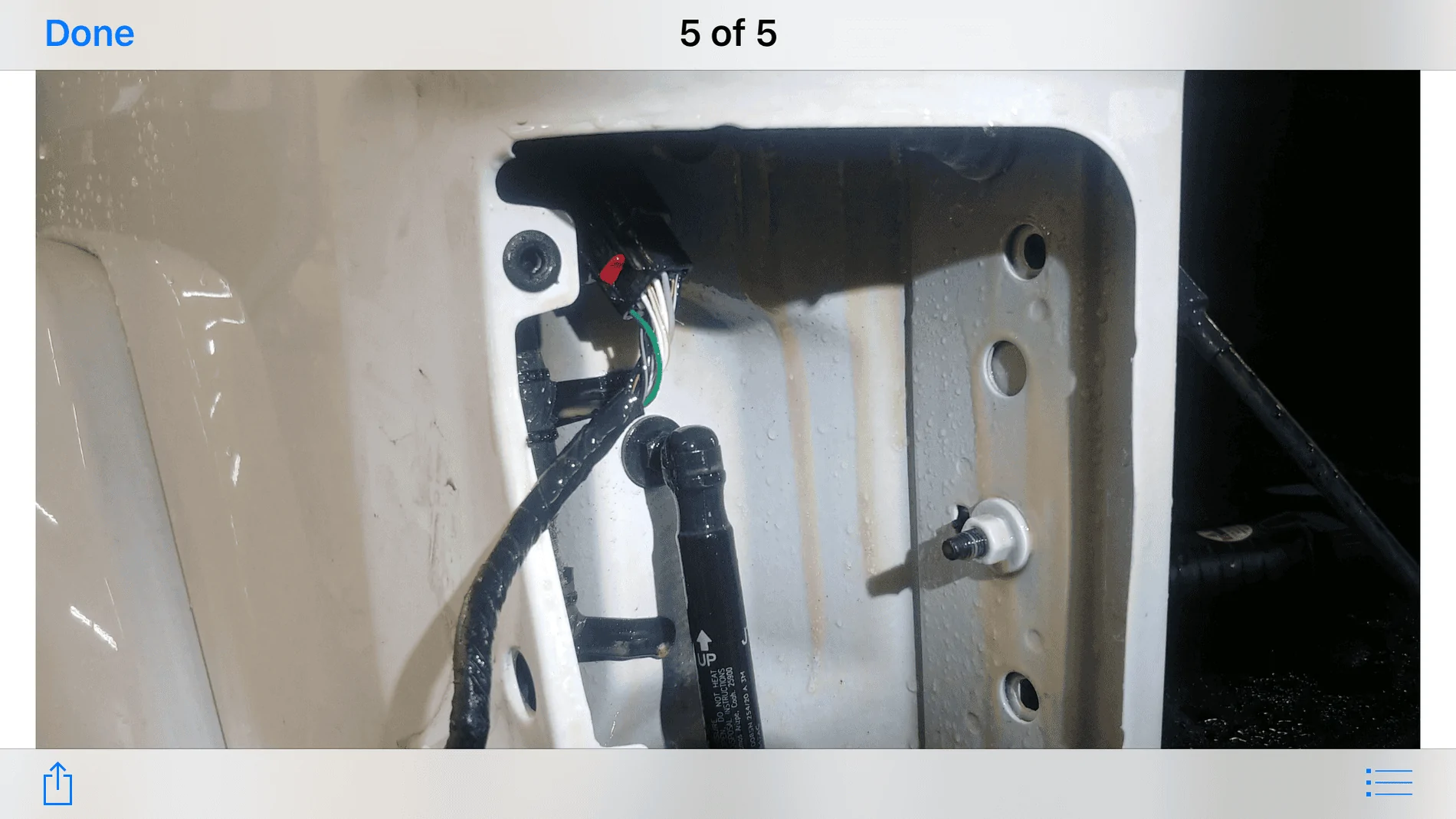

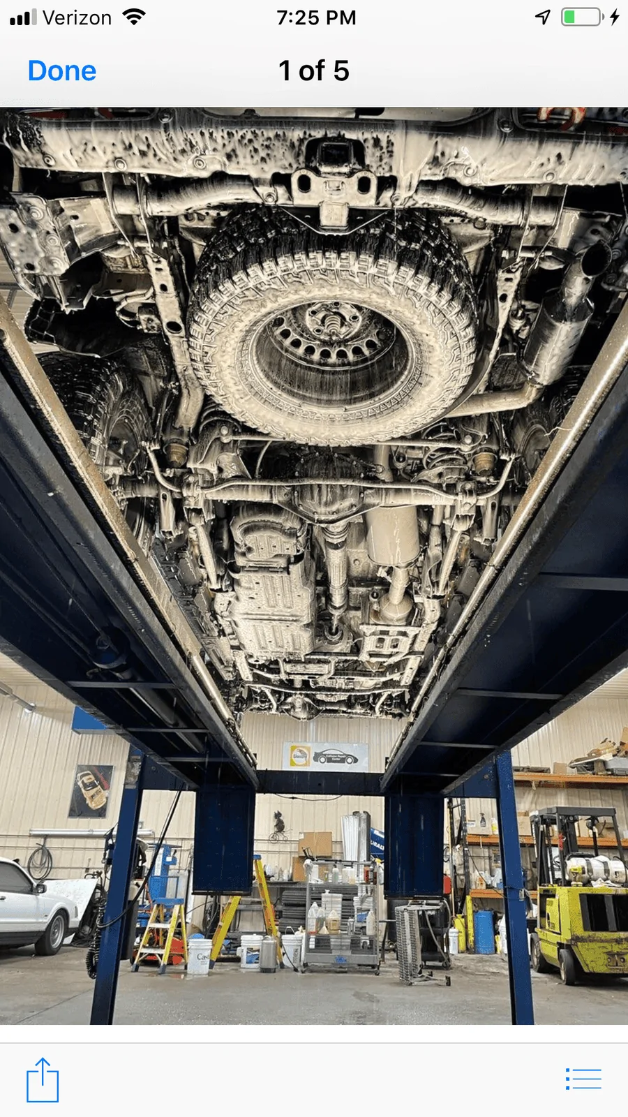

Just had my 2021 JT GLADIATOR DIESEL undercarriage known sprayed for rust protection. Very common in Canada because they know all about salt and rust. Jim Falcone 315 292 8838 out of KROWN OF UTICA RUST PROOFING owner. It is done annually and costs under 200 dollars but varies depending on vehicle. I plan on spraying it every spring and fall living in snowy NY. Some photos showing first they remove salt and clean underneath. They even removed my taillights. They drill and spray into the doors then place plugs. Truck looks great.

Looks like they did a good job, not sure that is available in the north east where I am. Only downside I have found is working on anything after being coated in fluid film and it is messy, oily and dirty.

Its called KROWN and u can google search. I drove 3 hours to have Jim do it. He came highly recommended. I plan on having my truck lifted in spring. I would rather have bolts come off easy and no rust. I traded in my 2018 JL RUBICON which i just loved but never rust proofed it but after its first winter i could see surface rust around control arms. i agree if u work on your own vehicle it could be messy but just wanted to share this is what they commonly do in canada.
